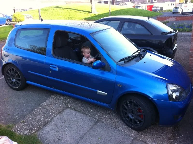

Looks like you have the same problem as me with some little thief trying to steal your car ;)

lol @ the kiddies in the driving seat so cute!

Lol, apparently it's an organised car ring across the country!! Little buggers!!
