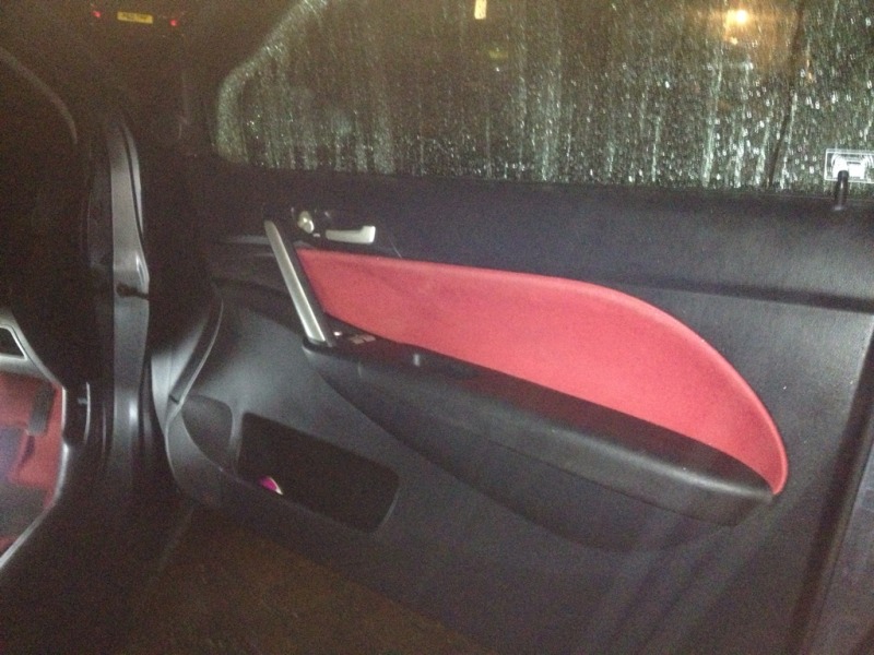

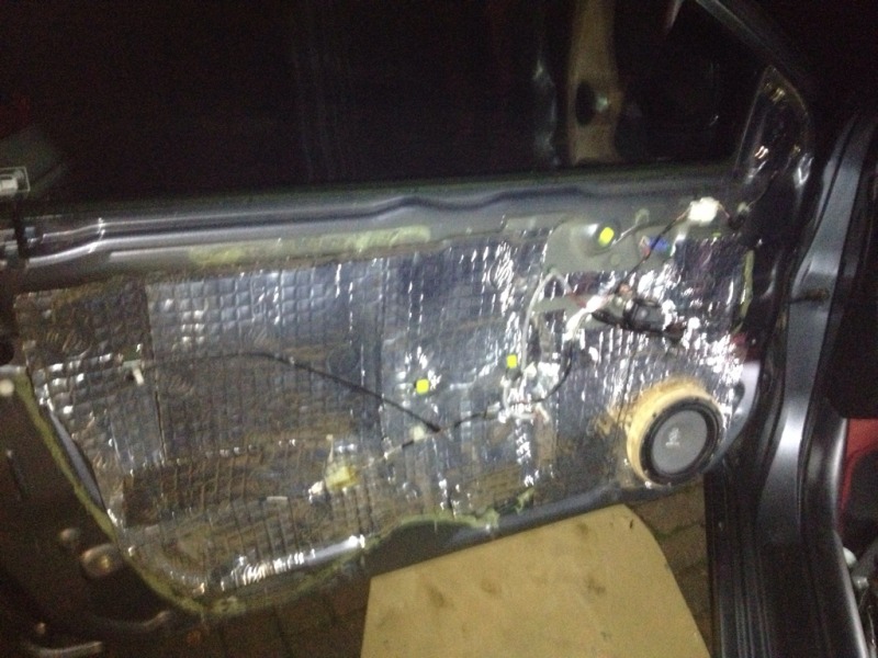

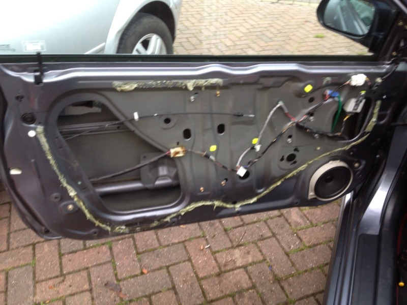

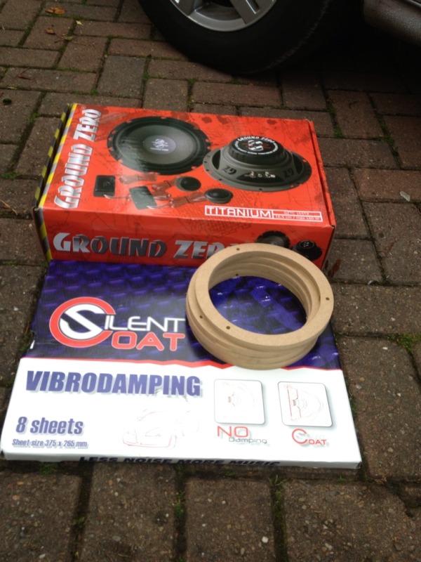

Started the door Builds today, Still waiting on my tweeter pods from Honda, So just did the deadening, trimming and MDF Baffles
Whipped the door card off:
This pony thing was there before:

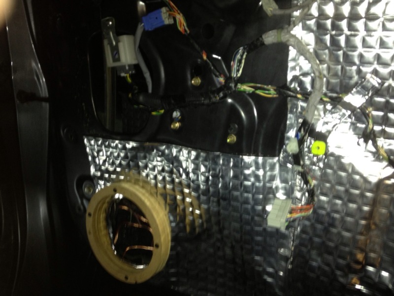

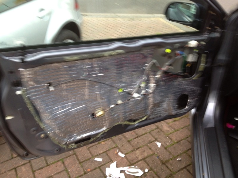

Ripped all the old stuff out, and started deadedning the outer skin
Then Sealed as best I could, the inner skin,

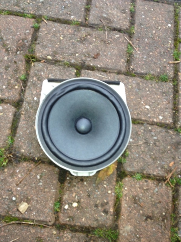

Mounted some 24mm MDF Baffles and the Woofer:

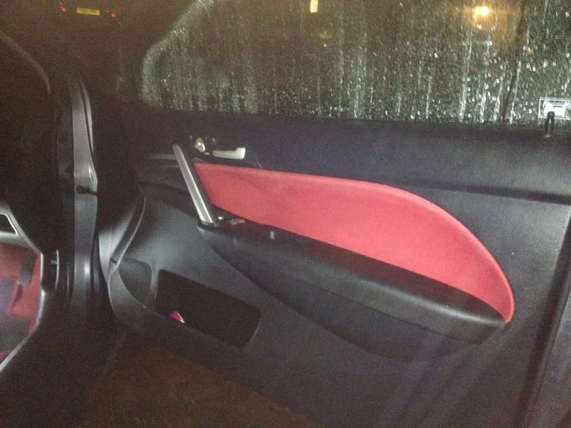

All fits back on invisibly once the door cards on
Had to trim the inner door skin with tin strips to clear the woofer magnet, and inner door card slightly with a stanley blade, but nothing too major! With the exception of the deadening should go back to stock pretty easily!
Waiting for the tweeter mounts and more deadening to do the other side!

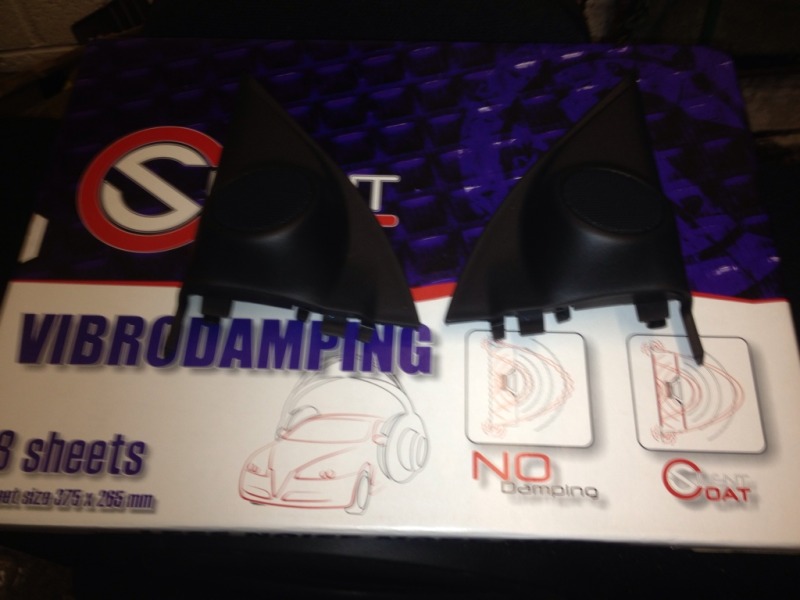

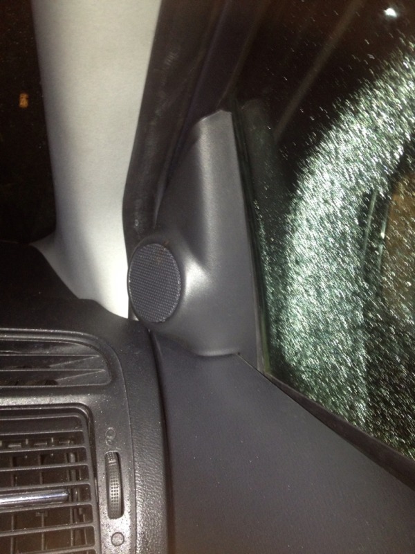

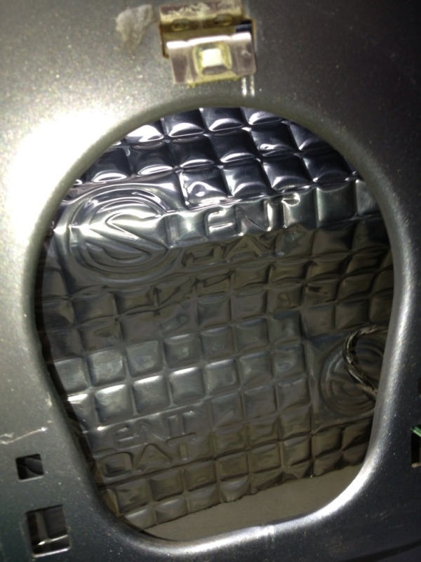

The rest of my sound deadening and my Tweeter Pods came. Some Civics came with these optional Tweeters in the mirror covers, but they were rare. People on eBay seem to think this means they are rare and expensive. Fortunately, Honda has an awesome online parts site, Called Lings Honda. Its basically a website where you can order parts online. Each car has Schemetics/Exploded Diagrams (similar to an R/C Car manual!) So I found the tweeters pods and bought them for £8.50ish each :)
I had football training so didnt start till 8:30pm, armed with a Xenon Lantern Light, I started, was finished by 11pm!
I finished up the right hand door, (deadening,trimmed and added MDF Baffles)
All fitted back together like new :) Cant really tell anythings changed!
Close up of the Tweeter Holders

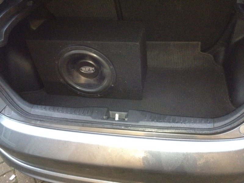

Here's the sub in a generic 1.5 CUFT Sealed Box

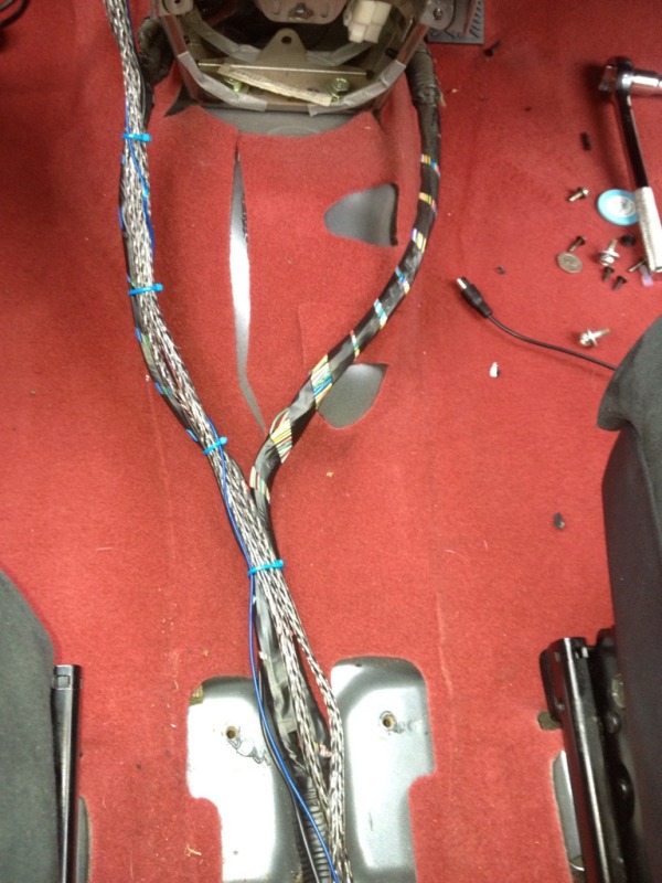

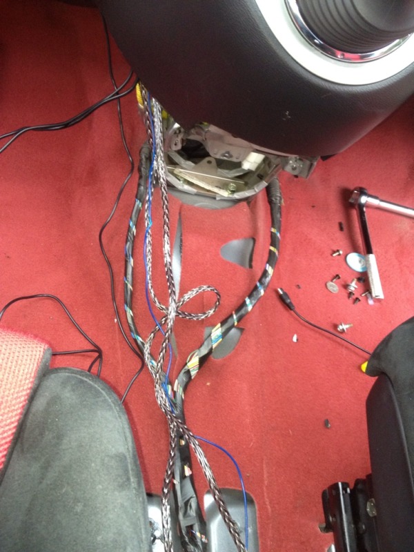

Now the amp was ordered, I decided to start running the wiring for the amplifier. Just a 4 Gauge kit. To keep interfearence at a minimum,
Ive ran the Power wire down the left hand side, and will run the RCA's, Remote Turn on Cable & Reverse Camera wiring down the centre. This meant taking out the centre console. Been a Honda, there were plenty of guides online and it came out with 6 screws:
I simply followed some existing loom and zip tied the cables to it:

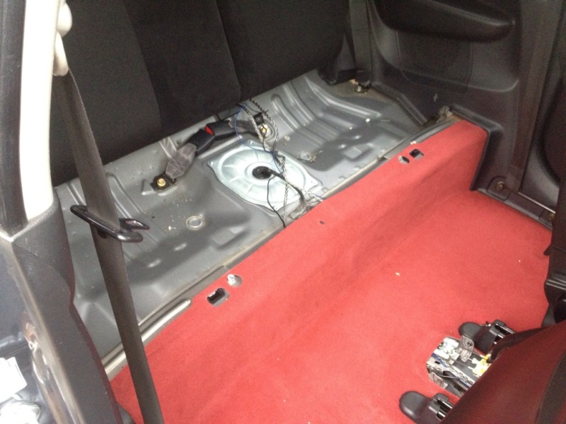

Out came the rear bench
I then ran the power Cable all the way down the left hand side upto the Glove box. I didnt bother putting it through into the engine bay, as Im not ready to power up yet, so for now its stashed behind the glove box:

Looks like a tidy install, can you not get a smaller box, looks like a lot of wasted space in the box? Would free up some boot space and look more subtle too.

Smaller box wouldn't benefit the sub. Im not just going to plonk it in there, Ill sink the amps etc, it will look fairly subtle.
A Sub has hardly ruined the car, especially @ 320wrms.
IF anyone has heard a standard Type R (or in fact any standard system in prfetty much any car, 182s have horrific stereos!), they will understand why I've done it lol. You're just been old!

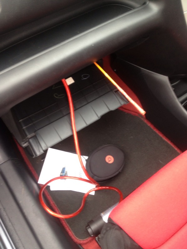

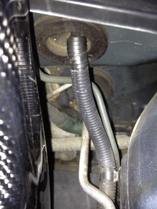

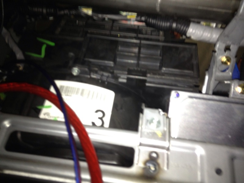

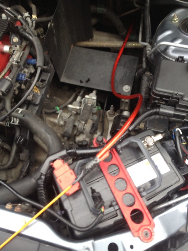

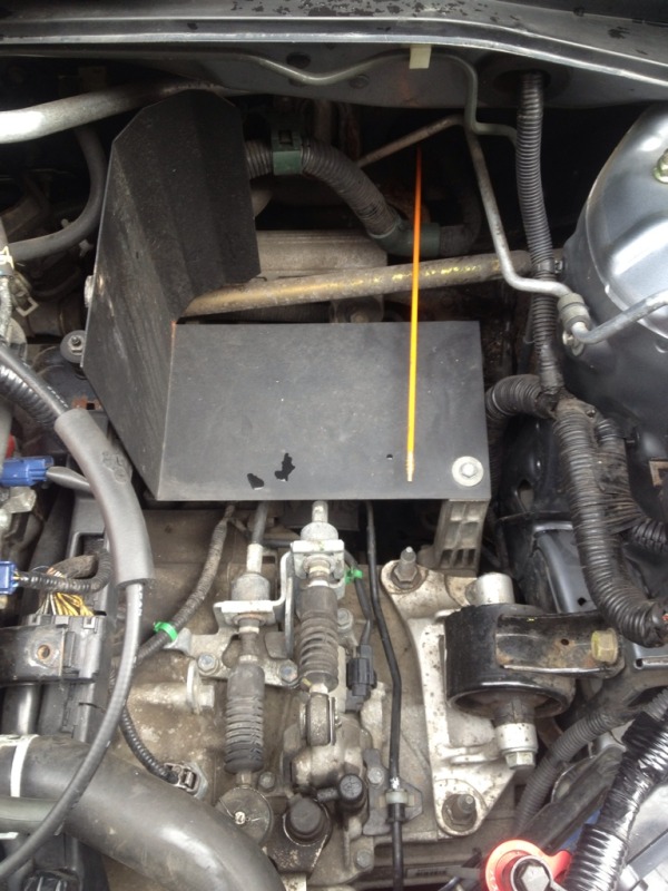

Because Id gone about it the hard way, and ran the power cable from the boot to the engine bay, as opposed to the engine bay to the boot, Id made it very difficult to feed the power wire from the cabin into the engine bay! I borrowed a flexi rod off my CCTV installing pal, removed the Tegiwa M Air Intake and pushed this through into the cabin.
Flipped down the Glovebox and out it came
Taped the power wire to the rod and pulled it through
So thats that. Only issue now is I need to crimp the terminals on to the wires, but my crimps are poor, So Im gonna ask my mate to crimp my connectors on with his high end crimps.

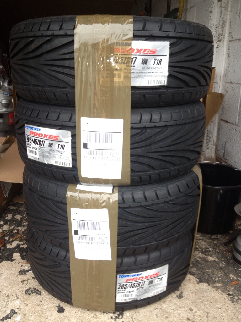

Fresh rubber :) Went for 4x Toyo T1R's, got them for a decent price. Currently have P Zero's, but these worked out £40 a corner cheaper! Ive heard they arent the best for the winter, but 8mm of new tread vs 2mm of old tread is surely better.
Dont need them on till Xmas time, but had a decent month at work so got them whilst I had some spare cash
  TTRS & V50
I bought two of these the other day and it's been shitty wet weather and they performing pretty good at the moment.
Considering they're 70 a pop from Camskill compared to anything half decent at 130 a pop, it's definitely worth it.

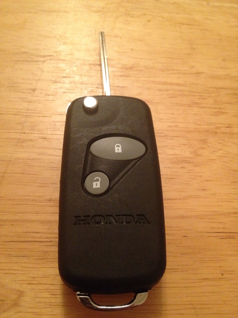

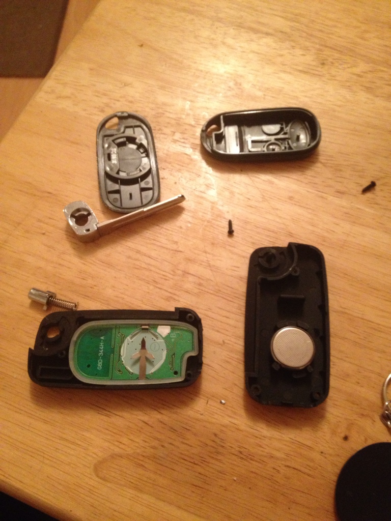

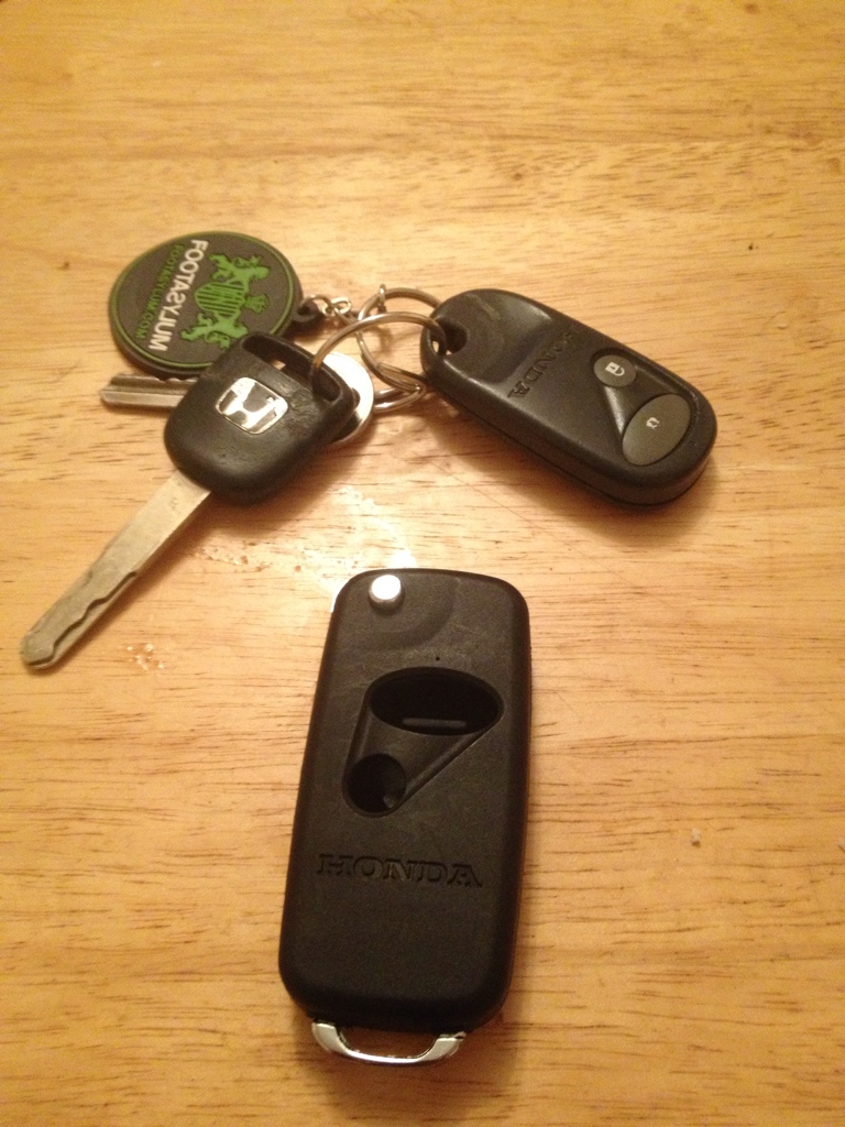

I was forever getting the piss ripped out of me for the pathetic Key you get with an Ep3. It looks like its from an Austin Metro. I usually type "Civic Type R EP3" into ebay when I am bored and I came across this!
http://www.ebay.co.uk/itm/390485776577?ssPageName=STRK:MEWNX:IT&_trksid=p3984.m1497.l2649
I whacked in an offer of £12 and it arrived 2 days later....
You start with this,
And basically, transfer the innards of your stock blipper into it, then get the key cut to the plain blade. I havent yet got the Blade cut, but as you are using the stock circuit board, no re programming etc is needed, its basically a shell.
Simple Job
And you end up with (IMO much better)
Also seen a few EP3's pull off the track look really well, Im not sure I can pull it off, but This little lot cost me around £20 2nd hand, so no big loss if I dont like it
