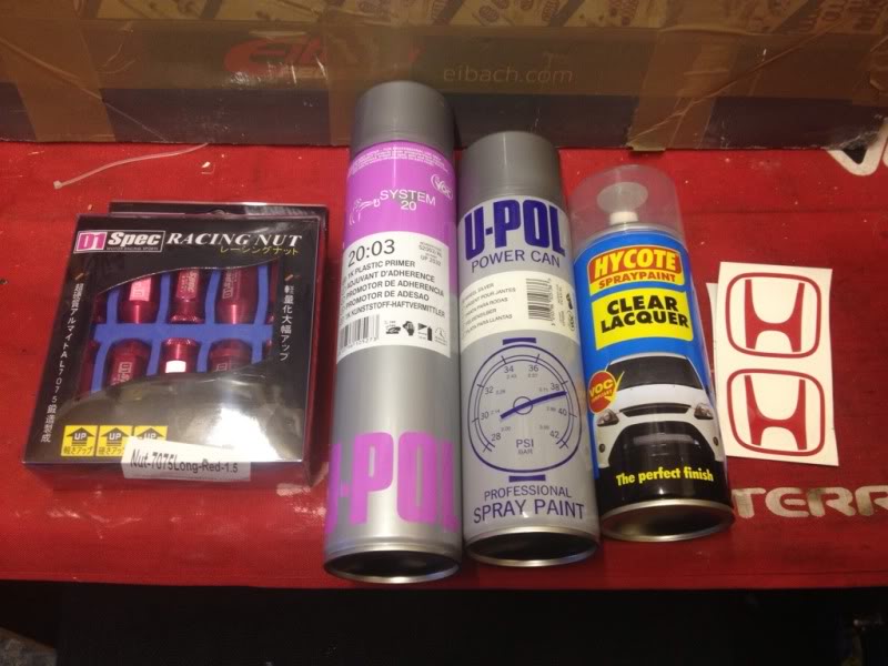

Rather than buy new ones, I decided to have a go at refurbing mine. I bought some Plastic Primer, wet and dry, Wheel Silver Paint, clear lacquer and some Red H Honda Decals off the CTRO.
Also got some Red Wheel Nuts, but you need adapter to fit them, and they havent yet arrived!

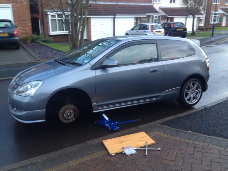

Whilst the wheels were off, I cleaned inside the arches and the inside of the wheels. Yes I used axle stands

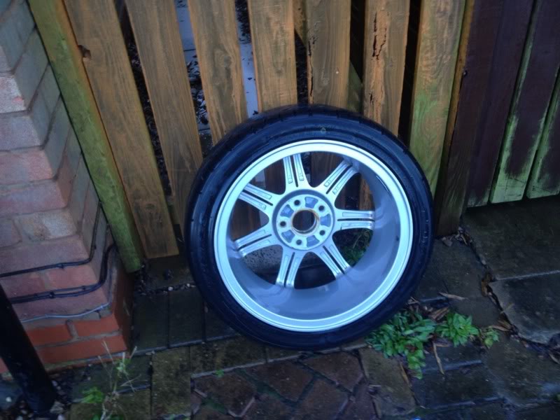

Cleaned the wheels

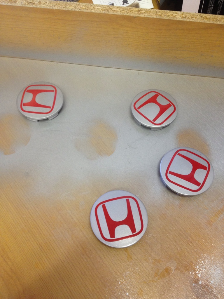

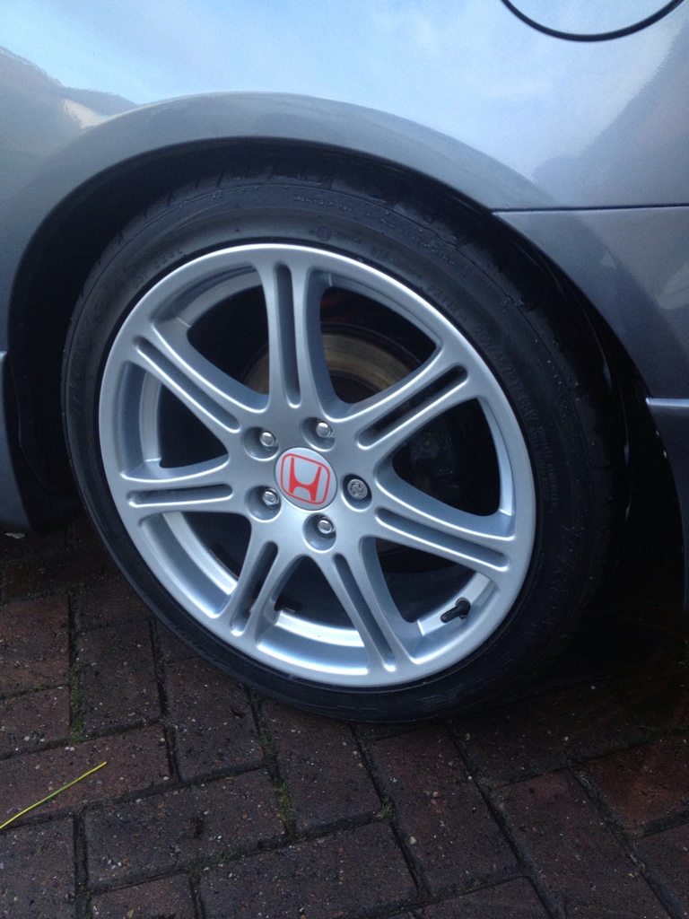

My Mate did most of the next part whilst I cleaned the wheels, so I cant take credit for the finish. We flatted the centre caps back with wet and dry, gave it a few coats of plastic primer, then a few coats of wheel silver. Once they were dry, we added the decal and put 2x thin coats of Clean Lacquer to seal them.
Colour match is spot on considering its an off the shelf paint.

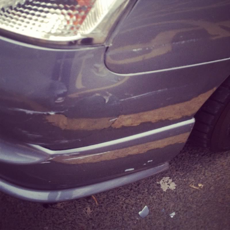

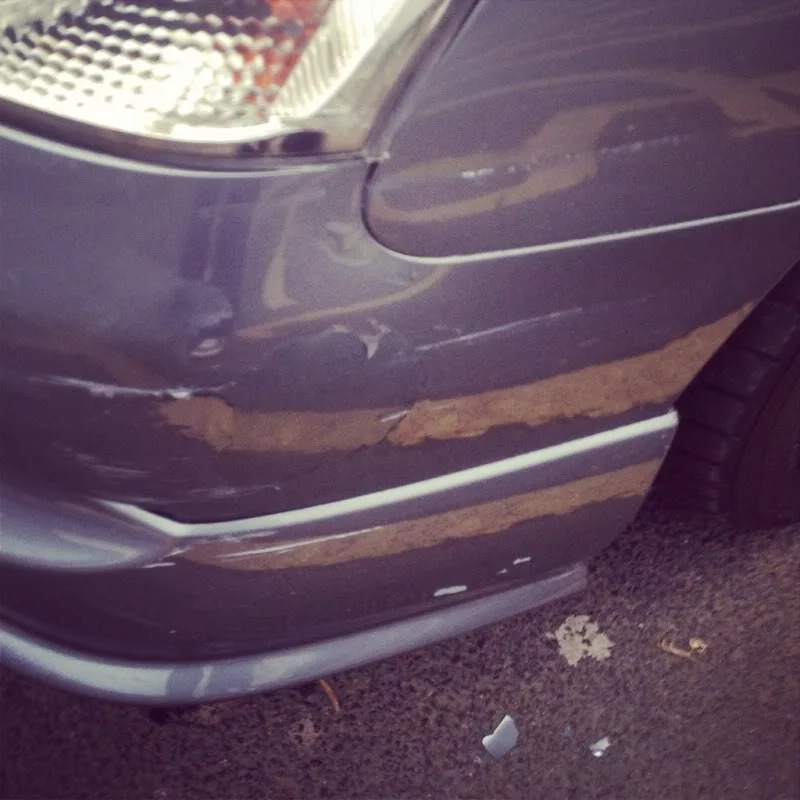

WELL!!! I've not drove this since January the 12th!! Got a bit of a scuff, (long story!) and I generally got fed up of having a car I Care about!
I parked it up, put it on trickle charge and forgot about it. I've been cruising about in a Golf Diesel and generally not caring about motoring!
The Type R needed rear discs and pads, so I had them fitted today, and gave it a wash:

Not sure when Ill start it all or in what order, but I hope to be done for the Summer. Had a quote of £350 for the damage repair, there's no dents, its just flaked the paint off, do we think thats a good price or???

£350 seems fair.

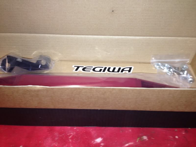

Well, I ordered it all. Had a decent win in the local casino, which has paid for most of this :) Quite a bit came today, still got to wait for the Cat Back System and the HEL Brake lines but here's what Ive got so far:
Jazz Washer Jets
JDM 22mm Anti Roll Bar
Poly Flex JDM Bushes
Tegiwa Red Lower Tie Bar
Genuine UKDM Mats - cant beat fresh genuine mats :)
Blackworks Upper Rear Camber Arms
Tegiwa Front Camber Bolts
AP Racing Dot 5.1 Brake Fluid
Trying to get it all fitted the weekend, then its off to A Line to do a Fast Road Set up :) Ill get the exhaust fitted and book it in at TDI North for the K100 :) Hoping for 220bhp!
Declared it all to the insurance and its gone up, but not too much so thats all good.
Blackworks Rear arms, really are a work of art compared to my D2 Racing ones!
Red Lower Tie Bar: Not sure what they do, I followed a CTR with one and wanted one :)

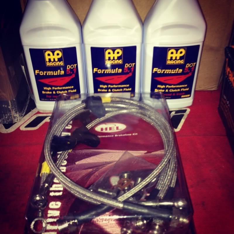

HEL Brake Lines came today:

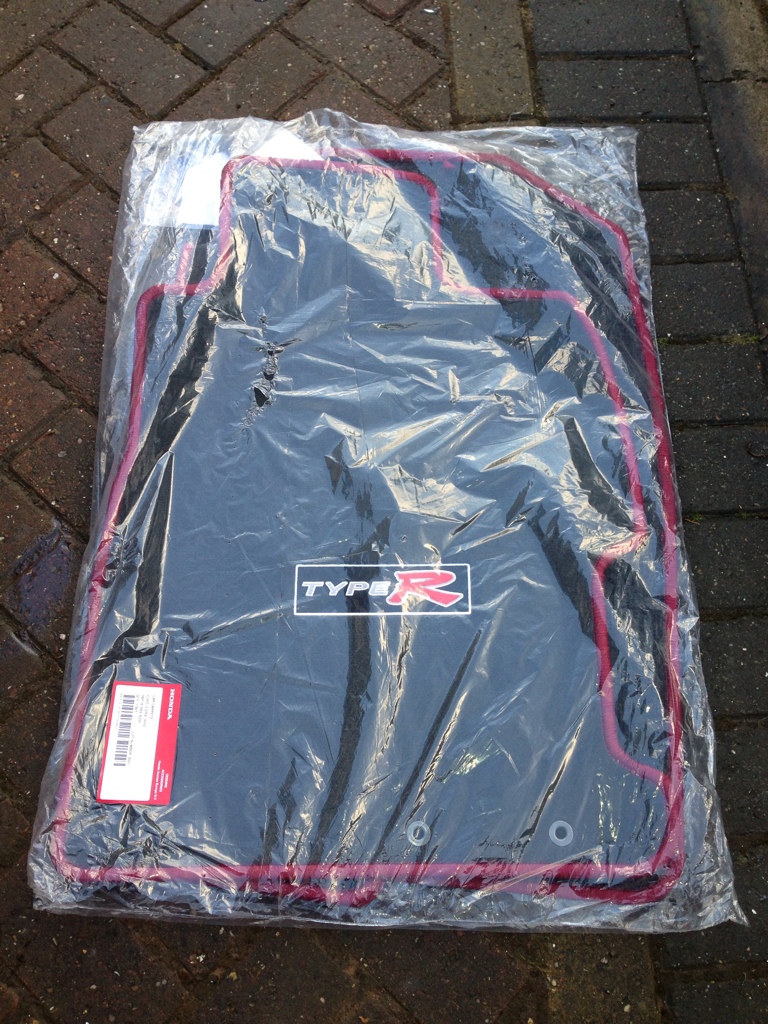

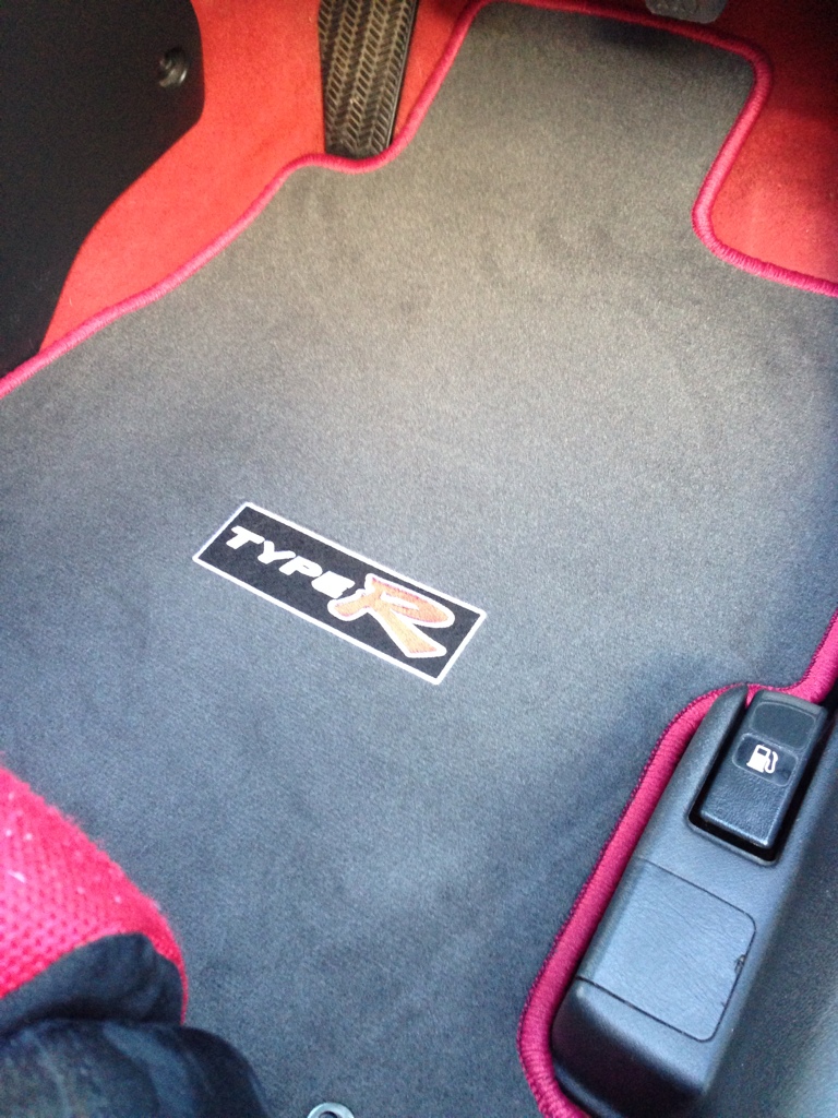

Gave it a quick clean today and fitted brand new OEM Mats, which came with the Clamp, which my car never had and I always lost out on eBay:

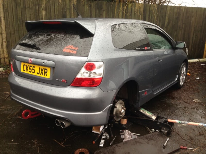

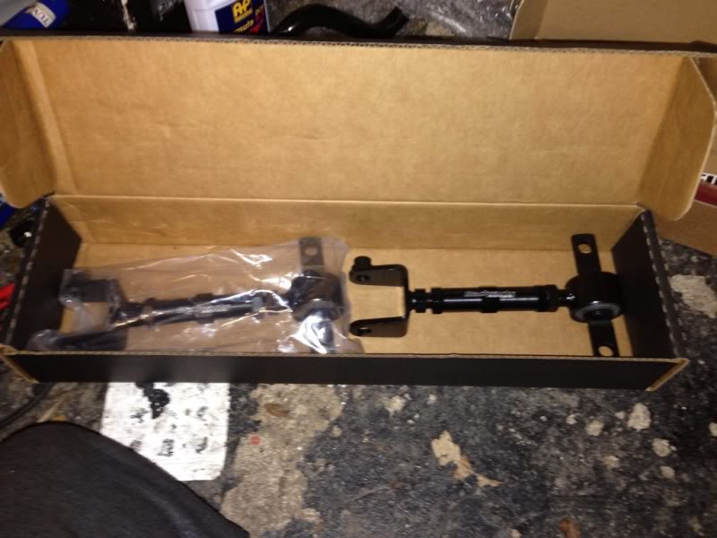

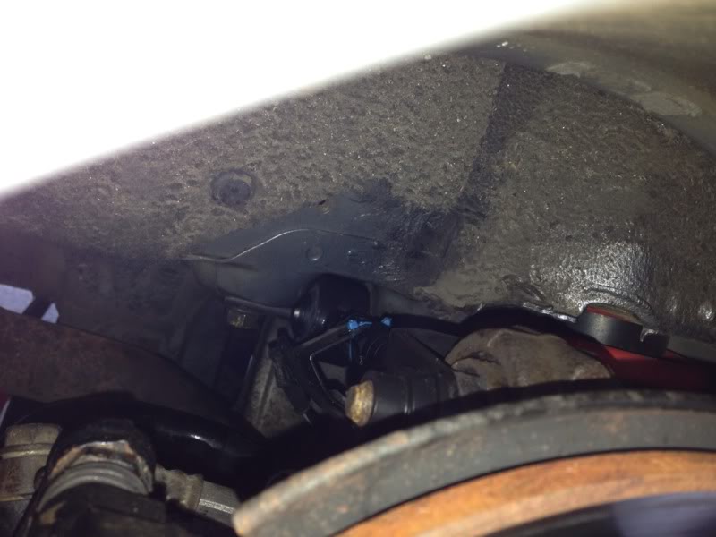

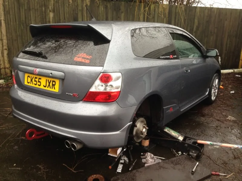

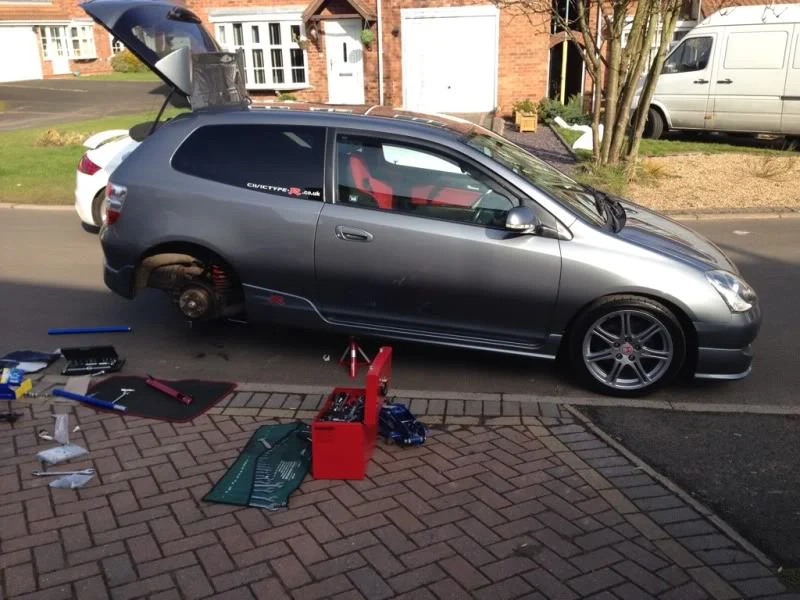

Weather was good today, so me and a pal had a go at fitting some of my parts. First one, nice and easy Jazz washer jets. These spray a mist of water as opposed to a jet. Simple enough even for me:

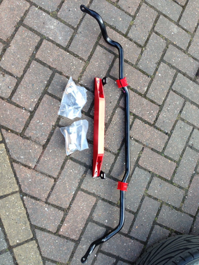

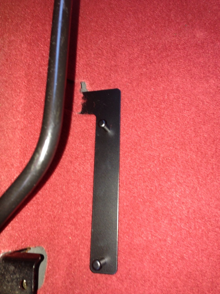

Then decided to have a pop at fitting the Rear Camber Arms, JDM Anti Roll Bar, Poly Bushes and Blackworks Camber arms.
I popped to the local motor factors to buy some new Drop Links., just to make things easier and jacked the car up:
Got a bit carried away with the Camber Arms, so no pics. I've done them by Eye for now. Ill get the Fast Road Geometry Check done at a place 8 miles away, so even if Im a tad out, it wont cause catastrophic wear to my new Toyos! I'll not use the car till then!
Here's a terrible pic taken through the wheel!

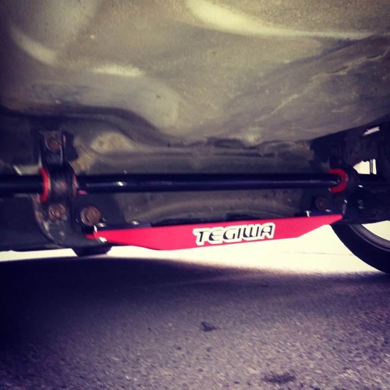

Then moved on to ARB:
Tilt your heads 90 degrees ;)
After some swearing, sawing off the old drop links, and getting filthy, here's how she stands at the moment :)
We had a look at the Front Camber Bolts, I'm guessing they work kinda like a Cam, but wasn't too sure so Ill let A-Line fit them when they do the Fast Road Set Up on Thursday if they can get me in!

Front camber bolts are easy. Just make sure you point the bolt toward the car as Fred taught me and the tab toward the block.

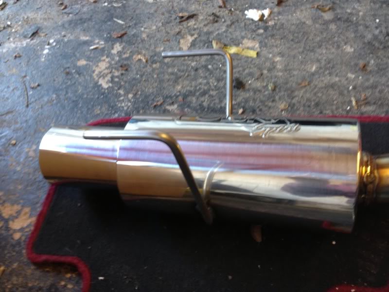

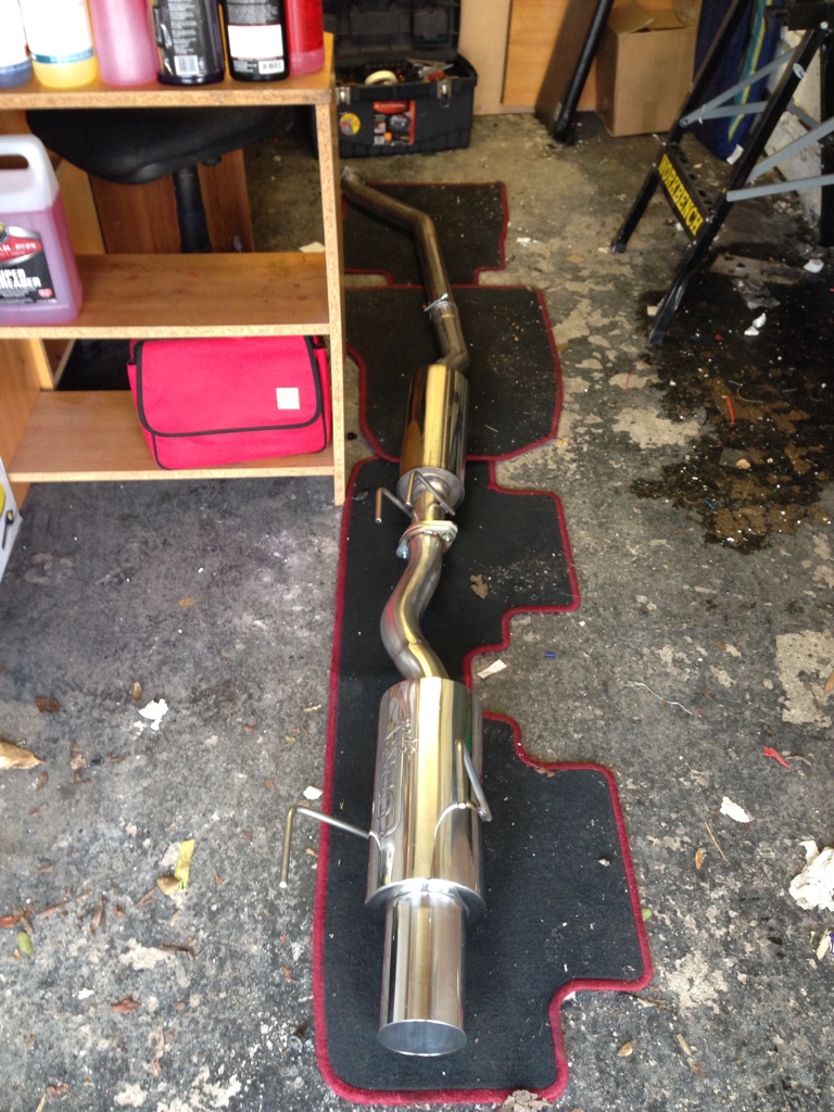

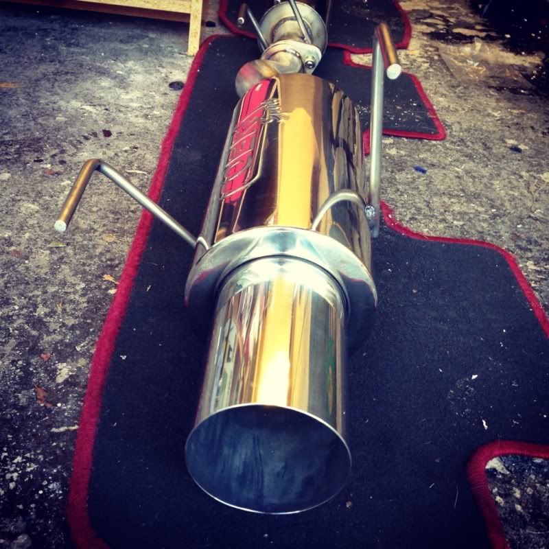

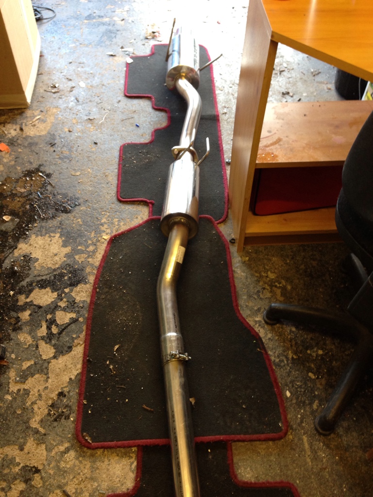

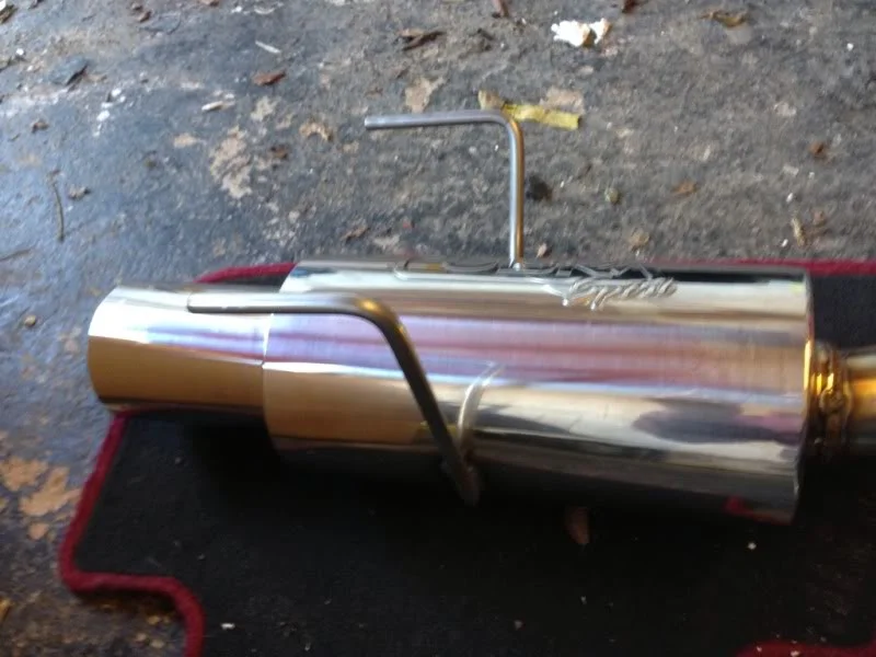

Front Camber Bolts are on, couldnt get in today to do the FRSU, so thats getting done in the morning. However the Exhaust came today.
Cobra, 2.5" Centre Bore, 4" Rear Can. with 2 small centre silencer.
Must say I'm very Impressed with the built quality!
Just need to get it fitted now.

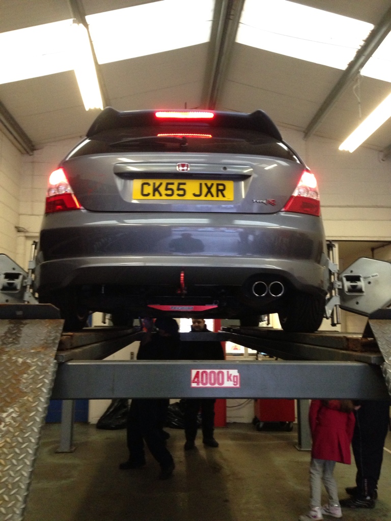

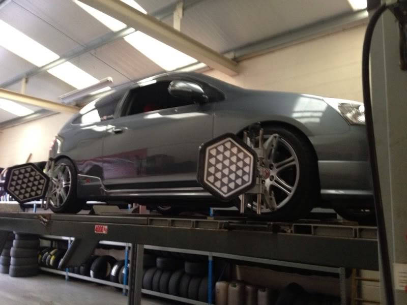

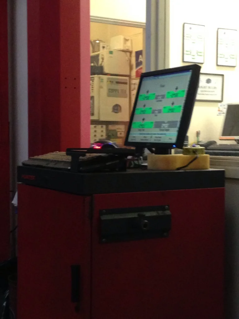

Right, I had a sticking rear caliper, butmy mate managed to rebuild and sort it on his lunch break so I got back to A Line in Dudley to get the full set up done :)
The settings I asked for are above :)
They got it up on the Ramps and set it using Hunter Laser Gear. I expected my settings to be horrific, been as me and my mate had fitted the camber arms and bolts ourself by eye, but it wasn't too bad really!
Not really gave it any with the new set up, but it does feel much better to drive, whether thats Placebo effect who knows? I only paid £45 inc vat to have The Toe/Camber adjusted to my settings, which is a bargain IMO. Got a before and after print out too :)

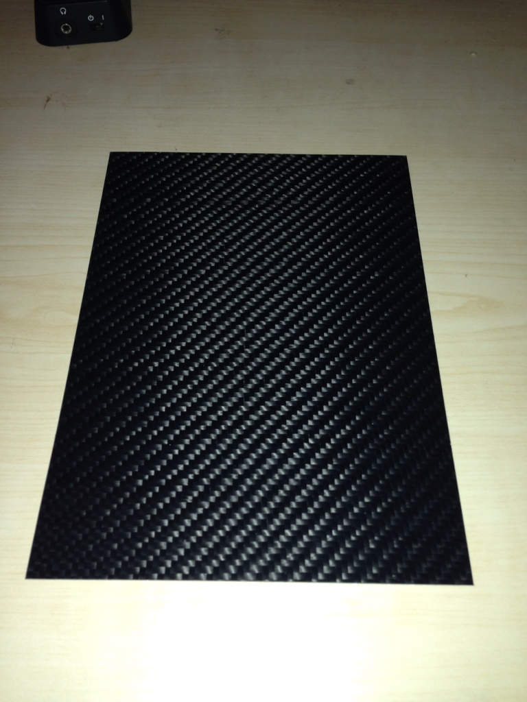

Oh, Im also going to have an attempt at fitting an S2000 Starter Button, going to mount it over the Climate Control sensor panel to the left of the steering wheel. The UKDM one doesn't have Climate Control so I'll cover this.
I bought a sheet of carbon to make a template and mount the button on :)
