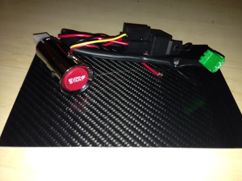

Got everything needed now for the S2000 Starter Button. Slight confession, the Button isn't "Genuine", its part of a complete kit you can buy. Its all nicely hardwired and comes with instructions. At one point I will possibly upgrade to a genuine S2000 item, they are around £50 from the dealer, seem to go for £30ish second hand so Ill see.

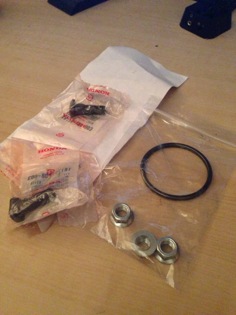

Also popped to Honda to get some Exhaust Bolts and a Gasket, you just know the ones on it after 50k are gonna be a nightmare!

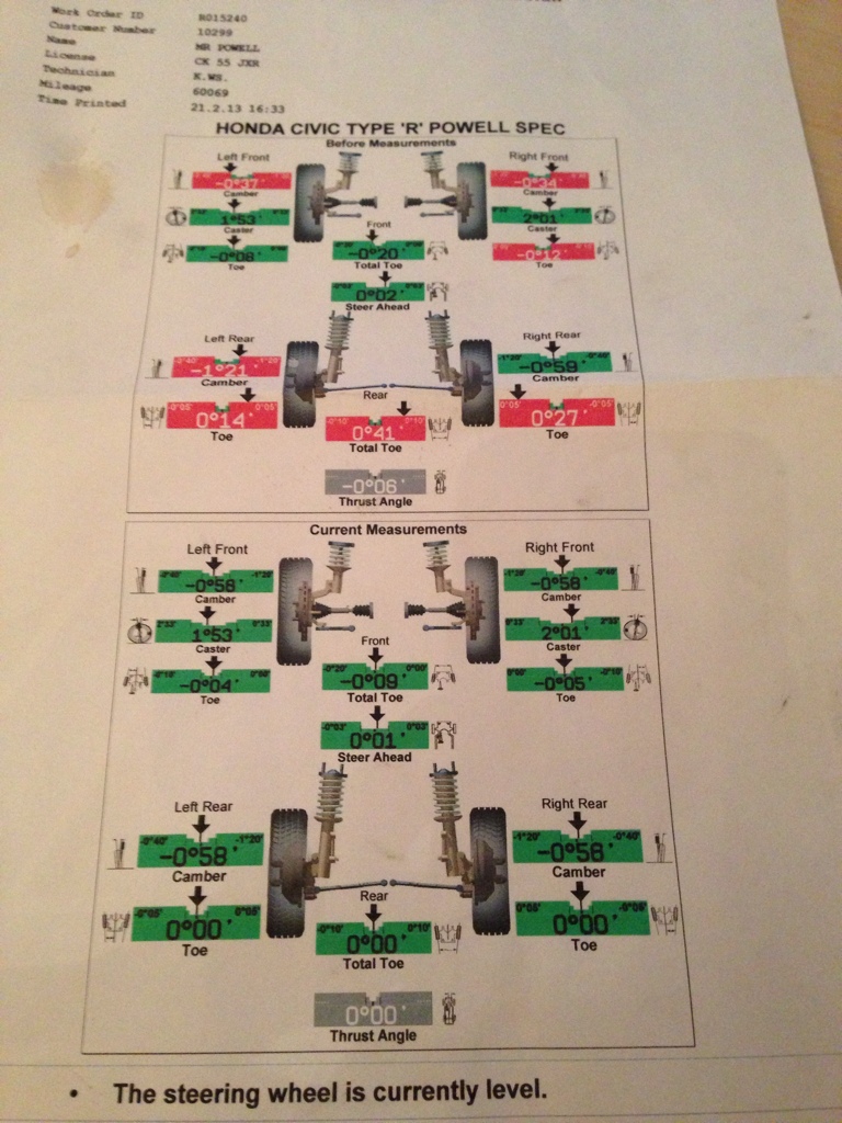

Here's the before and after from the FRSU

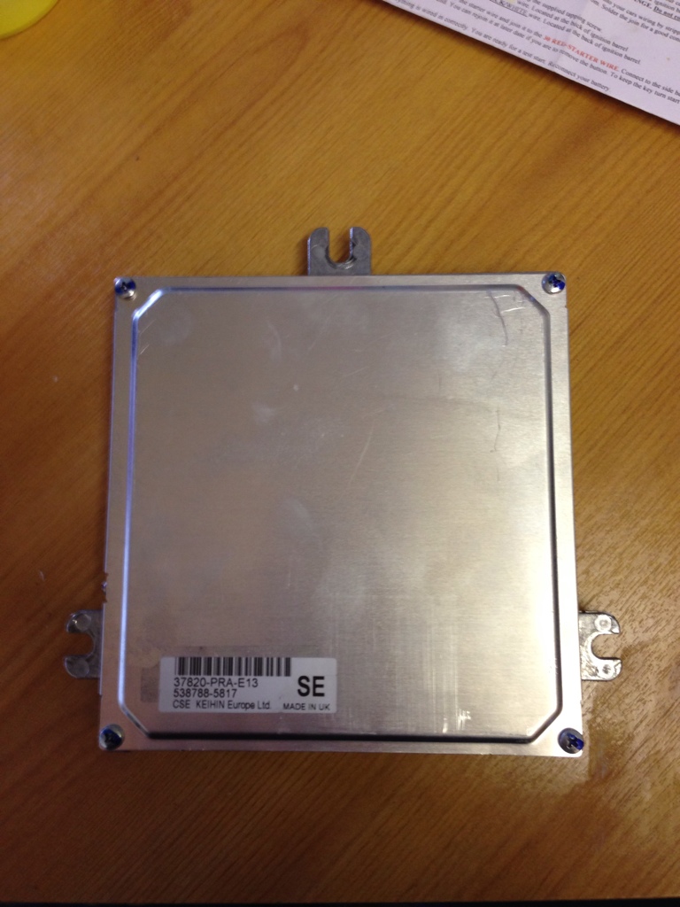

And the paper work necessary for sending off my ECU :)

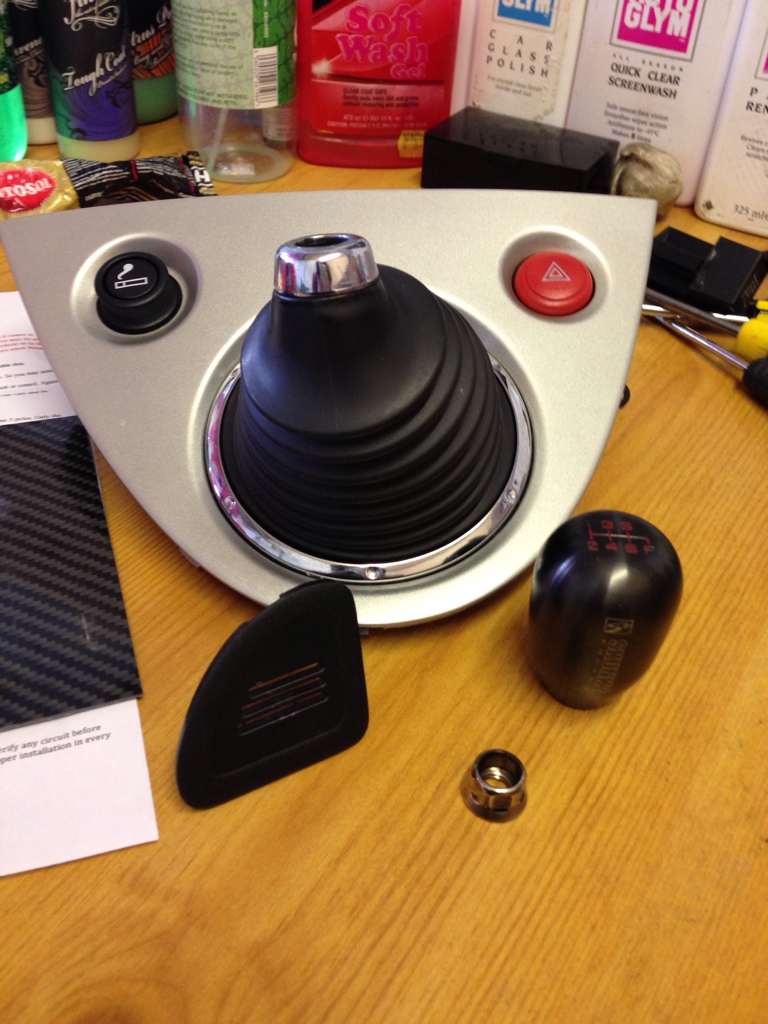

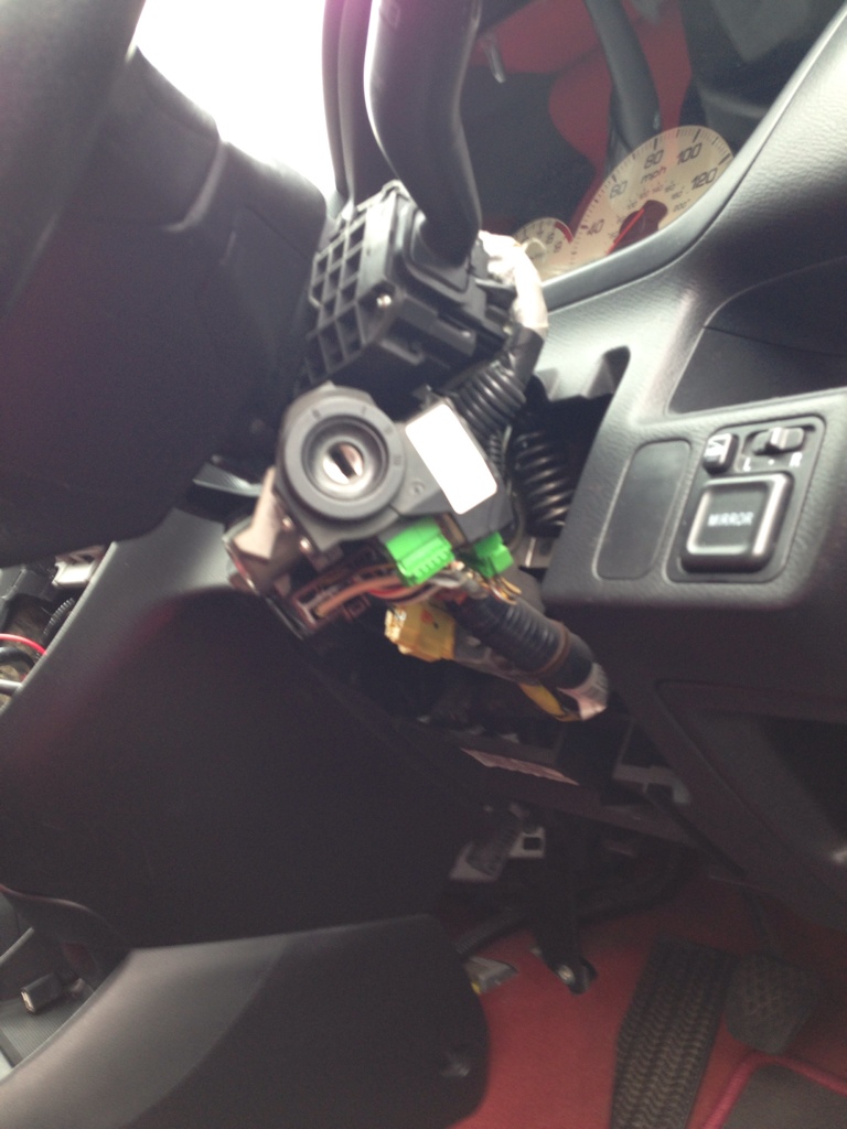

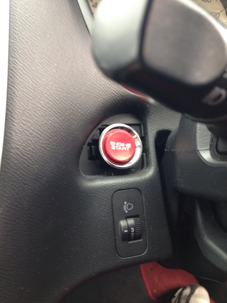

Right well been as the ECU is going off tomorrow, I wont be able to use the car, so I decided to at least start my S2000 Button install:
Started by stripping the steering column cowling and the centre console:

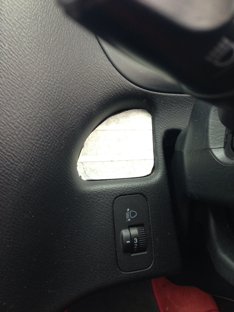

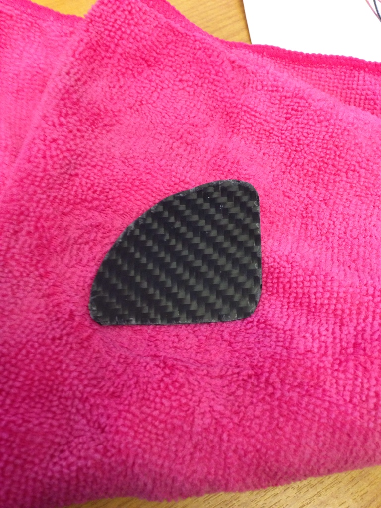

In this picture you can see the Triangular "sensor" panel. Now, the JDM Civic has a sensor behind here to monitor the Climate control, I dont have this luxury so its not needed:

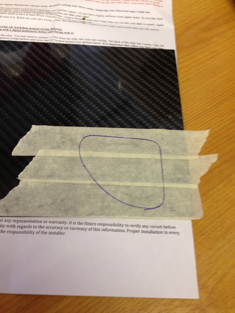

I marked up the Shape needed and had a go at cutting the carbon with Scissors, went well IMO
Here's how it will look:
Little rough round the edges, but a quick sand and a polish and its not too bad for my first ever attempt. I've got plenty spare if I want to neaten it up but it looks fine IMO

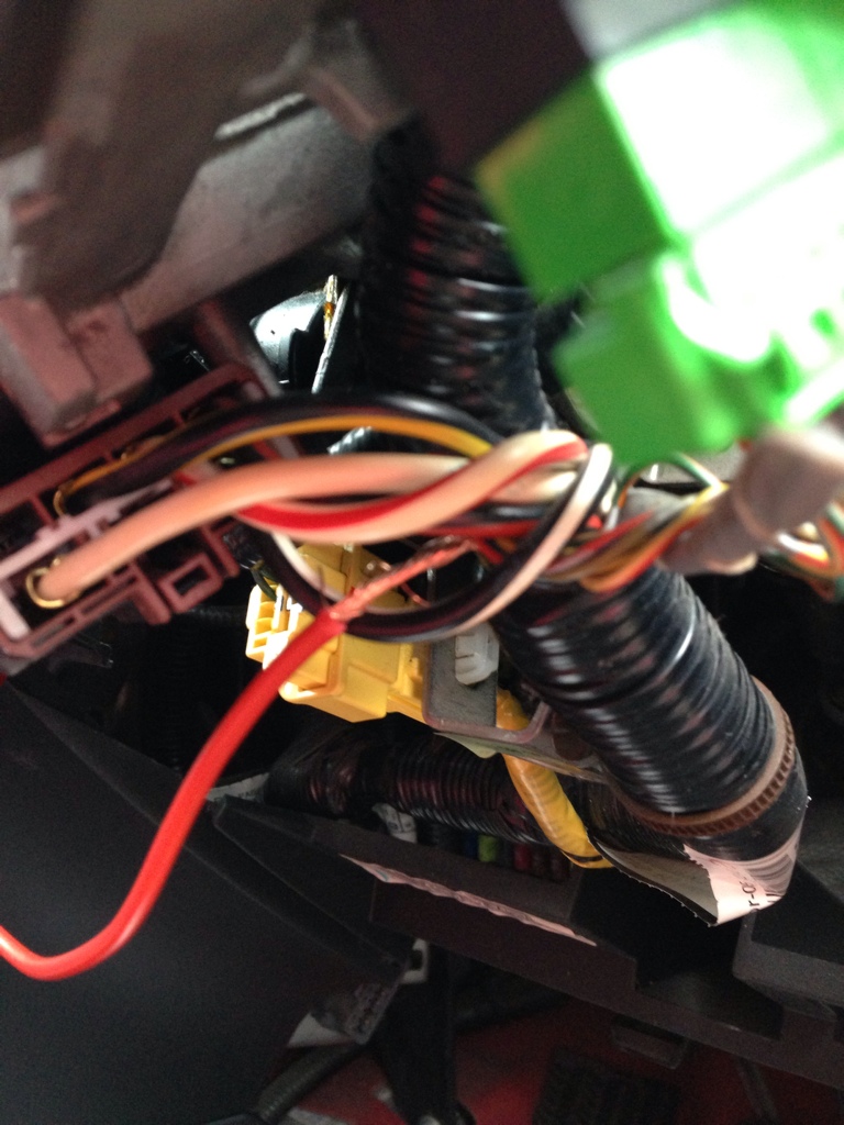

I've wired the positive and negative in so it has power, lights up and clicks, just one more wire to the starter motor and I can start putting it back together, also need my mate with a hole cutter to cut the circle out in the carbon. Will look something like this when done, but with a carbon surround!
Gotta go food shopping now so cant finish :( Boo!
Did a bit more, got power to the switch, and put the centre console back together :)
Just need to link the red wire into this black and white wire now and put the cowling back on.

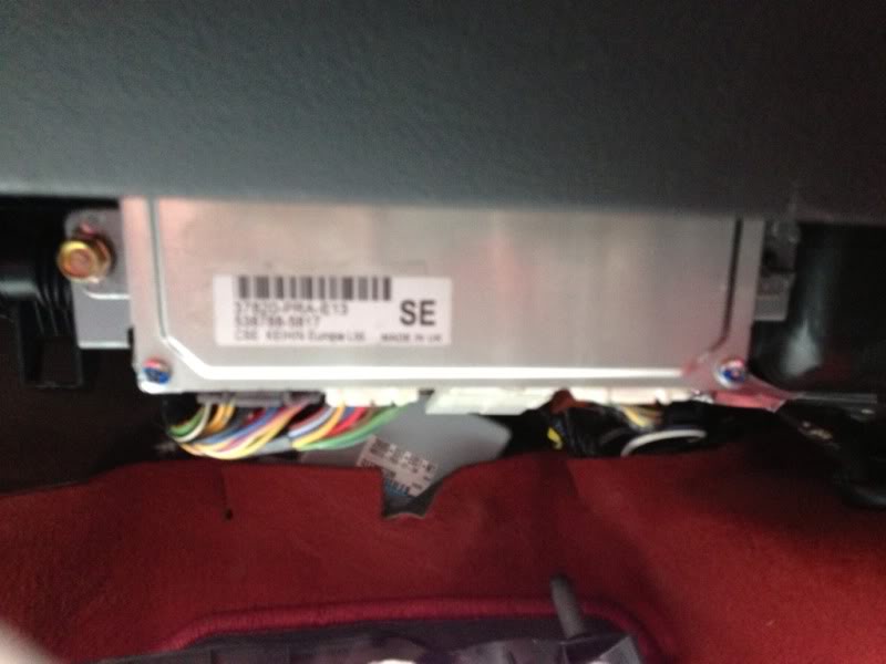

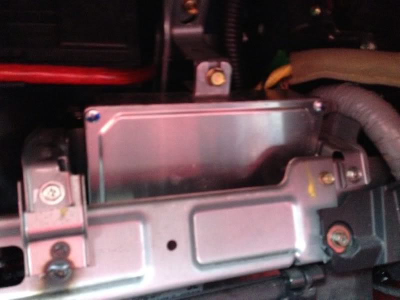

I then started taken my ECU out for the reflash tomorrow. Simple job, disconnect the battery, undo 3x 10mm Bolts behind the Glove box, undo 3x Plugs, all done :)

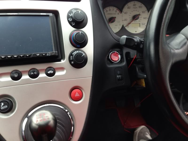

Good job looks good. Considering fitting a push button start to my Fiesta ST.
Danny_172 said:
So do you need to put the key in the ignition, turn it, then press the button?
Yep i think so, turn to position 2 then press the button.
o
Its the most pointless mod Ive ever done, yes you do need to turn to stage 2 ignition then start. TBH the way Ive wired it I dont have to use the button, its a novelty I know.

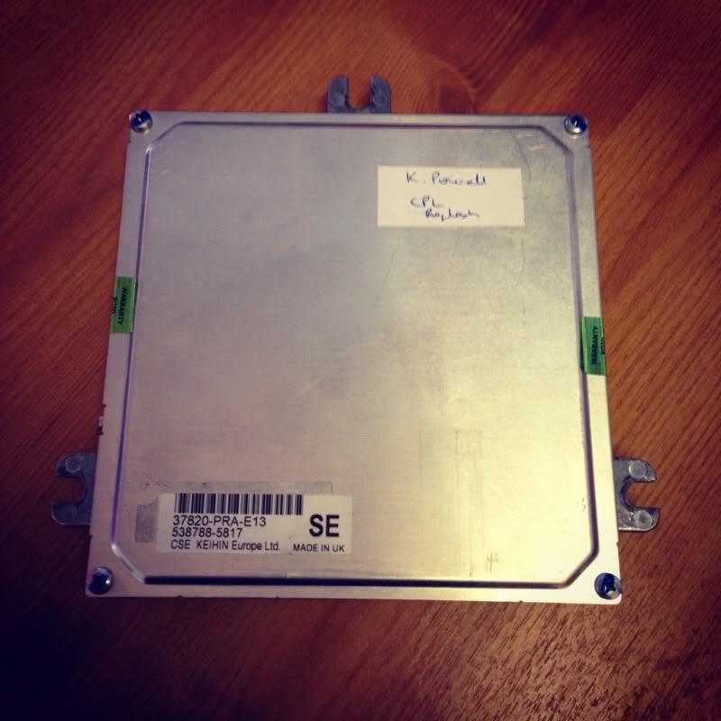

Right as you know I sent my ECU to CPL on Monday at 11am.
I got an e-mail off Lynn yesterday evening with the Tracking Number for my reflashed ECU. I kept tracking it, and it was going to arrive before 1pm today. Now I started work @ 1pm, and wanted to take the car, and it needed fuel, so time was against me.
I decided to take the forum stickers off, they were a bit big and will be replaced with smaller ones:
I put the R on the daily, as a joke, its off now ;)
I then needed to finish wiring the starter button, or at least connect the stock ignition wire back. I took a trip to a local electronics place to pick up some connecters and put the cowling back on.
Then at 12:05 this little beauty turned up :)
I cant open it to show you as it will Void the warranty, the only difference on the outside is my name is on written on in Pen lol. Out of curiosity (and to stop some bitchin' on some forums), I emailed Lynn to ask what ahs been done. She confirmed that inside the ECU there is a K100 Board, just with a generic map on. IF I went all out with further modifications, they could remap this, without the need to buy a K100 or Kpro. Just pay for the tuning, amazing deal IMO, I've basically paid £40 for a generic map, with the option to get a full map and expand in the future!
I quickly fitted it, took all of 10 minutes and then wired up the negative. I turned to stage 2 ignition and pressed the button and it started first time :) Was more surprised the button I wired up worked TBH ;) I let it idle for a bit whilst I reprogrammed the radio stations, then drove to the local Shell Garage to fill it up with V Power. It immediately felt "punchier" even before V-Tec. I let it warm up and went the long way to work to give it a test.
I must admit I wasn't sure what to expect. All I have right now is an air filter, the exhaust isnt fitted, so this is pretty much a standard Type R, running a generic "budget" map, really its nothing special. Once warmed up, I took it down the dual carriageway to see how it went. It is certainly MUCH faster than before. I have no dyno figures or anything to back this up, but there is a definate increase in Power THROUGHOUT the rev range. It even picks up @ low RPM in 6th gear. The one thing I will say is the Stock Type R to me was a very jekyl and hyde car. Pre 5800rpm, it wasn't very fast at all, even for a 2.0. When you went into V-tec you felt a kick and away it went. The V-tec engagement point is now 5200rpm. However, I believe in the standard Type R, the ECU cuts the power slightly before changing cam and you "feel" a quite abrupt kick. This "kick" has gone, it just goes. You have to be checking the Speedo/Rev limiter to see where it changes, and when you concerntrate you can feel it, but its not as abrupt as before. The speedo however confirms that you're going much faster than before. The change from Low - High cam is absolutely seemless in comparison to stock.
