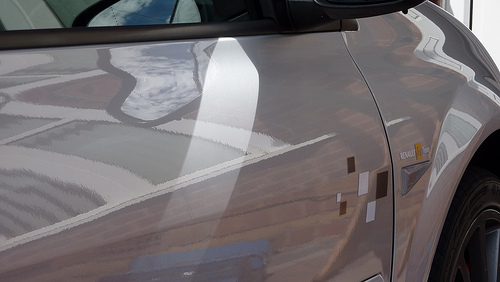

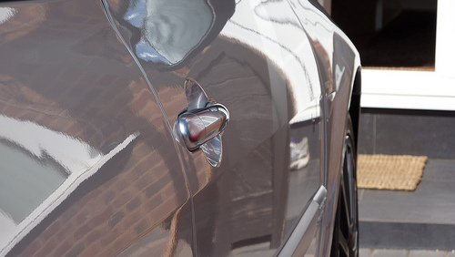

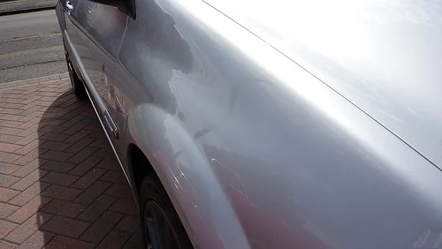

Some afters... not bad for silver me thinks!
I just wish Zaino beaded a little more... probably my best finish so far on my car. What else is worth a bash on silver?

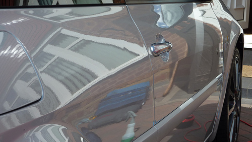

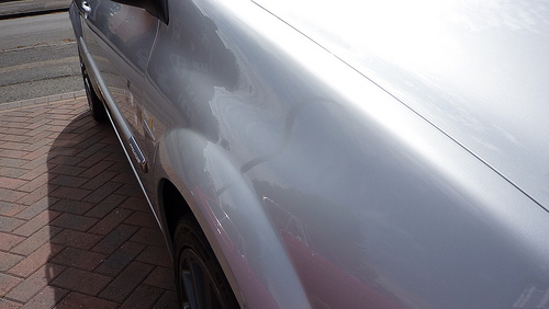

Steve... not many good pics :(
Here's one cheeky one!
  Megane R26
Lol, trust me there are no swirls after FCP!! ;)
You're one to talk anyway!!! Your last write up didn't have any direct shots did it?? ;)
Agreed! Tyres look pretty new (tread colour wise) as well, so presumed as much. Looks well chap! Correction or enhancement etc?
  Megane R26
RDS removal frenzy then enhancement. It had a good 20 deeper scratches, but the paint was only 100-120 microns all over! I've definitely mastered RDS removal after that though!!
Zaino Z2 and Z8 to finish.

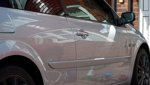

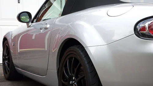

Pro Race 1.2's!! They looked sweet against the silver paintwork:
Got anymore photos Russ?
Looks amazing, really changed the colour.
Must of been dirty lacquer.
Been on since Feb done several trackdays, inc Silverstone 3 days ago.
