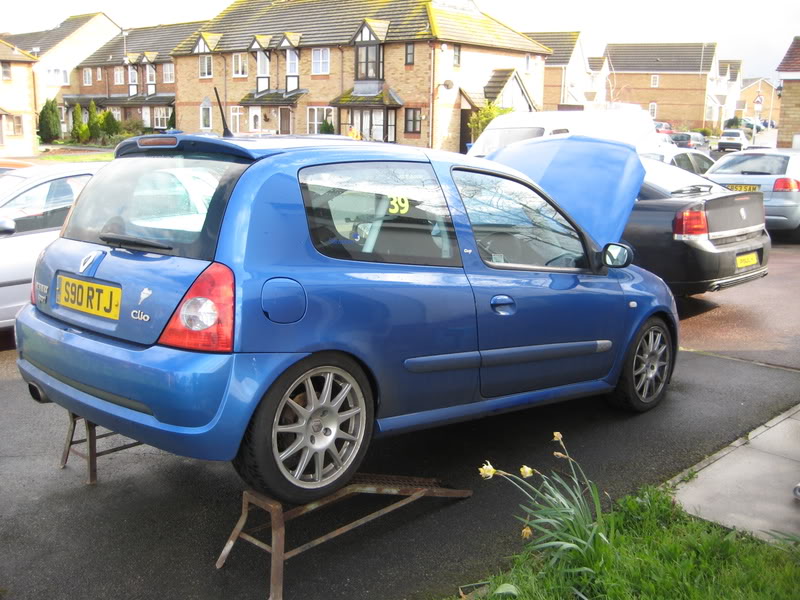

I managed to limp the car round to my bay and reverse it on the ramps, got half way up and the release bearing caved in and stalled the car, therefore no drive to reverse the whole way up!!! Managed to find some ratchet straps, attach it to my mates front tow eye and get the car fully up on the back. This was the progress from last weekend...
Always good with a little help from ya buddies...

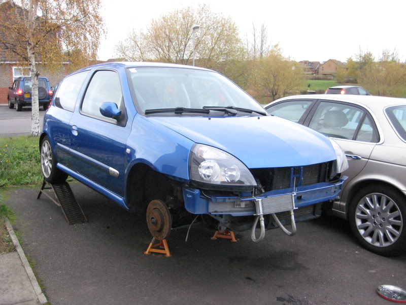

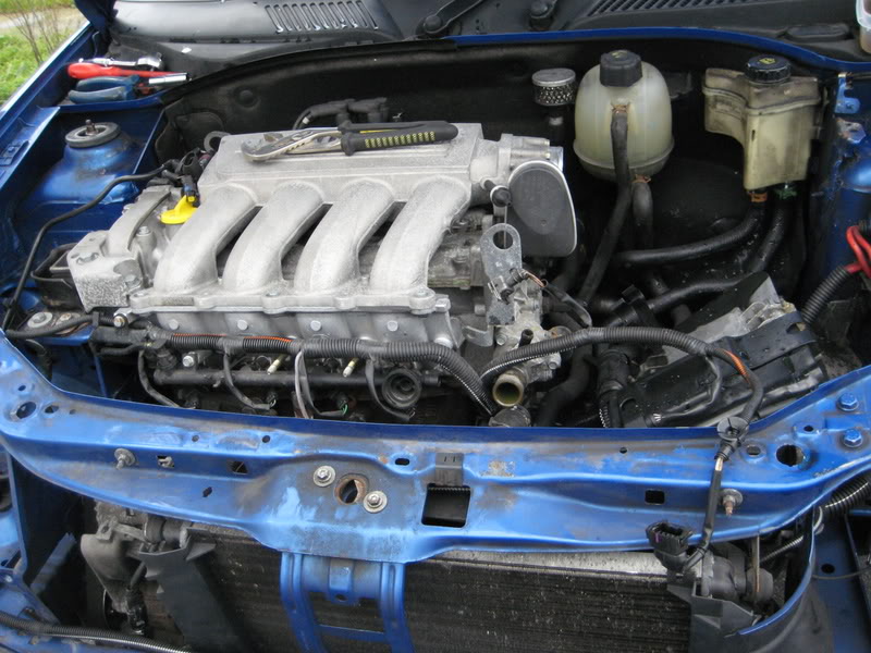

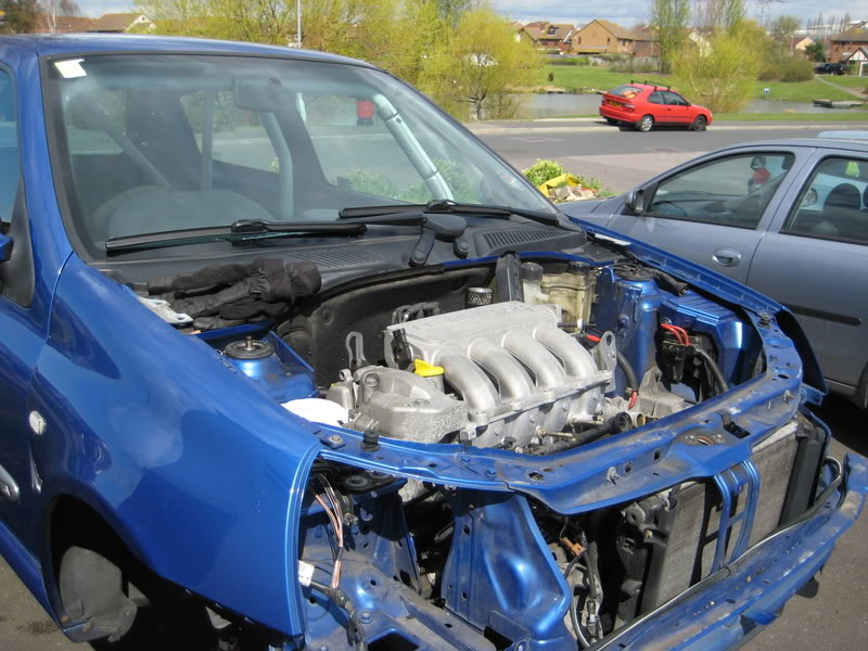

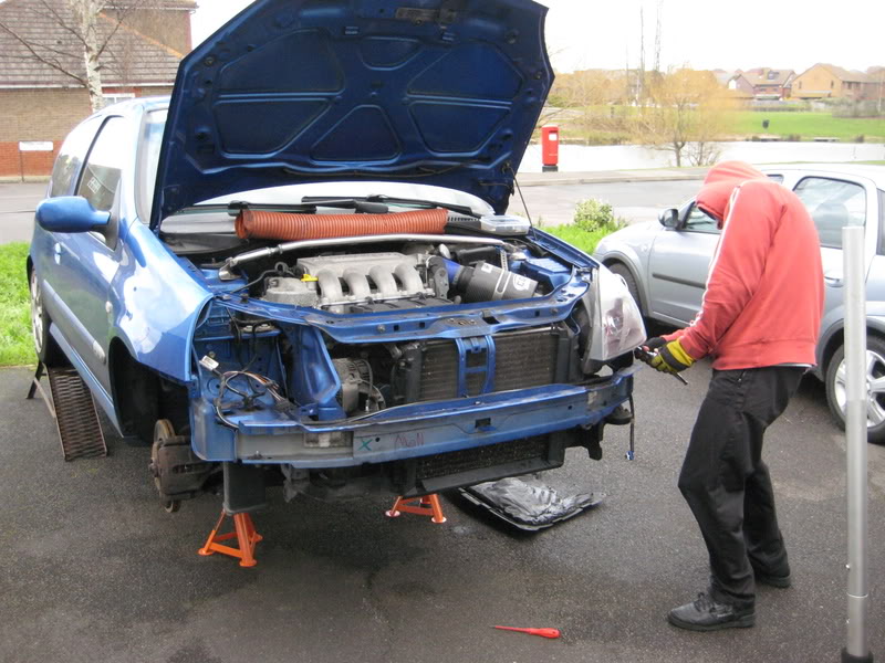

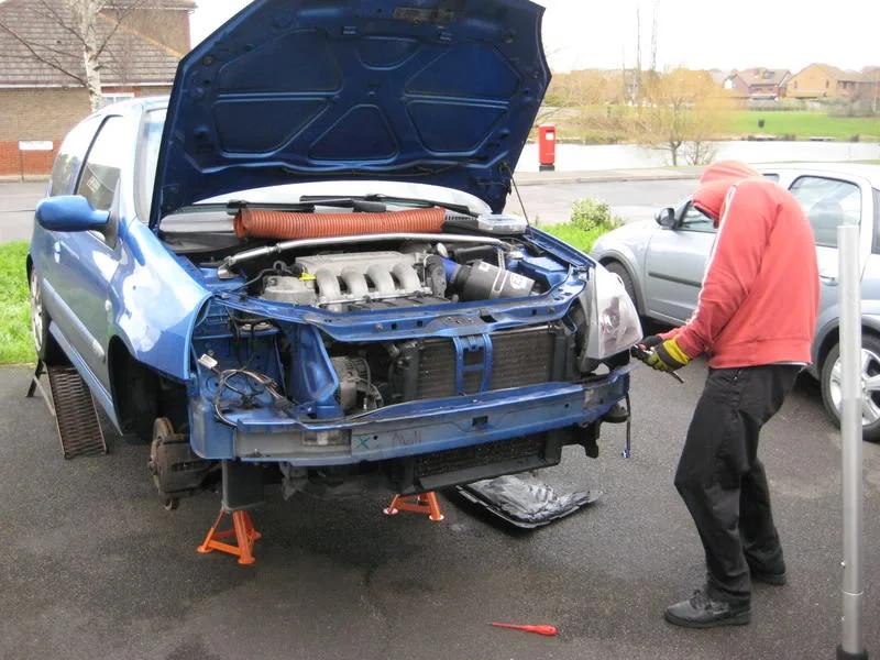

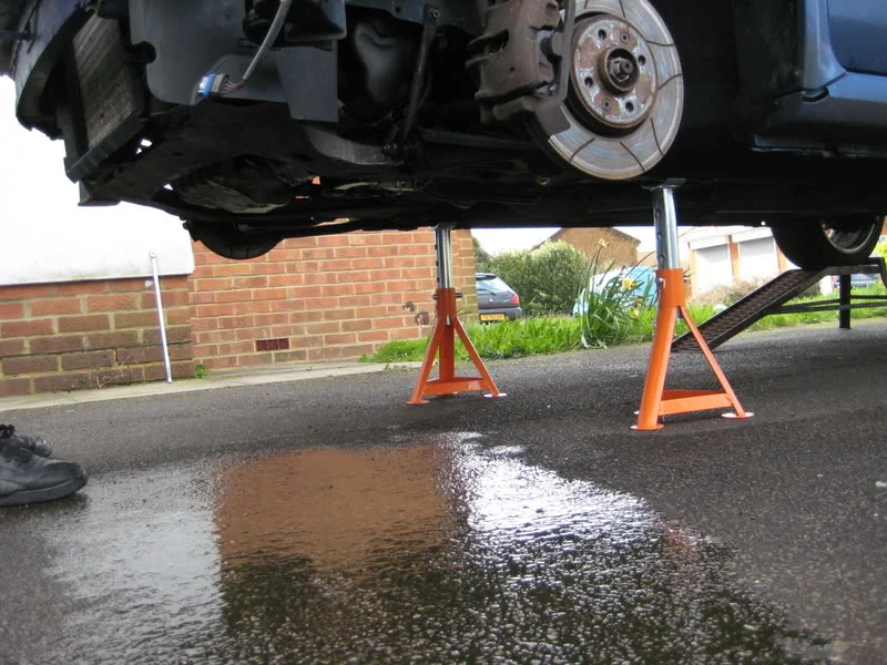

First port of call was to start stripping the front end off and start disconnecting the various pipes, clips, sensors from the engine..
Front end..

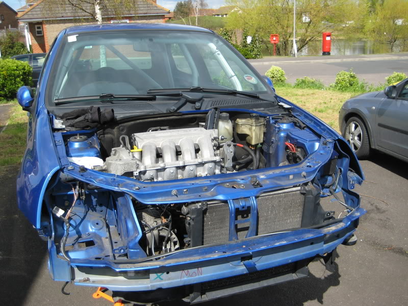

Engine lookign bare..
Collant being drained..

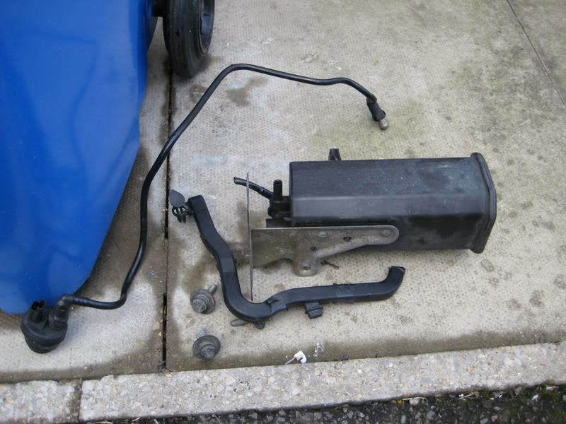

Carbon canister removed..
All tucked away..

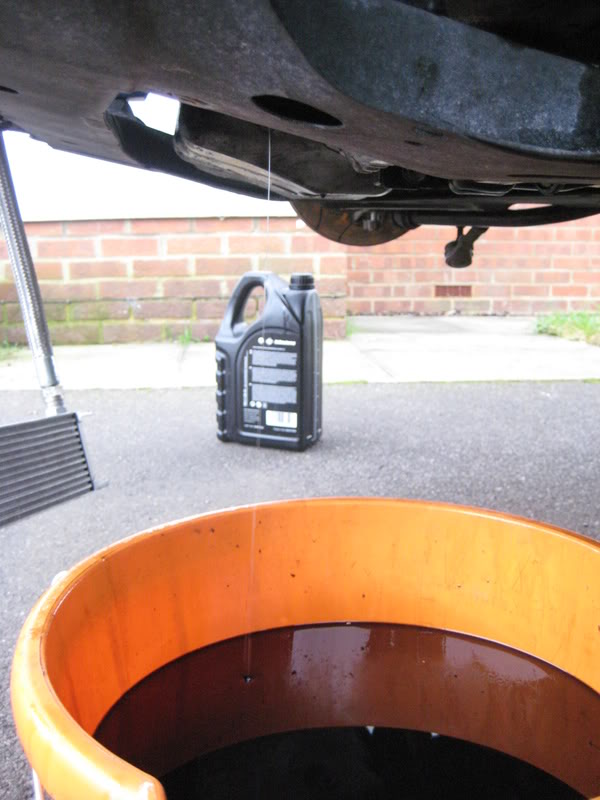

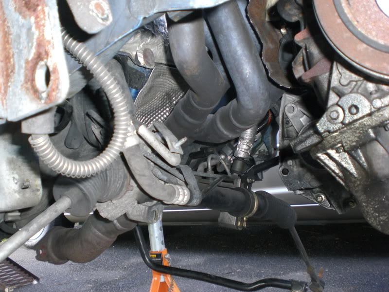

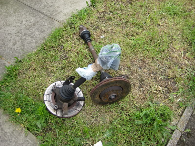

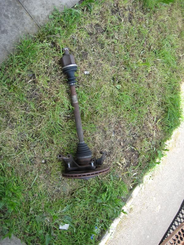

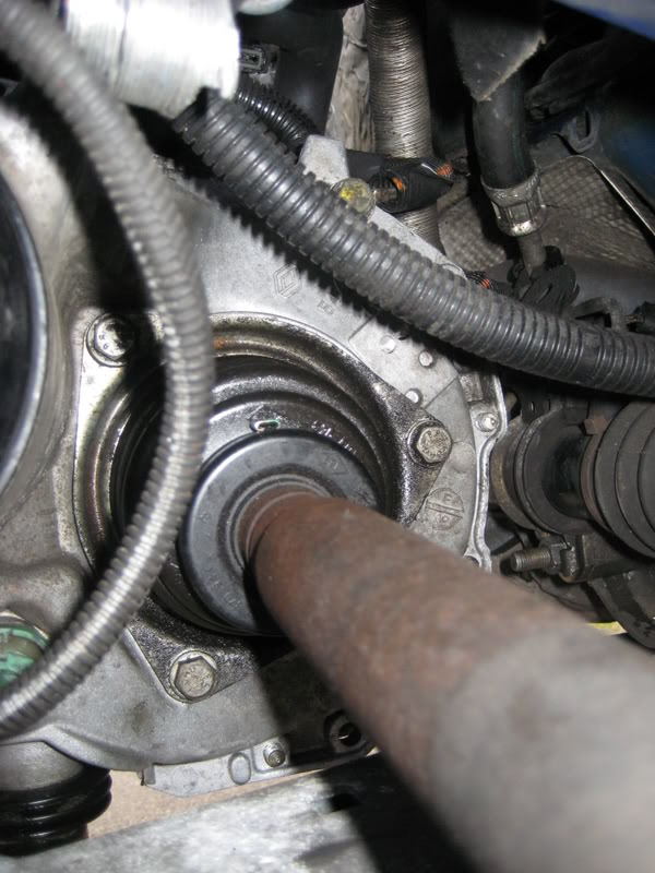

The gearbox oil was drained and the driveshafts, hub assembly and discs were taken out
Then we took the bonnet off, not really necessary but made moving about in the bay a lot easier! Can’t believe how bare it looks….!

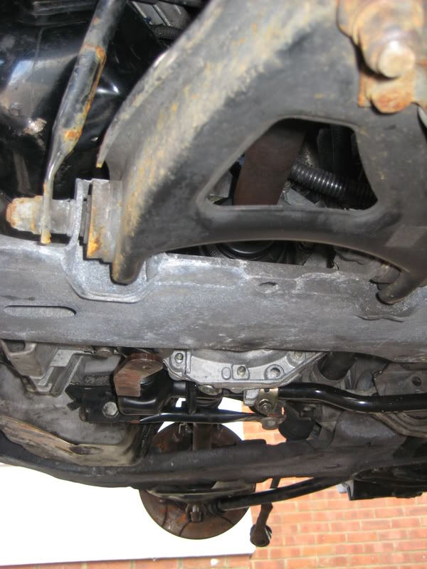

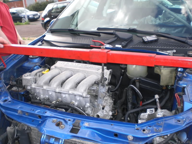

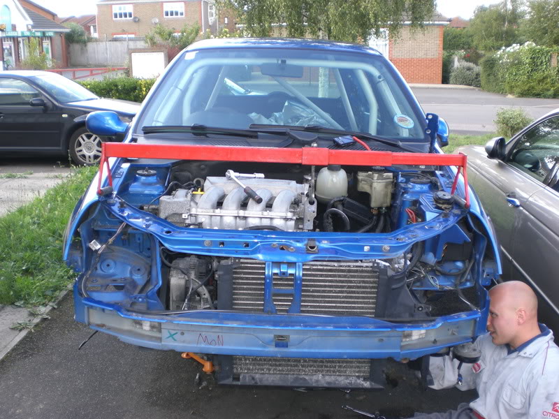

We cracked on after a tea break and aligned the engine brace so we could get the subframe off, undo the gearbox mount and drop the box out.
Engine brace
Subframe off

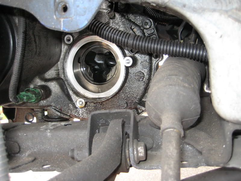

The last job before we dropped the box out was to undo all the bolts holding the gearbox in, make sure the gear linkage was clear so it didn’t get bent and then undo the gearbox mount…..
And hey presto….it’s out!!

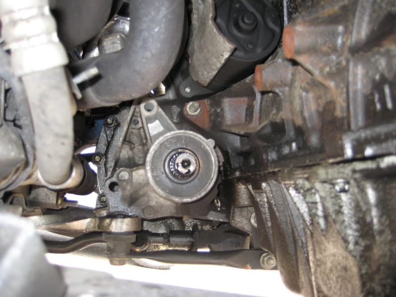

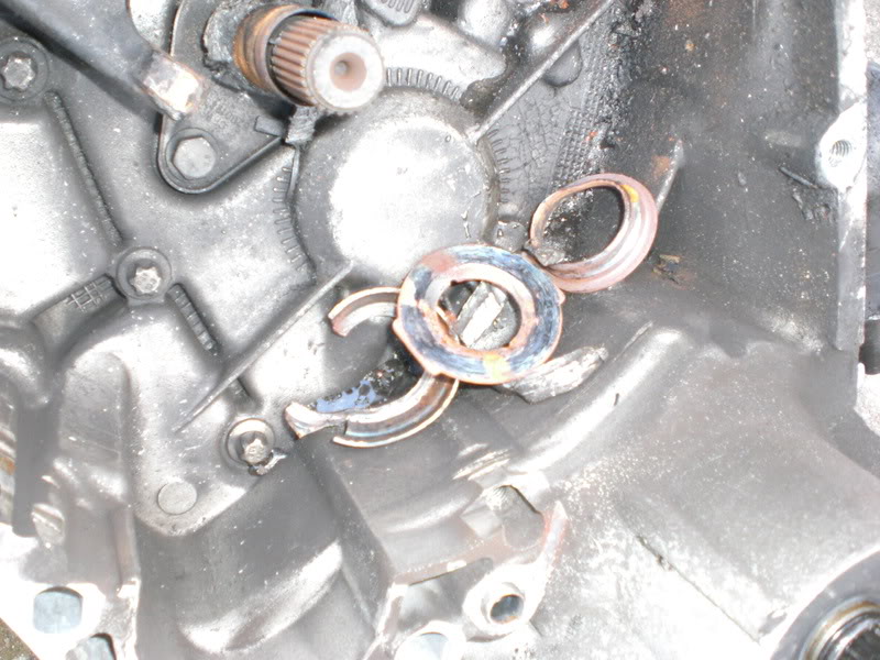

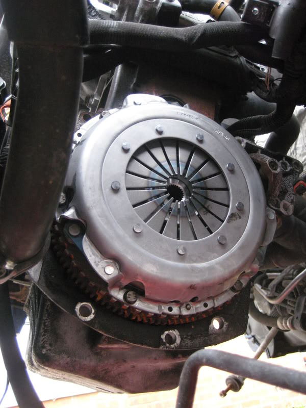

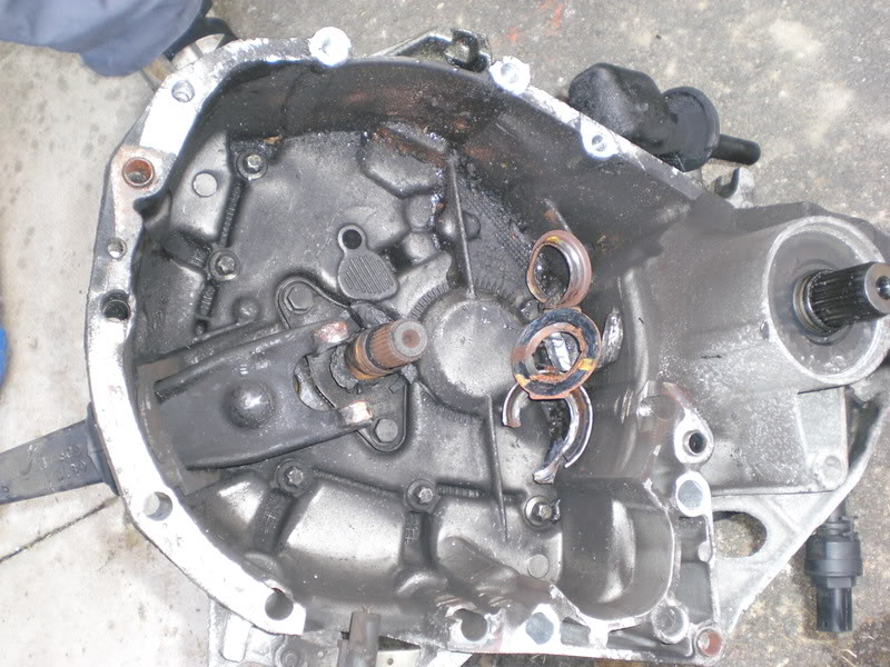

You can see the remains of my release bearing…in pieces! The input shaft needs replacing as well as the bearing has made dips on it where it’s failed!

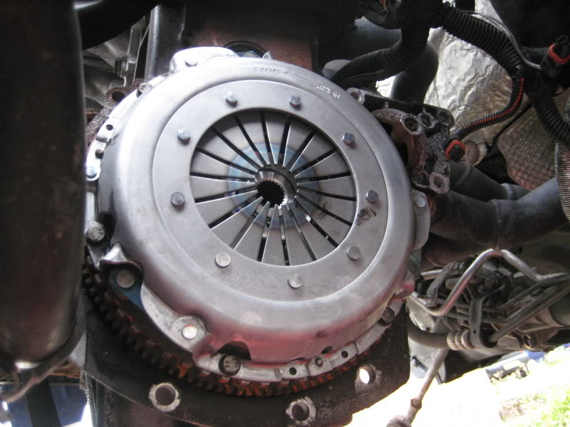

Also took the clutch out, the clutch plate was fooked, again where the bearing had failed, the plate looked ok, but didn’t have that much left on it!
So there we are…I’ll put some pics up later of the clutch cover. Hopefully should be up and running again soon!!

the gearbox is being dropped back from the repair HQ today already to be put back in, the list of what was wrong was....
3rd gear selector fork
2nd & 3rd gear syncro
spigot bearing
nose cone needed to be replaced where the release bearing failed
That was it! So it's all lubed up and ready to go back in...need to get a clutch first!!!

Driveshaft’s put back where they belong
After the driveshaft’s where put back in and all hubs bolted back together, we hooked up all the plugs/sensors that where originally all taken off to aid access.

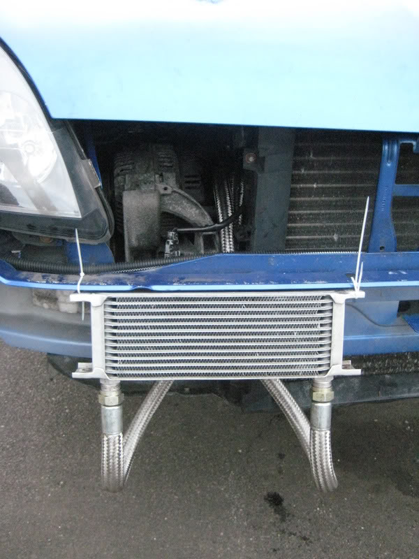

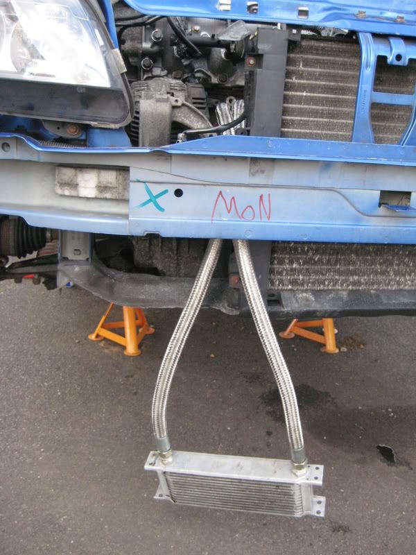

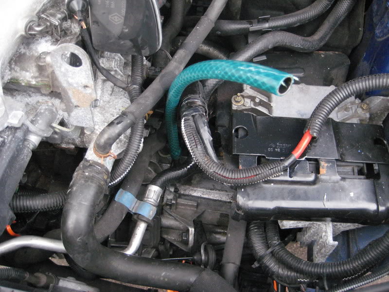

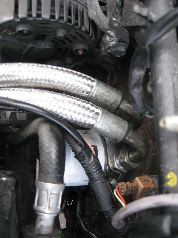

Once that had been checked and double checked we set about installing the oil cooler, nice and easy job, although we’ve got the ghetto cable tied look at the moment until I set about bolting the bracket up!
Put the new engine oil in and filled the new gearbox up…with the help from a bit of old hosepipe!

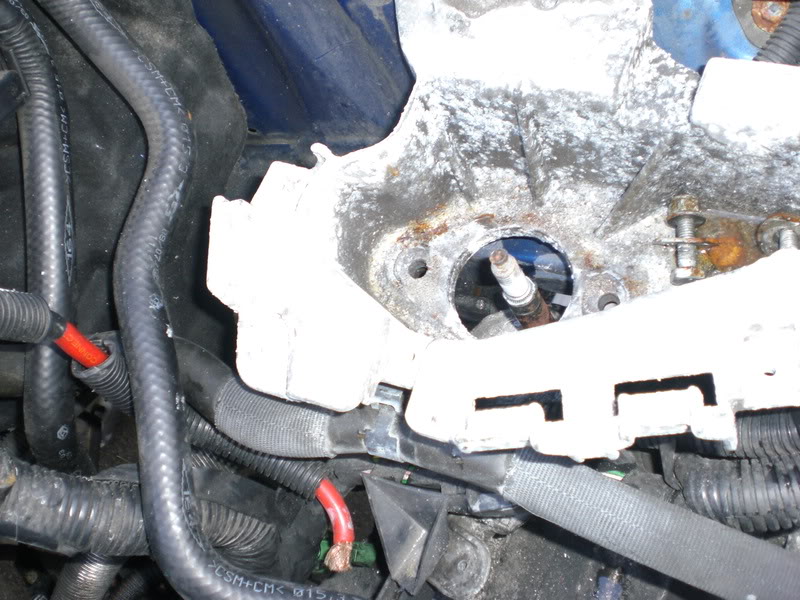

It spat and spluttered into life, although with a misfire, doh!!!! With it popping and banging and idling about 2k! I decided to turn off and check the regular (plugs and leads).
They were screwed! Where the rain, frost and other rubbish had got into the bay from the split in the cover, gloop had turned the leads to rust as well as the top of the plugs! So no wonder it had a misfire, surprised it even started after that!!
Quick visit to the K-tec website, and 2 days later and brand new set of magnecor leads and NGK plugs landed at my doorstep (picture to follow….)

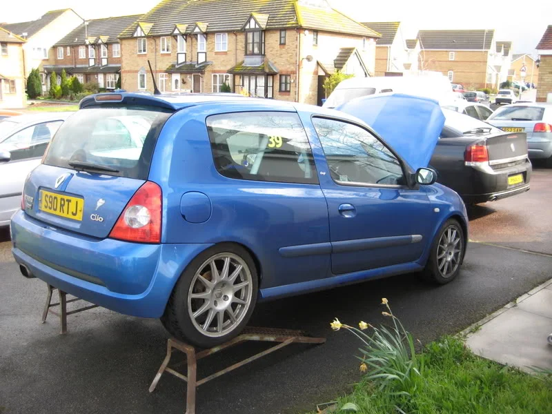

Here's what the car looks like at the moment..
