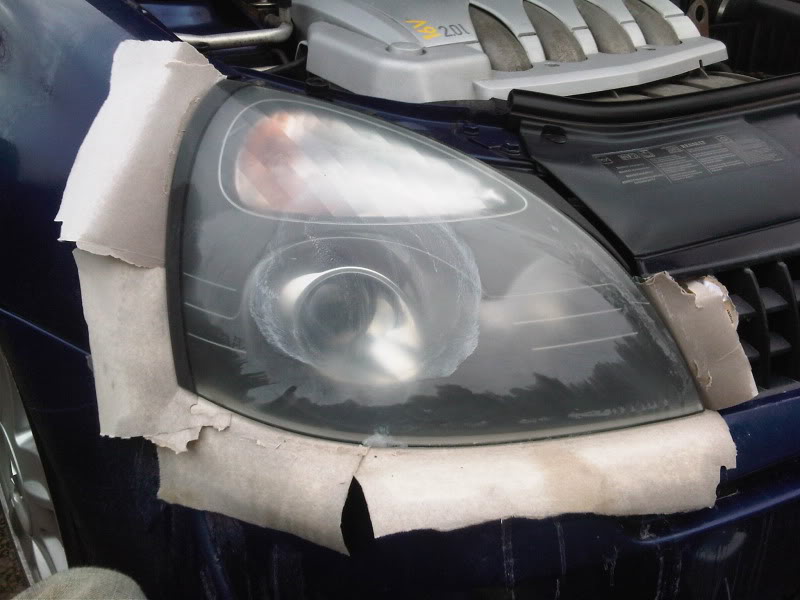

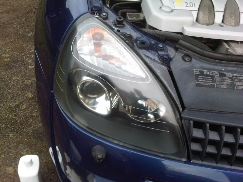

headlights faded and crazed (self fix)

What did you use on the lights, I had a Celica with faded lamps and used a deglasing paste and come up good as new. tried the same on my cup and hardly made a difference :(

I followed the guide on here, wet sand using finer and finer paper, then scratch remover, then a good polish up. I'm finding give them a good polish once a month keeps on top of them.
