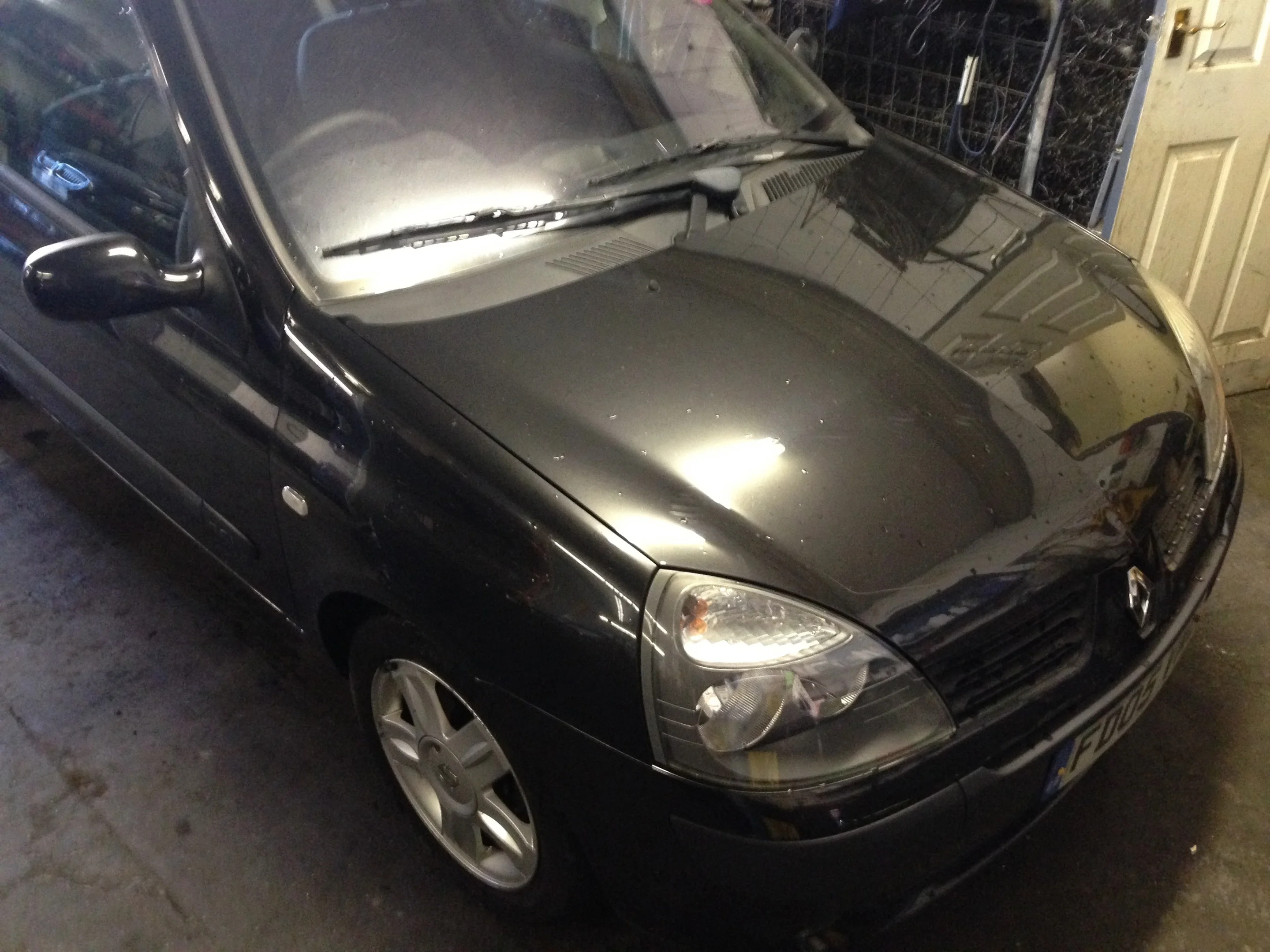

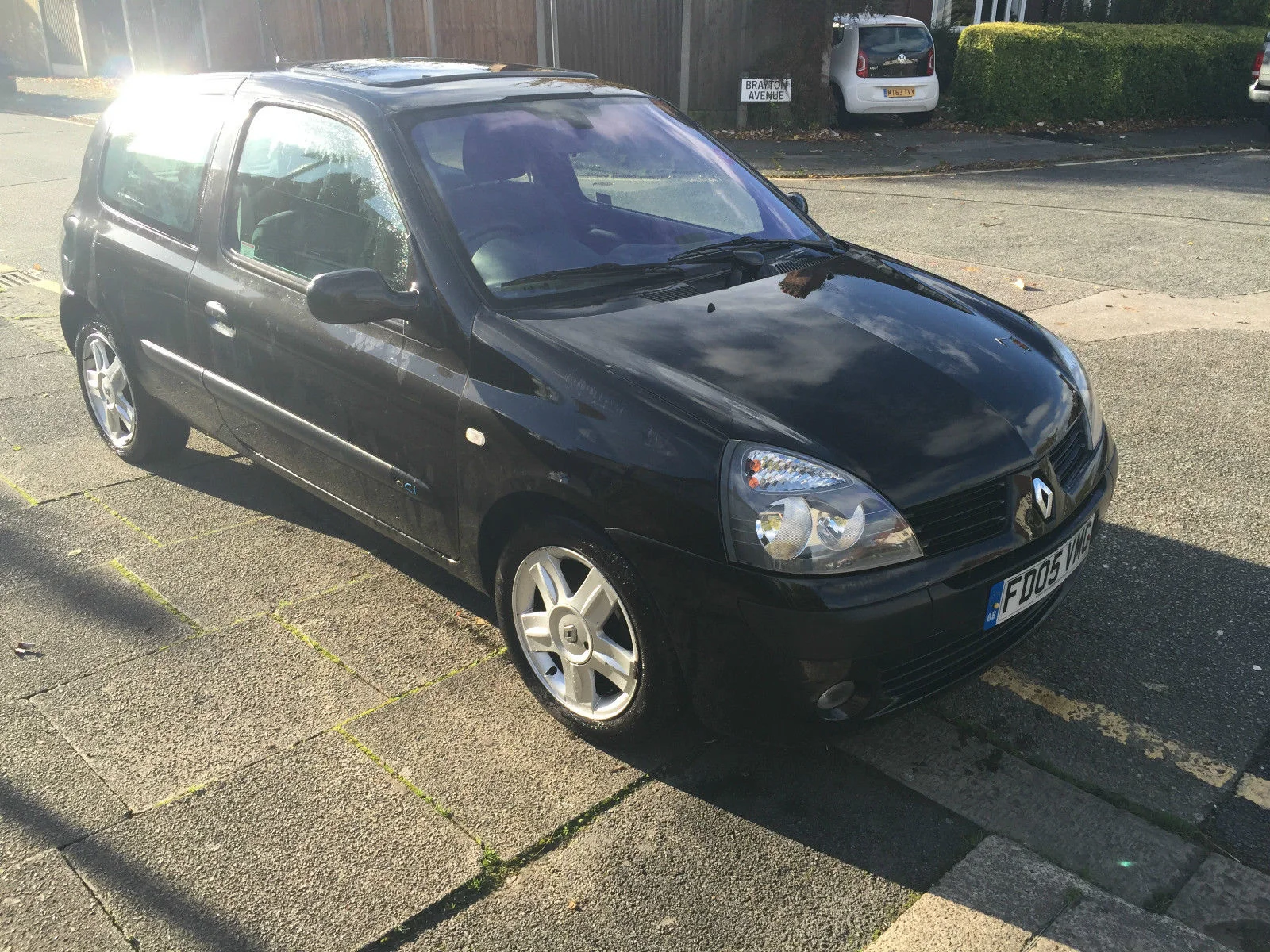

This was the photo off the eBay ad.
It's had just 1 lady owner from brand new, done 86k, has full service history and almost every MOT certifcate since 2005. oh & 10 months MOT still.
I bought it needing a lot of work. The aux belt snapped one day whilst she was out shopping and took out the cam belt with it, bending a few valves. Previous owners had the belts replaced at their garage and got it up and running again but thats when it occurred that some valve damage had occurred, so they gave up spending any more money on it.
I offered a real low-ball compared to the asking price and to my surprise her husband accepted straight away. (oh s**t, I'm at uni in Leeds, struggle to find space to park one car let alone two!!)

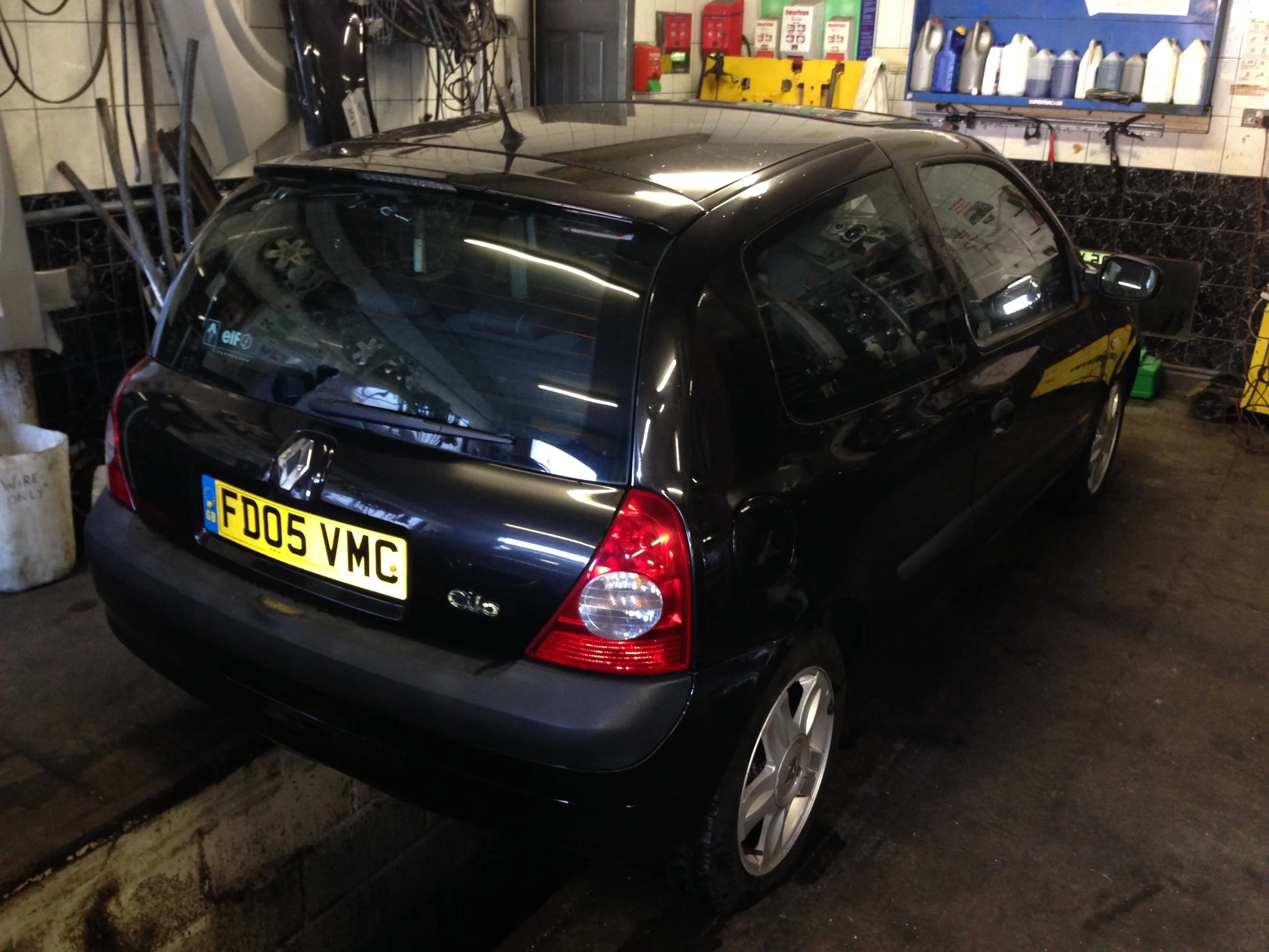

Anyway, went to pick it up the next day with my mechanic from the garage next door to my uni digs, on his transit recovery truck.
So this is where it's spending all of christmas. He's got the head off and it's been sent off to be skimmed and have 3 new valves etc.
It's going to be a hefty bill as I expected but will still work out a cheap dci 100 considering what I paid for it in the first place.
Fingers crossed all goes well putting it all back together!
