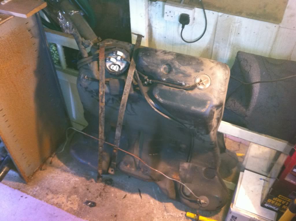

Got the rest of the remaining parts off now. Fuel tank, heatshields, coilovers, rear bumper/lights and rear brake lines.

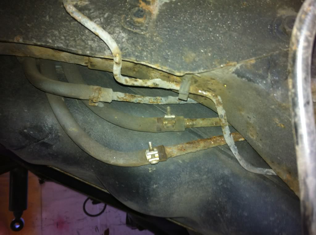

Took a photo of the fuel lines for future reference...
Tank and straps off. Left the filler thingy on, the bracket was just twisting rather than the one crusty bolt loosening.

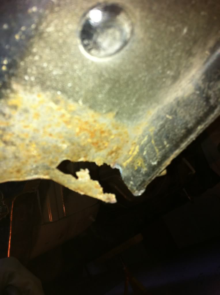

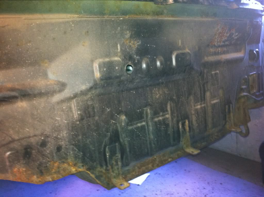

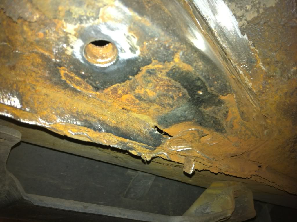

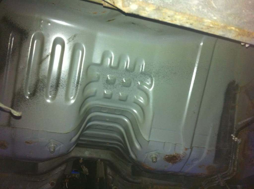

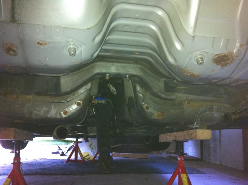

Was surprised with the rear half TBH, seems the sills will be the worst. Some condition shots.

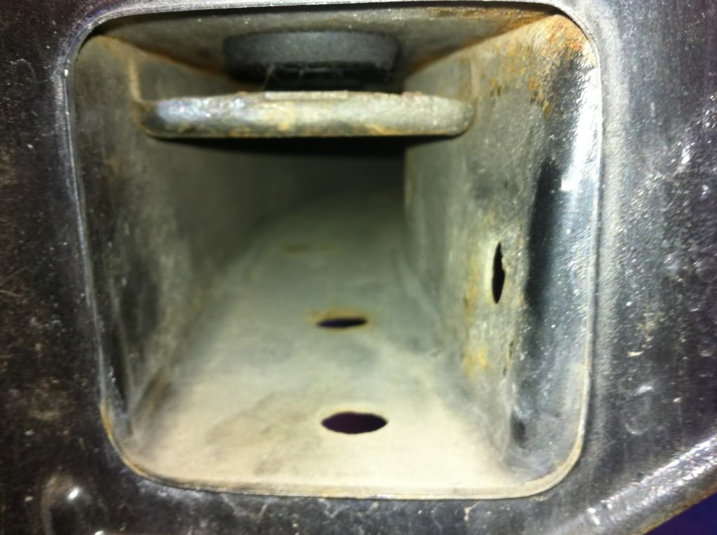

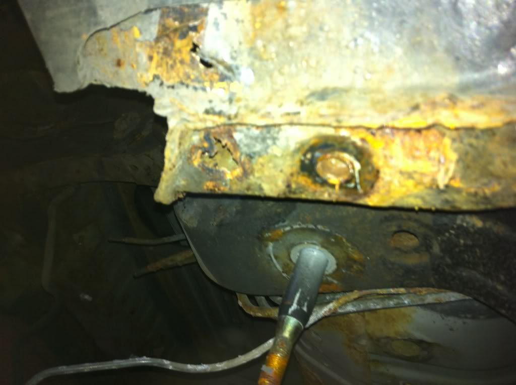

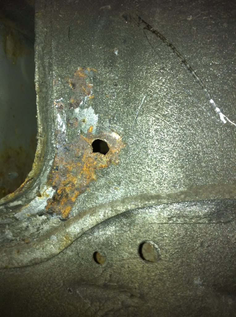

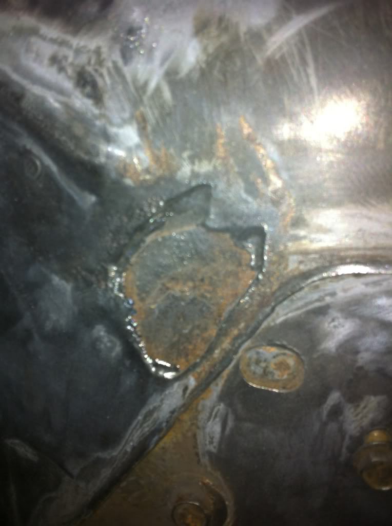

Just poked 2 holes into the sill area, right next to one of the bloody subframe mounting points. Awesome.

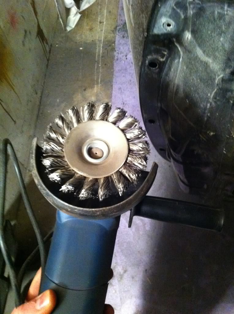

Why not get a wire brush on an angel grinder, took mine of in a few seconds when I did the SX.
  Evo 6, E92 320d
I did use a pretty heavy duty brush, the biggest issue was getting right into the groves to clear out the old seam sealer, that stuff is annoying.
  CBR1K, F21 125D
Messy f**king job whatever you use.
I used Some heavy duty gunk type stuff then let it sit then pressure washed off.. still needed to wire brush it after :(

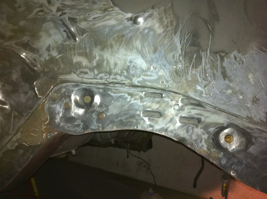

Decided to f**k this scraping off, banged this into it instead...
Which results in a lot of dust...
Unfortunately, I'd spent a lot of time at work today using a grinder. So after 2 hours and lots of cramp, I only got this far...

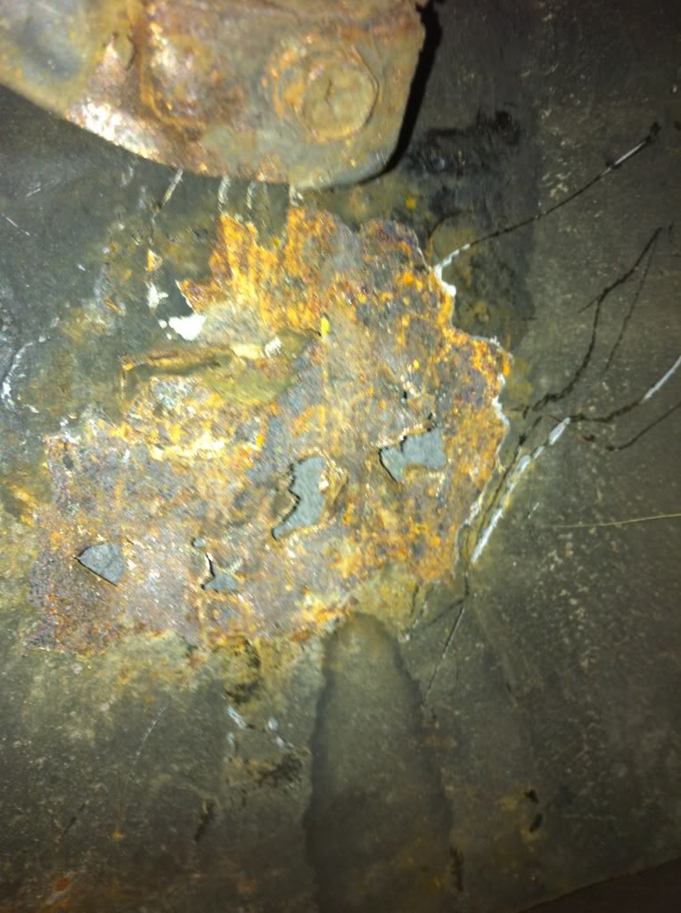

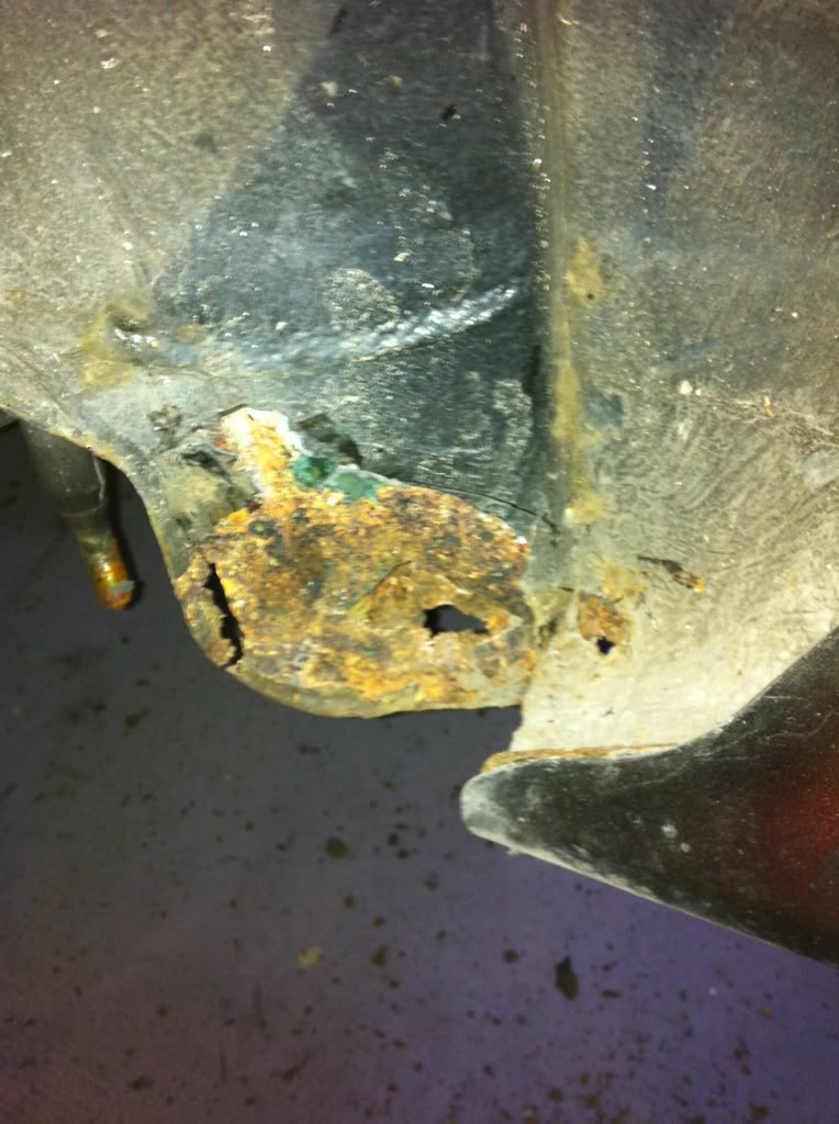

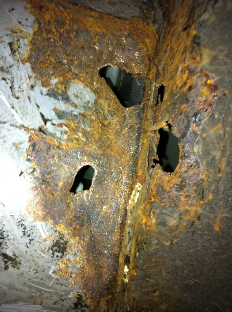

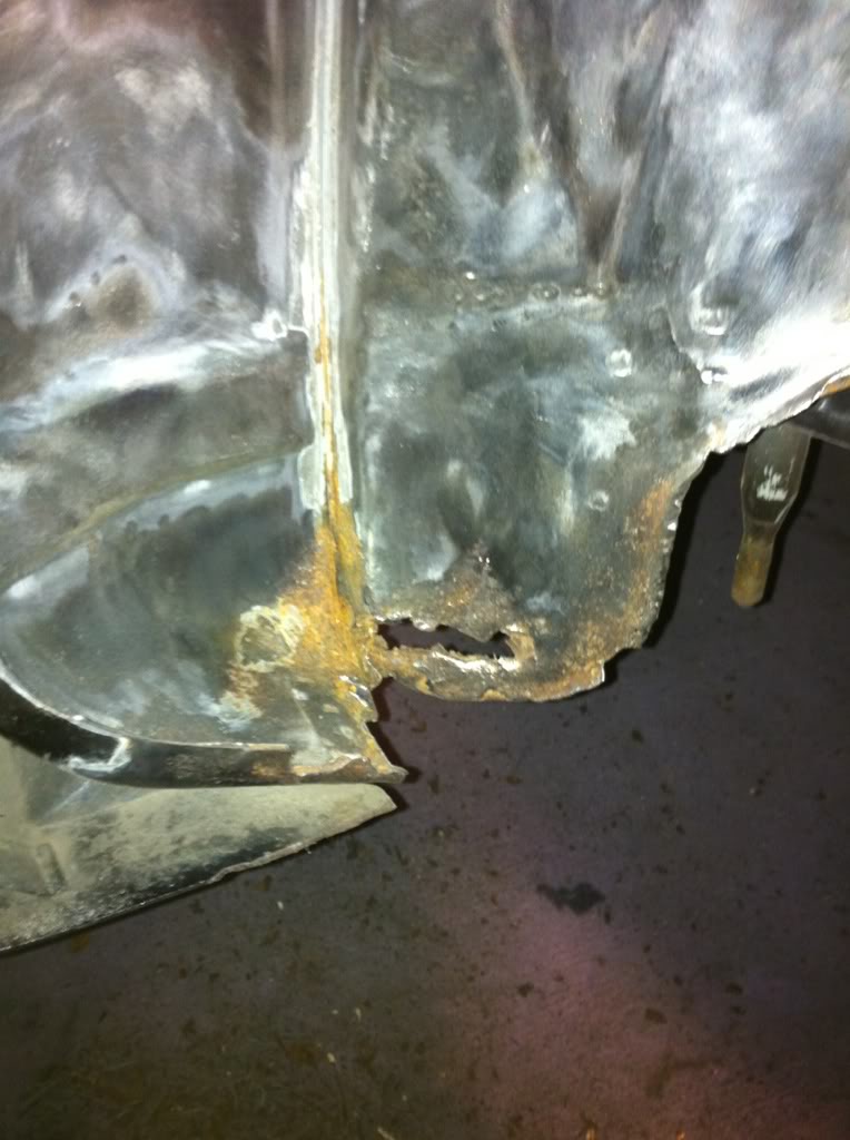

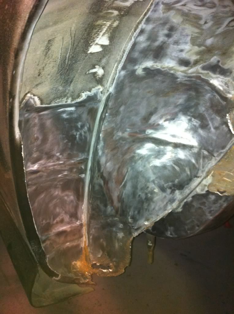

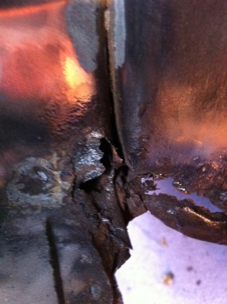

And the areas that I've found to repair so far...
My welding skill (or lack of) is nowhere near good enough for such an intricate repair in the arch/sill area. There's 4/5 panels that all meet up there, and the pictures don't convey the level if rot.

Take it you are seeing if the new subframe will cure the alignment issues before diving into the rot I take it? Im not really familiar with the panels on the 200sx but most of the repairs don't look too bad.The last one will be a bit of a pig unless you know or can work out how the panels should fit together,if you do know then thats half the battle but it still looks like lots of fiddly repair sections to be made up.

I've seen worse too, just that area is an utter c**t to repair. It's not a simple plate job like it would be elsewhere.

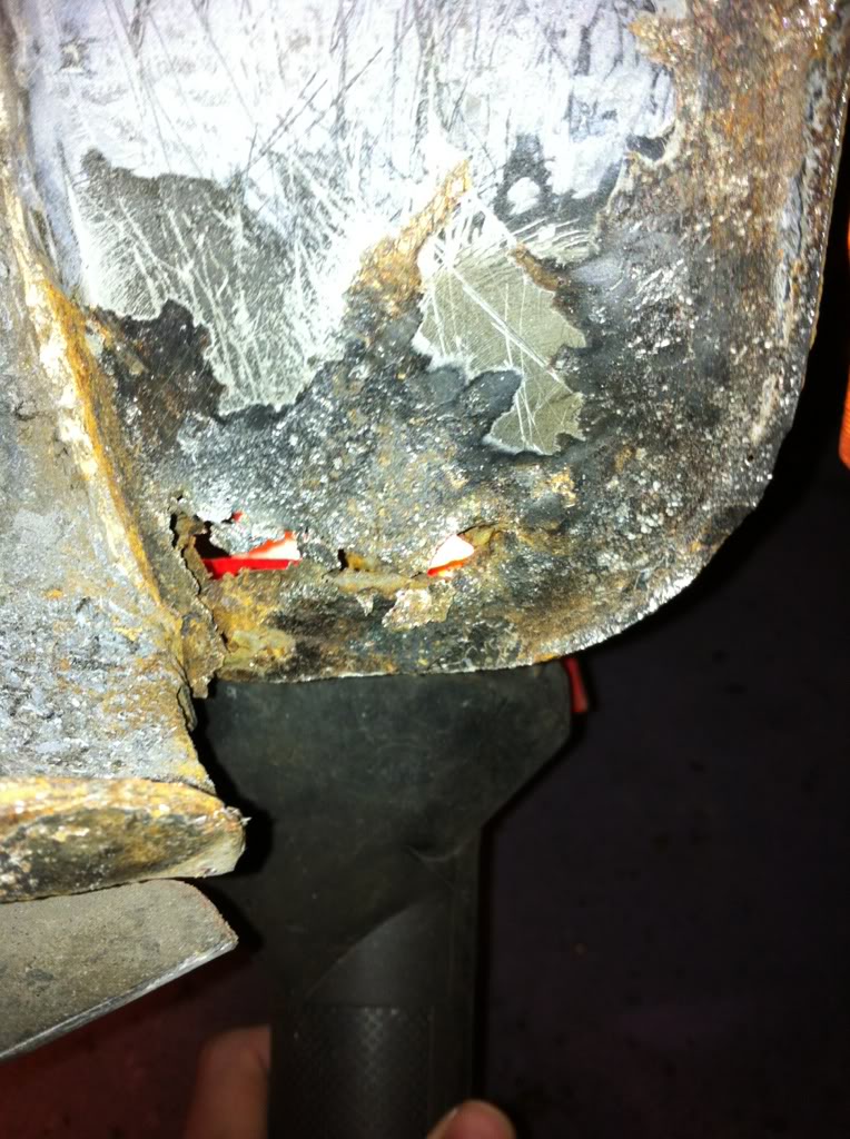

Keep digging away at crusty areas, and holes are growing or appearing.

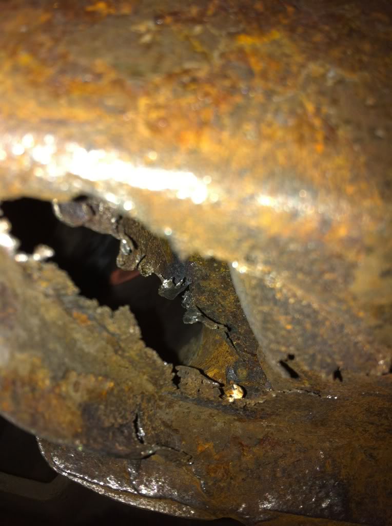

Poked some more holes into it lol.

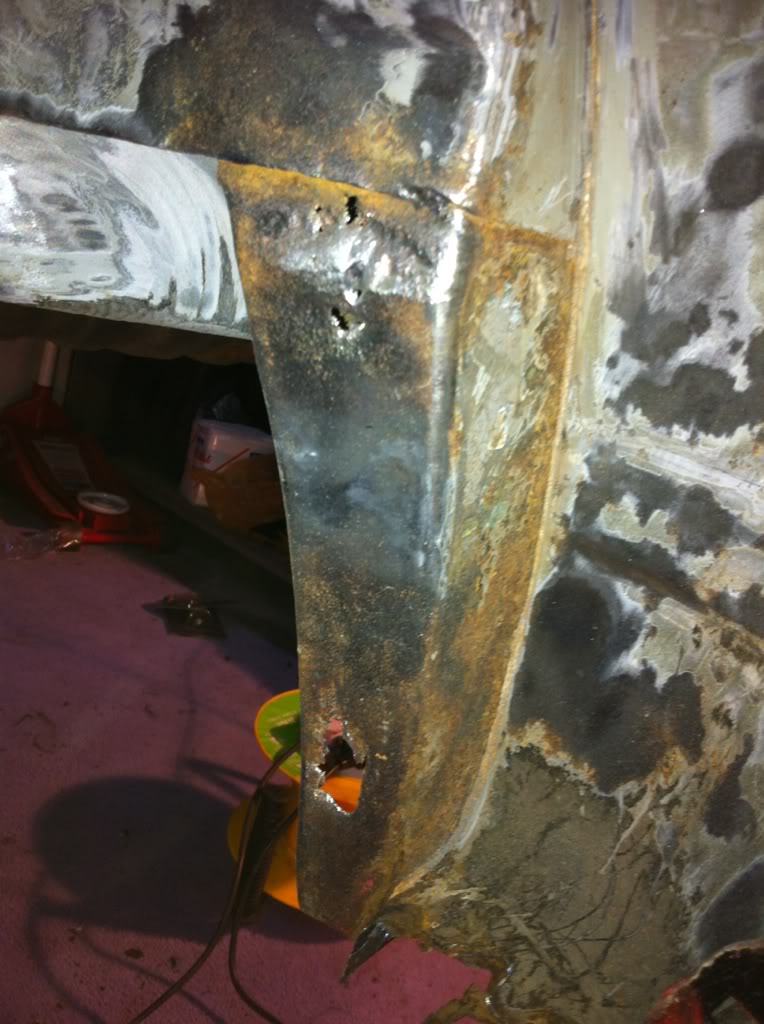

I'll just cut that panel out like I did on the other side last year. It extends into the bodywork this time though...

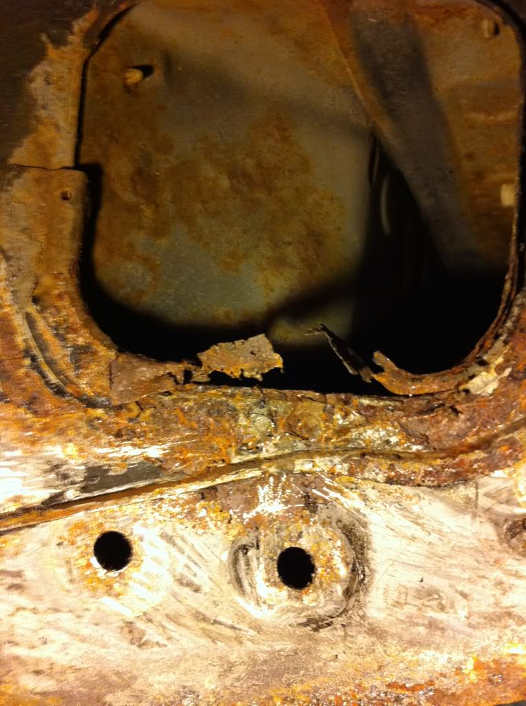

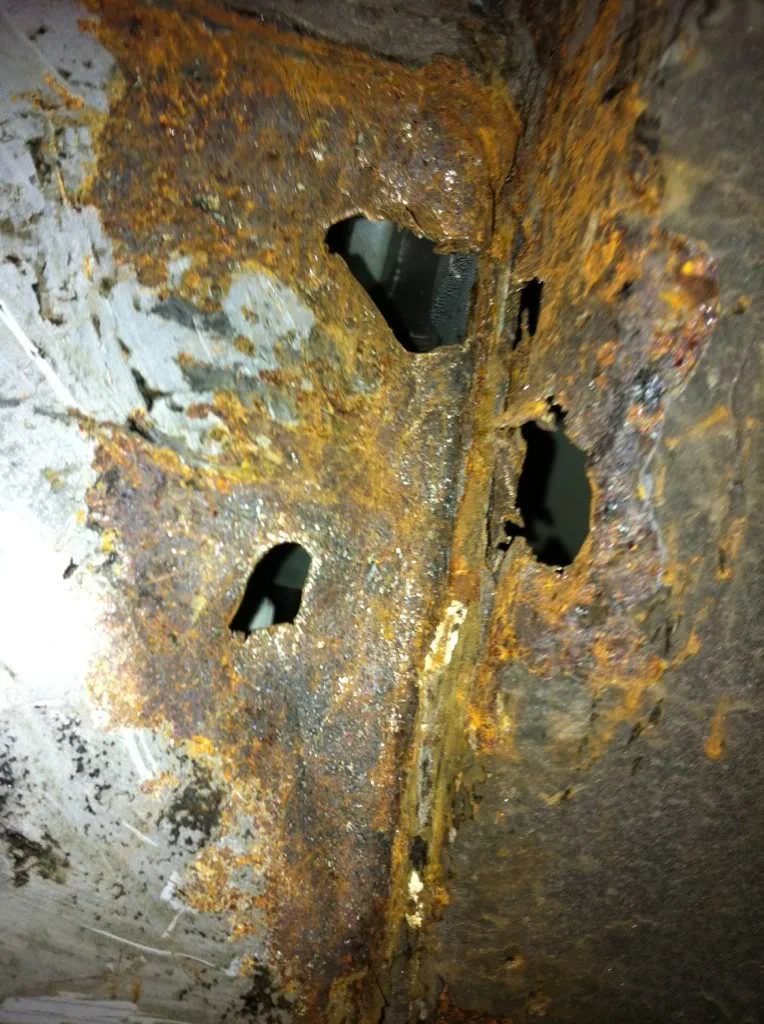

Decided to poke around the driver's side and found more in the sill.

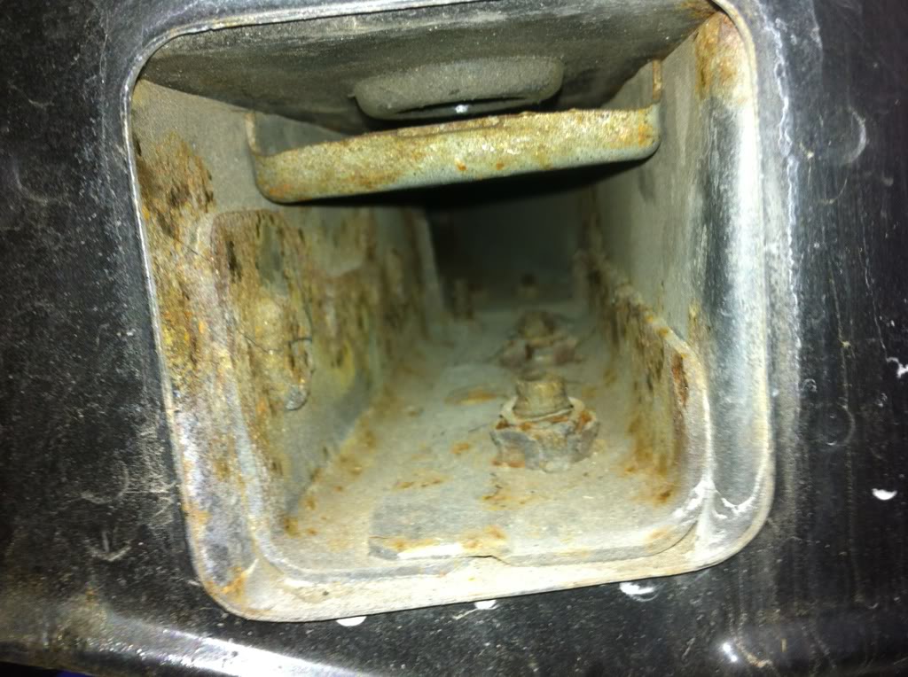

And some into the boot and around the inner fuel tank filler hose hole.
So plenty of rot to cut out and replace, mostly in awkward seams of multiple panels. Interest is rapidly decreasing again.
  BMW M135i
f**k me, is this common on S14's ? That's a hell of a lot of holes on a relatively modern car.
Its common enough on jap stuff of the age full stop, non galv chassis and they don't throw road salt about in japan like we do over here. Seen three sent to the scrappers like this, even one that looked pretty clean on the outside. The new stuff still isn't as good as it could be either imo.
