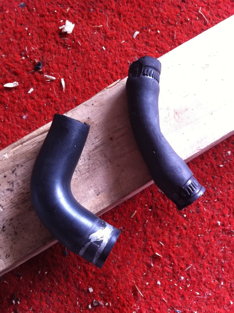

The car didn't perform faultlessly though, about 18 miles out of Whitby I noticed a lot of blue smoke in the mirror. I thought "s**t, the turbo seals have finally died." However, the smoke stayed constant no matter what I did with the throttle, so I dived into a lay-by. Looked under the car to see oil dripping off the exhaust. Oh dear. First thought was the turbo oil feed, but that was fine. A quick look through the arch showed it was the turbo oil return into the sump. So we managed to cobble a temporary repair out of a VX220 gearbox breather mod at the side of the road. This was quite awkward given limited space on the scissor jack, and basic tools. An hour later it was up and running.
I've since repaired properly it using an old breather hose I had kicking about. Proper fix on the left, roadside repair on the right...

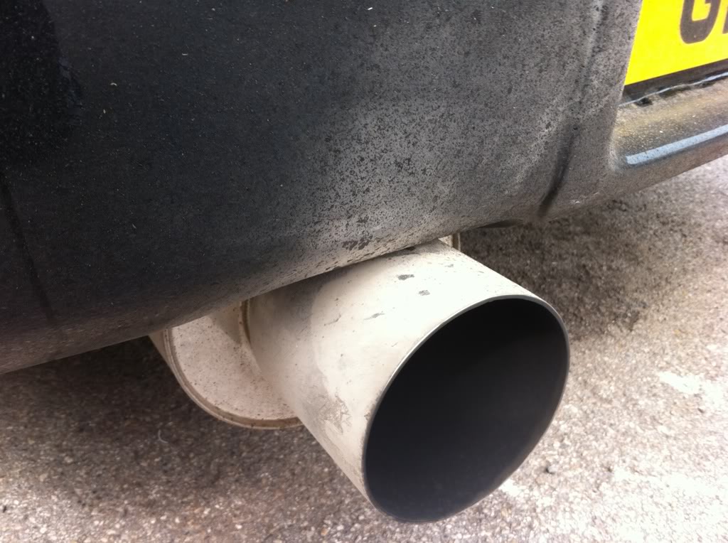

One thing driving me mad is the exhaust still sounds like it's blowing under load. It shouldn't be, everything I touched is nice and tight. I wonder if it's a trait of an exhaust system with a wastegate divider?

the waste gate divider is it a solid welded in or a bolted in one?? i know there were a few people who used to say they would vibrate making a strange noise...

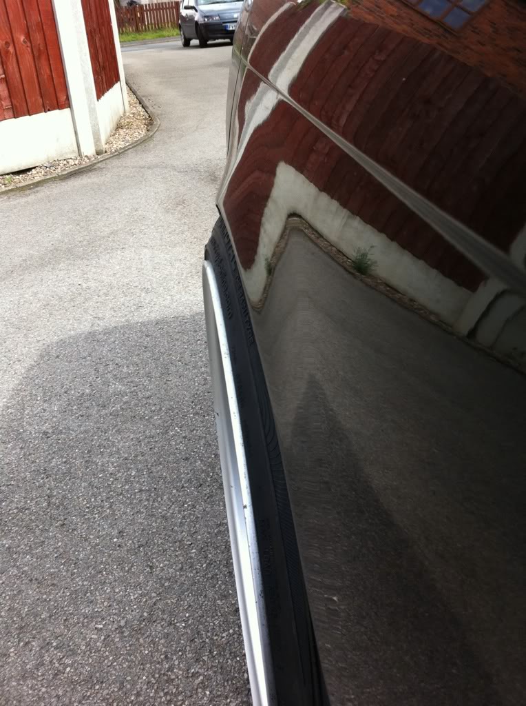

Got my 18" Regas on today. 18x9.5 ET18 225/40 all round. Tried leaving 20mm spacers on the rear, but ran into this issue...
That was with my jack still taking some weight, stupid bent subframe!
Got them all on without any spacers...
Look awesome. Unfortunately the car now feels s**t to drive. It tramlines a bit more, and the rear end feels like it wants to do it's own thing when changing direction. So I don't really like that. No suspension parts are loose so pass on that problem. All I know is I'm very quickly getting bored of suspension/handling issues.

Would a full geo check not sort out the handling issues?
RThat's why I've got another subframe to fit Daniel, it's been that way since the smash, just 18" wheels show it more.
Doubt it, it had the geo done and it hasn't changed. It needs a new subframe, probably new ball joints all round etc.
May be a bent chassis though, can't rule it out. If a new subframe doesn't put that wheel in the right position then it's fucked.

geo will show up an issue. well it should, specially if something is bent. the arms ok? might not jsut be the subframe. its nice though
I had alignment done after I swapped out the bent bits (except the subframe), and it aligned up OK. It was obvious the subframe was bent from the big difference in arm lengths to get the same figures each side.
