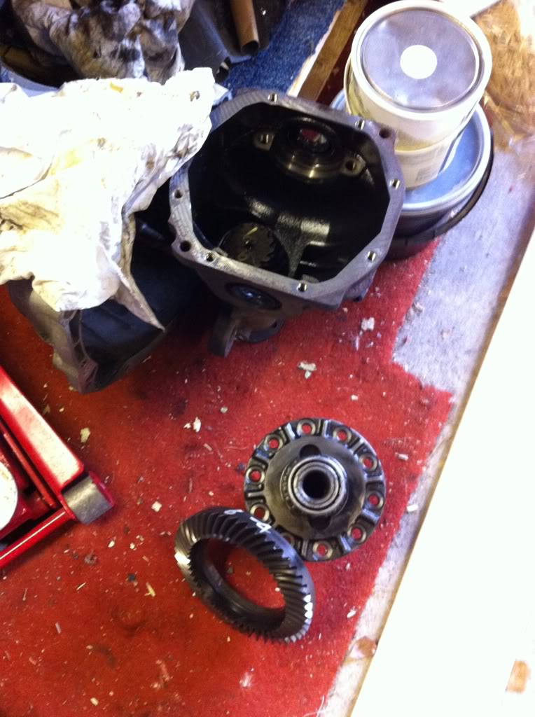

So I've finished stripping the spare diff, now to clean it all up and fit my kaaz...

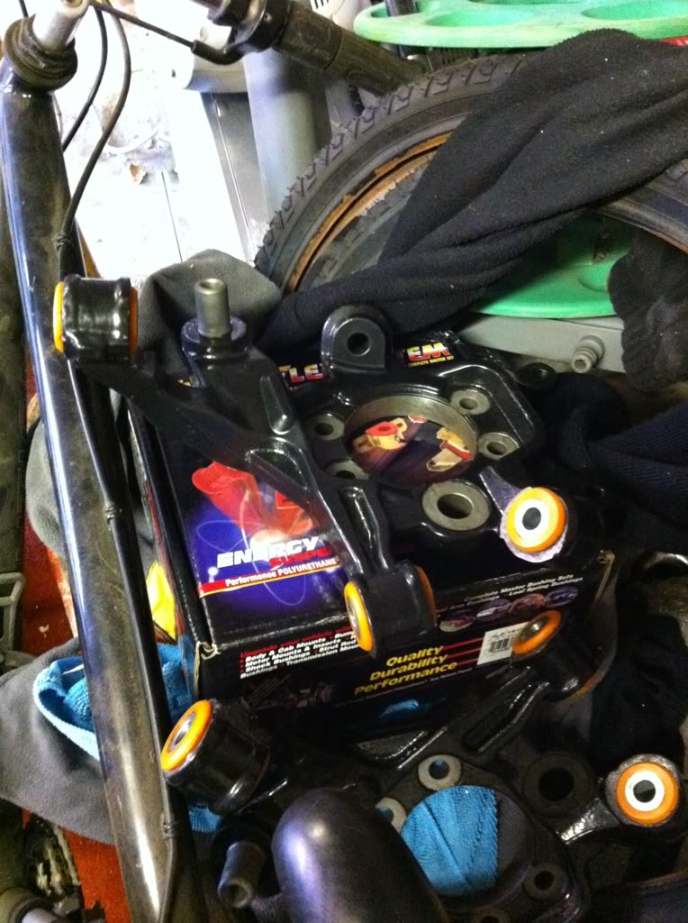

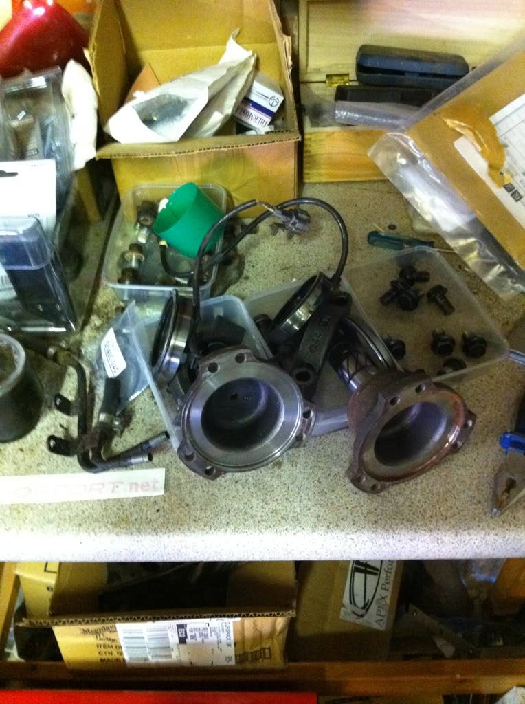

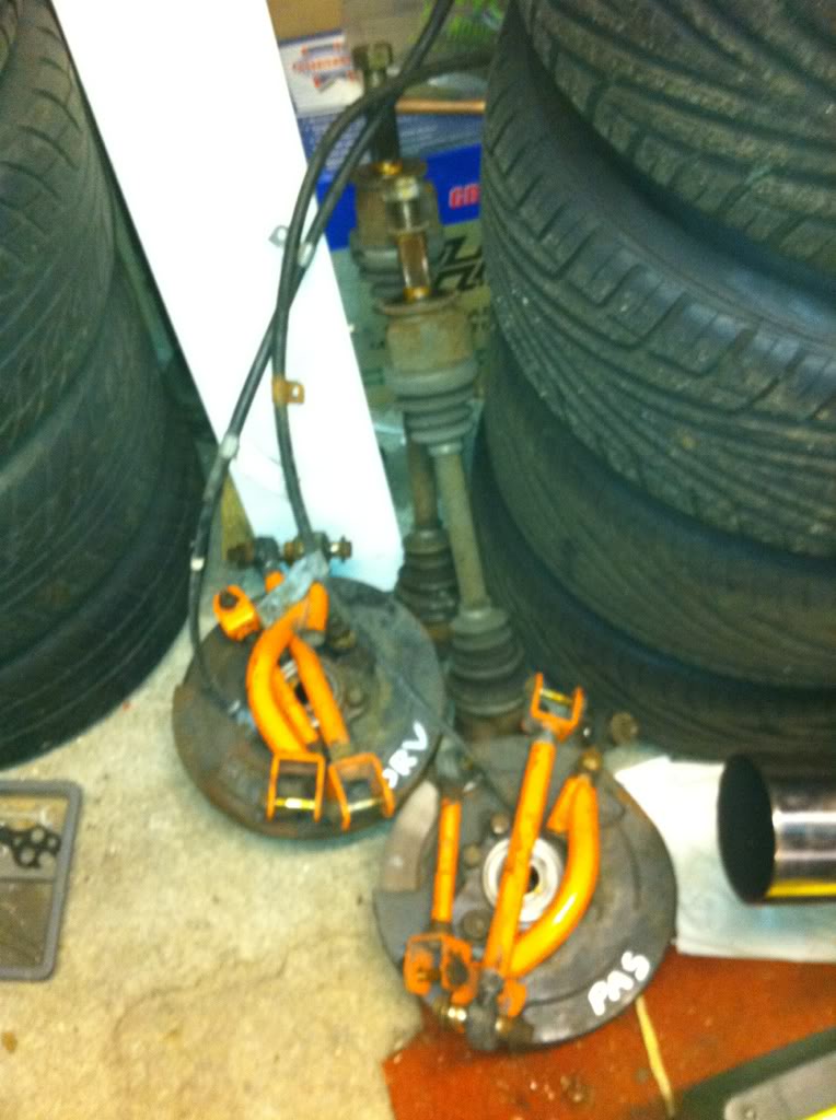

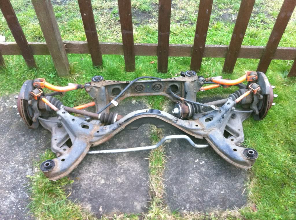

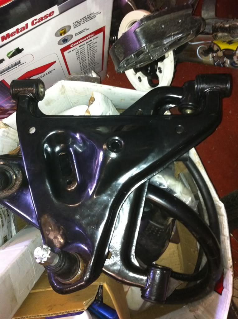

Also after waiting for the energy suspension bushes to arrive, I got my arms finished off. Energy bushes in the lower arms, DW ones in the uprights. The ball joints are Nagisa Auto roll centre correcting doodahs, not cheap, but easier than cutting up arms and cheaper than the ready made alternatives. Neither bush brands are a perfect fit but they're good enough not to move anywhere they shouldn't, so decided they'll be OK...
So get the diff built up and shimmed up for the backlash, await front balljoints from Japan, polybush front lower arms and fit balljoint, fit new tie rods and tie rod ends, fit new rear subframe with diff, arms etc, align, enjoy.

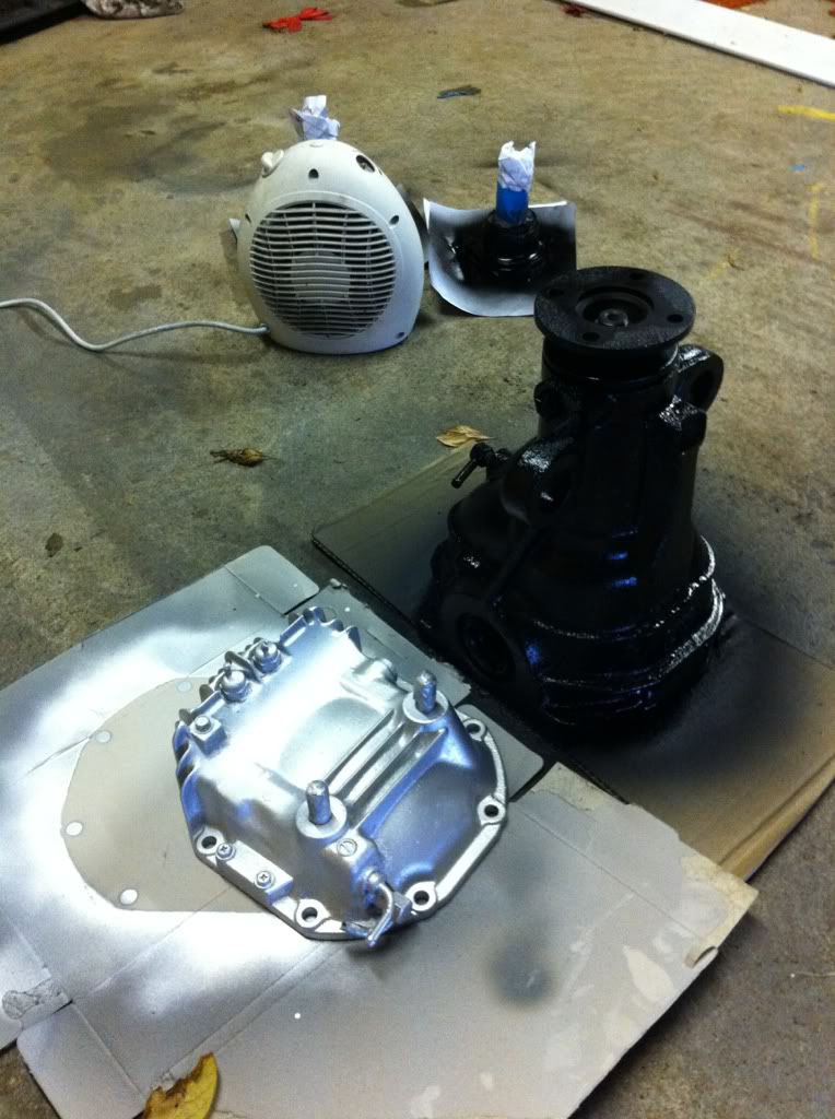

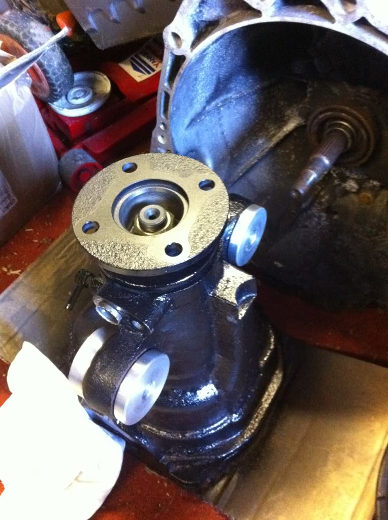

Haven't touched the diff since I last posted, so today I've painted up the casing, backplate & output shafts...
Nothing fancy, just wire wheeled up, zinc primer then gloss black or aluminium. Ordered the input and output seals from Nissan today as the outputs had definitely leaked on this, and might as well do the input for piece of mind. Unfortunately, I've got a fortnight or so wait for them :(

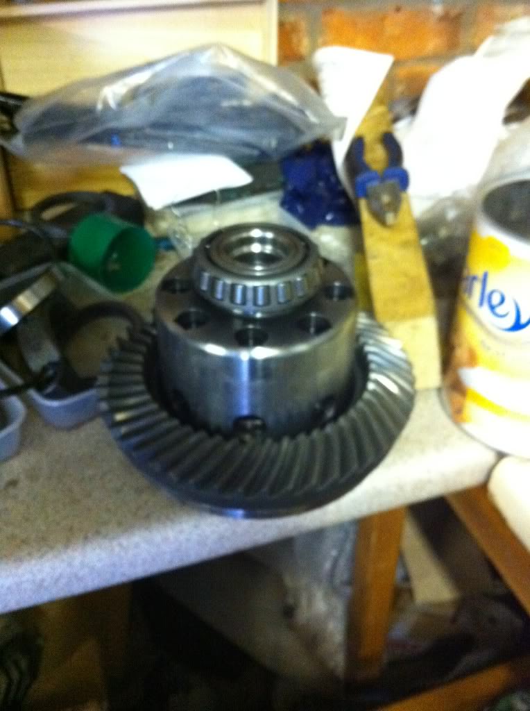

Bolted the pinion ring to the Kaaz LSD, it's not torqued or got loctite on, as I may have to use some little engineering trickery to get the backlash correct with the few shims I have...
Also put the diff bushes into the casing after a couple of days leaving them in the freezer. Needed a bit of winding in with my patented "Super long M12 bolt & super thick penny washer bush pressing device", but nothing too strenuous...
In theory I could build the whole thing up now, but can't be bothered until I get the oil seals.

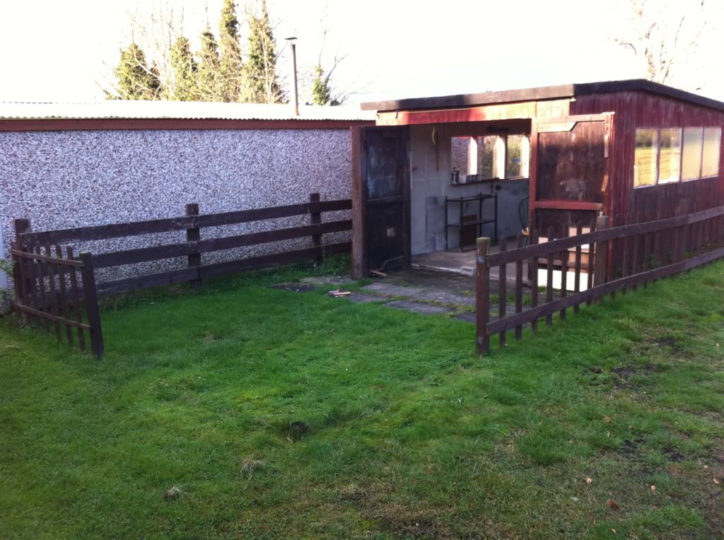

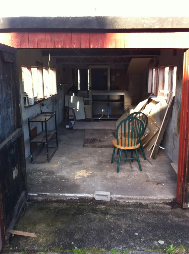

Anyway, a colleague of mine moved into the village a while back, and had offered me their "garage" to rent cheaply to sort the car out.
I had to smash a load of cabinets out and pull down a fence to get the car in! Also resealed the windows and door, and laid a carpet down to lay on.

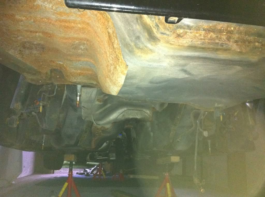

The car has sat in there for nigh on a month now, but today progress began. Started off trying to get it in the air, but the battery has gone flat. So I used the crap scissor jack to get the front on wood and the rear tow eye to get the rear on wood, then I could jack it properly.

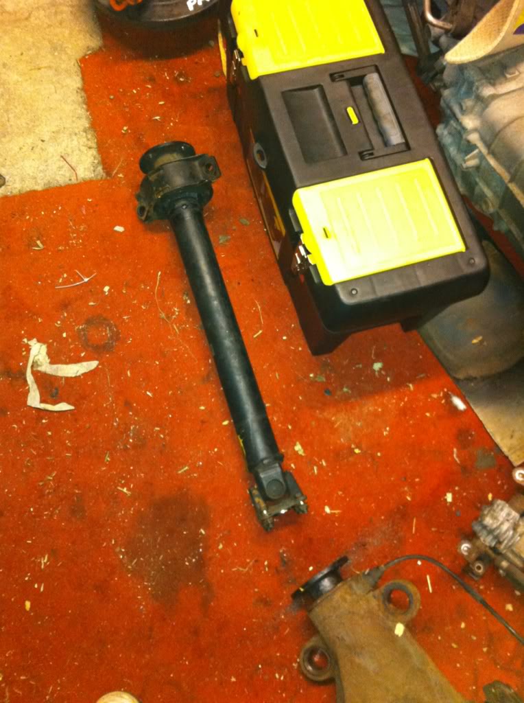

My friend Gaz who painted the car came round to give me a hand, and we got the exhaust and subframe off, then removed the diff from it. Had to take the prop out with the diff as it was the easiest option, which I can sort later.
Anyway, all I have left to remove now is the rear coilovers, fuel tank and bumper, and I can begin poking around for rust. Oh the joys!

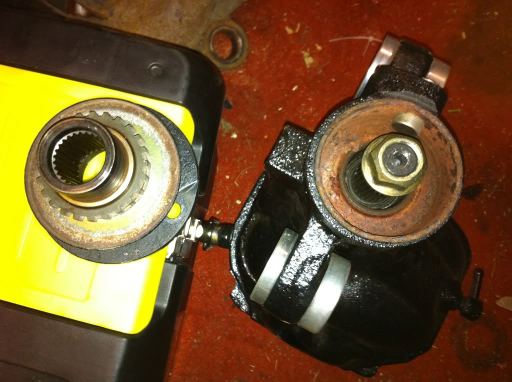

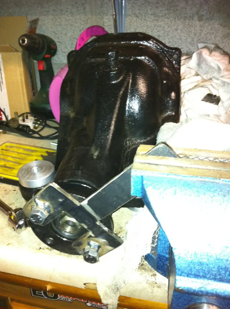

I'd knocked up a spanner at work yesterday with a welder's watchful eye to lock up the diff I'd started refurbishing, to loosen the centre bolt and remove the input flange...
This puppy was so tight my 24" breaker bar was bending big time. So I had a brain wave, and remembered Gaz who helped on Monday had left a 240v impact gun in the workspace in case I needed it. Popped that baby on it and the nut span off easily. Bearing pullers on the flange, and it's off. Need to change that oil seal, however, the ABS sensor shroud is in the way, so I need to look into that...

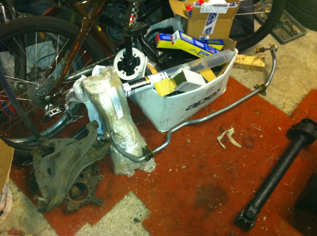

Faced with something I could easily break, I decided to make some room again by dismantling the bent subframe. This left with me with a pile of bits I need...
The Whiteline ARB, unsurprisingly, starting to rust after a year, alongside some parts I can sell...
Then before coming in, I split the rear section of the prop from the old diff. Now, everybody moans these bolts are a b**ch to remove because a normal ring spanner won't fit. This is easily resolved by chopping 2 of the 5/6 protruding threads off the end of the bolts with a hacksaw. Now, should I ever need to remove it in situ, it'll be a piece of piss...
