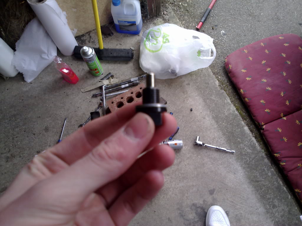

WTF is a magnetic sump plug??
covering problems and extending the life of the bottom end ;)
the SR20 has issues with the cam spray bars clogging if the oil isn't regularly changed, if they clog, the cams and rocker arms start to wear and lots of lovely swarf floats around the engine until it ruins all the bearings.
Magnet in the sump collects this swarf and extends the life of the engine

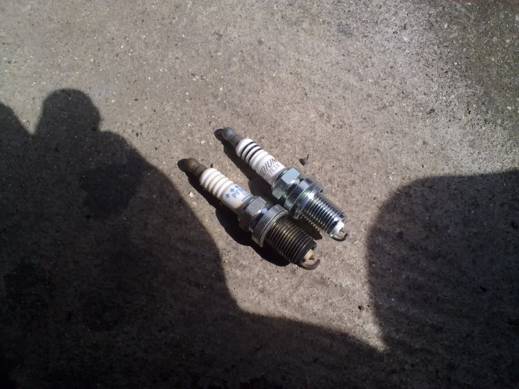

Finally, a chance to give it a bit of a service.
Plugs, fuel filter, air filter, oil filter and oil done today. Will do the rad/coolant on my next weekend off in a fortnight, as I'm off to collect some 17" Regamasters from Bristol tomorrow.

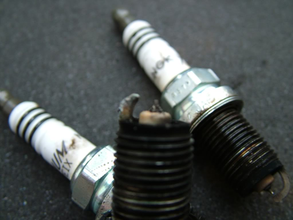

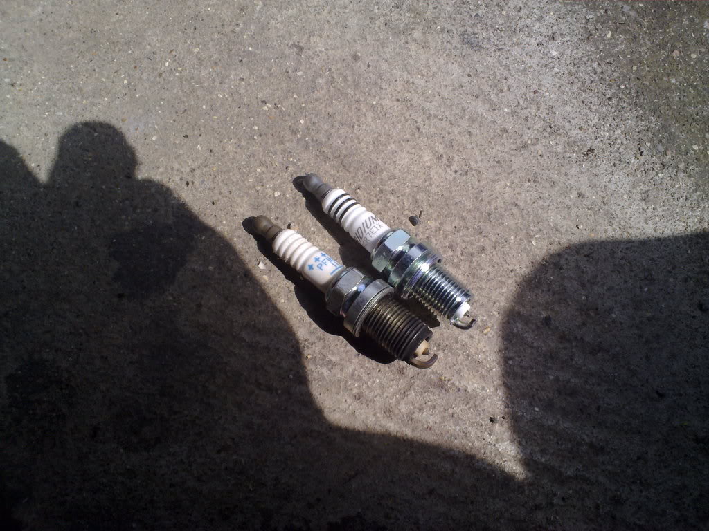

Old vs New Plugs - Old plugs are black as hell, supports the fact it stinks of unburnt fuel and pops and bangs like a good 'un on overrun.

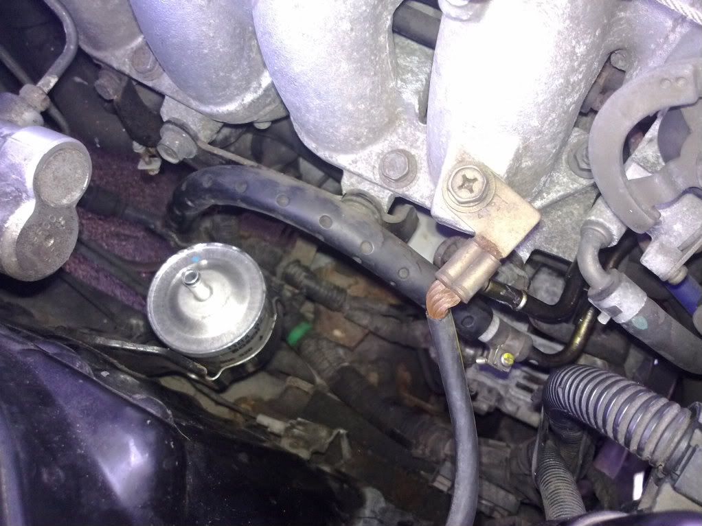

New Bosch Fuel Filter in, took some doing, the hoses were ridiculously tight, not helped by me not being arsed to depressurise the system.
The magnetic sump plug, a bit fiddly to screw in, as the magnet is actually very strong!

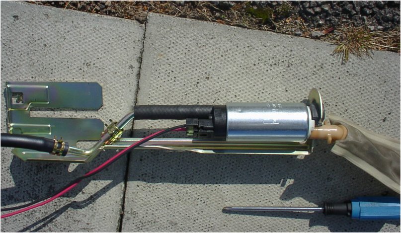

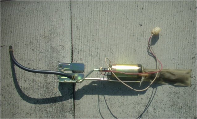

Sorry we go on about Walbro's..haha! Its just very important and alot of people think it will be ok. You can see just by taking the cover off though? Walbro's look about half the size of standard.
Standard - http://www.kuddy.net/200sx/_images/fuel_old_pump_small.jpg
Walbro - http://www.kuddy.net/200sx/_images/fuel_new_pump_large.jpg

Well I just looked, the fuel was over it, but it looked small and silver rather than the bronzey colour of the OEM pump, and the wiring has been chopped & crimped together.
Then you my son, have nothing to worry about. :)
