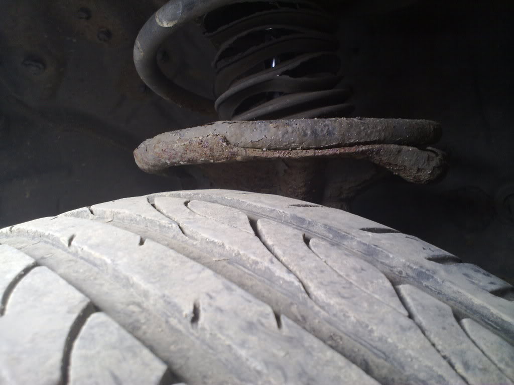

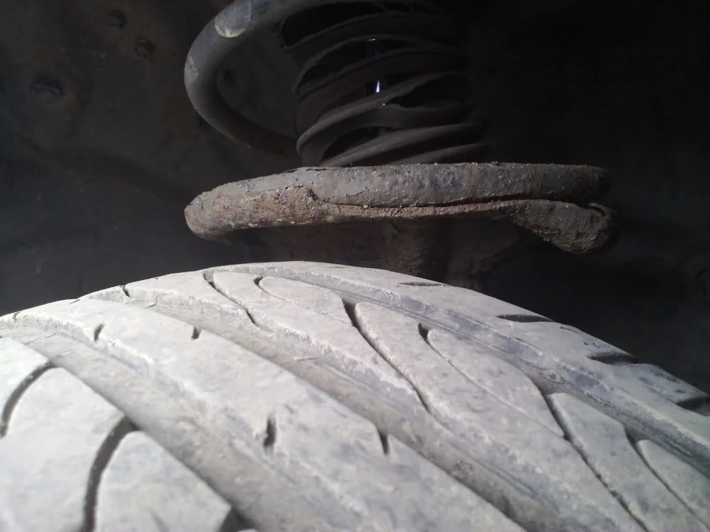

Front strut clearance (17x8 ET35)

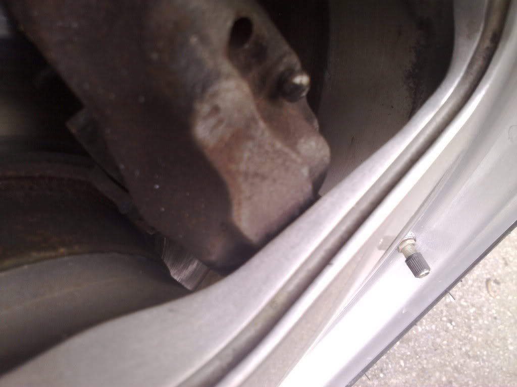

And caliper clearance, tight as a duck's anus TBH...

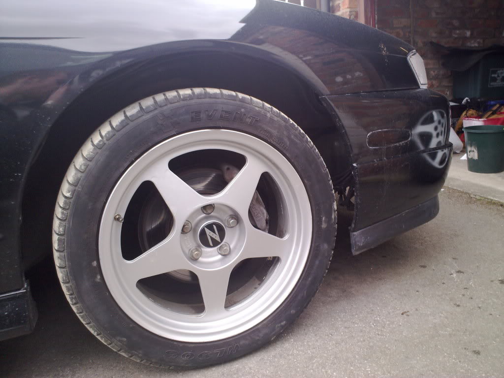

How the front sits...

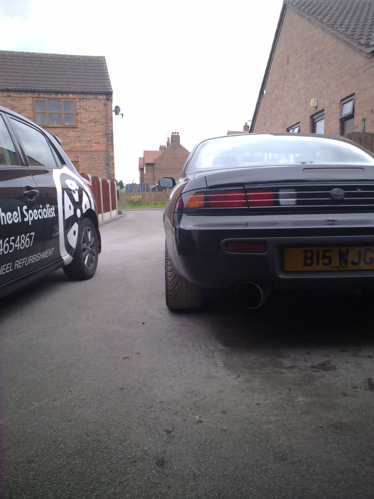

And the rear (17x9 ET38)
Better pictures when I get my DSLR back from Soph. Need to refurb them, and probably space the fronts maybe 3mm to be safer with the calipers. Rears might want spacing a touch when I buy coilies next pay day, we shall see anyway. Desperately need some tyres too, and to refurb them.

On the Z there was literally 0.5mm of clearance from the caliper writing to the rim! Looked too close tbh!

WOAH! you can run much more than that on the rear!! i ran stock arches with a 18/9.5 et 15 on the rear!! i would stick a set of 20mm hubcentrics on the rear (give me a shout if you need spacers i can get you hubcentrics with new studs etc cheap!) and i would do 15 or 20mm on the front! stick 225/40 tyres on the back or even 215/40 and a 205 on the front... then coilovers and a healthy amount of camber...

Got any full car pics with the new wheels on Gaz? They look spot on!
