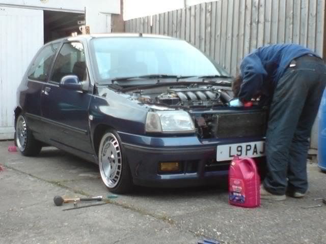

My valver/172 project

  '92 172, Lotus Elise
fiddled with the relay, it now clicks open, but im only getting about 10v through it... battery is still showing 12v, but is admittidly quite flat (wont turn the engine over many times)... anyway connecting this up to the fuel pump doesnt start the pump, so i need to do some more fault finding :?
also, trying to get my alternator light to come on on the dash.. if I ground the connector as beanie says the light comes on, but on the 172 alternator neither of the 2 pins on the connector go to ground :( - should I just use the 16v alternator?
