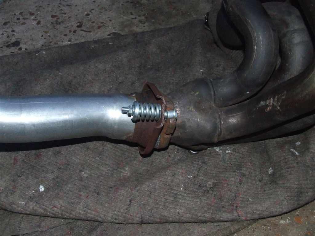

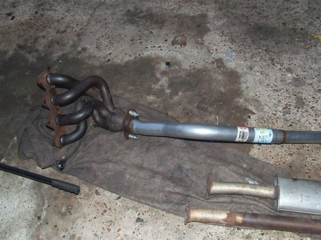

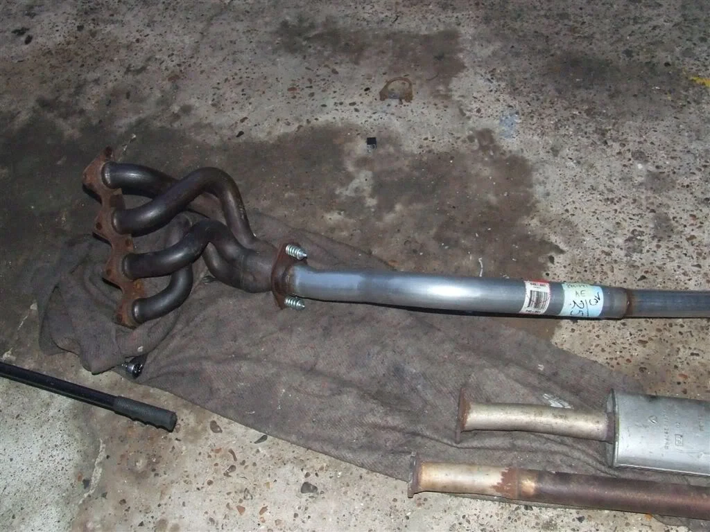

Got a downpipe off a pug 405 which fits the 172 manifold!
but the fun will be cutting and welding it to fit my existing exhaust :(

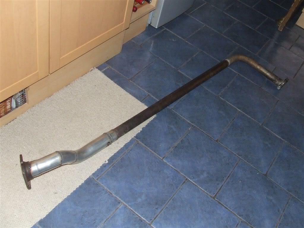

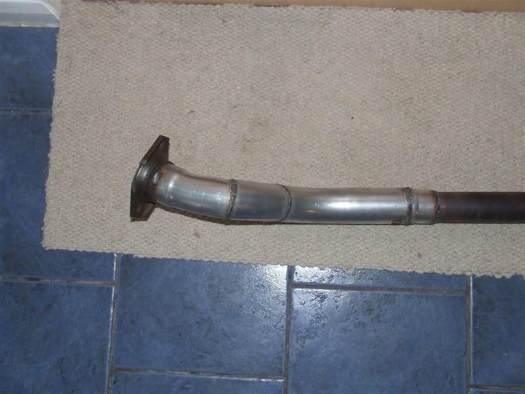

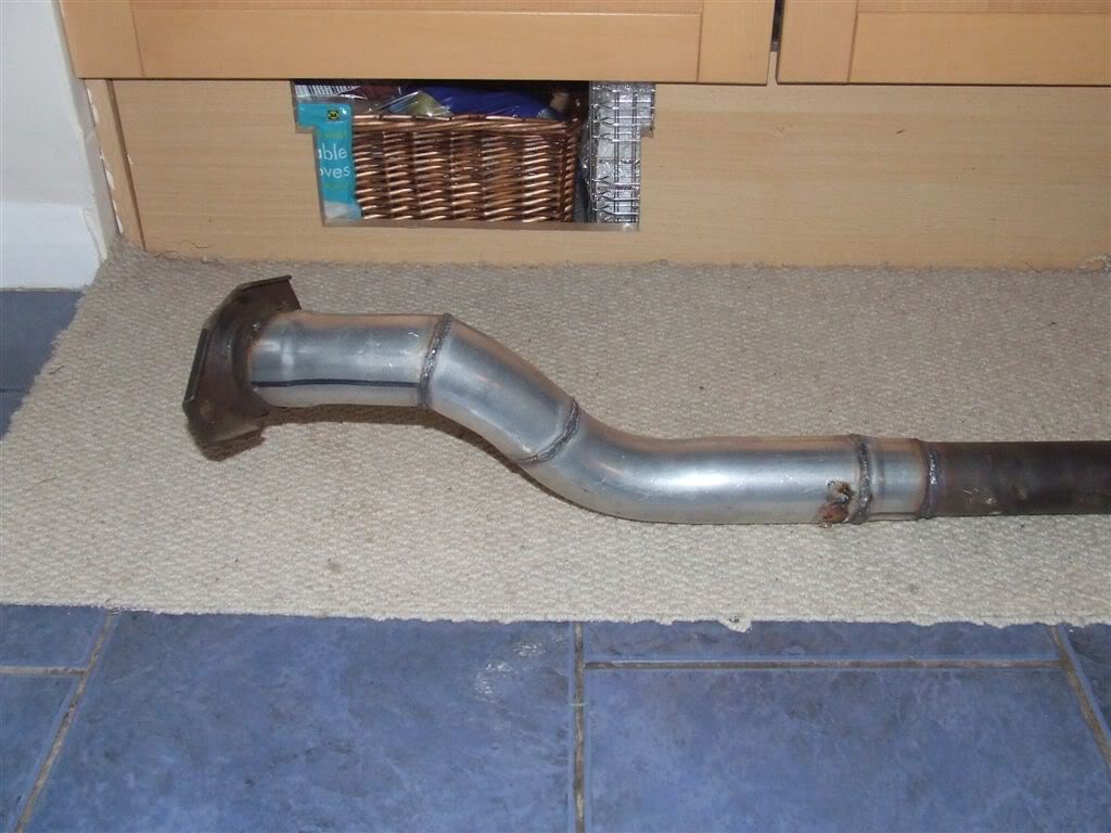

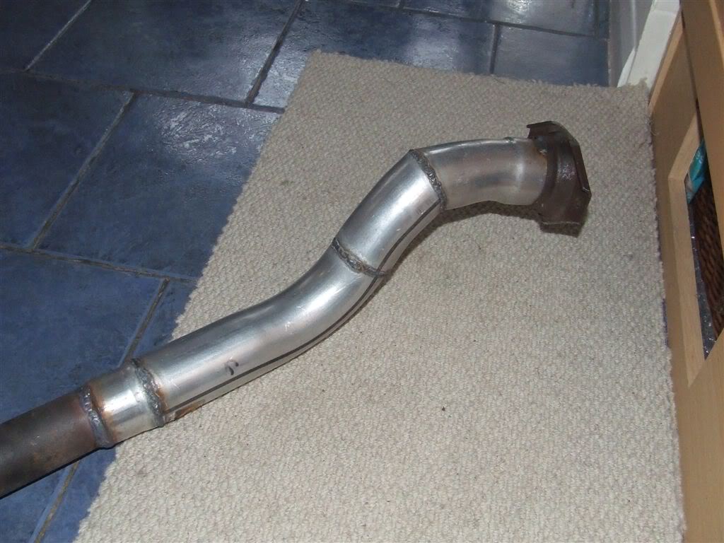

spent all day today running around trying to sort my exhaust...
cut and measured all the pieces myself under the car and got them welded up
looks brilliant, but the bend right after the flange is about an inch and a half too far away from the flange, so i need to chop a section out and get it welded to bring it closer ... it just hits the bulkhead atm :(
so close!! :(
  172 Race Car
What bore size is it matt? Looks a tad small in the pics
You could use this one as a template now and go get yourself a nice stainless made up
  '92 172, Lotus Elise
the 'old' looking bits are my old 16v exhaust.. so only 2" i think
not measured the new stuff, but it looks big! :p
but yeh, at some point i'll replace it with a bigger size
the fact im not running a mid box or cat should help though?
