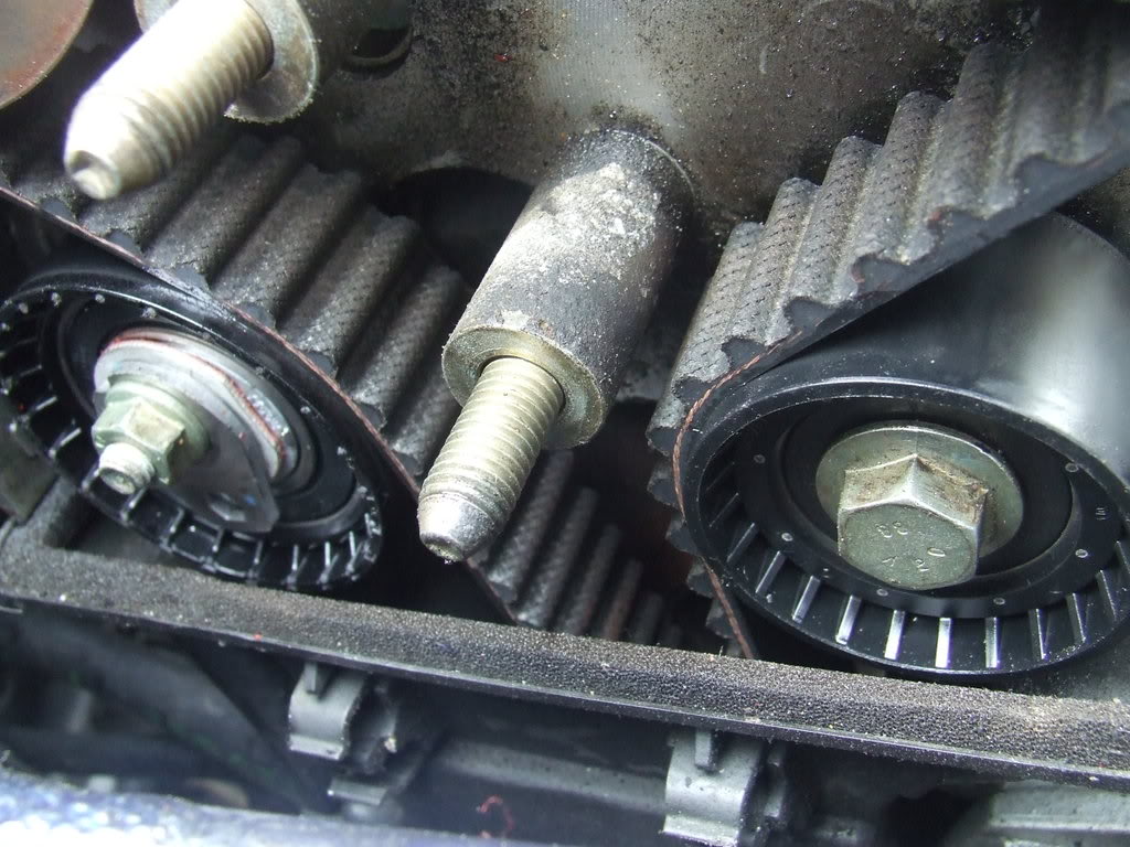

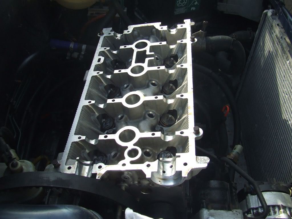

tensioner not done up correctly (Dan's fault)

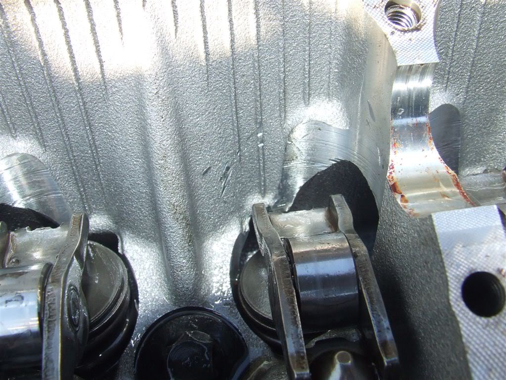

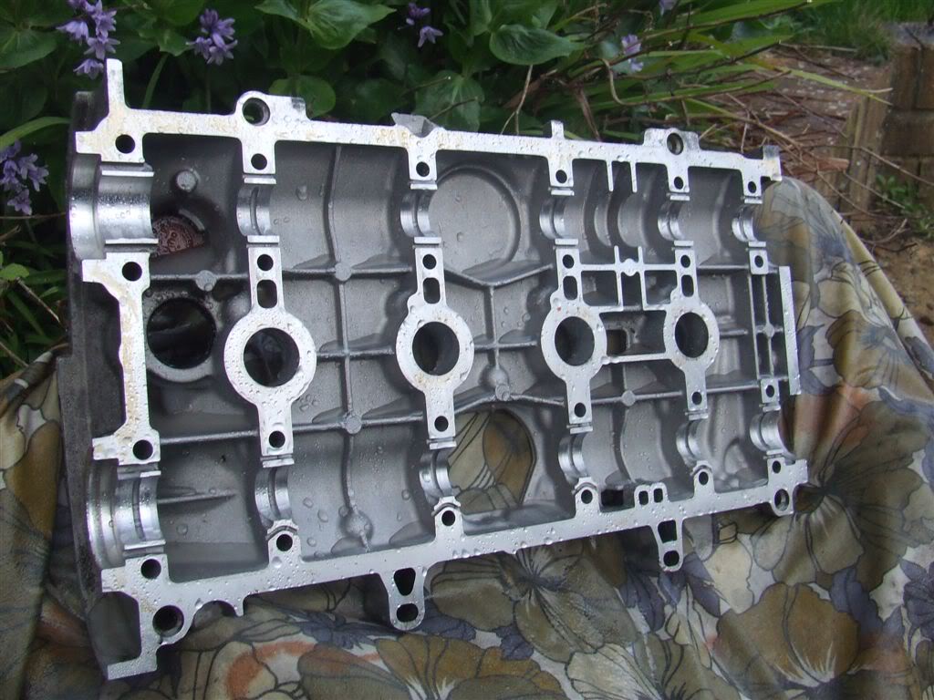

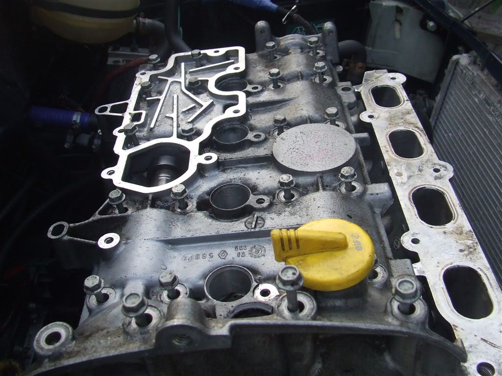

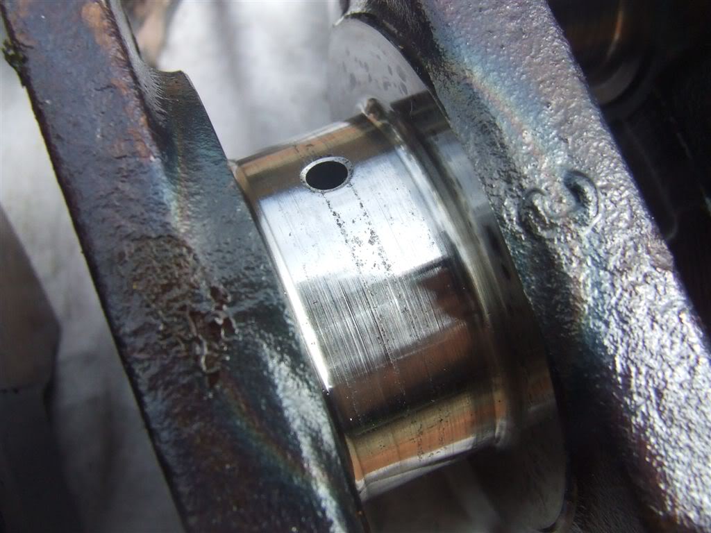

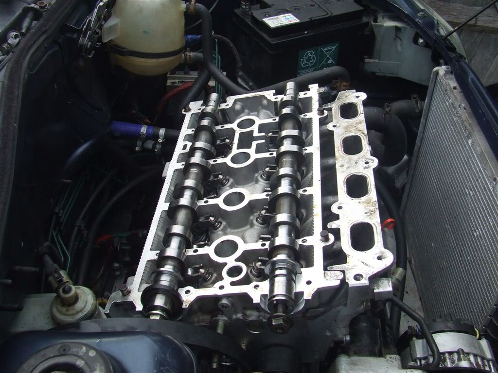

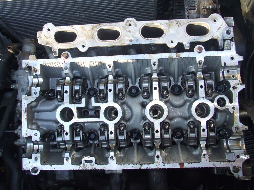

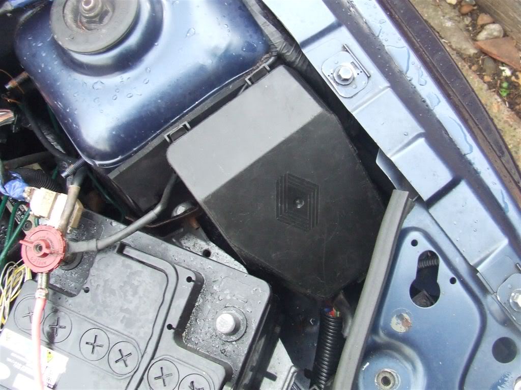

cam cover off

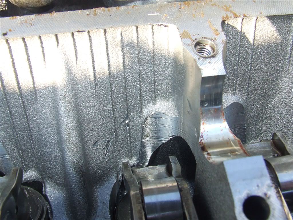

bit of damage caused by the broken spring

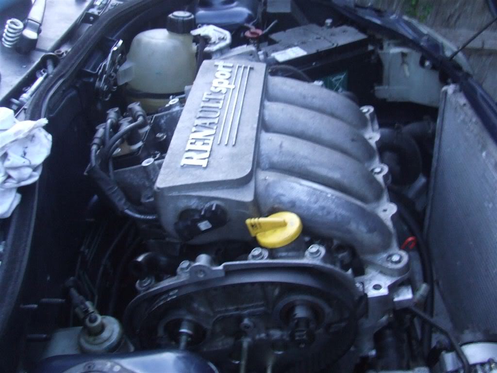

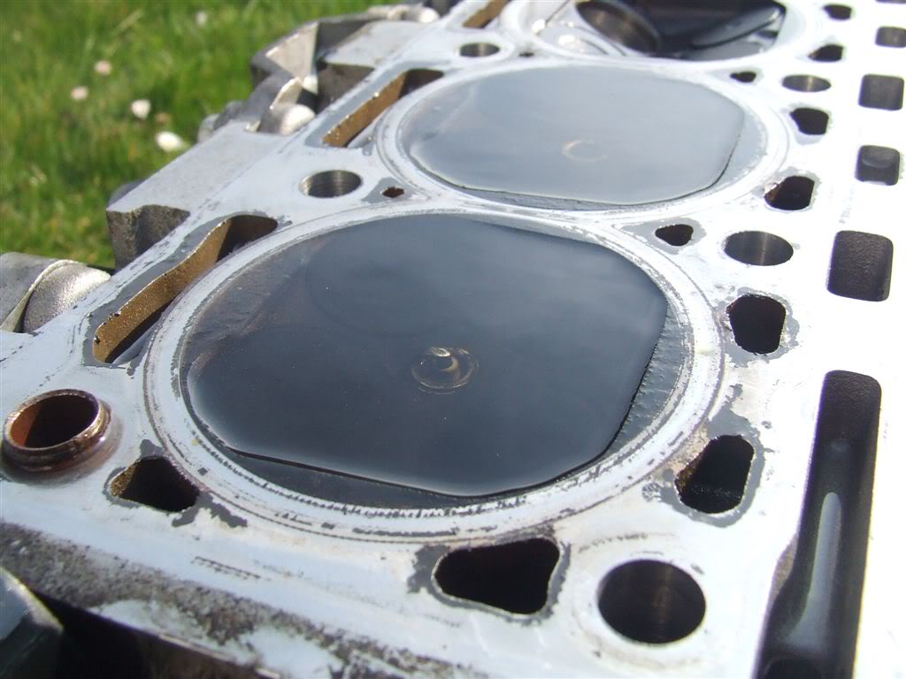

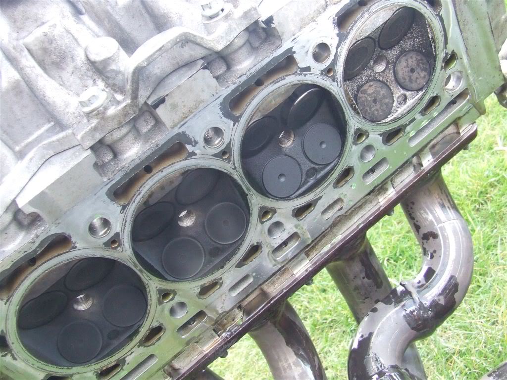

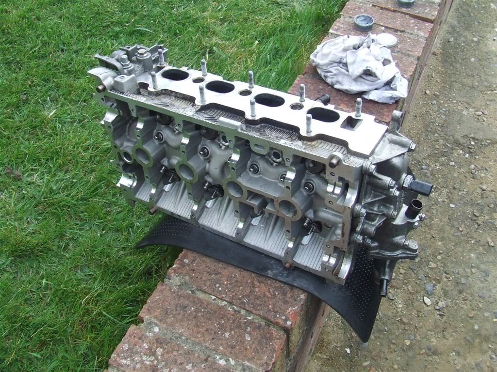

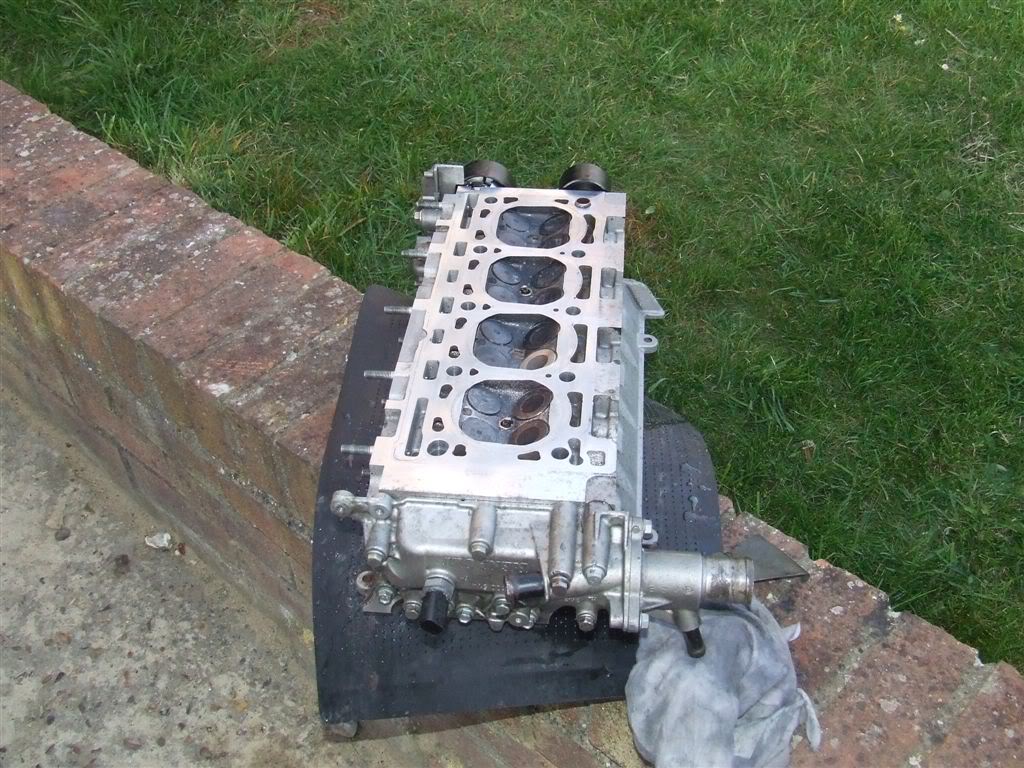

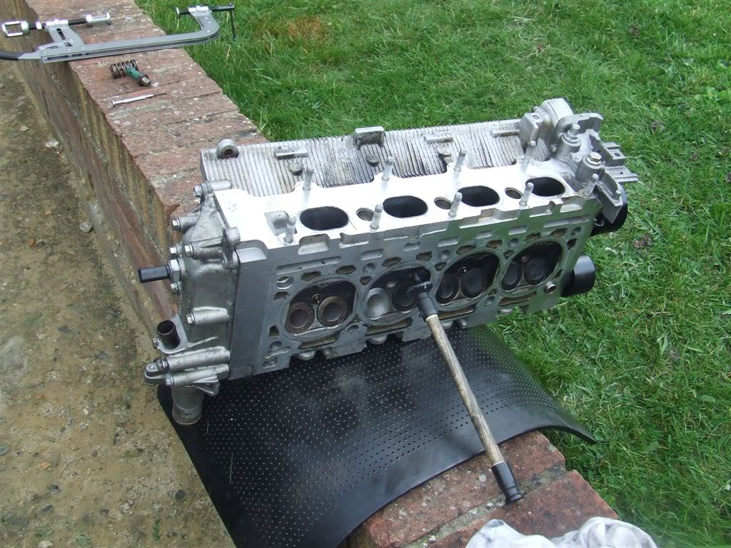

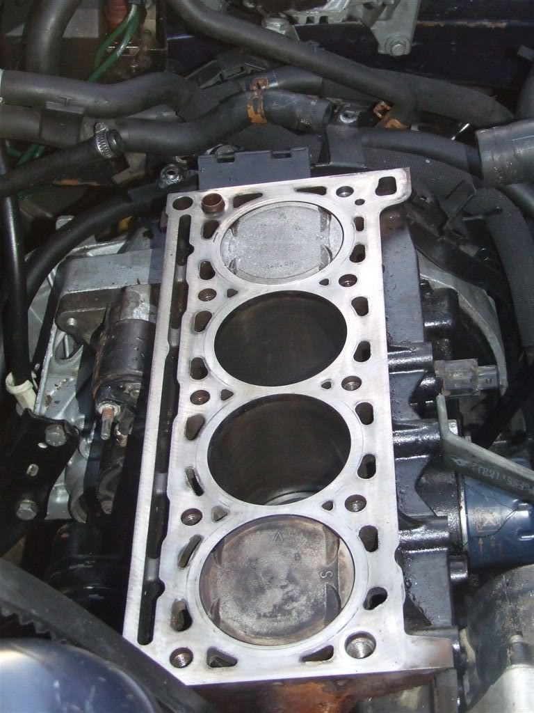

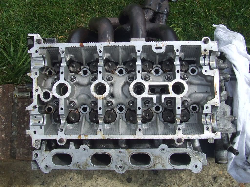

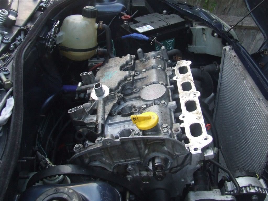

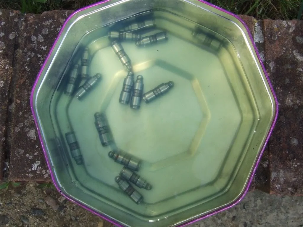

head off

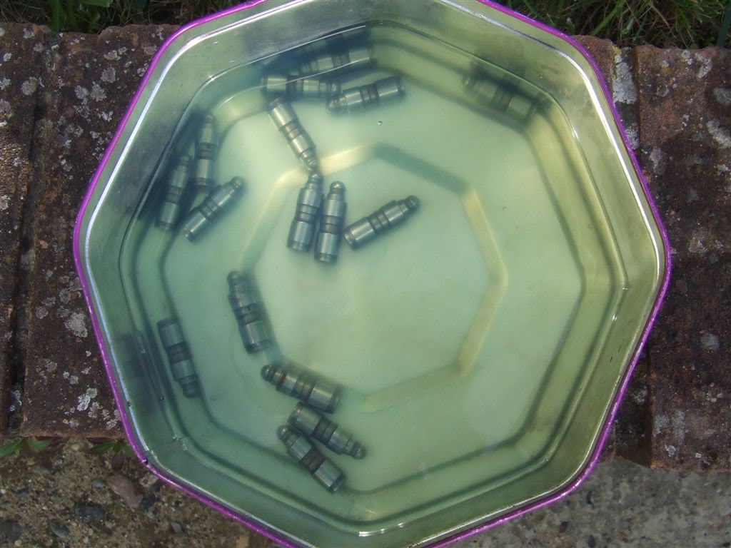

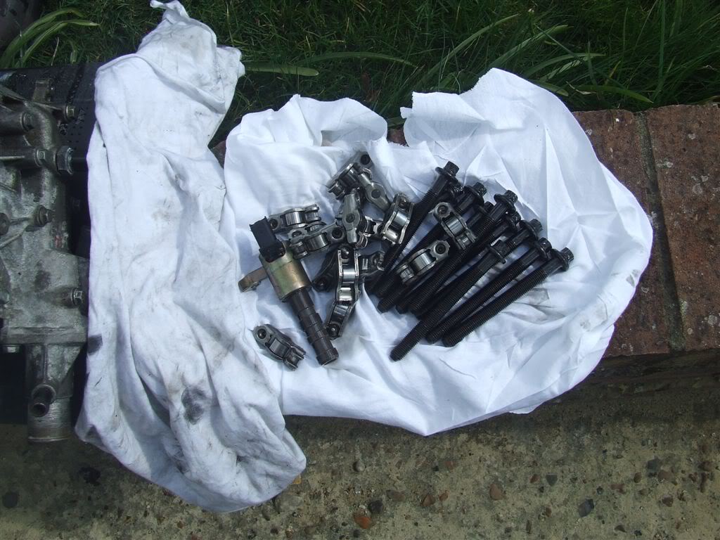

head bolts and followers

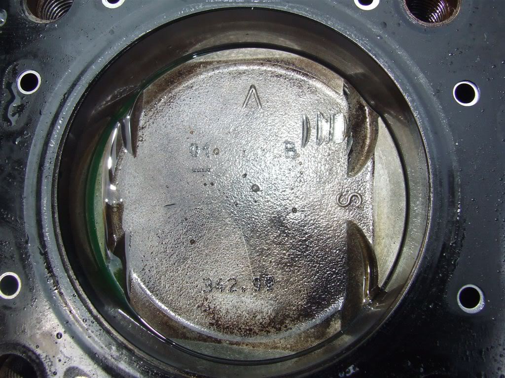

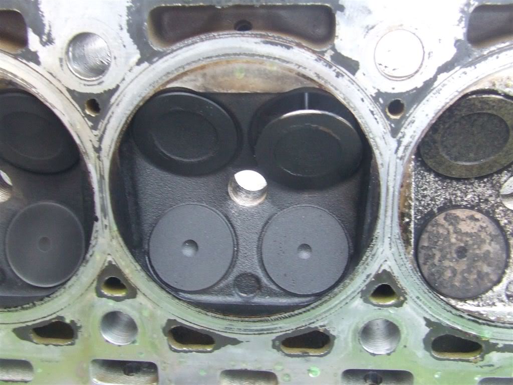

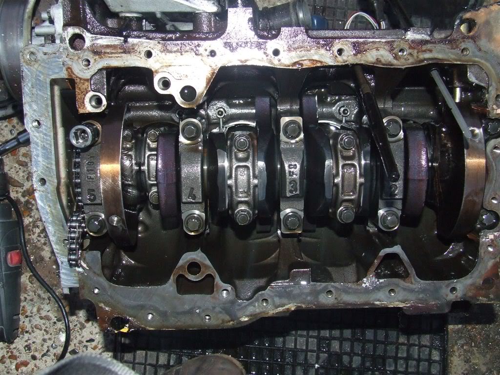

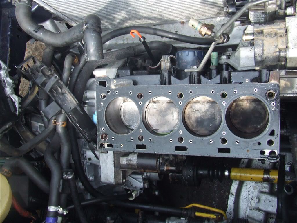

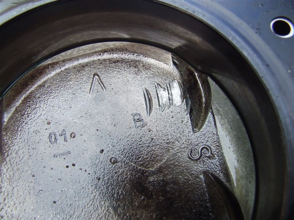

1 step forward, 8 steps backwards:

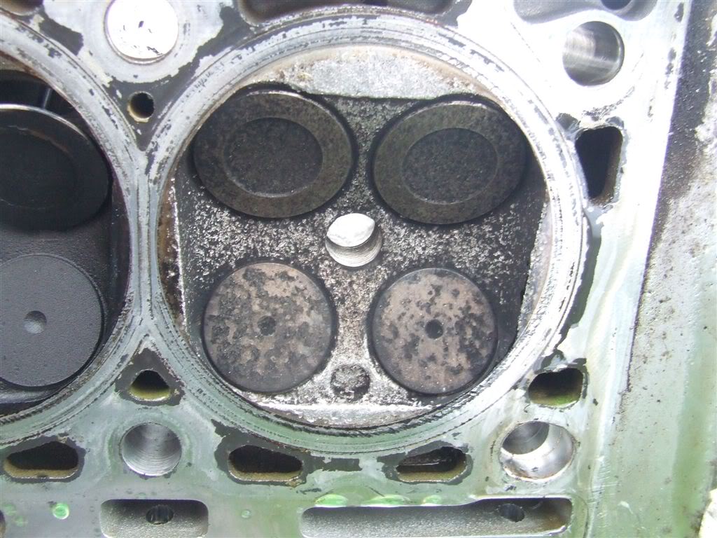

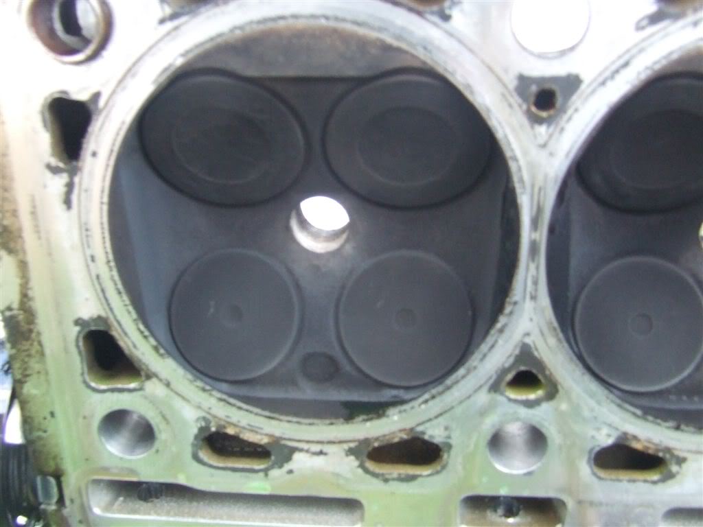

damage to piston 2 caused by a stuck valve
hence the poor idle

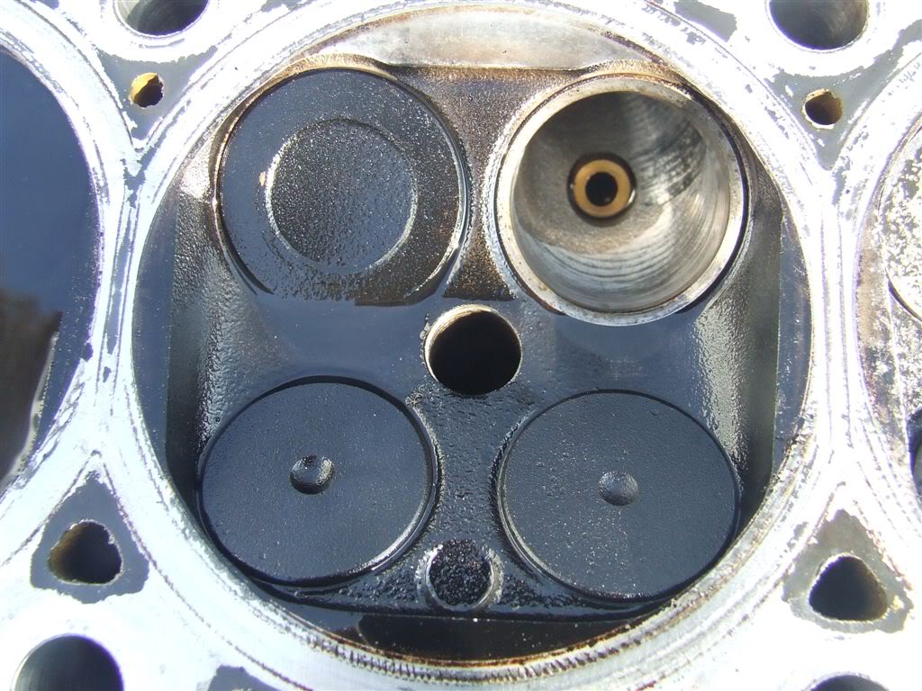

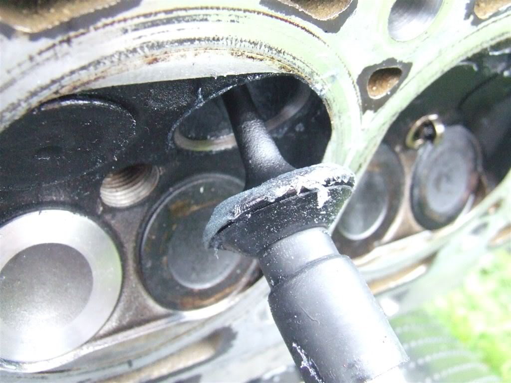

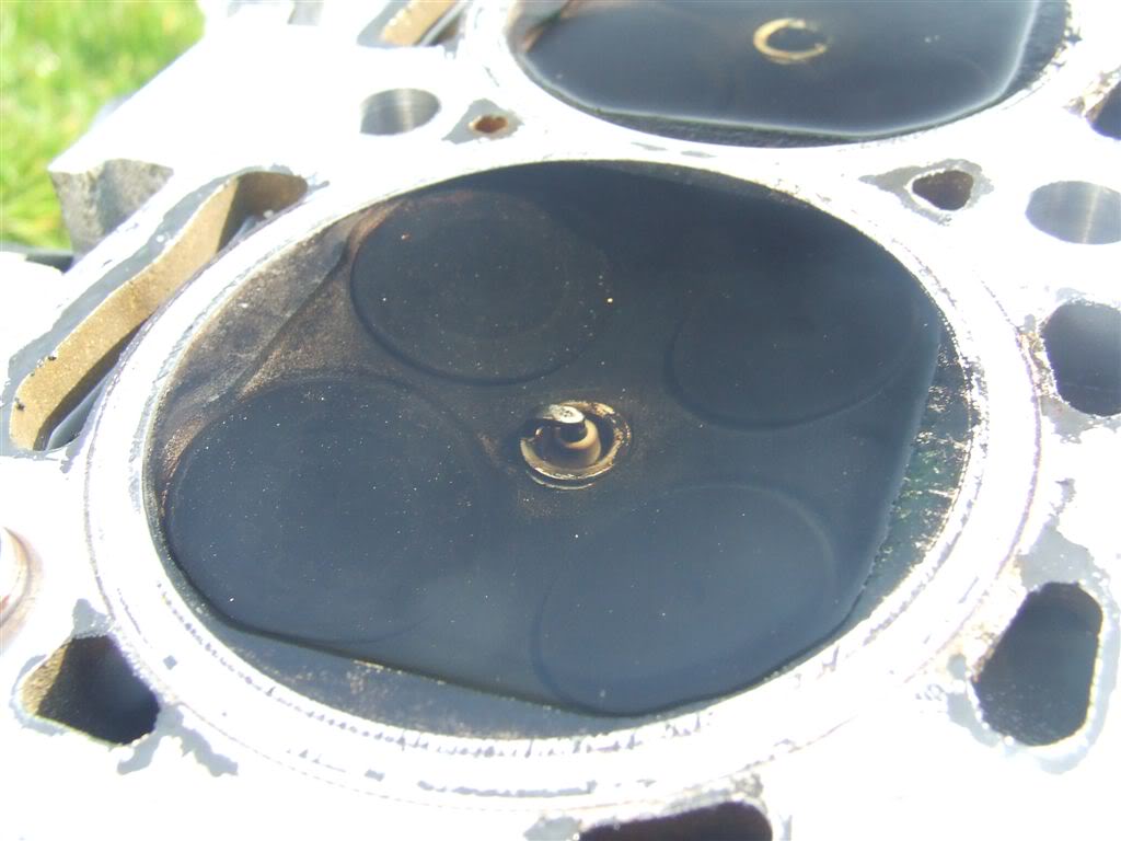

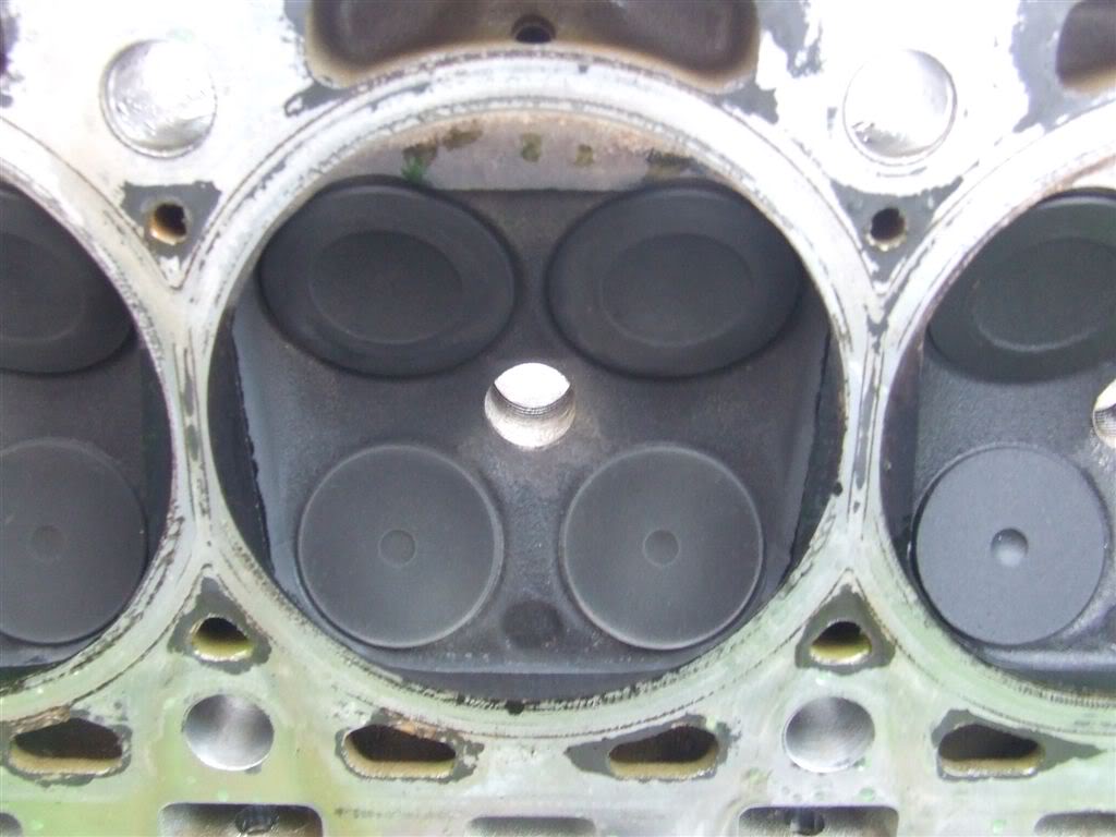

stuck valve:
running rich?
detting much?
parafin in the upturned head to do a cheap leak test

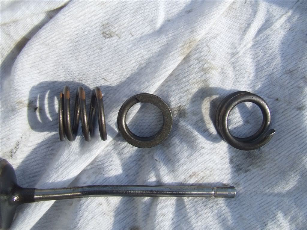

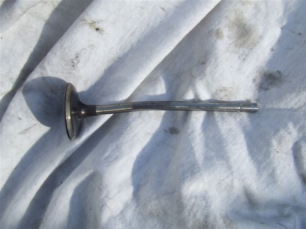

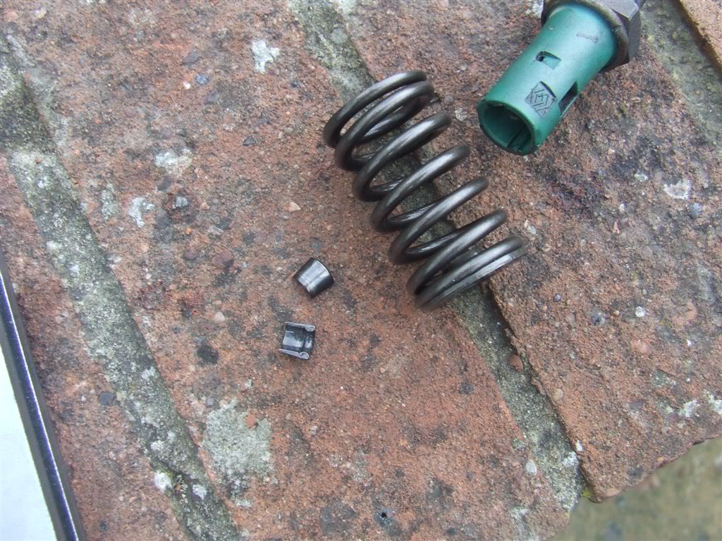

valve removed:
bent
valve spring mashed

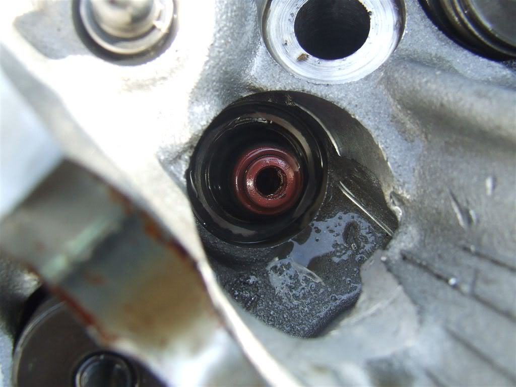

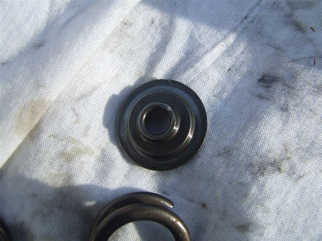

retainer
valve stem seal

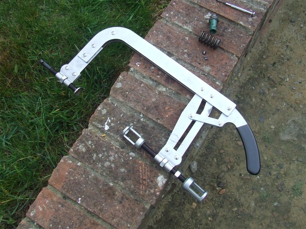

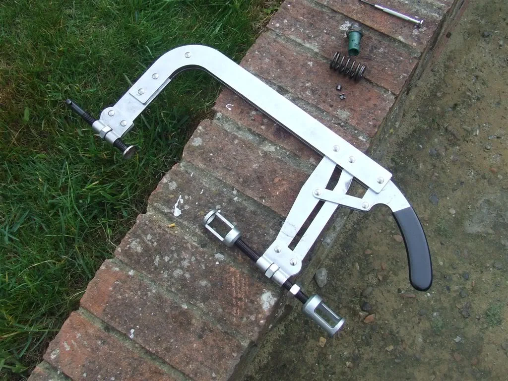

I've gone and bought a new valve, new seal, new spring, new retainer, new collet etc... and have some spring compressors
Got renault to 'express' them so I picked them up this morning (instead of Tuesday!) except they only sent 1 single collect... which is useless, so i've gotta go back on tuesday anyway to pick up the other one.
Then it should be a case of putting it all back together, tightening and timing it up and it should run! (again)
