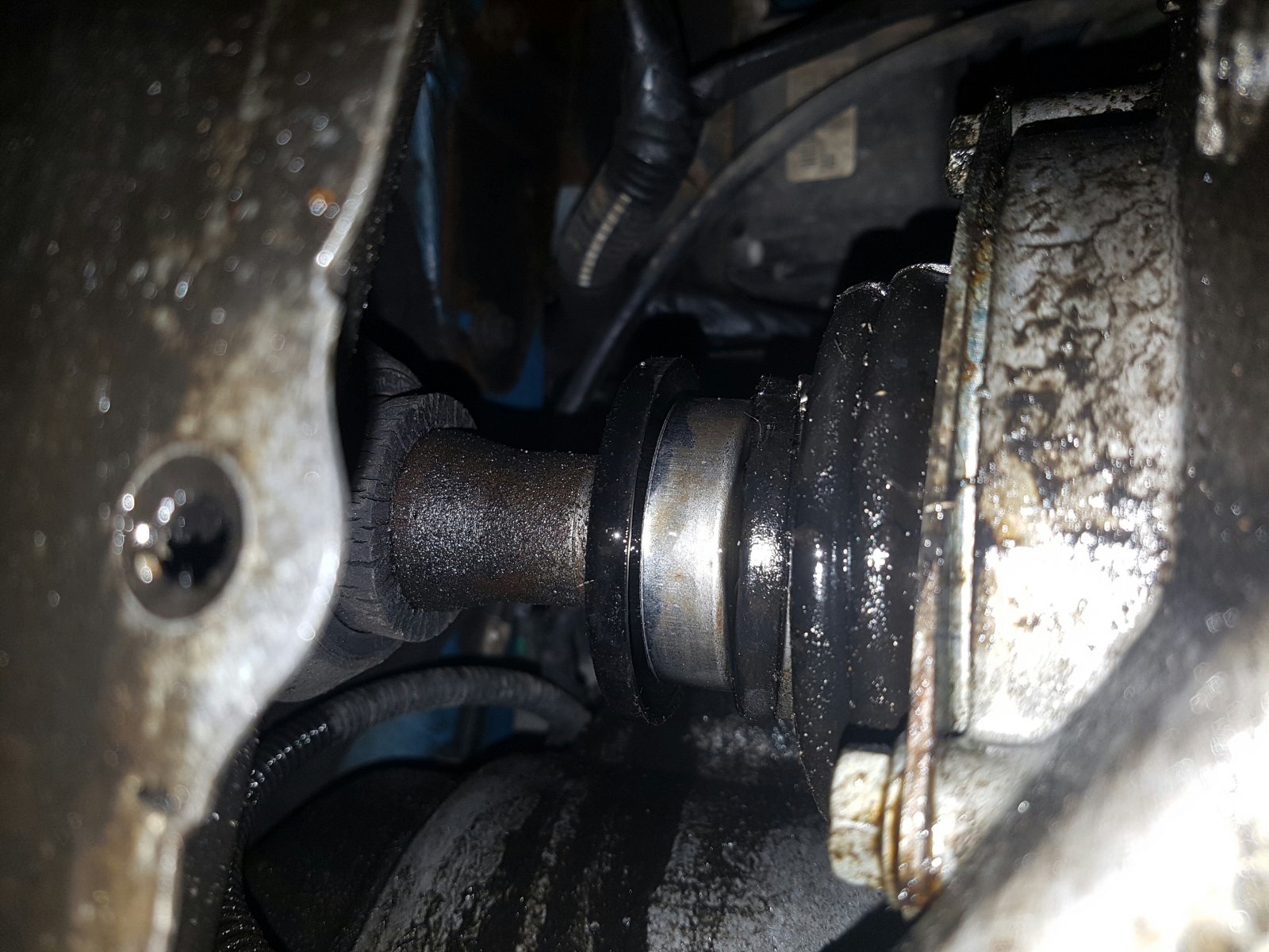

Happened today while removing the hub to do a bearing change. Turned out the spline was seized in the front hub and was pulled out while the hub was removed.
This is what I have. What's the deal here? How do I refit the rubber? Process to what's next?

Pic is taken by looking underneath it with the hub being on the left hand side.

If you cannot work the boot back onto the shaft, remove the 3 bolts holding the retaining plate to the box to give you something to work with.

After some research and a phone call from my good friend Alex (AlexW on here) all I need to do is undo the 3 bolts, pull out the shaft and refit the rubber and reverse the process. This has been clarified by @stevem :)
