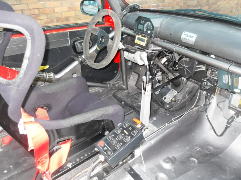

Liking the car, ive got a cup racer which is converted to RHD so if you have any questions just PM me. Looks like and ex TCR car that like mine, interior is the right colour for it.
Loving the hairdryer in the corner of the dash aswell, the heater/blower on them really is poor.

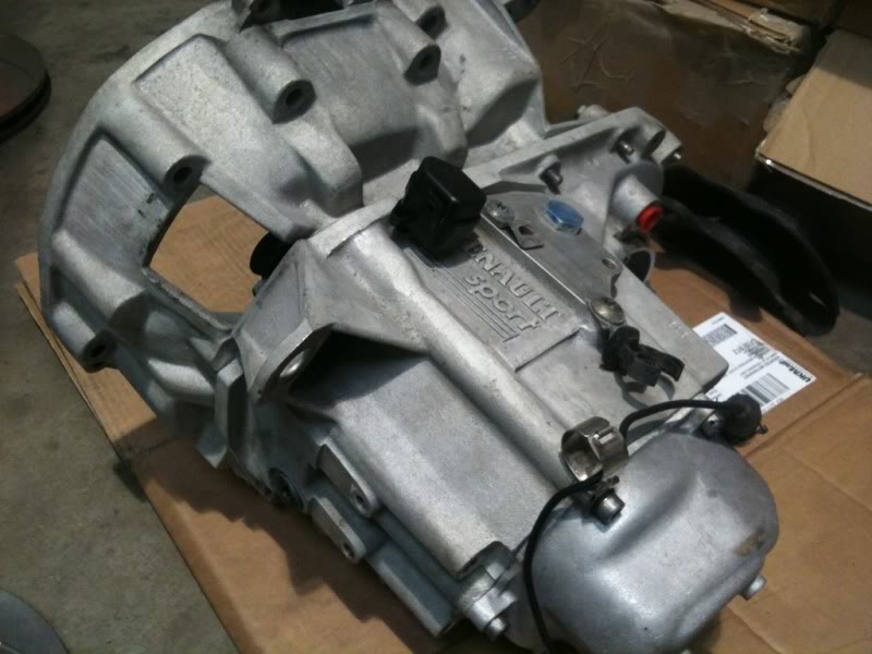

Well made a start on the car today , removed the engine and box , the box has been sent off to have a lower crown wheel and pinion fitted to lower the top speed and bring the gears closer , I have order suspension from Reiger which should be ready in a few weeks , while the engine is out we can modify the bulkhead to change it to RHD , its off next week to have the wiring donethen .
I have a guy round the other day taking details and measurements to make me a kevlar tank and sump guard
I have entered a rally on the 28th December so need to get moving on it now , its going to be a close call to get it ready in time

Project looks great and I love the look of the super 16 myself. Can anyone tell me where you can buy that dash? I have seen that now in a few race cars but can't seem to find who sells it.
  clio cup race car
The dash was supplied by Renault sport , not sure if you can still buy them , I need to swap the 'pod' over to the right side , the dash is only made of plastic so whatever I cut out of the drivers side to fit the dash i'll have plastic welded into the hole in the passenger side and then get the dash flocked

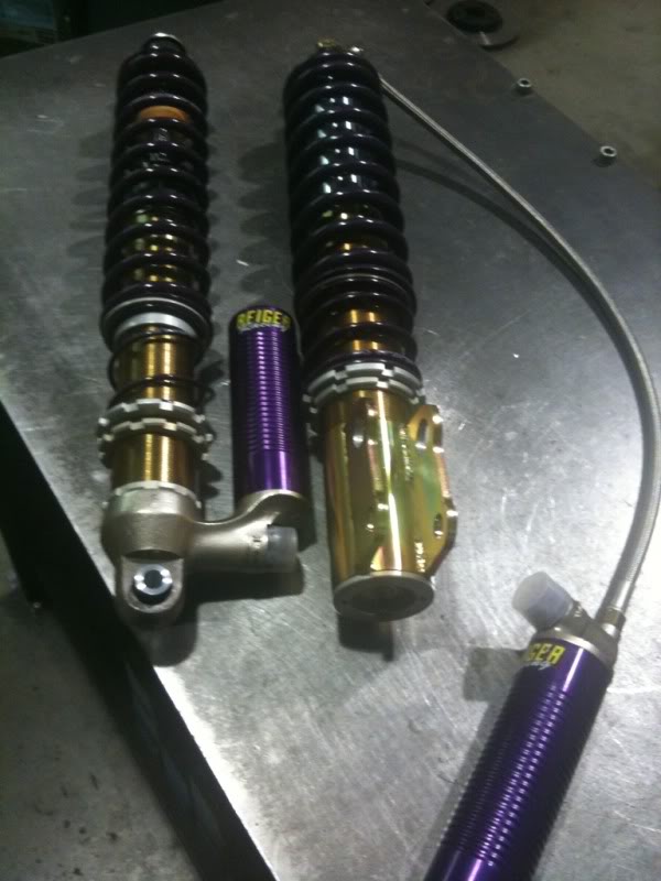

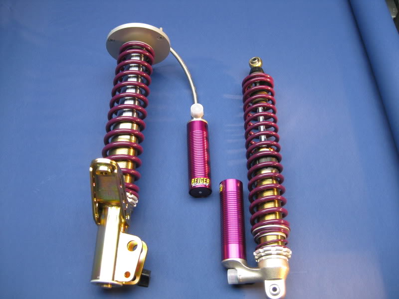

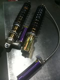

The suspension is costing £2600 + vat , which for what your getting is a bargain , still hoping they haven't cocked up on the price as I was expecting double that from Reiger !
They sent me this email of a kit they made for another car to give me an idea of what i'll be getting

The suspension I am having is 3 way , the cans you see have 3 adjustments , high speed bump , low speed bump , and rebound , you can fine tune how the suspension reacts on different surfaces.
The suspension you are having are only adjustable for height , and are very basic to the ones I have ordered , AST also make 3 way suspension with a retail over £4k , I expected the Reigers to be over £5k as they are the best of the best , in the back of my mind I still think they have quoted me wrong , so I'm keeping my fingers crossed for the next 3-4 weeks until they arrive :D

There will only be small holes where the bincale use to be from the rivets and 1 hole about 12mm big where the plug for the display comes through. So you shouldnt need to cut or plastic weld anything really, Just a bit of fibreglass to fill the holes should do the job.

Had a good run on it today and the steering wheel is on the proper side now :D finally received the bulkhead bracket from cliospares after waiting for about 6 weeks for it ! , so removed the dash , the fuse box in the footwell , measured where to fit it and welded it in place , and took a nibbler to the bulkhead and cut the hole out for the steering column to fit through , refitted the subframe and the RHD rack to make sure it all fits and works correctly.
Just need to sort out the pedal box now , the nibbler will be back in action to cut the bulkhead to fit the servo ect on monday.
My cup suspension I sent to Holland for them to measure to make the new stuff was sent back to me yesterday so hopefully by mid week I should have the car back to get it mobile so I can trailer it to the electrician to sort the wiring out.
The gearbox should be back with me mid week as well , they said the gears were looking fine so nothing needs doing apart from changing the CW&P and some bearings and gaskets
So its all coming together , hopefully it should be ok for the rally the end of Dec.

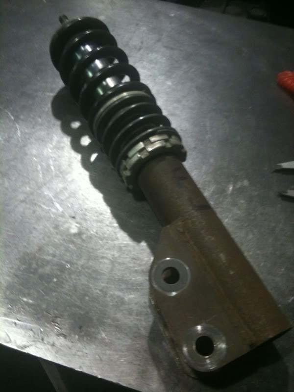

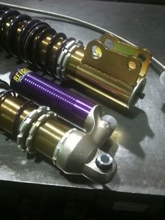

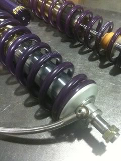

The suspension turned up today , I had my doubts it would at the quoted price so over the moon it did
This is a Renault Bilstein strut
And this is whats replacing it
Just need to get them on and set the heights , then the job of setting them somewhere close for rallying in the lanes.

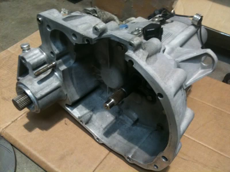

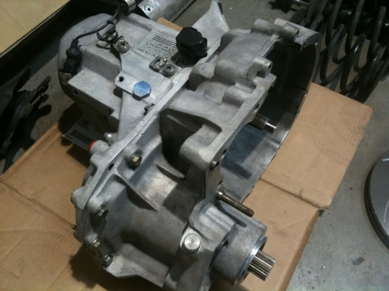

Had the gearbox back from a strip , check and have a change of crown wheel and pinion to bring the top speed down

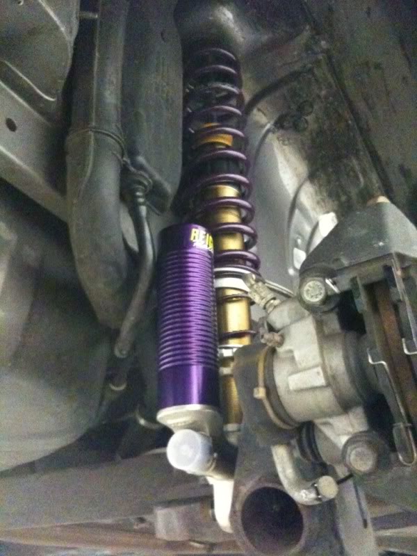

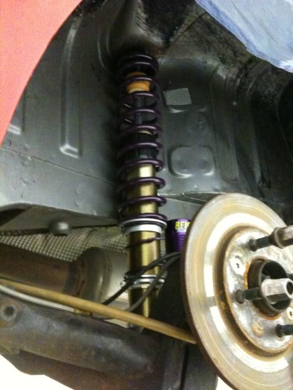

Got the rear fitted on yesterday , the breather for the tank is in the way of the O/S can on the bottom of the shock , so will have to move the breather pipe , apart from that it all fits nicely
When I get a mo I'll fit the front on !

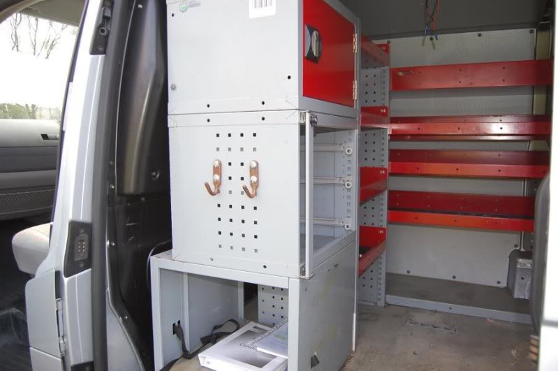

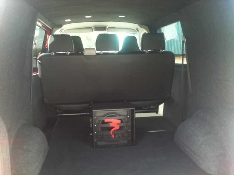

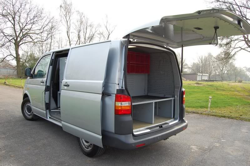

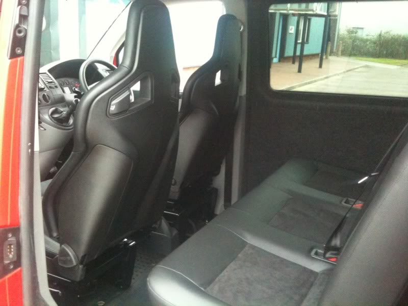

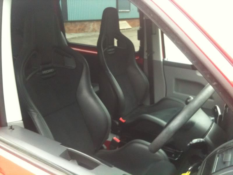

Been busy buying a new van and trailer , started off with a bog standard 2.5 VW transporter panel van
A Ferrari red paint job , coilovers , 22" wheels , Recaro CS's , rears seat recovered to match , and fully boarded and carpeted , side and rear windows , an awesoome sound system , finished off with a Hybrid turbo and mapped to 190hp !
