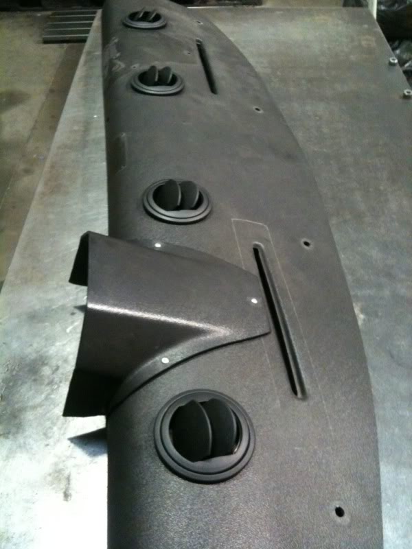

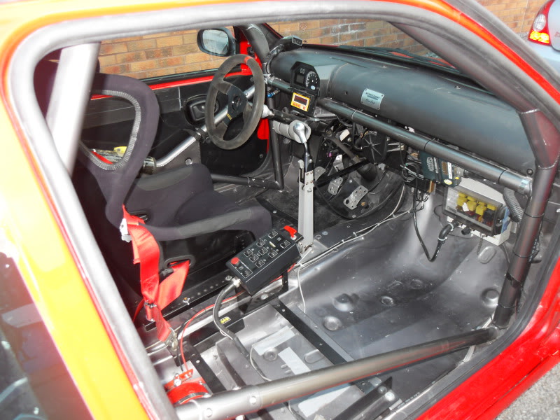

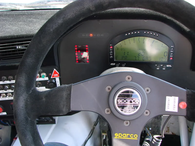

I have sorted the dash top out now , changed the digital dash cover over from left to right side , and cut holes for the heater vents , hopefully no more misting up in wet weather !
Got a got coming to collect it today to flock it , I will then put the ID plaque back on in the middle showing the build number
Took the dash over to the car today just to check it all fits and the vents don't get in the way of the cage or bulkhead , all fits fine , and the wiring is coming along nicely

What are you going to use to feed the new heater vents? the standard blower they come with is about as useful and a chocolate fire guard.

Didnt realise you were converting it to RHD. What messing do you need to do with the drivetrain/steering etc? I presume the hole for the steering is still there?

No its not its a rally car , and will be used on closed roads , which includes lanes , as I have driven RHD all my life , if I went out and drove flat out in a LHD car I would end up on my roof somewhere , I know where my ass needs to be in relation to the road , it also comes natural if I need to use the handbrake , all this would be unnatural if I was driving a LHD car and my stage times would be much slower.

No I had to cut holes in the bulkhead for the pedal box and steering column , had to measure and take templates from the RHD shell I had , mark up the race car bulkhead , double and treble check it all , then attack it with a nibbler ! , and then weld in the bracket to hold the top of the column.
All worked out fine though

On the bulkhead , you can see when its been pressed into shape , you can see where the holes should go as you can see some of the shape , just takes some perfect measuring , and guts to actually cut the holes the correct shape and size lol

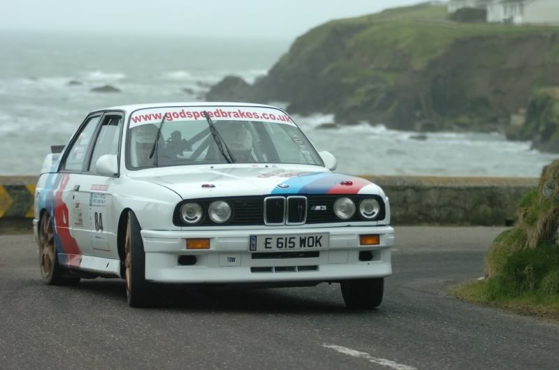

M3's are better RHD lol

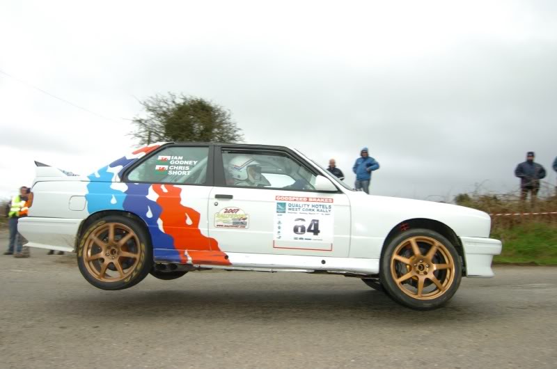

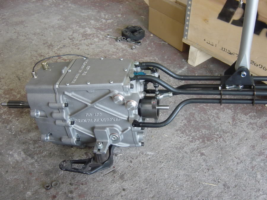

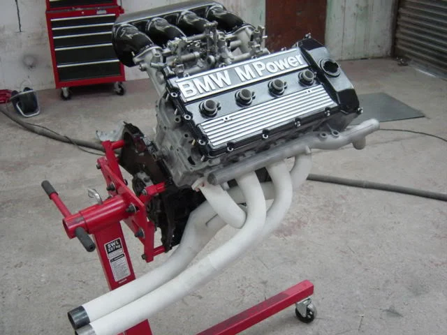

I built that up from scratch making it RHD , and it handles very well , would happily swap stage times with WRC impreza's and 6R4's , it was a 2.5 running some Prodrive DTM spec cams , pushing out 316hp through a Drenth 6 speed sequential gearbox , spent nearly £50k building that then realised it was too much money to have tied up in a car that could get wrecked and lose it all , so sold it. Awesome car.

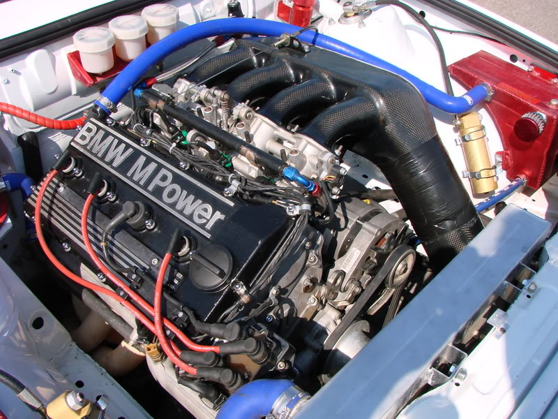

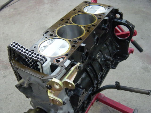

Awesome pics :) but 50k in a car that could easily be smashed up by a simple mistake is insane so good choice in selling it, love the engine pic especially with the carbon airbox i take it you was using the alpha-n management?. Was that a originally a 2.3 but been bored out and internals put in to make a 2.5? normally the 2.5 had the rocker cover in White with the m strips over.
I love the induction sound of these when fitted with a carbon airbox sounds mean as especially when there screaming there nads off lol.

Is that first M3 pic on the Isle of Man? Seem to recognise

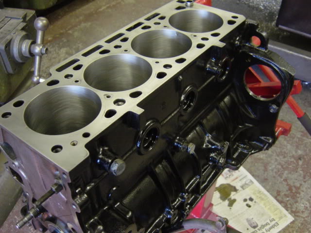

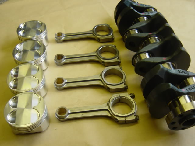

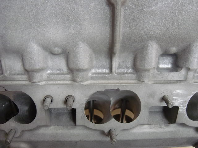

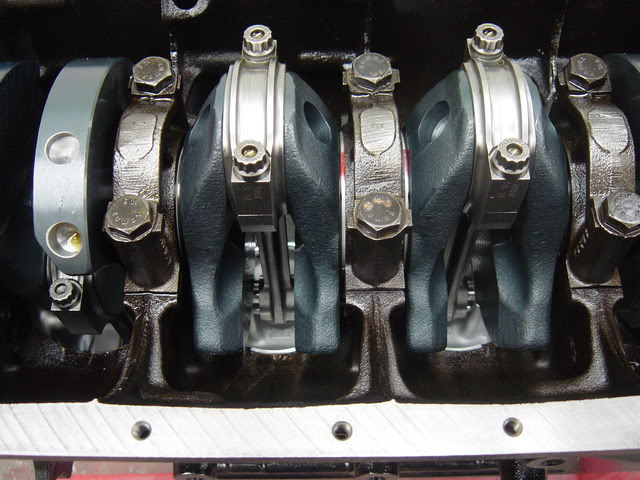

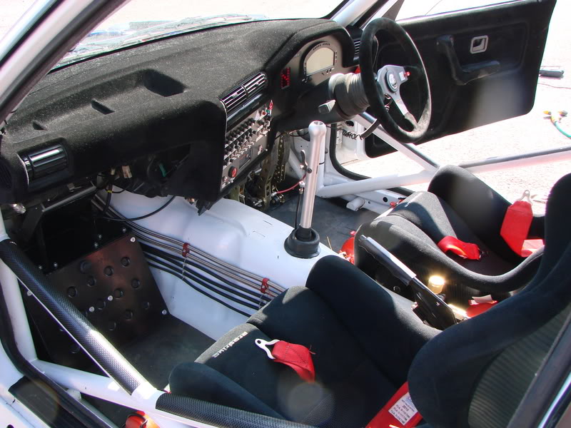

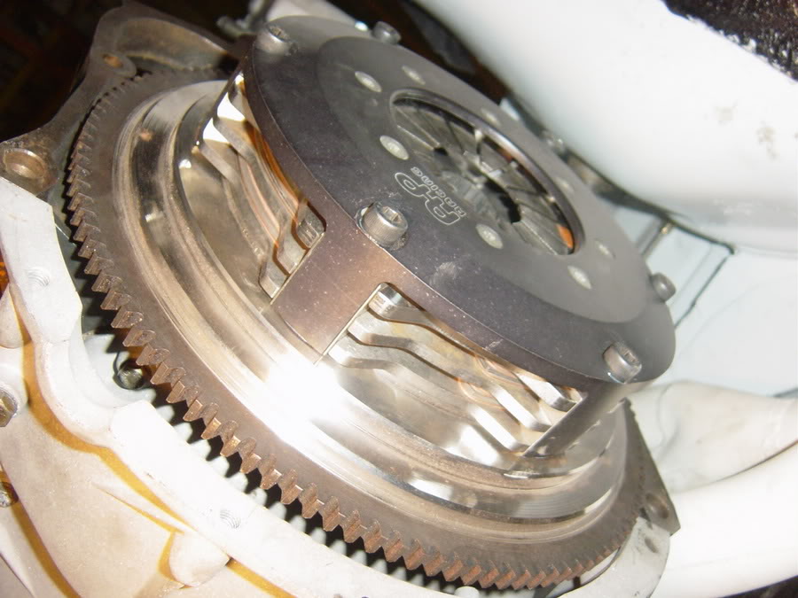

I bought an M3 road car as a donor , it was rough , but I had bought the shell with the welded in cage , so just needed some parts from the road car , it was a 2.3 , but I bought a brand new 2.5 block from BMW , and a 2.5 crank , and bought some steel rods and forged pistons , had the head ported , had some DTM vlaves , shims , valve springs and cams , also got some 2.5 48mm throttle bodies , carbon airbox , and a DTA pro 8 ecu , had a manifold and system custom made , the manifold had to clear the steering column , no LHD one would fit.
It had the best of everything , inc £8k worth of gearbox
The picture is not in the Isle Of Man , its on the ring stage of the West Cork rally in Ireland , a very famous bend , driving LHD is easy on a track compared to a one car lane flat out , at least on the track you have plenty of room either side of you , get a wheel off the road in the lanes and it drags you off

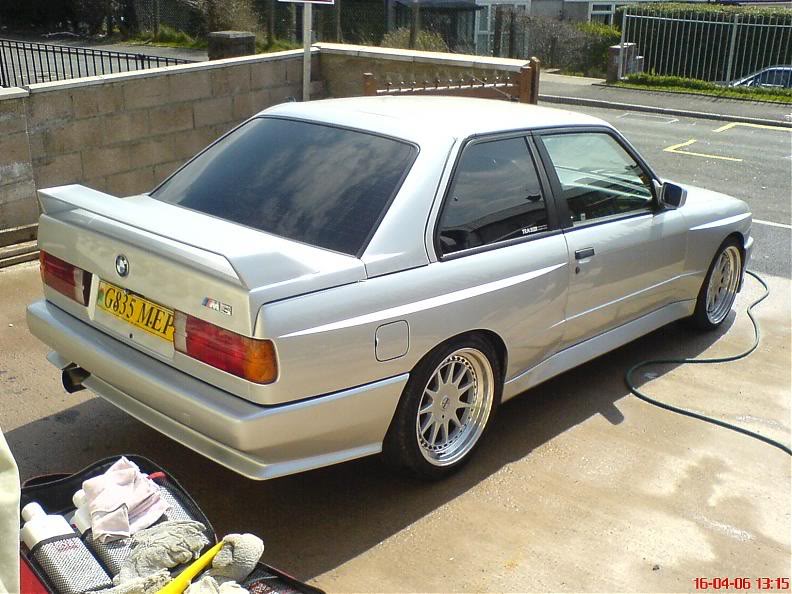

Just been looking through your threads on there didn't realise that the M3 was done back in 2005, you were lucky to have done it back then as the prices for the M3's have shot up stupidly now (I'm not complaining though it makes my car worth more money) :).

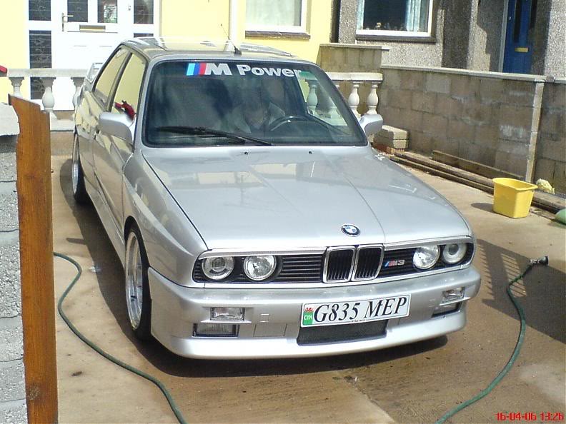

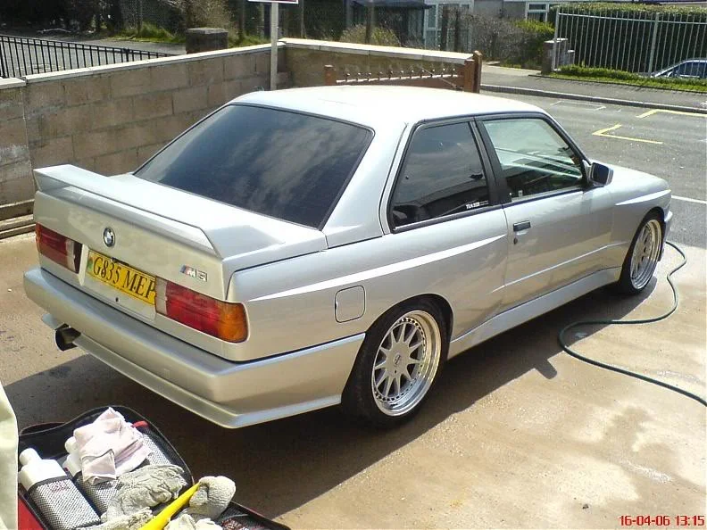

Not high jacking your thread but here's my car it has 60k and im the 1st uk owner although a few things have been changed now :D.
