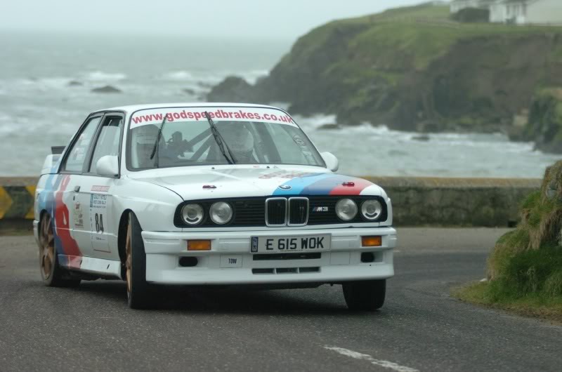

Yes I have been coming to the Jersey rally for the last 7 or 8 years , last competed about 4 years ago in My M3 , but the brand new gearbox jammed in gear on the first stage !

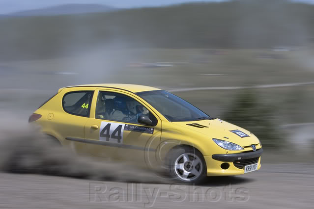

Why ? I have done loads of gravel event in FWD and 4WD , I had a 206 cup car that you could throw around like an Escort , sideways everywhere , it was a lot of fun :D
Because I've never actually done it.
Being so used to rwd all my yoof and rallying days,I would just be worried natural instinct's would take over.
I know I race a fwd,but it all happens a little slower and there are no trees.
I'm sure after a little practice I would be fine though.
I was brought up on Escorts so know where your coming from , this was a handfull in Ireland through the slippy lanes with 316 hp !
My old 206

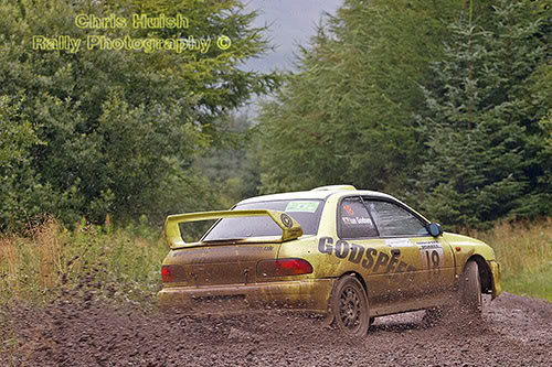

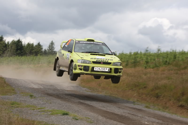

Then how an Impreza should be driven lol
With a front wheel drive car on gravel you need to be braver on the throttle keeping it down on the bends to drag you round , where as a rwd you can drive the car easier on the throttle keeping the back end out , once I got over that , I found FWD good fun
