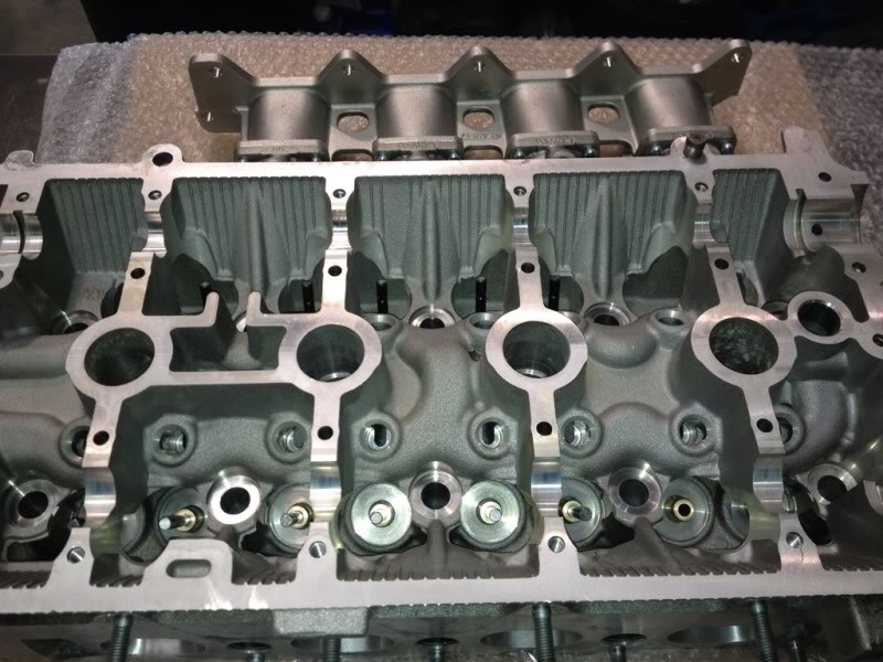

I have sent the 'inbetween' engines head off today to CNC heads to have a full porting job done on it , I have sent the supertech valves to them as well so they can recut the valve seats , they have said they should be able to turn it around in 10 days , will get the block off the South Wales pistons in Cardiff in the next few days so they can rebore it so I can build the bottom end up in time to get the head back , I should get the cams from Cat next week , so hopefully in the next 2 weeks the engine should be close to being built ready to be dynoed.
I'm doing another rally in a month so would be nice to have it fitted in time for it :D

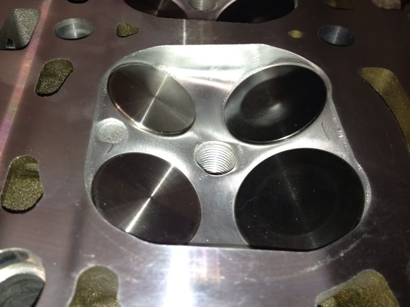

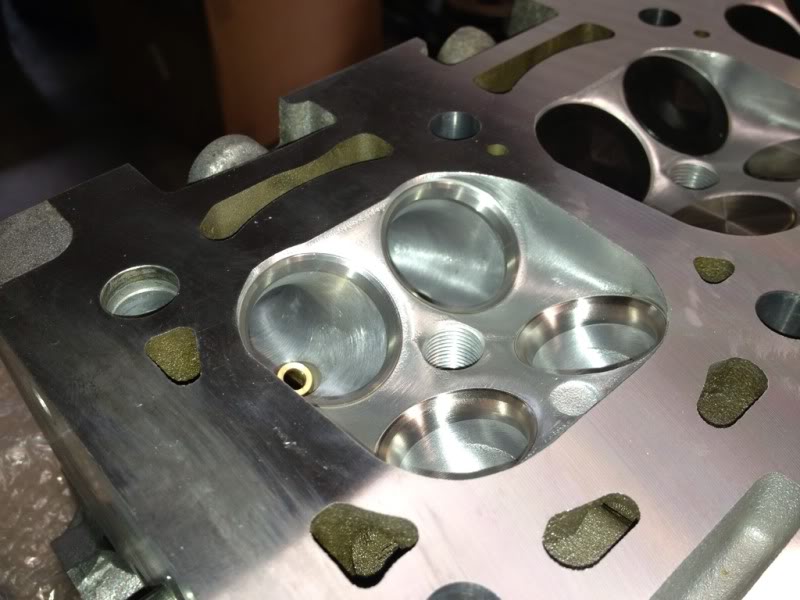

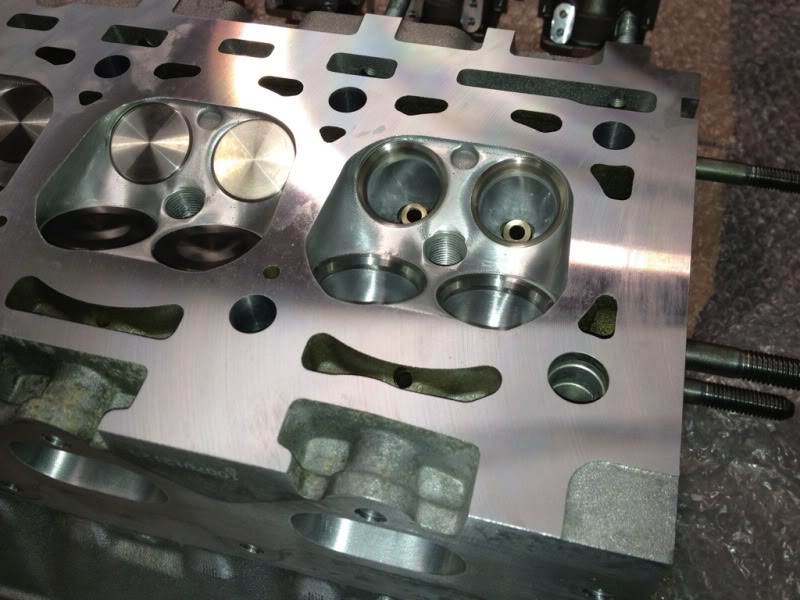

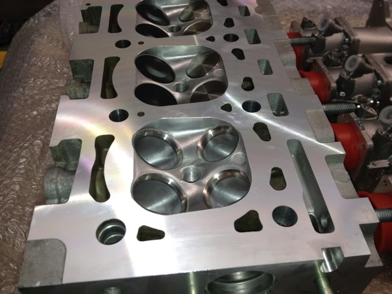

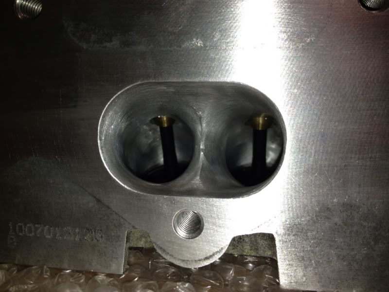

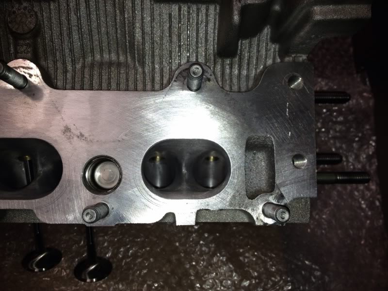

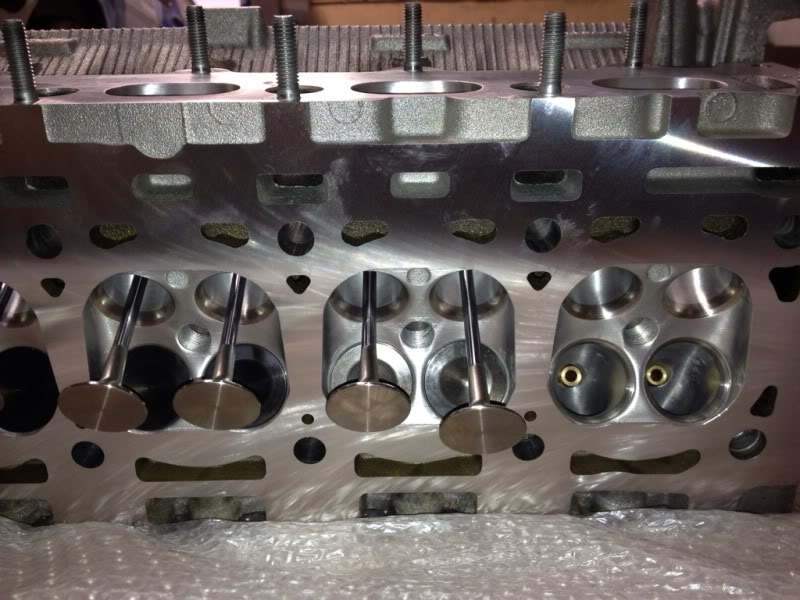

Just received the head back from CNC heads , they have fitted new guides for me as well as a full porting job , re-face the head and re-cut the valve seats , all looking nice a pretty !
Should be able to build the head back up in the next couple of days , still waiting on the cat cams at the mo
