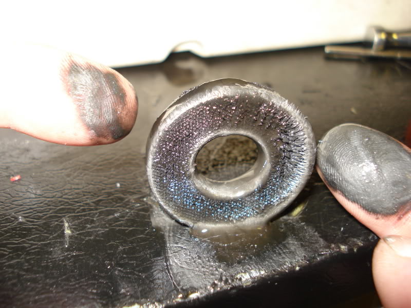

Had SWR contact me back yesterday by email and they are saying the box problem was caused by a sludge given off by the diff plates slipping , they have said its loosened off quite a bit over the course of the rally I did and the sludge has got into the bottom of the box causing the problems with the gear change and flat change , so will have a chat with them this morning to get the diff rebuilt to stop it happening again , they were saying the flat change wasn't setup properly , but thats been working perfectly for the last 6 rallies and the Llandow track day so I couldn't see it being that.
This is a picture they sent to me showing the sludge around the magnate
Cheers Ian
Yes the photo of the sludge if from my box they took yesterday and emailed over to me , had a good chat with Steve today and what he says is making sense , the sludge is off the plates in the diff and shows the diff has been worked very hard , in Caerwent where the rally is it mainly made up of mostly straights and first gear 90 degree bends , it's a car breaker of a rally , which pulling hard out of the corners is working the diff real hard , thank god the championship is not going back there this year again , he said my diff has slackened off quite a lot from last week when it was rebuilt , so they are going to sort it out and tighten it back up , and I'm going to look at fitting an oil cooler , and plan on changing the oil every event , and remove the pin at the bottom of the box to clean it out at the same time , so hopefully will keep on top of it and stop it happening again , they had a few similar problems on some of the race cars , but the race cars never had to put up with what mine did last week ,
Ill see how I get on with it on the next couple of rallies , at least they will be fast flowing events so should be easier on the whole car
Seems feasible but you would think a gearbox that was designed to go on a Group A rally car would be able to cope with one though rally. But obviously not lol
