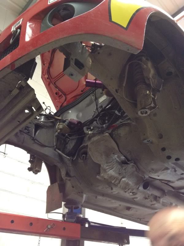

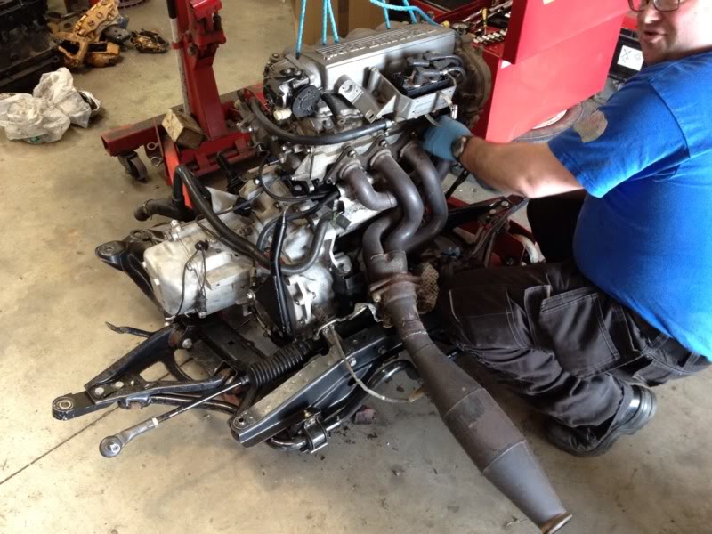

whipped the engine and box out and bought a new flywheel and clutch plate , and had the plate re-paddled
All back on the subframe , fitted a new water pump and track rods while it was apart

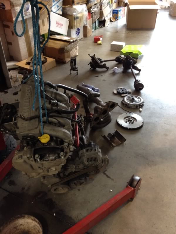

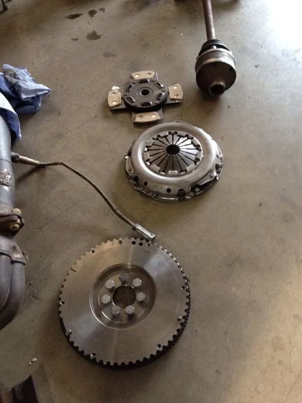

Had an up and down day yesterday , about a mile into the first stage the new clutch started slipping , we lost quite a bit of time , I was hoping it was just bedding in , it was better after it had cooled down and went out on the second stage , and did seem better the further we went , but even towards the end of the day , even if you touched the clutch by resting your foot on it it would slip , so the engine and box has to come out again now to see what the problem is.

My Helix clutch was just like that when new along with a new flywheel. Just puting my foot on the pedal would make it slip, Now they seems to be worn in and works prefect.

I stripped it all apart today and can't see anything wrong with it , there seems plenty of clamping force on it , tried speaking to someone at helix but they took my number but no one called me back , will have a call round tomorrow with those in the know.
Measured the room I have for the thrust bearing incase it was tight and putting pressure on the clutch cover , but there is plenty of room , so I'm at a bit of a loss , never had a problem with a paddle clutch not biting , but then I've never fitted a brand new flywheel before so might just refit it all and put some road miles on it.
I think it is the combination of new plate + fly that does it. Now when the clutch bites my flywheel have got a goldish surface on it. Seems like some of the material on the pads have transfered to the flywheel. My guess its like beding in brake pads and it takes some time to get it right. Put some miles on it and it will work great.

Why do you take the engine out to do clutch? We did a lutch on mine in pits at brands in just under 2 hours, it slipped until we gave it extra cable, then it was sweet.

Its very easy to drop the complete subframe with engine and box ect on my ramp , I can have it all on the floor in 45 mins , and I wanted to get a better look at the thrust bearing in place to make sure it wasn't dragging .
I ordered a Helix cover for it today as I don't think the valeo cover is clamping it tight enough , I can move the clutch arm with one hand quite easily when the box is on the engine , I think the cover is faulty , it should be tighter than that to move , my sons 1.6 205 clutch arm is way harder to move

I have fitted a Helix cover on friday and I cannot move the arm at all by hand , so the Valeo cover must have been faulty , just need to refit the engine and box and give it a try now.

Went and competed on a rally yesterday in West Wales , gave the clutch a good test and its perfect now , had a very good day , nothing went wrong with the car apart from hitting a big tractor tyre and snapping the corner of the front bumper off !

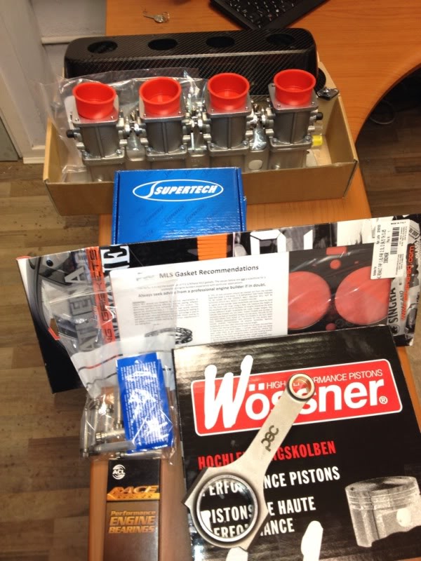

Had some deliveries today , I'm going to be building an inbetween engine to give me some more power now , someone I have spoke to is doing a lot of work on one of these to get some silly power out of them so if that all goes well i'll have one of those
Got a standard engine off someone on here , so will strip that down in the next couple of days and get the head off to be ported ect , got cams on order from CAT , went for 423's , had a good chat with them yesterday and they have a solid lifter conversion with solid followers done now , they can supply it in a kit with cams , pulleys , springs ect and it works out at around £3k with a 4 week ordering time.
Got my throttle bodies , valves , wossner pistons and steel rods , so hopefully have it ready to fit into the car in the next 2/3 weeks :D

Some nice looking parts, same Jenvey's as in mine, i would of thought you would of gone for the newer Direct to Head Throttle bodies thought they are better?
was told by a few people that the tapered ones are better , they are used on the Millington engines which are about the best engines used for rallying today so can't be that bad

nice looking engine spec going in there Ian. Presumably you're doing full ACL bearings, lightening the crank and wacking a lightened fly on for good measure? What bore are you going for?

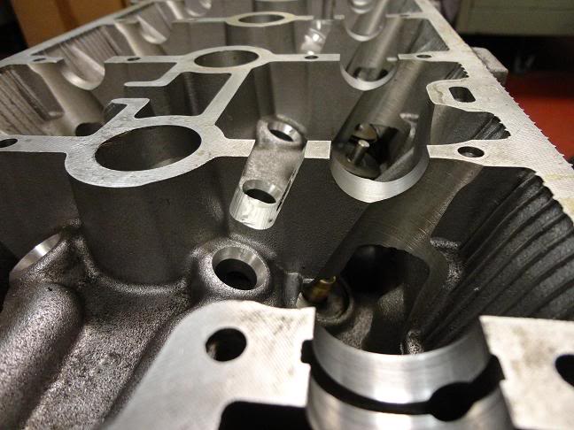

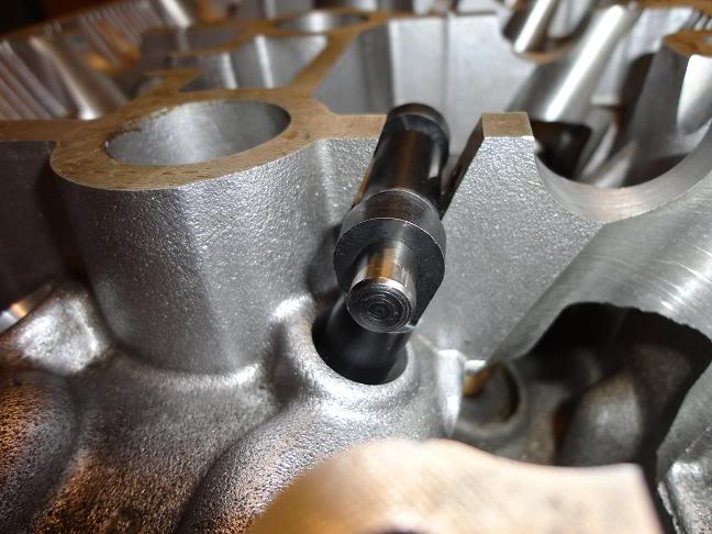

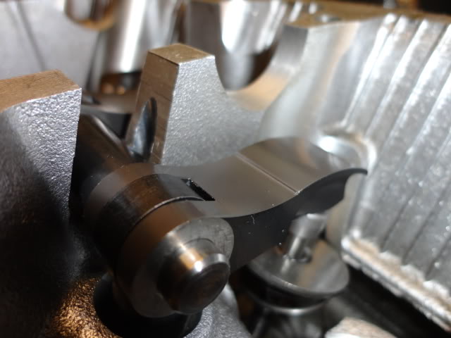

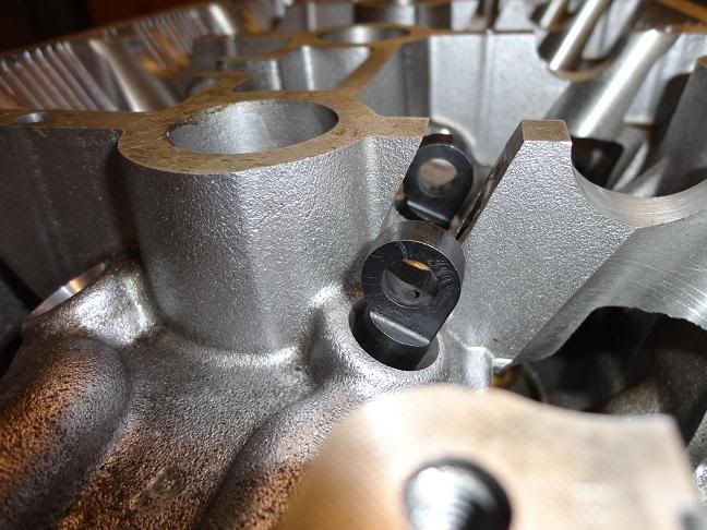

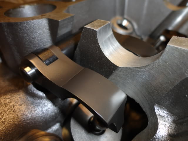

Had a good chat with the guys at Cat regarding there solid lifter conversion today , took the plunge and ordered one , there are a selection of cams available , and comes with solid lifters , followers , double valve springs , cams , cam pulleys , they say it will take 9k revs ! looks like a good way of making the top end reliable and getting away from the standard follower problems.
ian-speedy
  clio cup race car
The head needs machining as the followers are connected to each other with a rod
