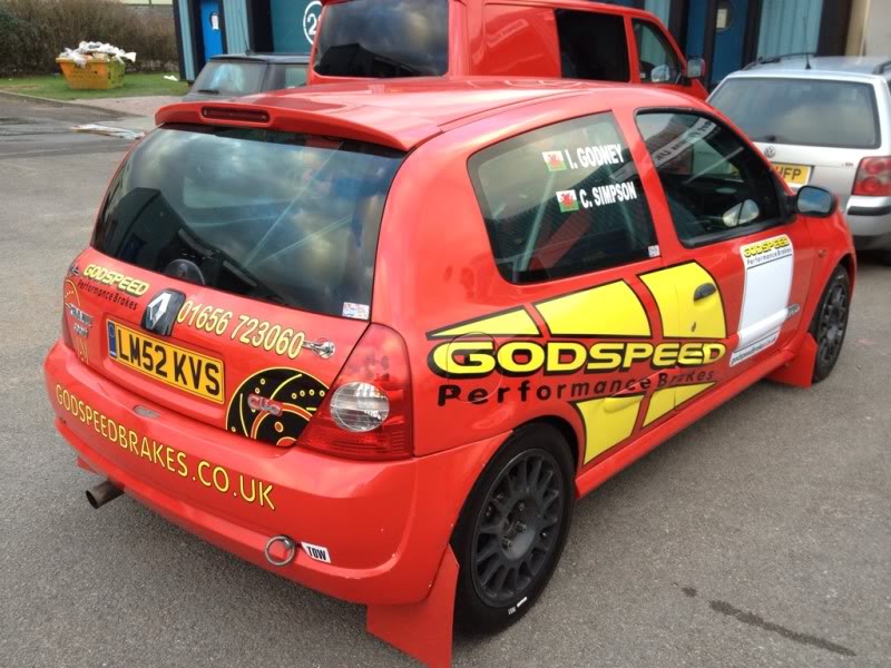

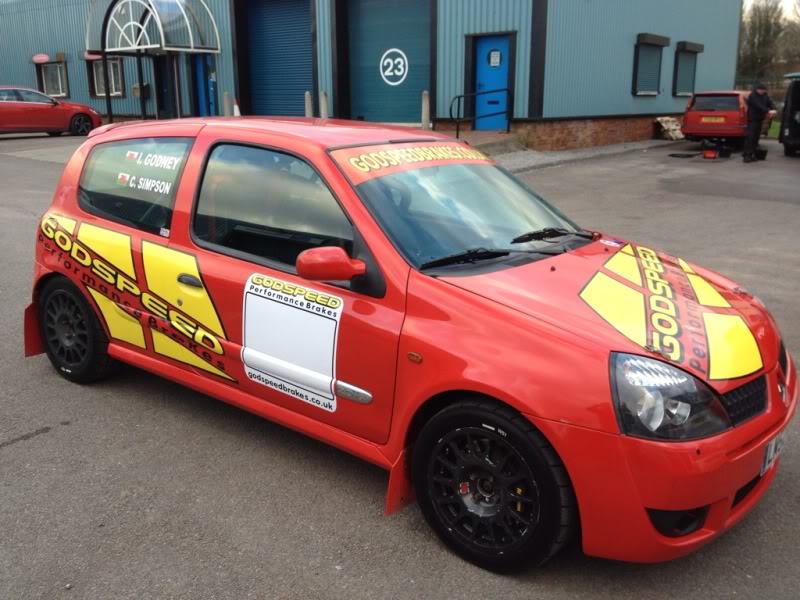

Just a quick update , the cars all fixed and ready and I'm doing a rally on sunday in Pembrey race circuit , here's hoping for a better result than the last time out , had the car all stickered up ,

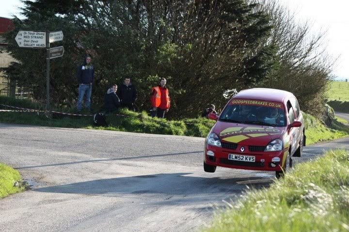

Had a good day today , although we went off the road and got stuck for 45 seconds before being pushed out on the first stage , and suffering a misfire for 2 stages which turned out to be some water in the sparkplugs , we managed to get 10th overall and 4th in class , had a good day and learnt a lot about the car

Got sent some pics this morning of yesterday , quite like this one , little tug on the handbrake to bring it round ready to go again :race:

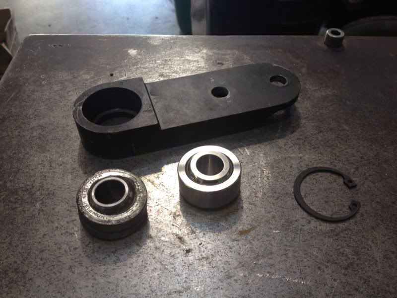

Had issues on the last rally where the lower ball joint nut kept coming loose , found out it was the rose joints had seized , spoke to various places about new ones , as the original ones need greasing , I have changed them to PTFE lined ones and see how they last
Off to Ireland in a week for the West cork rally so see how they cope , I have some spare ones just incase as well.
