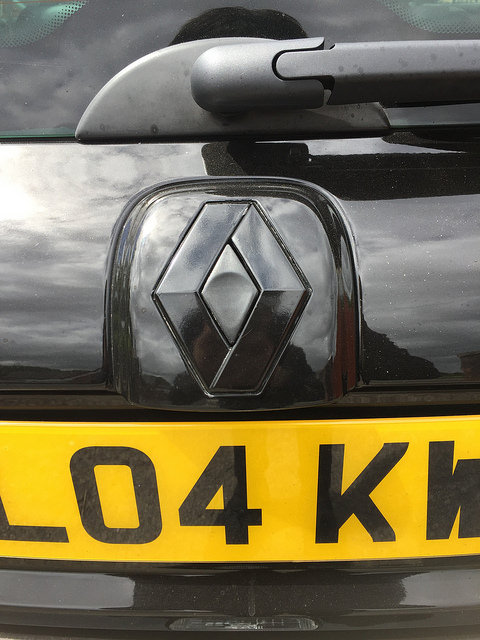

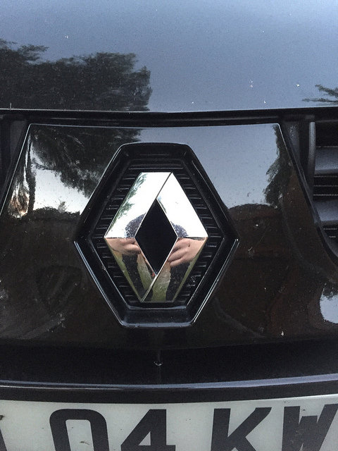

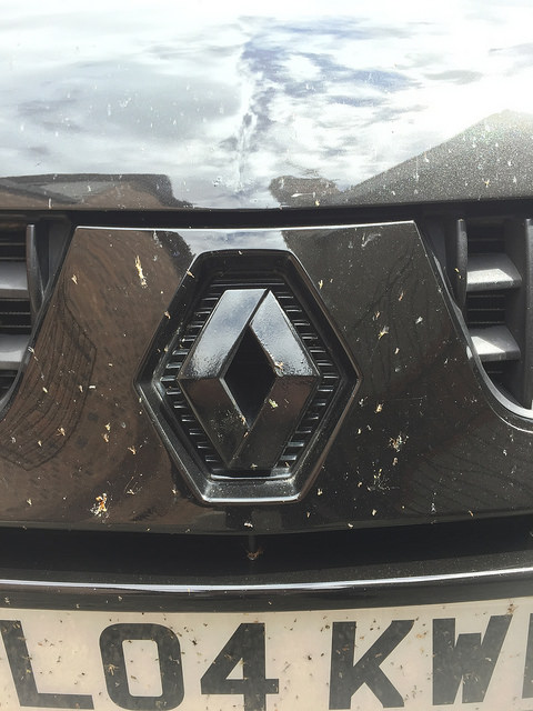

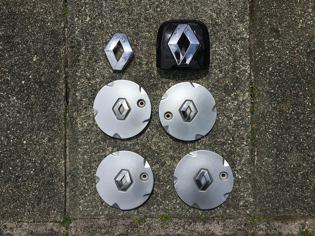

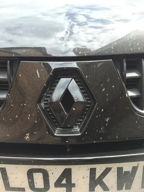

Firstly, got around to getting rid of the black diamonds, they'd been bugging me for a while but I was busy fixing/improving other things. But a scour of eBay later and I'd sourced a BG rear bottled handle with the diamond, a front diamond and some centre caps from a 1.2, which use the same centre diamonds as the 182 ones.
BG 182
by Niall97, on Flickr
Old diamonds were a bit tacky for me, didn't mind the black front one too much but at the back and on the centre caps they looked a bit naff. Plus I'm sticking to a black/silver colour scheme what with the standard interior dash strips, boot badges, bullets etc, so these silver ones were the final piece of the puzzle for the outside of the car.
Old (excuse the flies I massacred on the way to collect the new exhaust):

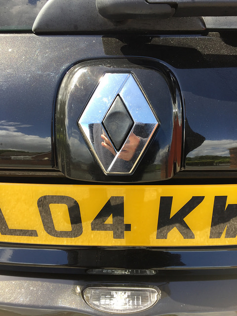

Looks much nicer now, a lot cleaner and more tasteful. Can't beat that clean OEM look with the right additions around it.
BG 182

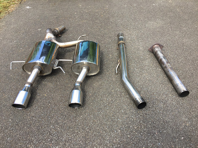

A couple of nights before I finally found a Milltek Non-Res & Decat system through somebody on CSOC on Facebook and went to collect it. I'd wanted this exhaust from the beginning; the best sounding system for the 182 IMO. They feel like a quality bit of kit and of course the reputation of Milltek.
BG 182
BG 182

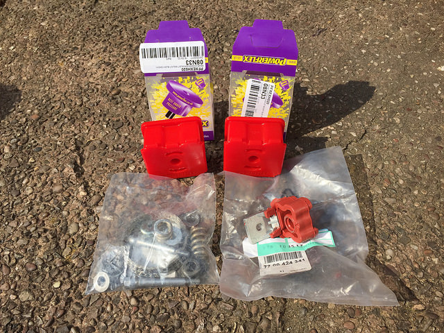

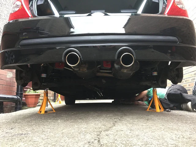

A few days later, my Powerflex exhaust mounts, new genuine centre hanger and new genuine fitting kit arrived. So this meant I could get on with fitting it.
BG 182

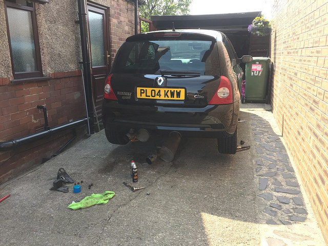

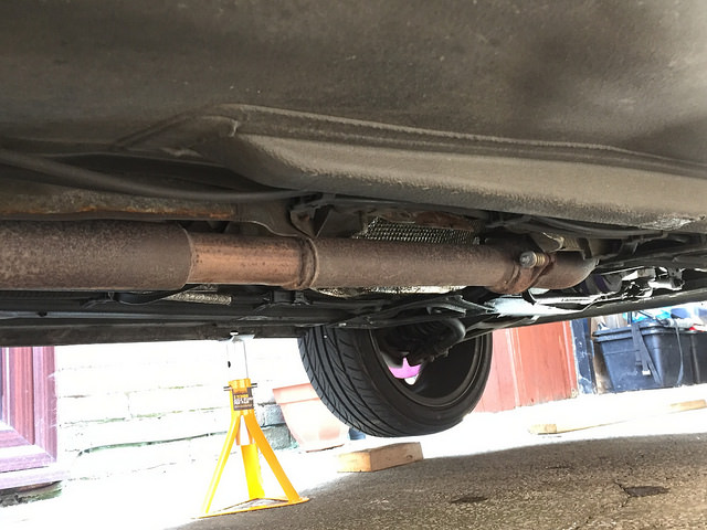

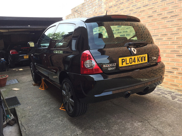

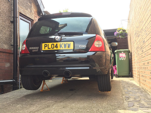

Got the car jacked up on my new axel stands, they were 50% off at Halfords so got all 4 for £20, bargain!
BG 182
BG 182

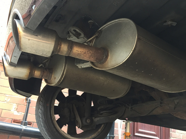

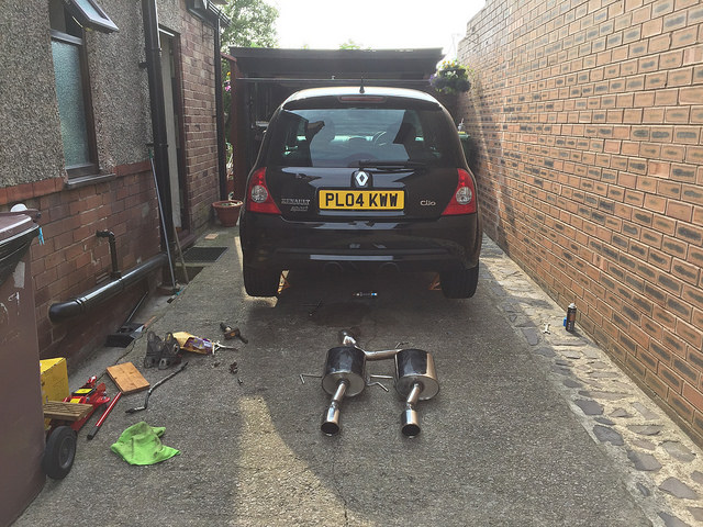

Now for my old exhaust, it's a Powerflow custom exhaust, and the receipt is from 2005 lol. Also, somebody had done some questionable work attaching the decat section to the centre section. Also had some awfully filled in exhaust mounts I couldn't stand, worked but just not for me. So clearly this had to go, it sounded okay, very raspy but it just lacked any tone on the throttle despite being a similar design to the Milltek. No blows or anything, works for what I needed but it was time to replace and refresh, as well as preferring the sound of the Milltek.
BG 182
BG 182
BG 182
BG 182

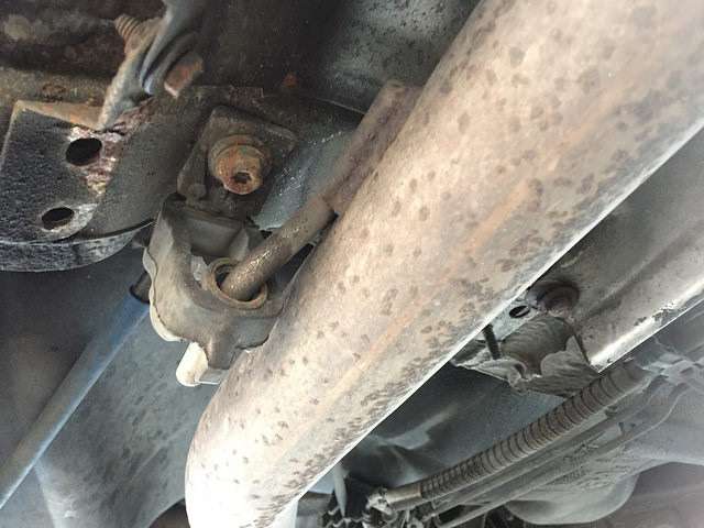

I set about soaking these years old nuts and bolts in penetrant, and gradually wrestling the thing off the car. It was a bit of an awkward task being on your back on the drive on your own, but slowly but surely it was coming off. Snapped two exhaust mount bolts which was annoying, but I couldn't have done any more, used lots of penetrant on them and used my shock and unlock but it seemed they were past it, so this will be being sorted this week so I can get some new bolts in there. This is how it was looking at this point.
BG 182

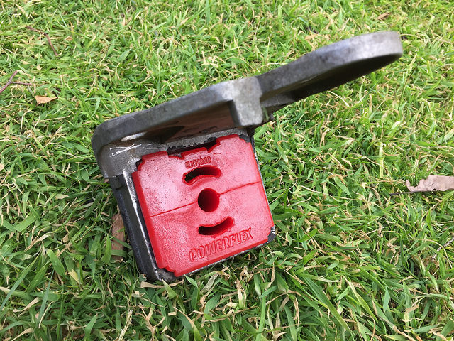

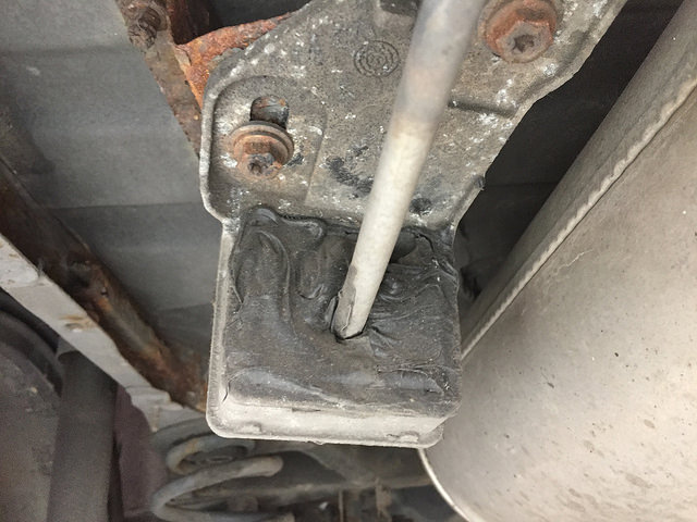

I then set about hacking all of the old rubber out of the old mounts to make way for my nice new Powerflex mounts. As always with Powerflex, they fitted like a glove and are a quality bit of kit, couldn't be happier with these, they look so tidy and purposeful under the car.
BG 182

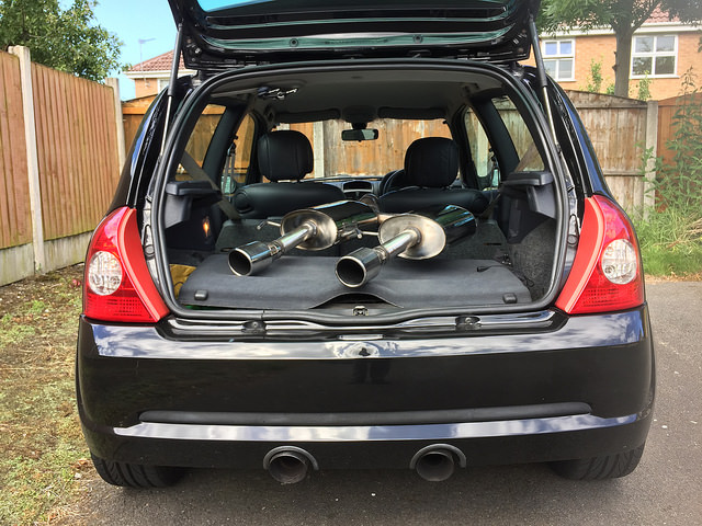

Half way there, and managed to wrestle the centre section and backboxes apart after much swearing and penetrant, and it was finally off. Time for the new Milltek.
BG 182

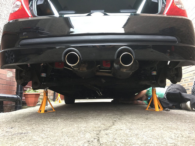

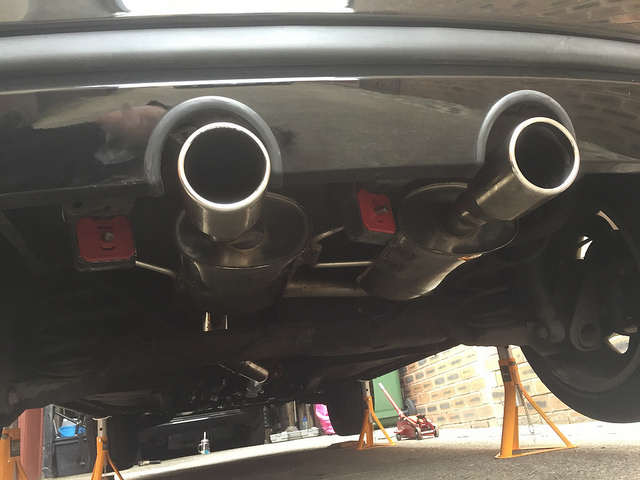

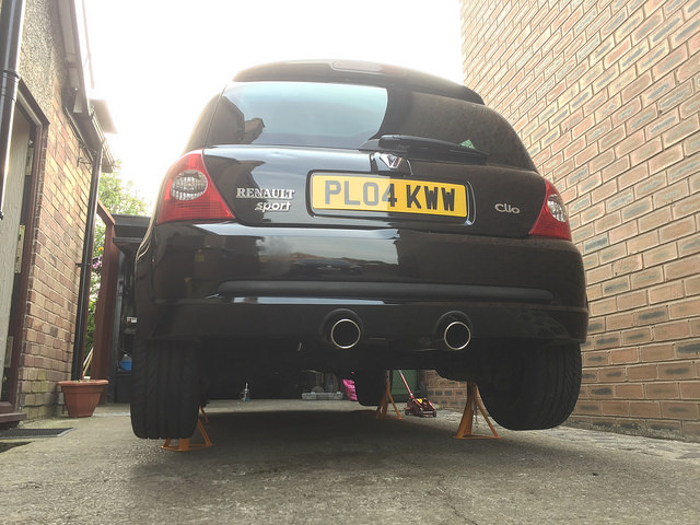

Aaaaaand it's on. Very happy with how it looks, so shiny and in combo with those red Powerflex mounts it just looks so purposeful and clean under there now, one of those very satisfying car geek things lol.
BG 182
BG 182
As you may be able to see it's hanging to the right, and the left exhaust mount is only being held with 1 bolt which won't help. So it's going up to @bloke this week to get the old bolt threads removed so this can be sorted, and then drilling the mounts so I can move it over to the left so it's lined up nicely.
And of course the noise, it'd be rude not to.

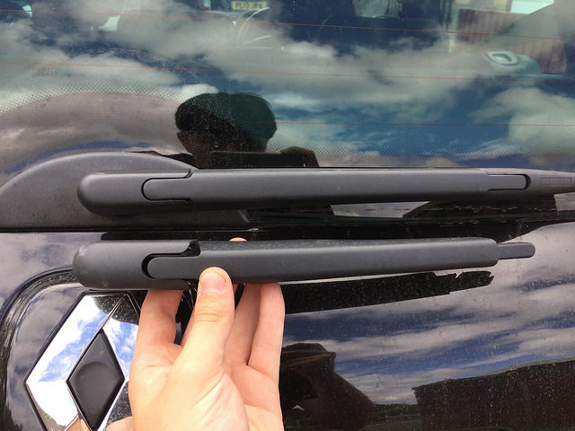

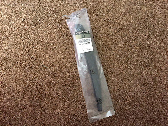

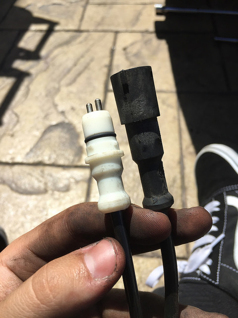

Final thing is an OCD job, when I first got the car my wiper arm was knackered and corroded, so I replaced it with a cheap one. It did the job but it's been bugging me it isn't a genuine one which most people would probably think is a bit silly but stuff like that really grates on me, I like doing stuff with the proper parts so it was nice to finally sort this even if it was very costly just for a wiper arm, should never need doing again now though so one of those bite the bullet purchases.
BG 182
New (genuine on the car) vs old (one in my hand, note the rounded cover for the nut vs the more squared off one on the genuine part):

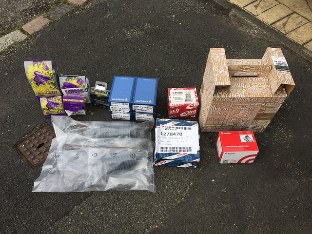

Here's everything apart from the coilovers and PMS stub axel bolts ready to be fitted, gotta love boxes of new car parts.

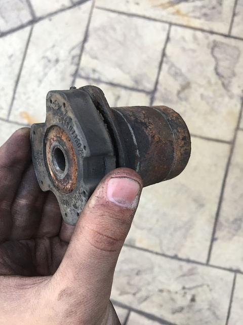

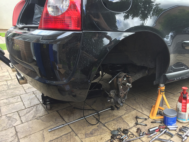

First up, we set about fitting the Powerflex rear beam bushes. We knew this would be a bit of a ball ache so dedicated a whole night to doing these. It did indeed prove to be a ball ache, with the bolt on one side not being able to clear the fuel tank, and just wrestling with the rear beam being on the drive, being careful of brake lines etc etc. In hindsight maybe a job for someone with a ramp really, still, doable on the drive!
Old tired original bushes out.
BG 182
New ones in. Do love the purposeful look Powerflex stuff has on the car like this, one for the geeks out there for sure.
BG 182

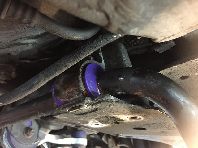

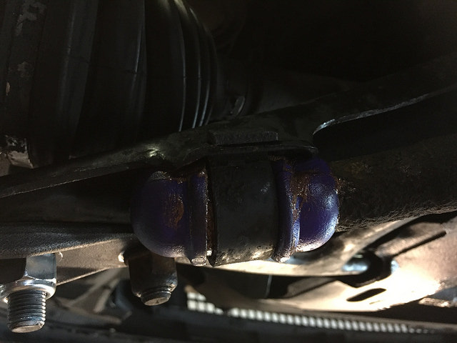

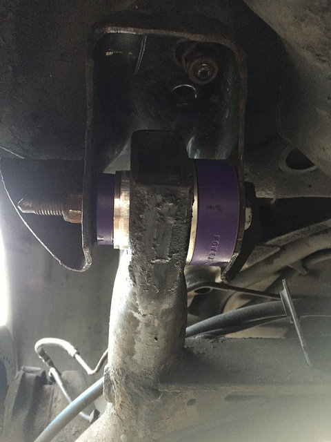

Next up were the rest of the Powerflex bushes, we were going to do some ourselves, but with the inner ARB and rack bushes needing a ramp I decided to get the remaining lot done and just get it done. While I was there and the wishbones were off it made sense to do the ball joints at the same time also, so it was off to @bloke on the Wirral!
Inner ARB ones in.
BG 182

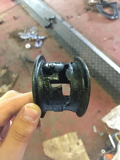

VERY tired rack bushes out, replacement well overdue on these. Forgot to get a pic of the new Powerflex ones fitted.
BG 182
Outer ARB ones in.

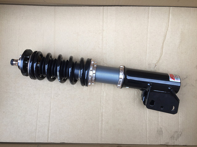

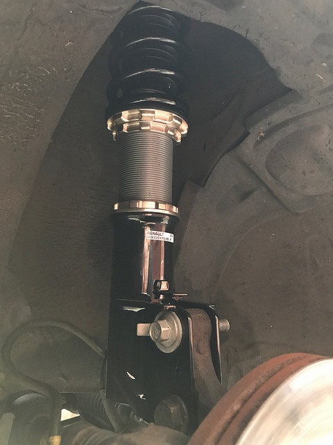

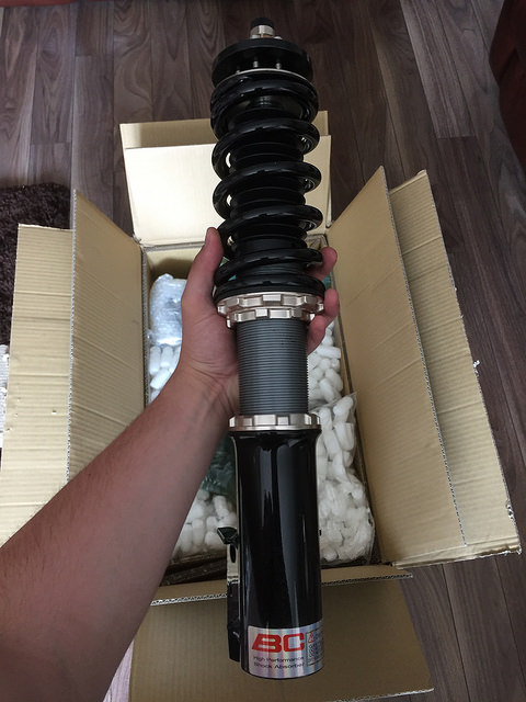

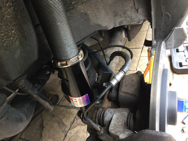

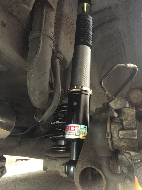

And the choice...BC DR's, 8kg/8kg springs with the BC adjustable solid top mounts. These coilovers seemed like the perfect choice for my fast road/track setup; lots of adjustability for between road and track, custom spring rates, solid top mounts to replace my tired knocking standard ones, and just a great quality product. I'd heard really good things about these from people on here, and it's easy to see why even off the car. The design is great what with the adjusters being on top so it's super easy to change them as and when you like, and the height is adjusted with the bottom collar which allows for the full damper travel. Also, these are the DR or 'Digressive Valve' version, which apparently means they're much better over small bumps etc and can react faster to that resulting in a better ride and I'm sure much more, which was perfect for my needs for the road.
BG 182
BG 182
That night rolls around, and we're back at it on the drive.
BG 182

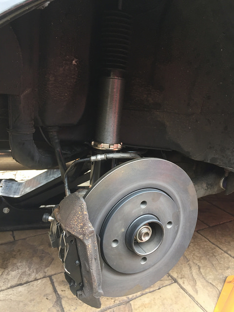

Rears on, and looking good!
BG 182
Fronts on, with the Eibach camber bolts in also.
BG 182

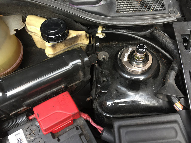

Quick pic showing the lovely adjustable top mounts and adjusters for the dampers. Look great in the engine bay, and of course killing two birds with one stone by replacing the old tired top mounts that knocked, as well as adding some nice adjustability and stiffness.
BG 182

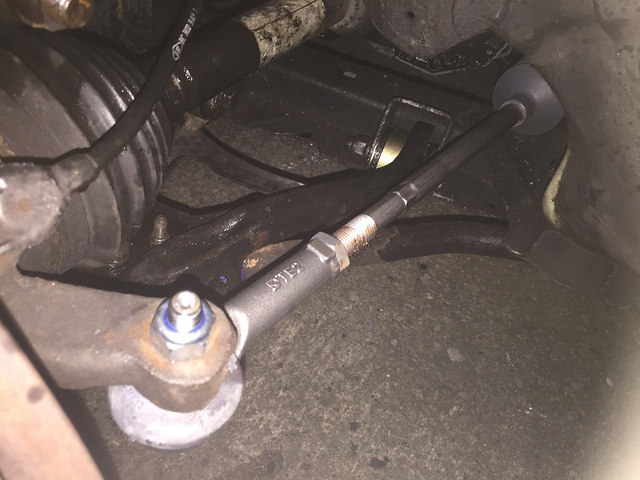

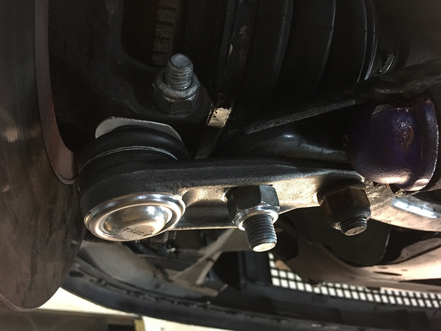

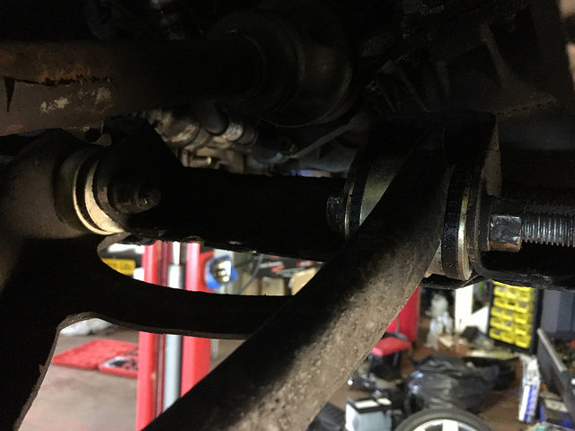

Last on the list for the night were the new inner tie rods and track rod ends. The old rod ends really didn't want to play ball, so they were angle grinder'd off, then just a case of getting the tie rod itself off, which was really easy with the long tie rod tool we bought from Ebay. Always a challenge with older cars, but we got it done.
BG 182

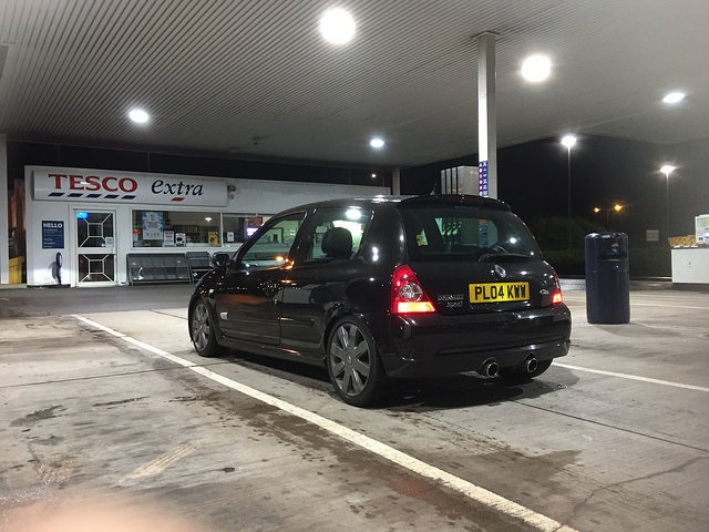

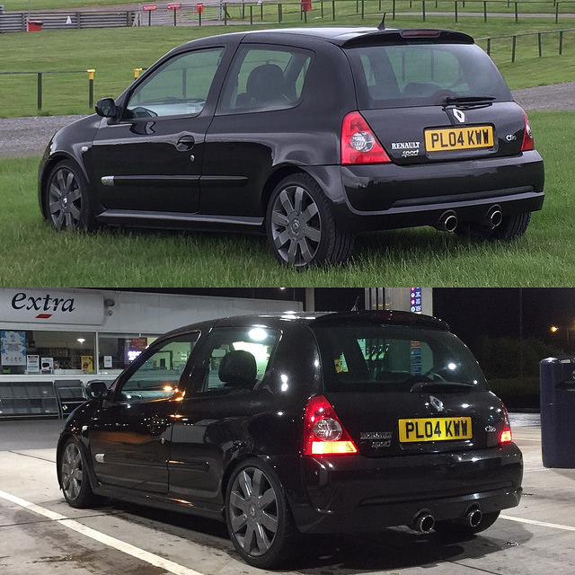

Another late night done. Few quick pics and a rough before and after showing the drop the coilovers gave. The fronts are just on the height out of the box, which was perfect funnily enough, then the rear has none of the spacers and with only the spring platforms in place. Perfect straight out of the box as I said, lovely!
BG 182
BG 182
BG 182

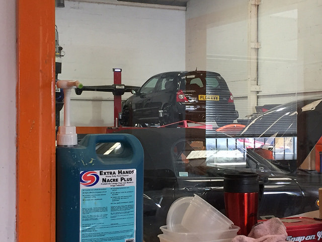

Camber and toe was just set by eye and guesswork, but somewhat ideally in the way it worked out in the end, I had my slot at Blink Motorsport booked in, so it was off to there for them to set it up properly. Anyone who knows them will know their reputation.
BG 182
And all done, time to see how this all feels!
BG 182
WOW, what a difference. The car felt perfect after all of the above coming together. Everything felt super tight, car felt very pointy and sharp, wanted to turn in much more, and mid corner grip was greatly improved. All of the little knocks and tiredness was gone. Coilovers felt great on the road, had them 5 clicks from soft at this point and they felt great then, but I've since knocked them down to 1 from soft and the ride is great, more or less the same as sportlines, no harshness or bounciness, couldn't be happier! Very glad I went for the 8kg front springs now too, fine on the road and also with the car being quite low now stops a lot of potential scrubbing. If you're going to get coilovers you want to feel the difference anyway really, so 8kg springs is the sweet spot IMO. On soft it doesn't feel like a coilover'd car, on hard it feels like a full on race car (god awful and basically unusable on the road actually, felt like the rear wheels were square on what looked like a flat piece of road).

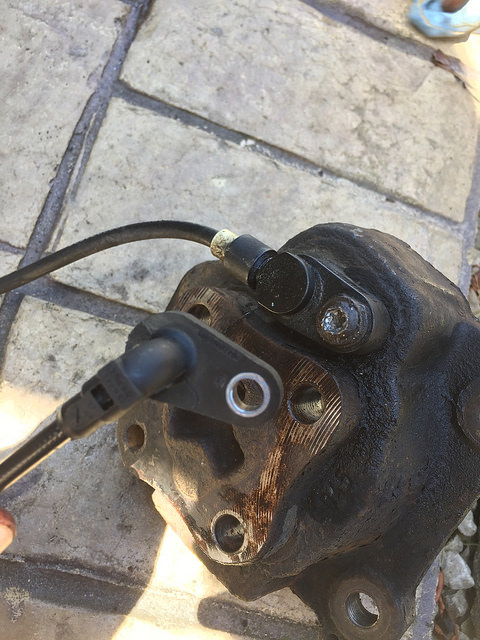

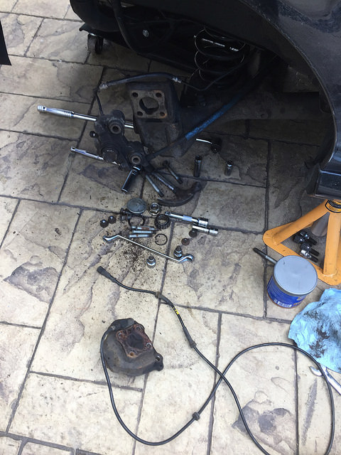

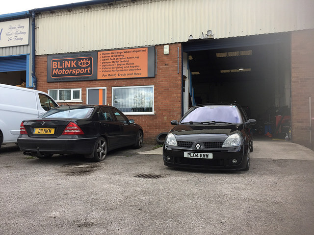

The next day, and the final few jobs of this whole bunch of stuff. Firstly, we attempted to change my faulty rear ABS sensor, only to find ECP had supplied the wrong one. It also transpired they don't actually stock the correct one which was good lol, so I have a second hand one from eBay on the way to me.
BG 182
BG 182
BG 182

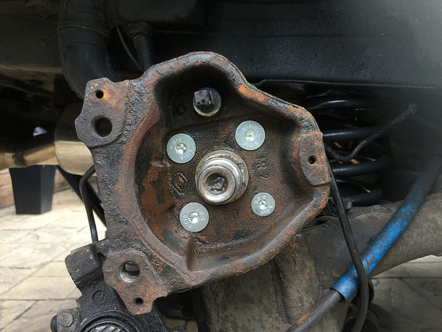

While we were there, we fitted my new rear stub axel bolts from Pure Motorsport. Nothing fancy, just to replace the old ones. I bought them just incase mine were totally knackered, which they weren't really, but for the sake of a tenner it's a headache avoided in future.
BG 182
BG 182 by Niall97, on Flickr

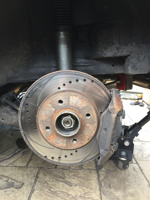

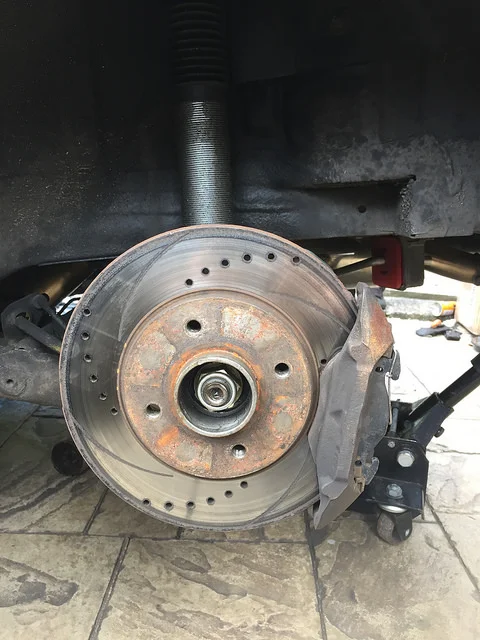

Next up was the new rear disks and pads. Very overdue, couldn't wait to get rid of the shitty drilled and grooved items the previous owner had fitted like I did with the fronts, plus they were very worn now, and the offside one's bearing used to come apart when you take the disk off which wasn't ideal.
Old.
BG 182
New.
BG 182

Quick drive after, and it seems the rear brakes were definitely due a refresh, can actually feel the rear brakes working with the fronts now, feels more stable under braking too because it's lurching forward less with the rears doing more now. Once again another great addition to the way the car drives.

Looks great with the coilovers and I bet it feels like a new car with all the bushes replaced.
Sorry if I've missed it but what size front plate did you go for if you can remember?
Cheers! Yeah really does. Especially with the condition of some of the old ones when they came out.
