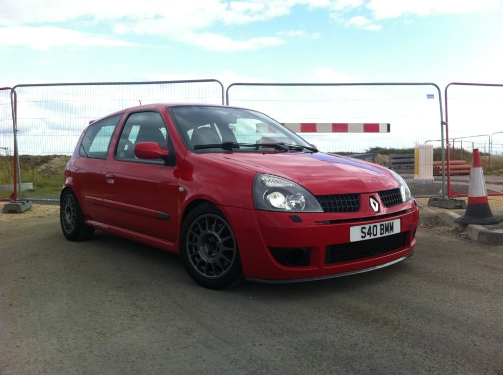

On the way home from work tonight I decided to get some snaps at the local industrial estate. I had promised Aucky a video of the Orbisoud. I will get a better one than the one below this week I promise! Please note it is inside a garage and I forgot to take my foot off the accelerator lol!

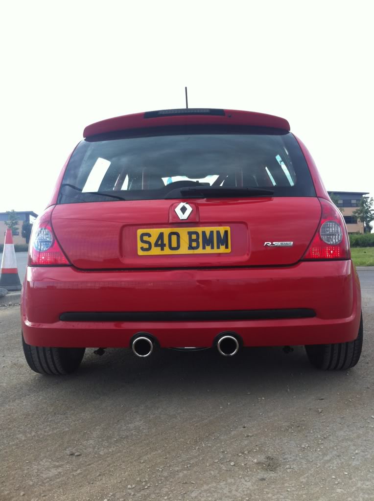

The alignment of the orbisoud (for Aucky)

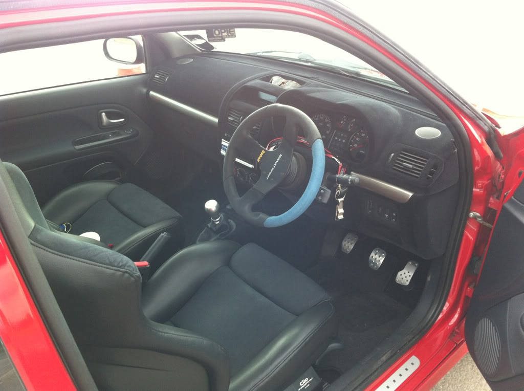

Interior pic

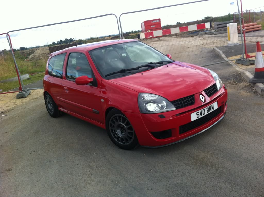

Apart from the wheels (Not a fan in general, not yours specifically) I love your car so much. Its bloody amazing.
Thanks chaps! I am very very tempted to get some Enkei RPF-01's but thats later on in the year if I make the change!
Thanks all!
Yes mate I am rubbish when it comes to wheels!!! I cant make my mind up! Really like the 2118's though!

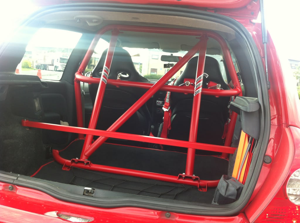

The cage is a Ktec Racing Full Bolt in with optional harness bar. Made by 'CAGED' I think. Slightly revised version of the MSV cages.

The wheel needs retrimmed in red imo. Would make an already excellent looking car that little bit better!

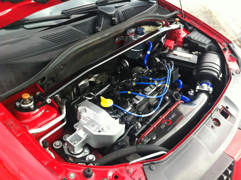

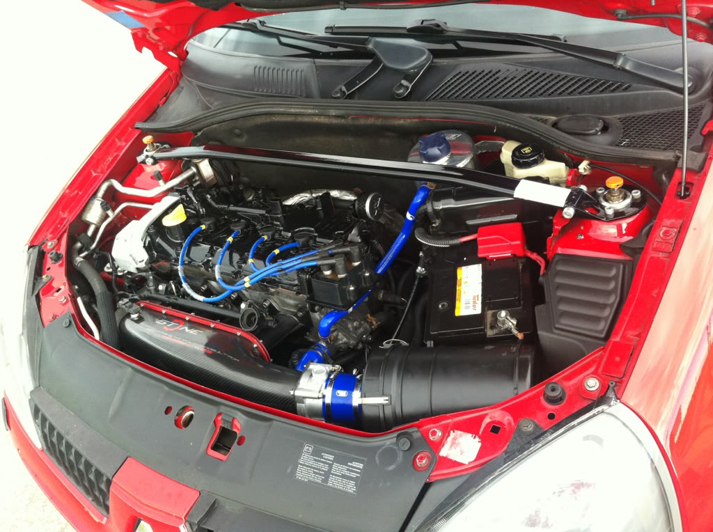

Nice RS2 set up as well, into the V6 box by the looks of it?? Tidy bay and car in general.

Where did you get the rear plate from, I'm after one about that size. What are it's dimensions as well?
^^^rear plate is the only thing I dont like - it's too short for the recess on the boot which makes it look odd IMO

Best Trophy on here. Love the dash, how did you do it?

1. Why only a half cage? It looks meaty as f**k. Did you not consider a full cage? (its my personal opinion that they serve no purpose when most of the front corner will crush the drivers face)
2. Why go to the expense of an RS2........ then stick a bloody big airbox on the end? Aurely an open filter would be better for that kind of flow?

The rear section does alot more than the front section in a roll. The B pillar hoop protects the drvers body in a roll. The front section is for side impacts and direct loading to the A-pillars mainly. (as I understand it) This cage is a full bolt in item which a full cage isnt, so no welding etc and with it being a trophy im inded one day I will have to return it to std. This cage looks 'meaty as f**k' becuase it has a harness bar which I really wanted as when I eventually do go on a track the std seatbelts are 100% not up for the job.
The other point to note is that if this cage is: A improving whats not there ie no cage, and B good enough for the MSV boys to offer trackdays in there cars with them I instantly feel a little bit safer than in a std clio bean can.
The rs2 does come with an open element in the kit. This element is small and the same diameter as the pipework that it goes onto. The engine will still be taking in the same volume of air because all the internals are std, it is now just doing it more efficiently ie through less of an inlet tract. The idea behind having a box has several benefits for a road car. it sounds a hell of alot more refined now, and the element is significantly bigger than the pipercross one supplied with an RS2 which can only be a good thing! The trumpet iss faced downwards to the wheelarch so no engine bay air is entering the system keeping inlet temps down which is a bonus!

You should get the Sabelt retrimmed with red across the top!
I was originally going to have the wheel retrimmed in black lether with red band at the top/red stitching but I havent got round to it yet. its on my list. I had better create a project thread soon because it has been quite a journey!
