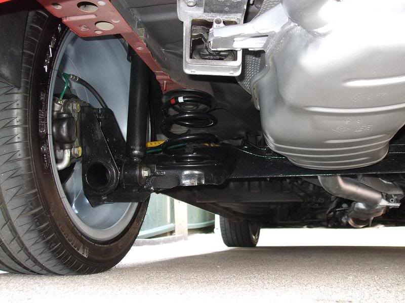

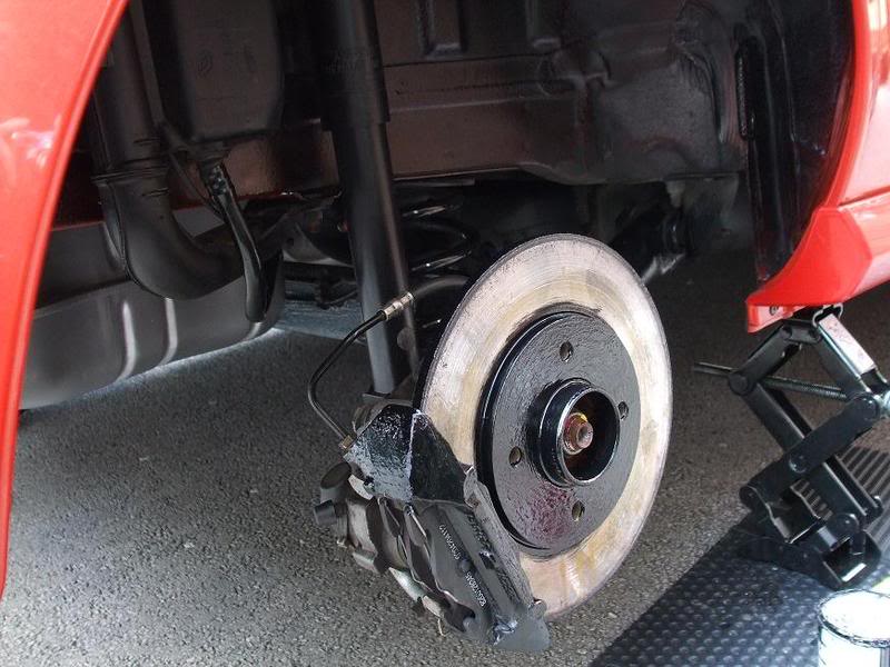

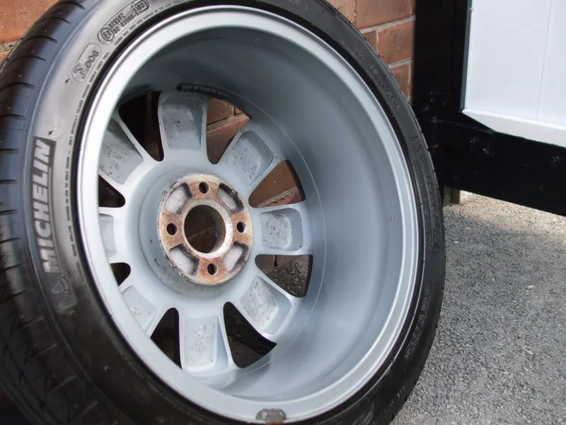

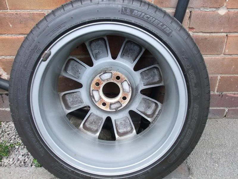

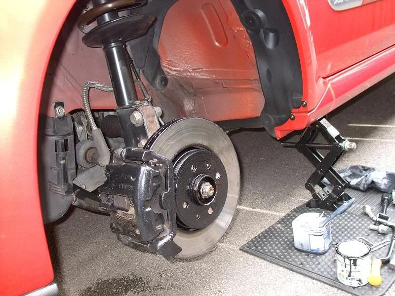

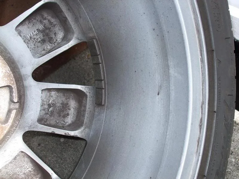

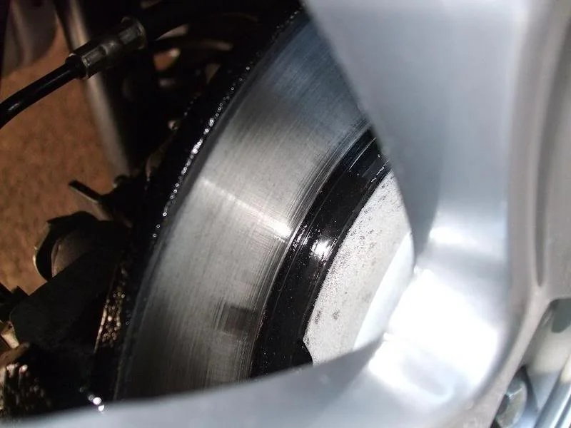

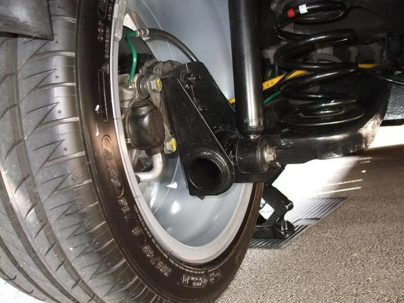

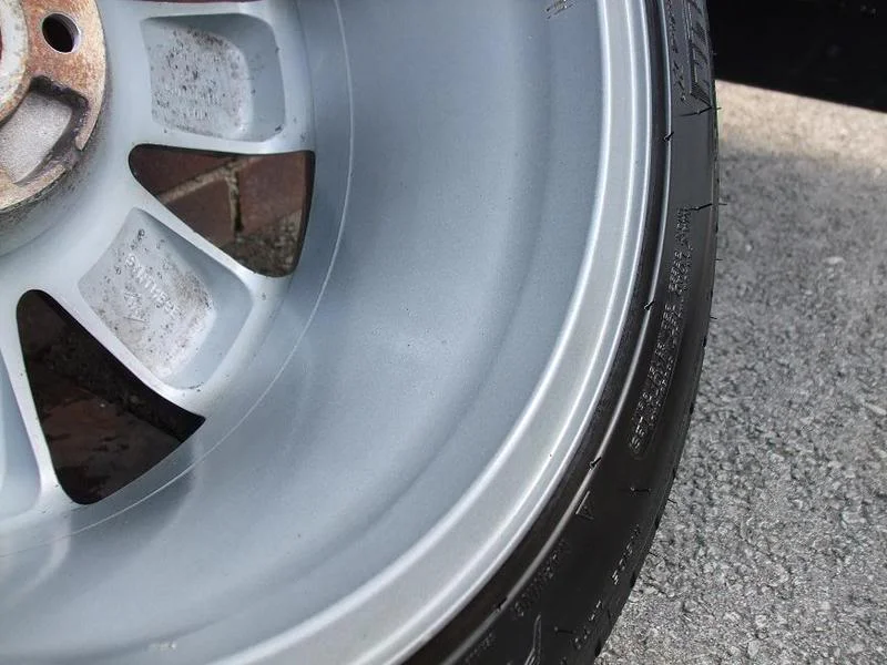

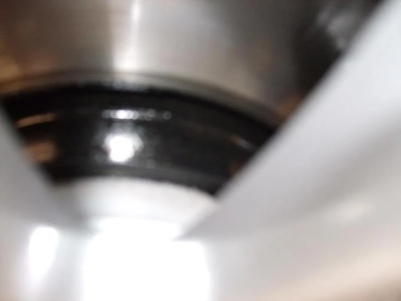

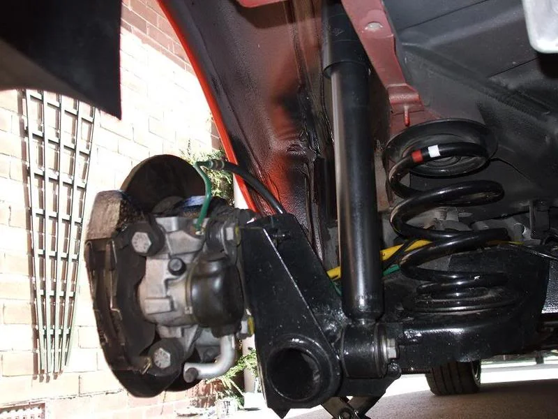

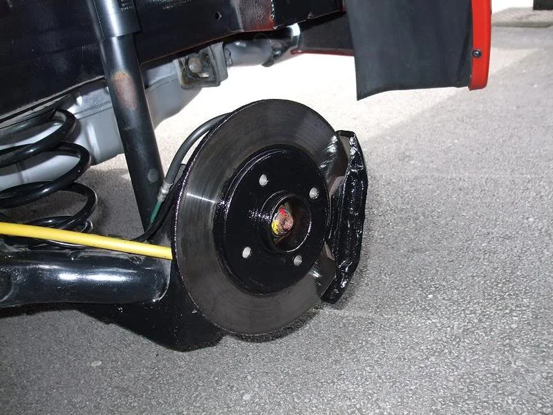

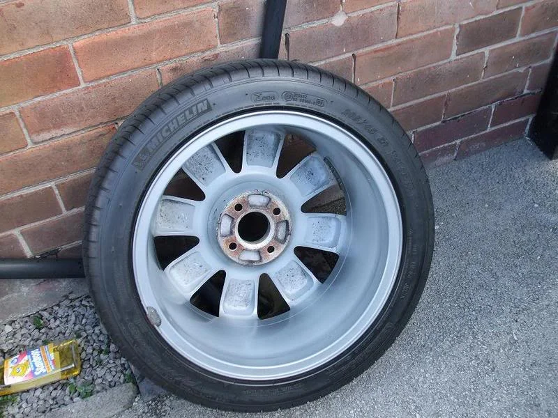

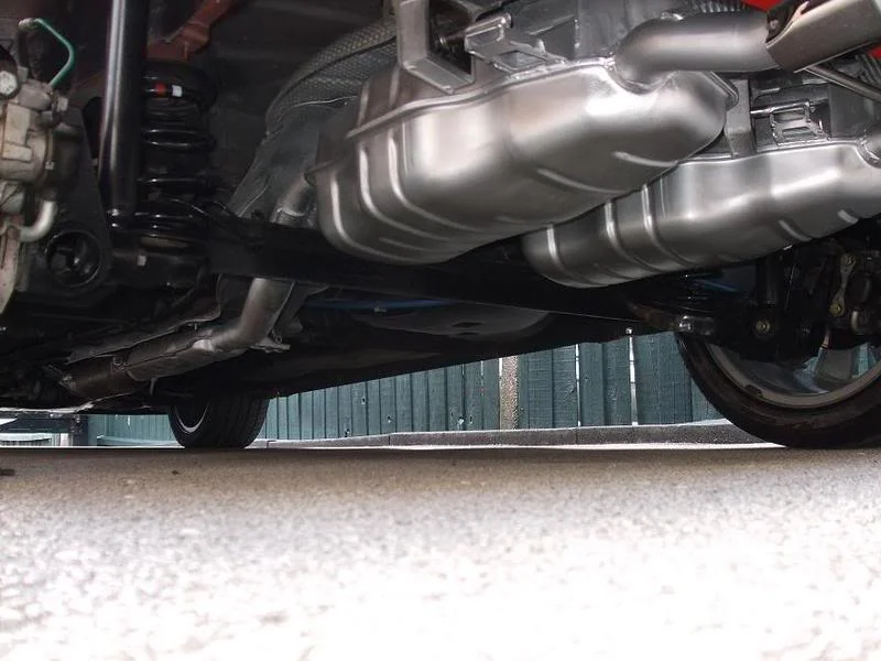

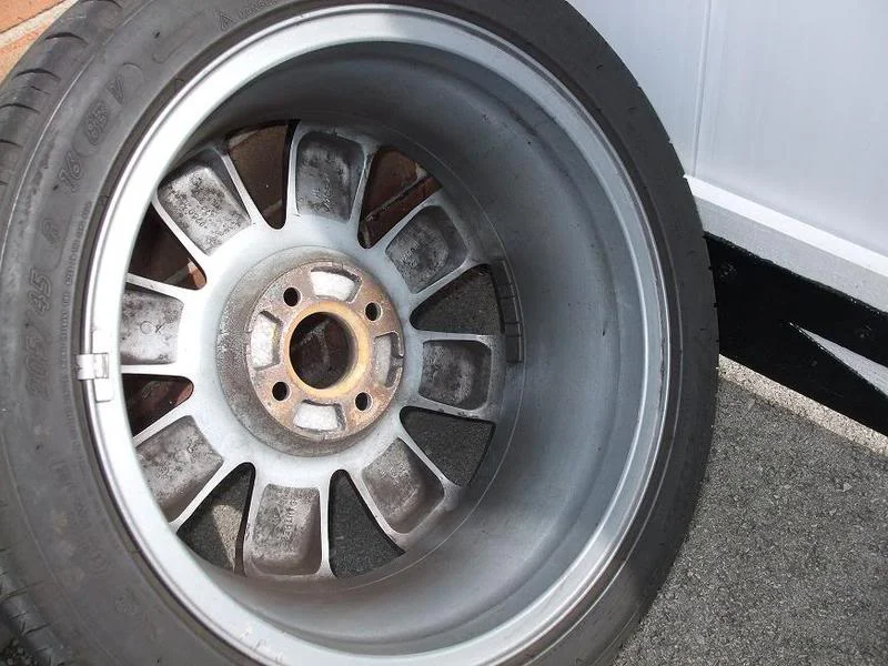

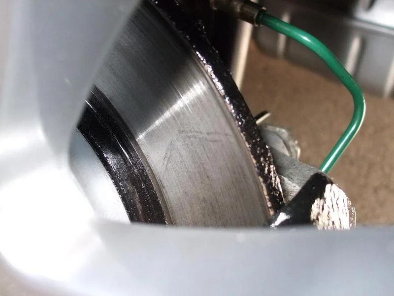

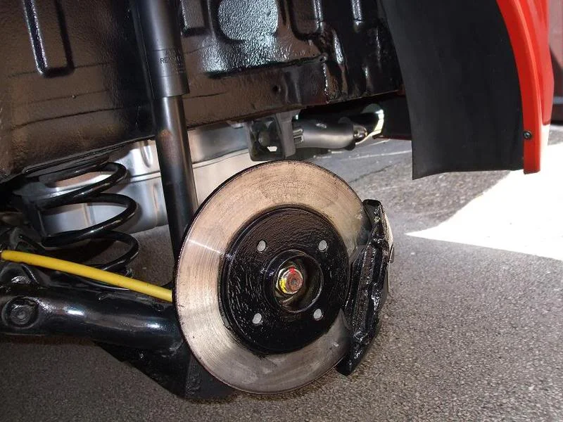

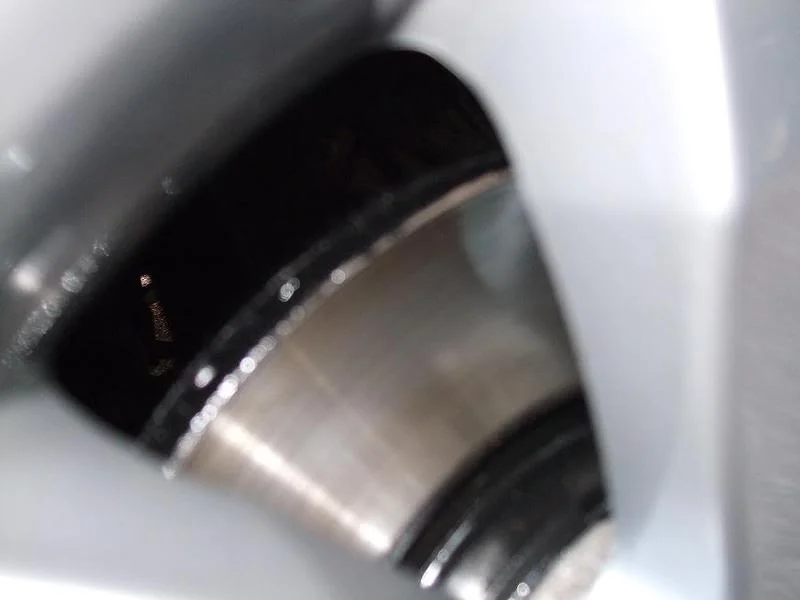

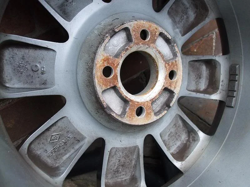

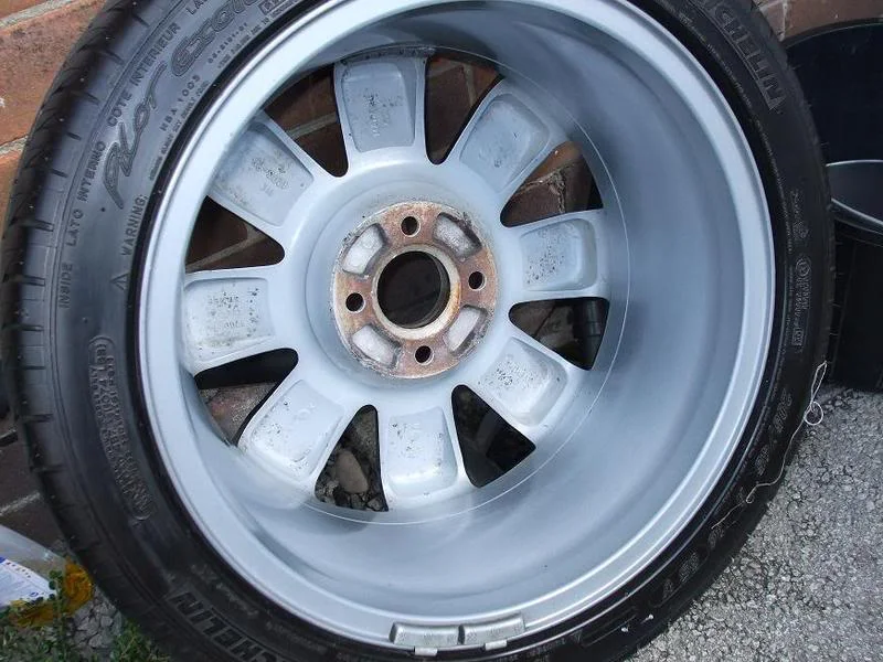

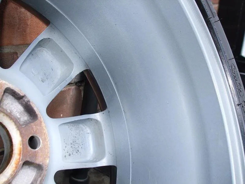

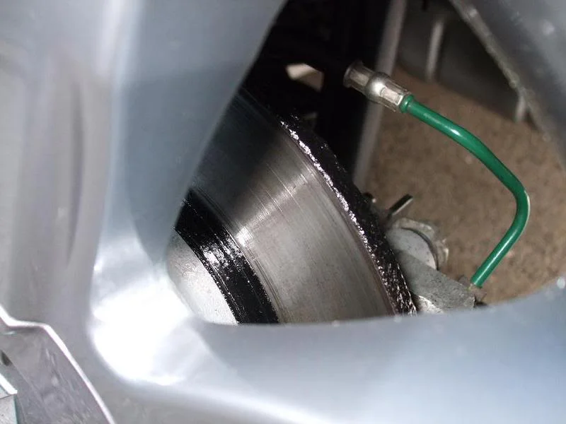

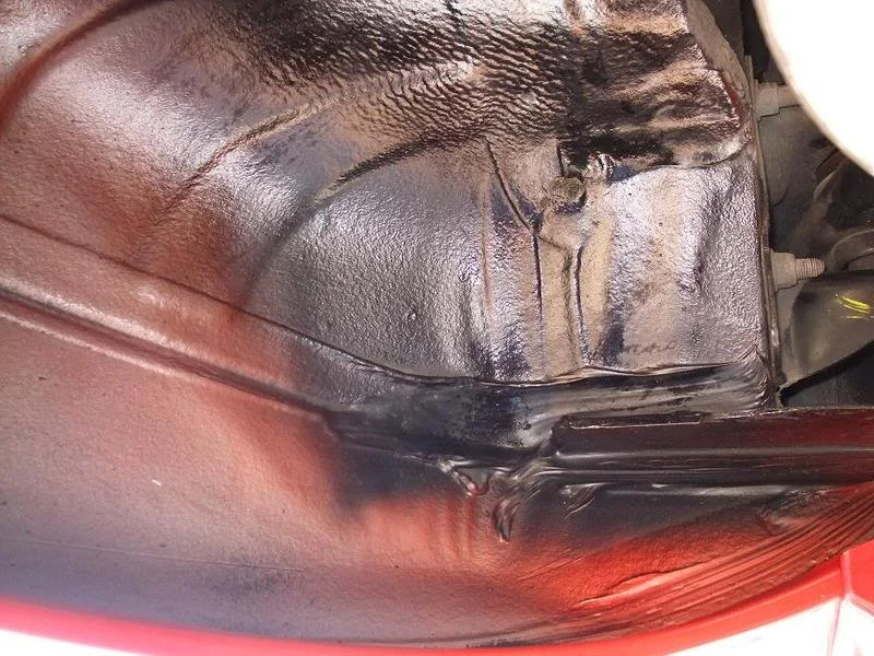

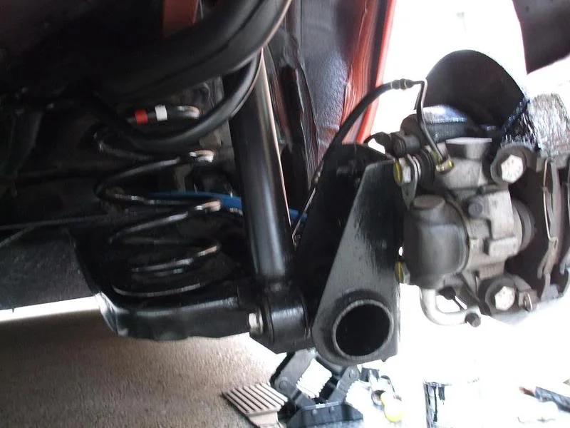

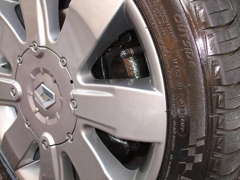

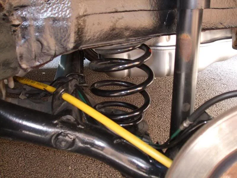

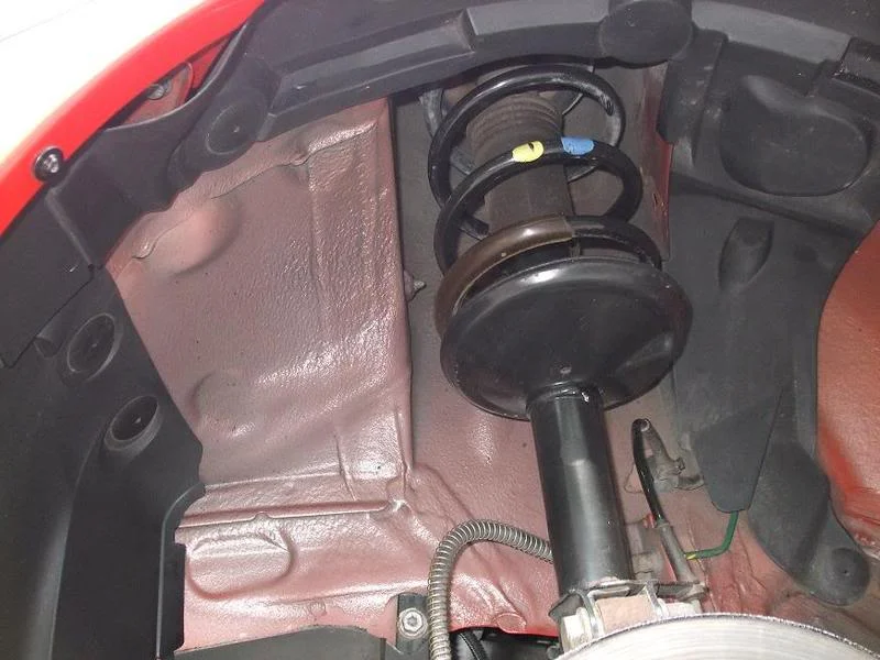

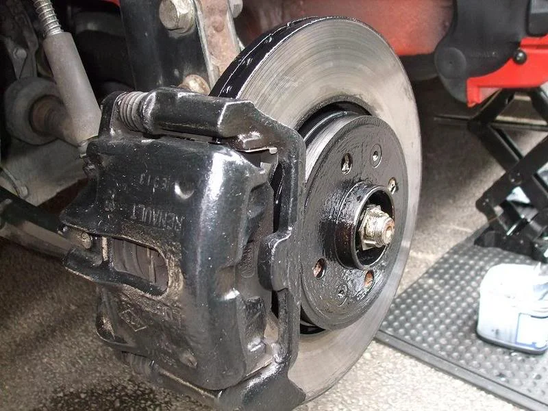

Hi all, I know you love my threads :rasp: decided this afternoon to take the wheels off as i havent for a while, while doing this i thought i would clean up the arches / wheels / and paint the hub / disk edge (as they were starting to look a little rough) :eek:

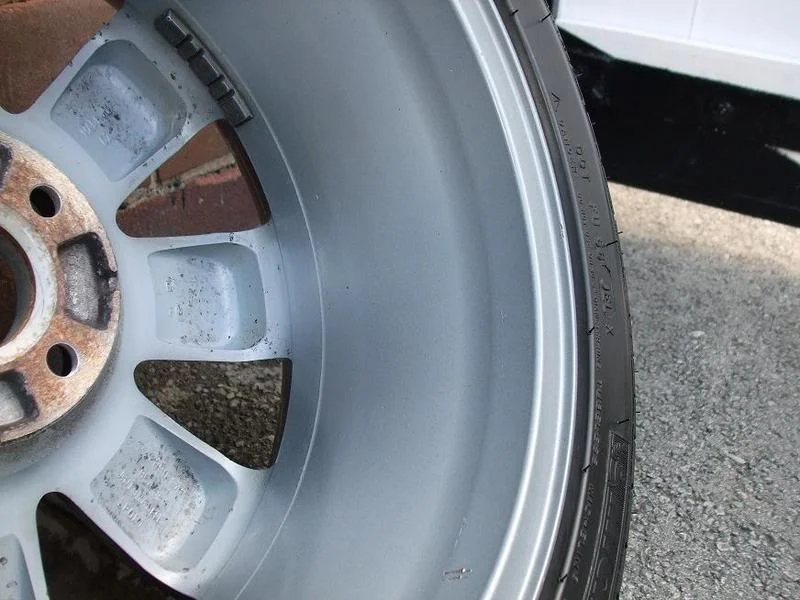

Pretty pleased with the results, couldnt get the wheels 100% perfect but im 99% happy with them! :approve:
Hope you enjoy the pic, to show you what ive been up to :)

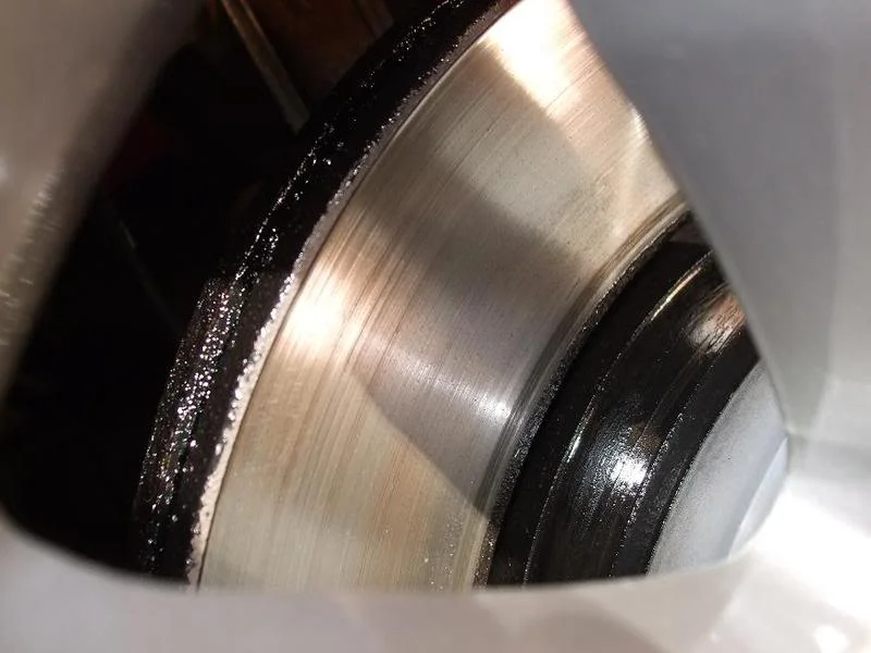

before

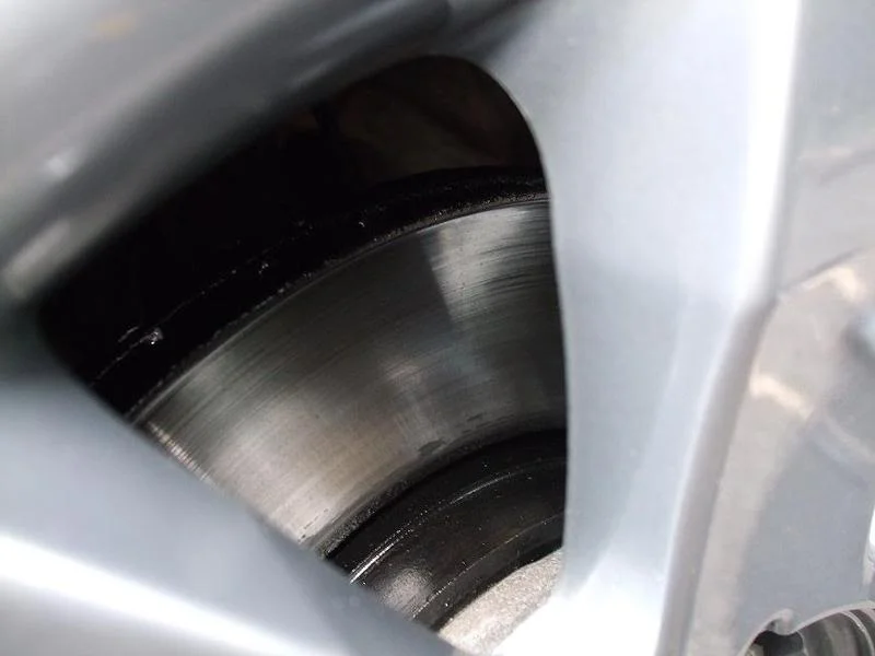

after

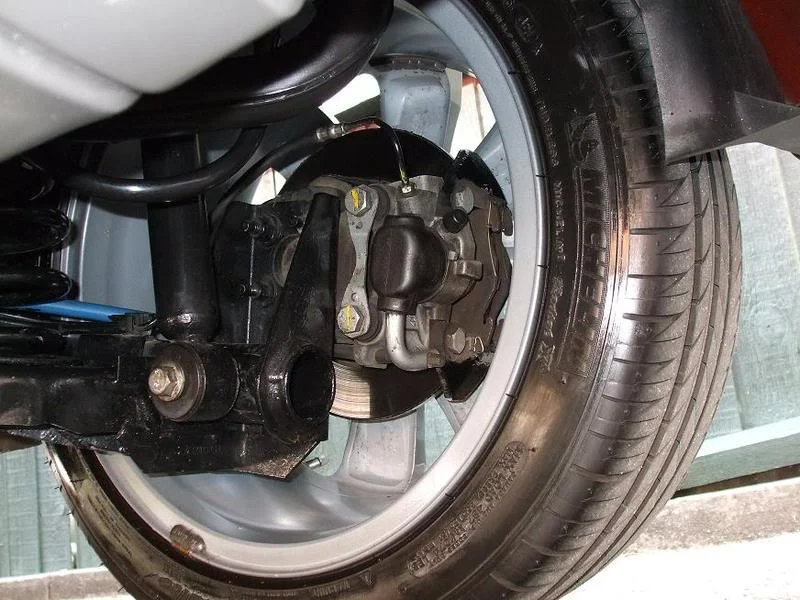

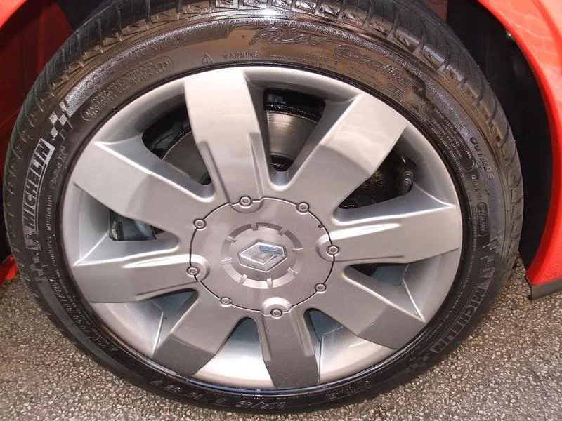

finished front wheel
its a labour sp of love keeping it in near perfect condition and using it every day - but i enjoy it :)

Your a brave man trusting those shitty Renault Jacks!!!
C
clvs2222
yep you are an extreamly brave man using the renault jack.
also, the tyre doesnt look very clean. looks like you've only dressed it, but not actually cleaned it. tyre brush you need.

^^^ Isnt painting the calliper part where the wheel touches the disc a bad idea? Wont stick to the wheel?
MarkCup
Make sure you check and re-check your wheel nut torque over the next few days/hundred miles. Paint on a set of track wheels I had meant when the wheels got hot and the paint softened, the nuts loosened off.
I had to stop at the side of the track and tighten the nuts up by hand before limping back to the pits at Goodwood with a wheel rattling and clanking as it was so loose - very embarrassing and potentially fatal.

Cheers Mark thanks mate ill check next week :eek:

You do understand that painting your discs where the wheel fits them is a really bad idea unless you somehow got a uniform coating(electrostat powder coat?) as the thickness will be different all over, the wheel won't run perfectly true with the hub. You should really wire brush the surface on the wheel that butts up against the disc too to get rid of corrosion...
You can buy brake discs with a coating to stop them rusting where the pads don't run these days, would look and work considerably better than painting them...

But, seriously, treat yourself to a trolley jack and some axle stands... Not safe 'detailing' under the car when it's just on a scissor-jack... :nono:
ForceIndia
  Gentlemans spec 200
Please, FFS tell me you had axle stands. If the jack doesn't come down the sills will cave.
