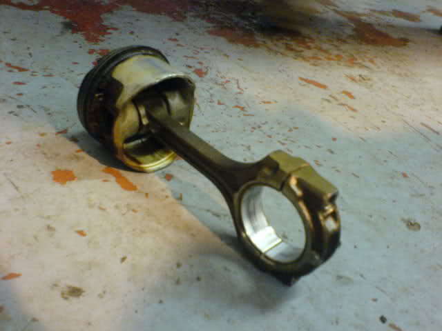

The one thing he did say was he wants the 'big ends' (pic above) put together by them as he won't be able to tell which goes with which - said he wouldn't touch it otherwise, is it that crucial?
