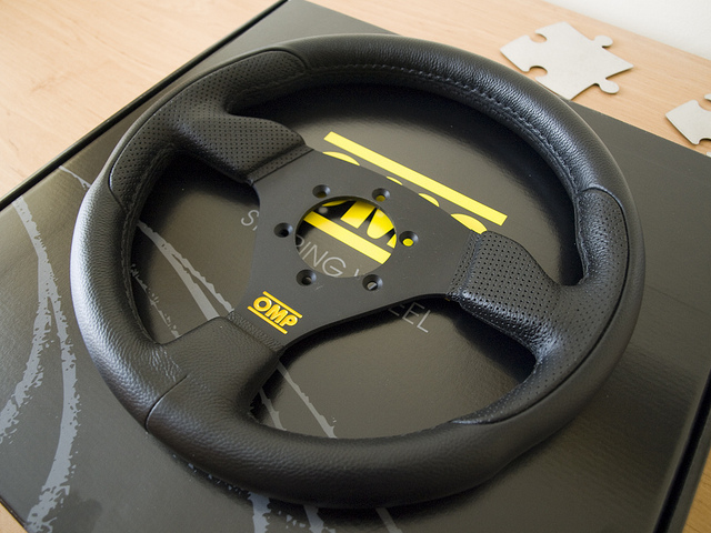

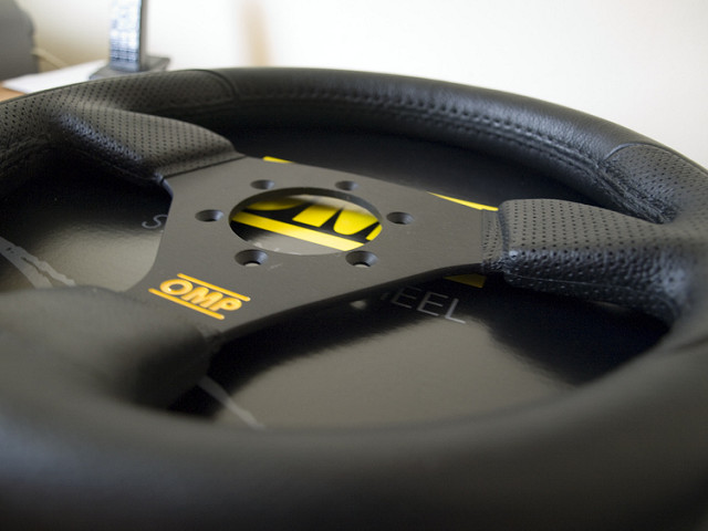

Update! My omp wheel arrived today, even from un-boxing it and picking it up, I know I'm going to love it. Got to be the best value for money wheel available.

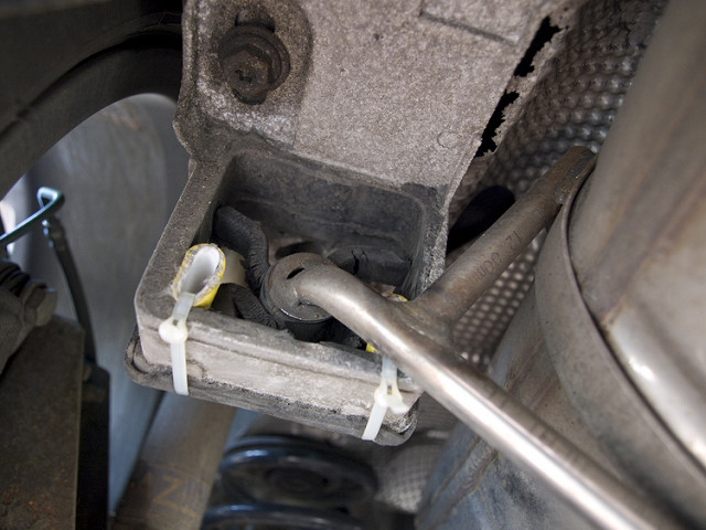

Decided to attempt to sort something with the rear exhaust mount this morning.
It had got to the point where it was unbearable; the noise/vibration coming from it was terrible, as the metal hanger on the exhaust was sitting on the metal cage of the mount;
I didn't want to use the socket, as although it would have lifted the exhaust, I imagine it wouldn't have done anything to help the noise/vibration issue.
So, I decided to go with the hose method. Cutting up a small section of my trusty karcher hose cable tying a piece into either corner of the mount.
So, although it still looks like a sagging shagged exhaust mount, it's actually 100 times better than it was before! The hose has pushed it up just enough to give some support and stop it vibrating through the metal mount.
I'm not sure how long it'll last, but for now it will do. I'll have a look into a better/proper fix when I need to.

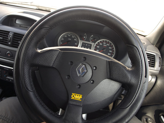

I also took the omp wheel outside to compare it to the original; much better! :D

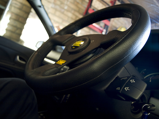

Strangely, the horn push doesn't fit in the centre of the wheel with the top silver ring in place on the boss.
As can be seen from this photo, the silver ring has a raised outward lip in the centre; it's this that's stopping the horn push going in.
Leaving this top silver ring out, everything fits together perfectly. So, I'm assuming there's no problem with leaving it out? I'm sure I've read/seen people do similar before on here.

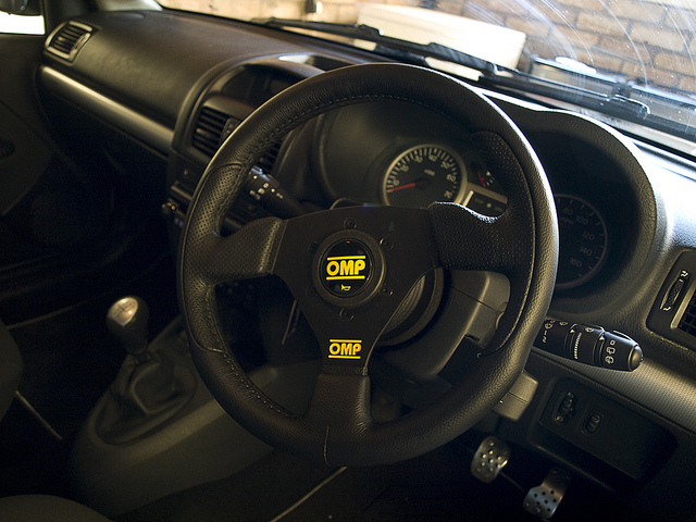

OMP wheel is now on; massive improvement over the original wheel, great to drive.
Very happy with it, looks much much better imo.

That does loom nice!
Your pictures are allways good quality :)

Cheers mate. Having fun getting the horn to work at the moment though haha. I think it's an earthing issue, the new horn push isn't earthing at the moment, so no horn! :eek:

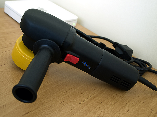

My machine polisher arrived this afternoon.
DAS-6 polisher, couple of polishes and pads (compounding, polishing and finishing) :)
I gave it a try this afternoon on the bonnet, which was one of the worse areas paint wise on my car, and was really pleased with the results. I'm going to attack the rest of the car with it tomorrow :D

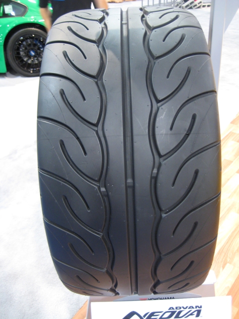

I've also, literally 2 minutes ago, ordered myself a new set of tyres.
I've gone through the Parada's at quite some rate and have been really happy with them; the dry grip is fantastic for the price imo!
So sticking with Yokohama, I've gone up to the AD08's (Yoko Advan Neova AD08)
