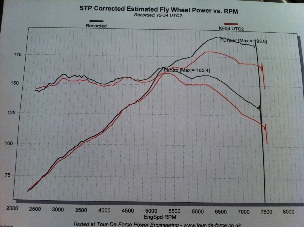

Was it noticeably quicker with the cams? I seem to remember you getting a pretty sizeable increase high in the rev range? I guess that's down to the 428 profile :)
  Mazda 3 MPS Mk1
Re: Iceberg 172 Cup Project
it was a lot more peaky, so further up the rev range there was plenty of oomph. Enough to justify the cost, probably not mate. id say stay with just the RS 2, and enjoy that, spend the money on trackdays :evil:
I was v lucky with the gains i got though

193 :eek: Didn't realise you'd got that high a figure from them!! Now I see why your car is a freak! :rasp:

Yeah, didn't want to sound like a knob, but mine does go really well for some reason, you'd be lucky to see 190 usually.

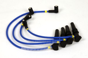

Also, ordered a set of Magnecor leads to go with the other engine bits. :)
When I had the plug damage a few weeks back, there was also light damage to a couple a lead too. Although it's been sorted for now, I thought best to get a new set of leads to prevent any future issues that may occur with the existing leads.
Went for the cheaper 8mm blue leads, as I can't see the 8.5mm really giving any benefit;
