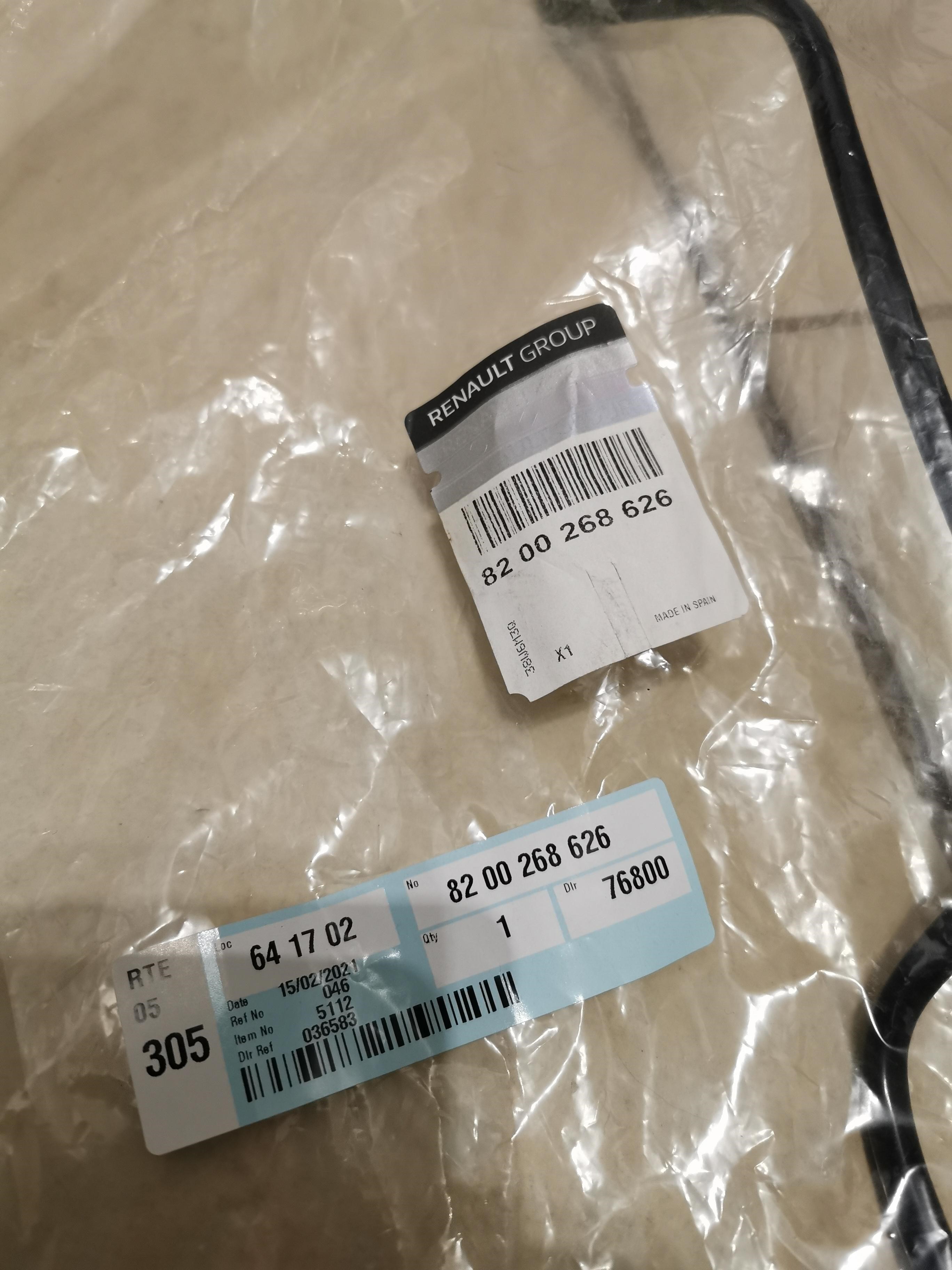

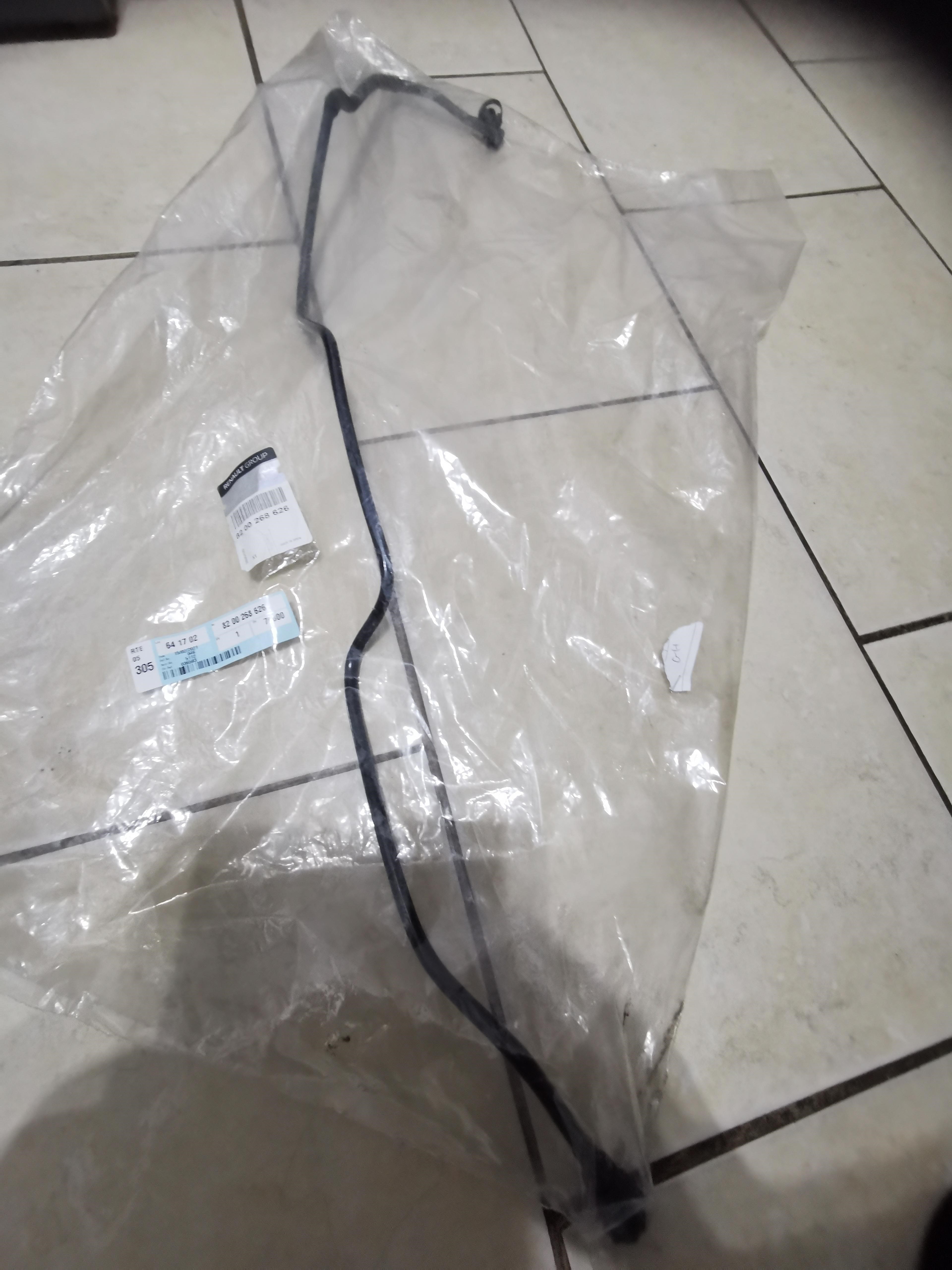

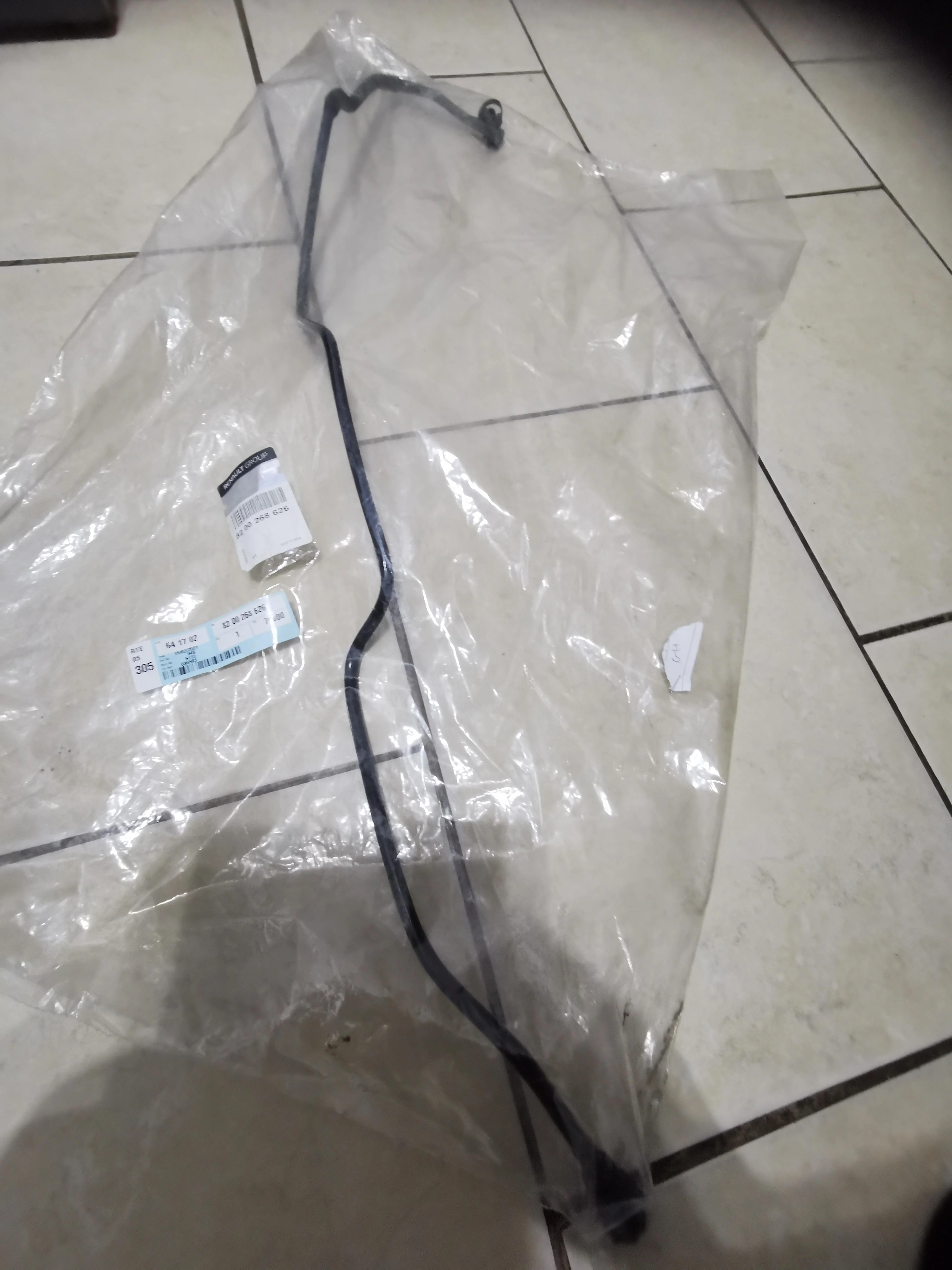

Genuine fuel pipe arrived yesterday from Renault
Fitting it in the morning and hopefully my mate has started cutting out all the rot

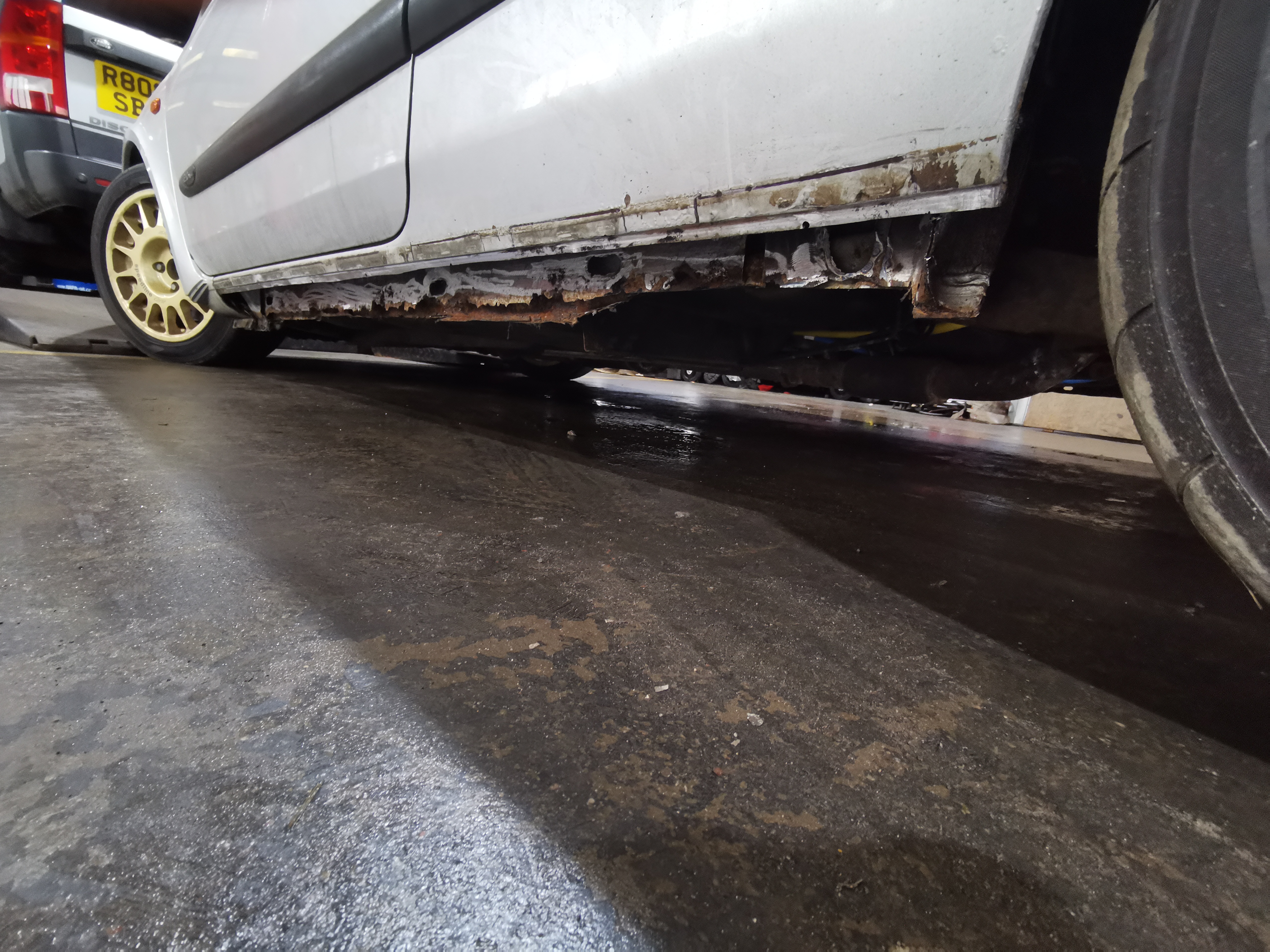

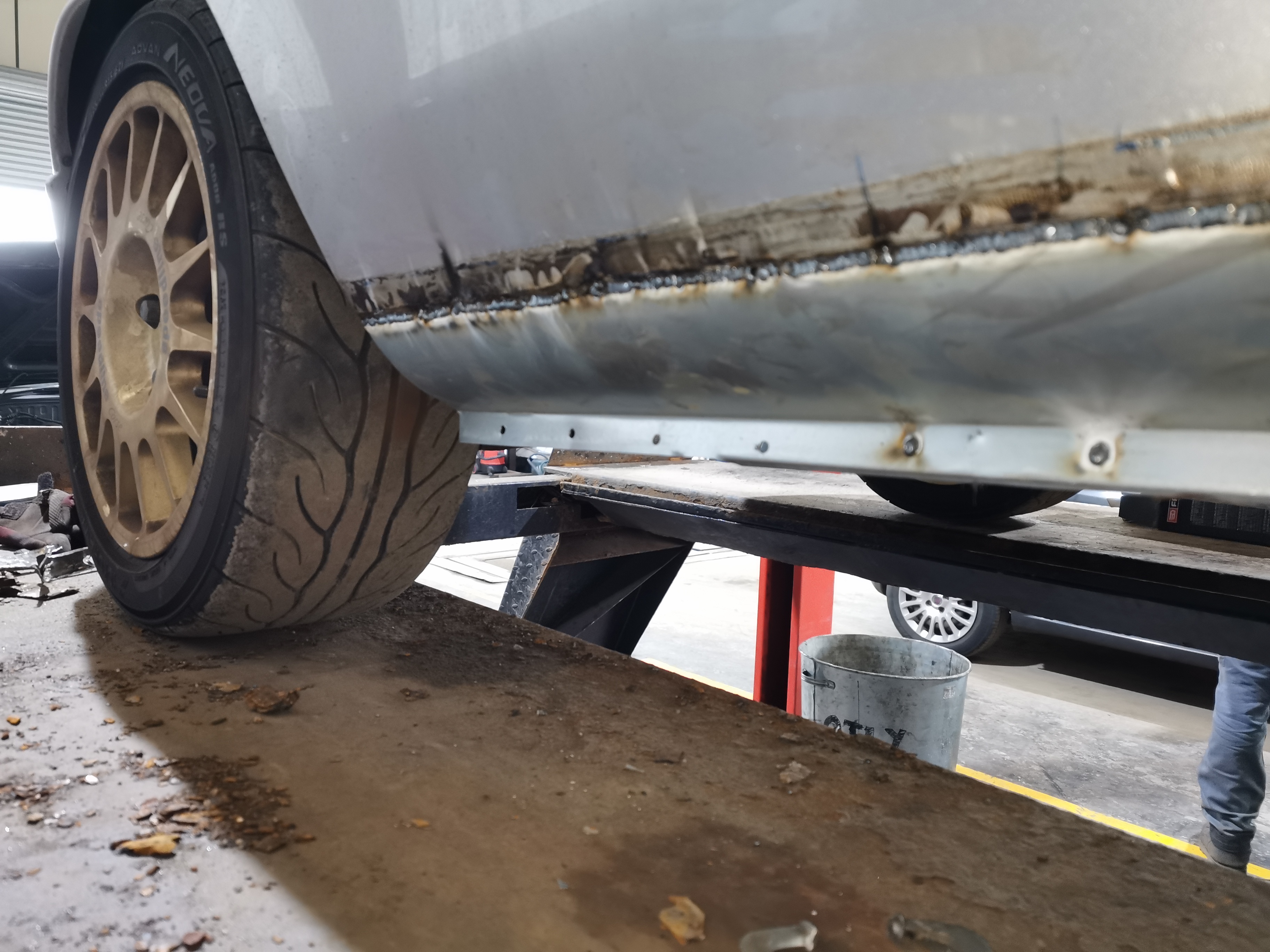

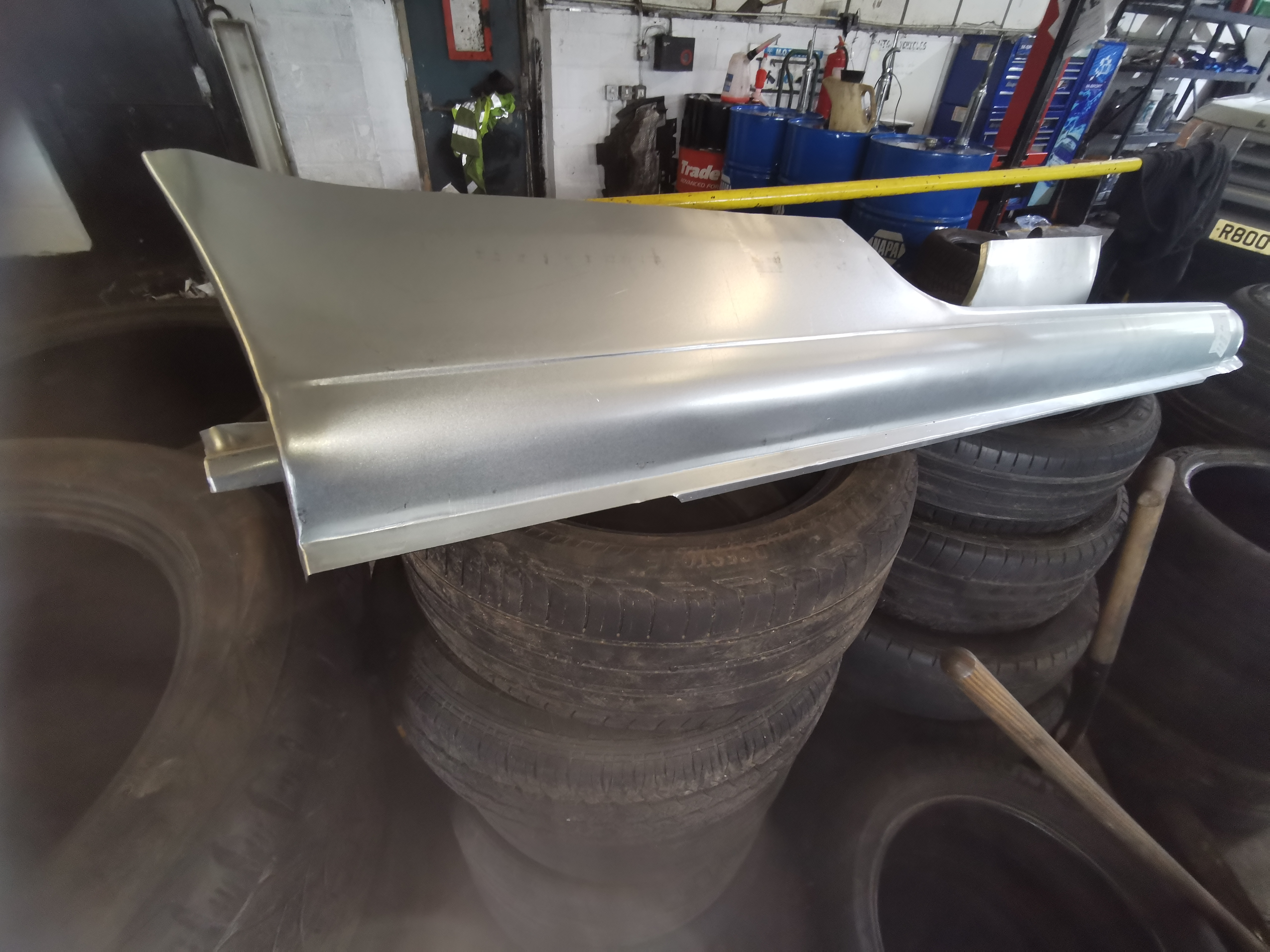

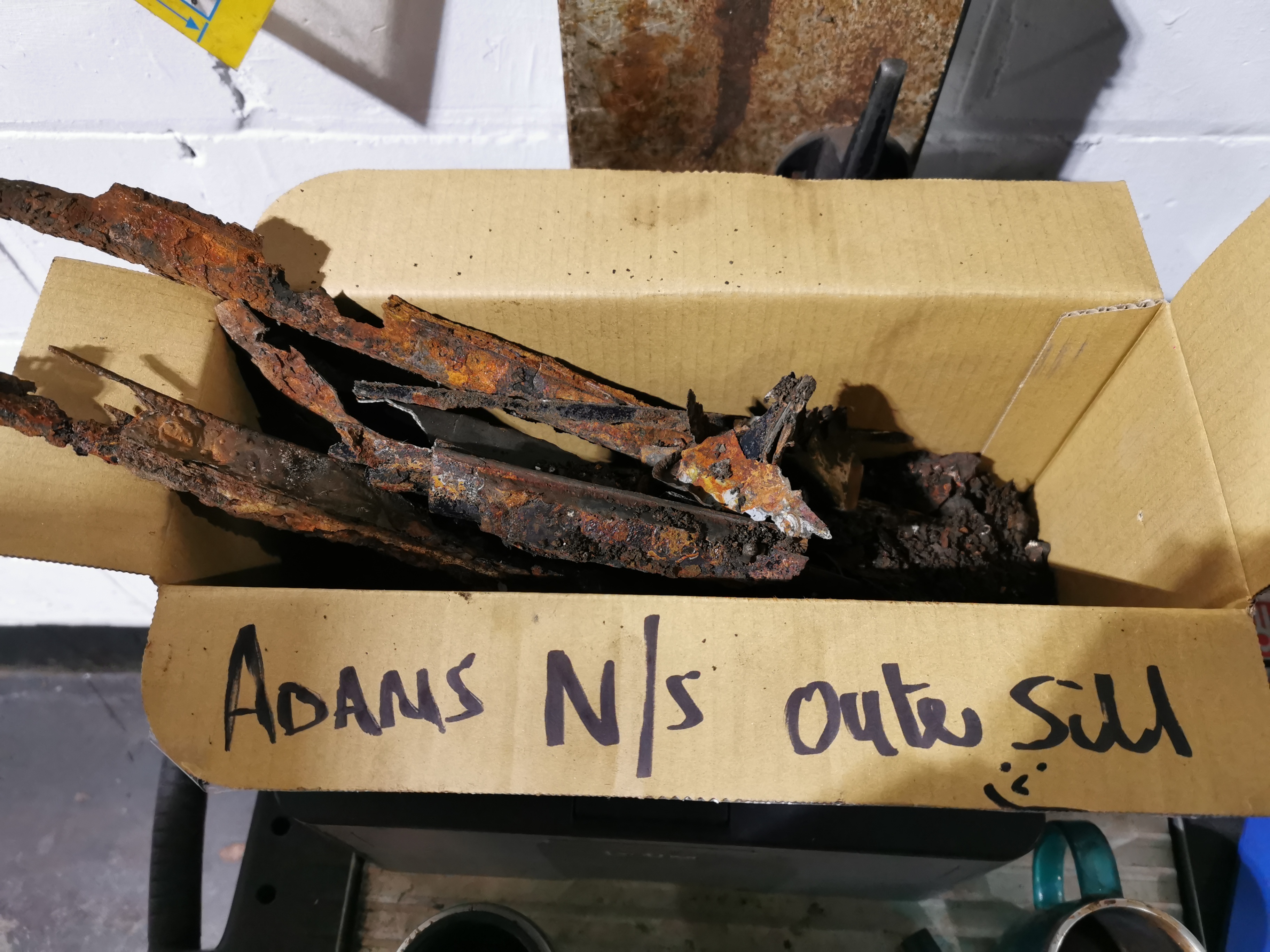

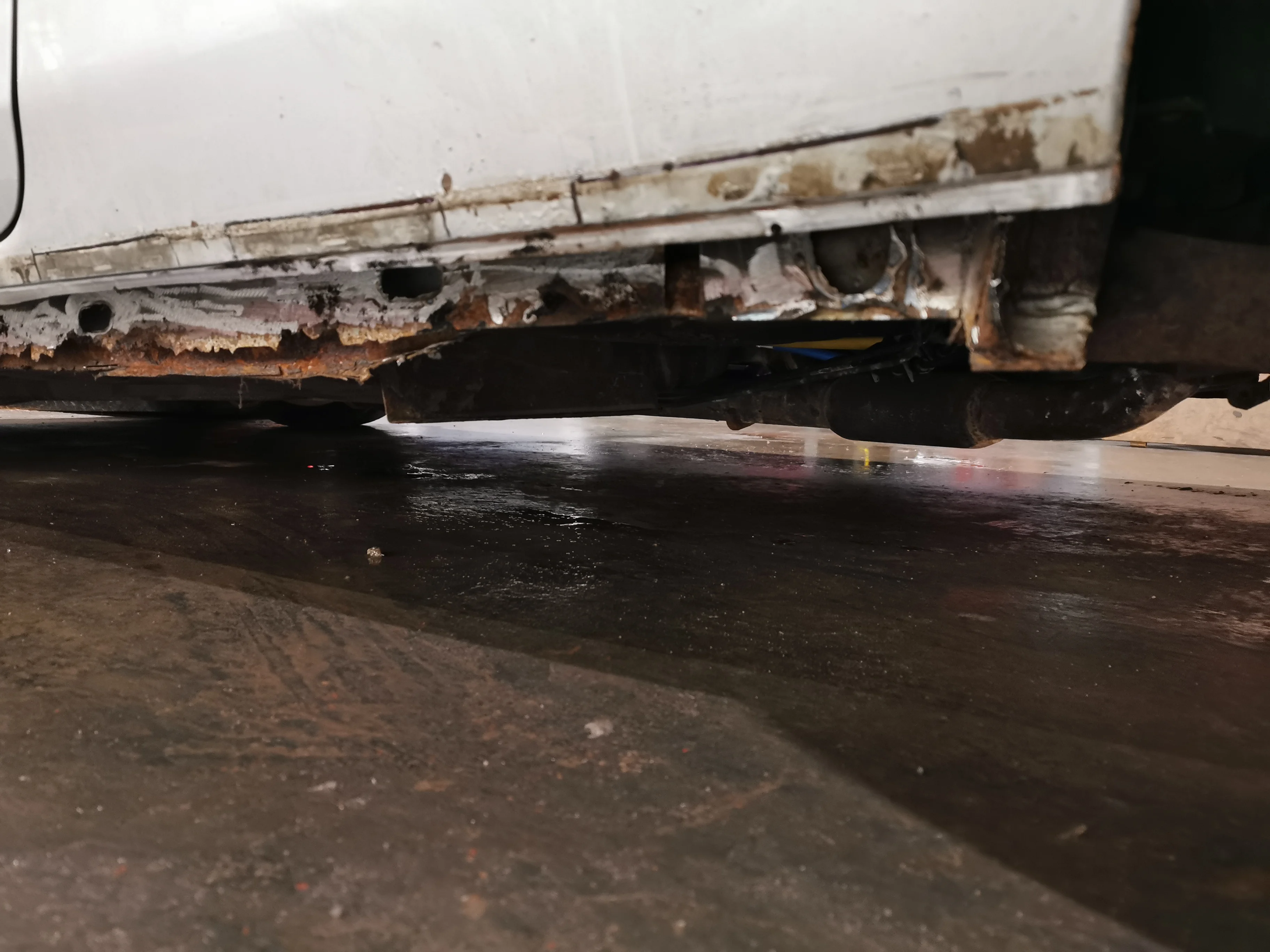

New sill repair panels arrived this week. So made a start cutting out the outer sill.
The plan is to weld It below where the top of the side skirts are.
Next step remove the interior and get the inner sills made up and welded in place

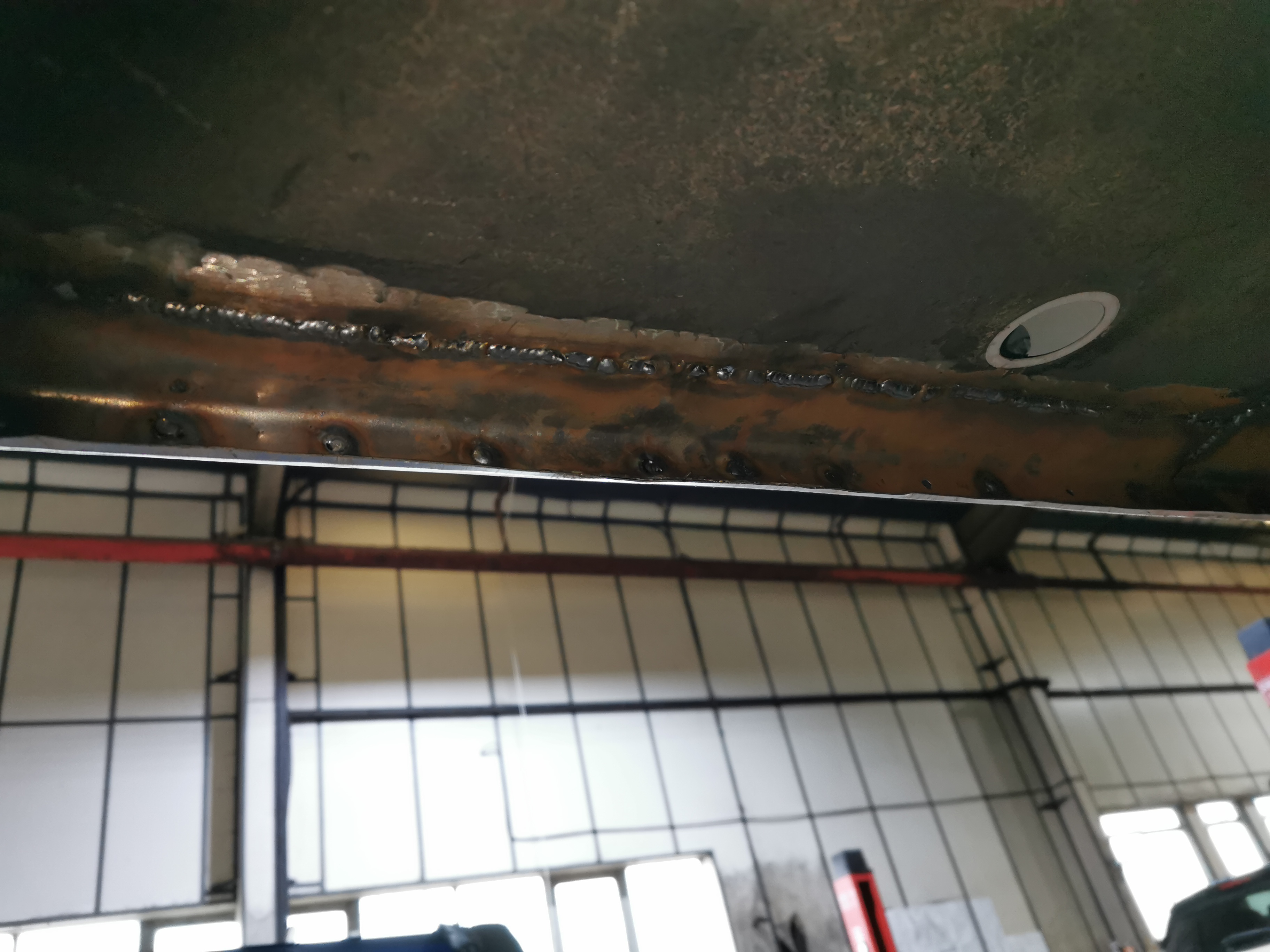

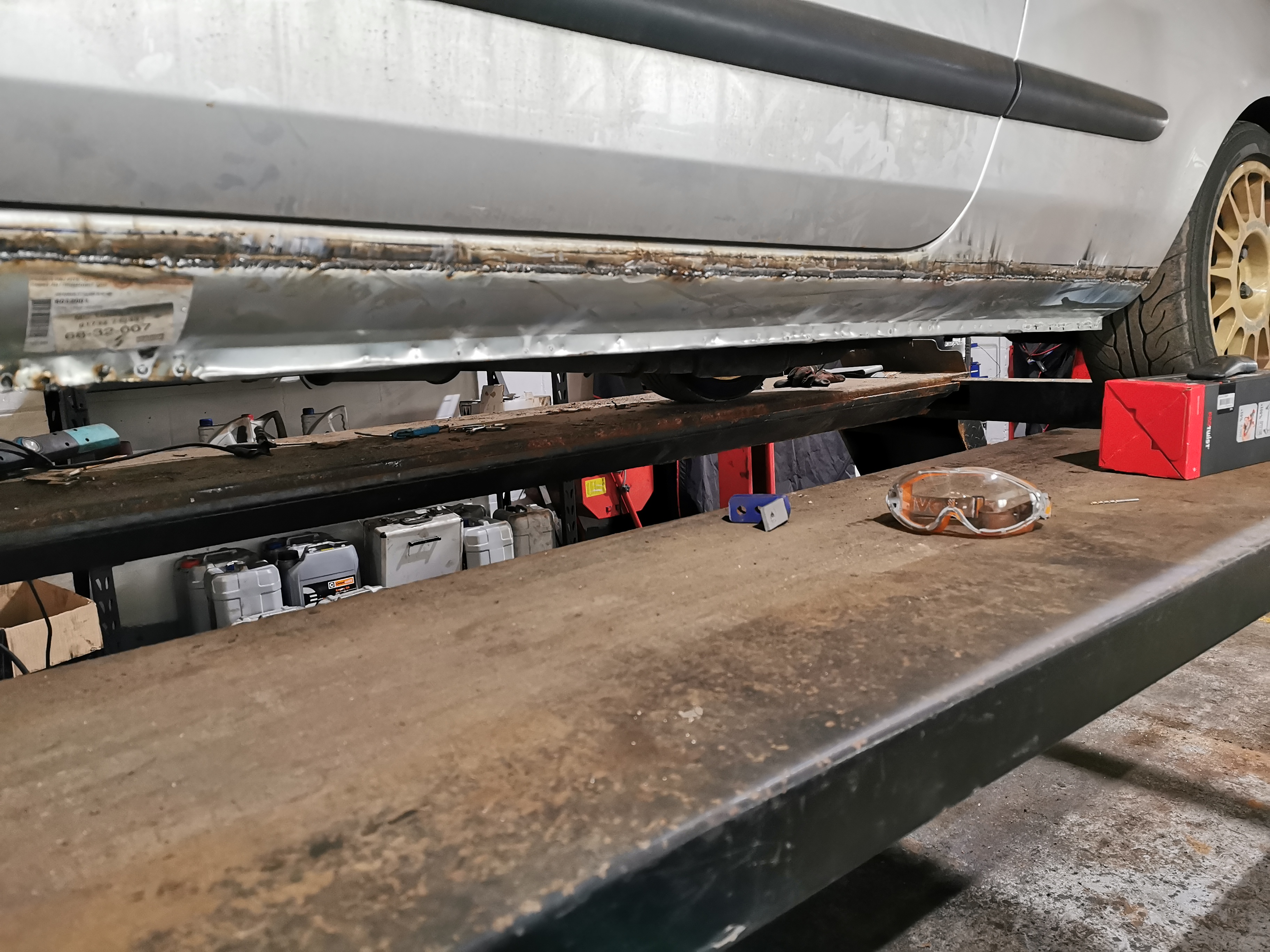

So I've welded the outer sill on the ns, inner sill and the mid sill to make it super strong.
The os sill is also welded in place
I've only ever welded once before so I'm happy with how it's turned out so far

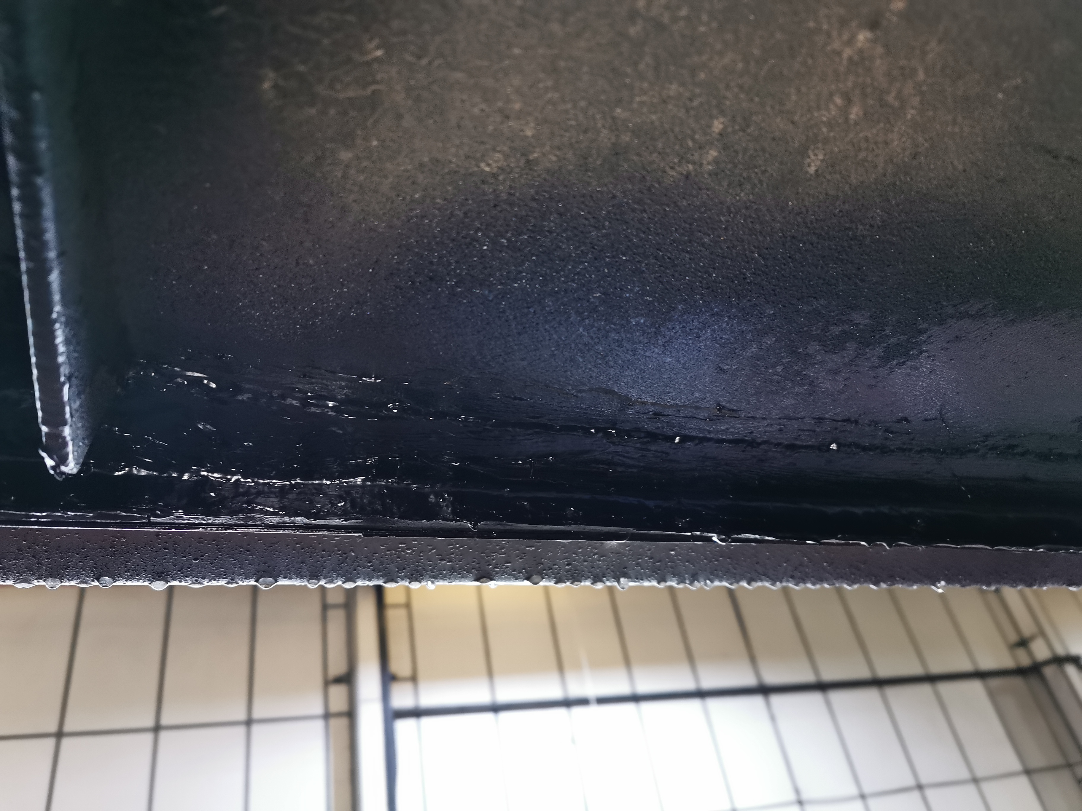

I'll be drilling a couple of drain holes along the outer to help stop the issue again
Next job is to grind the welds back, prime them and add some protection and then underseal the car

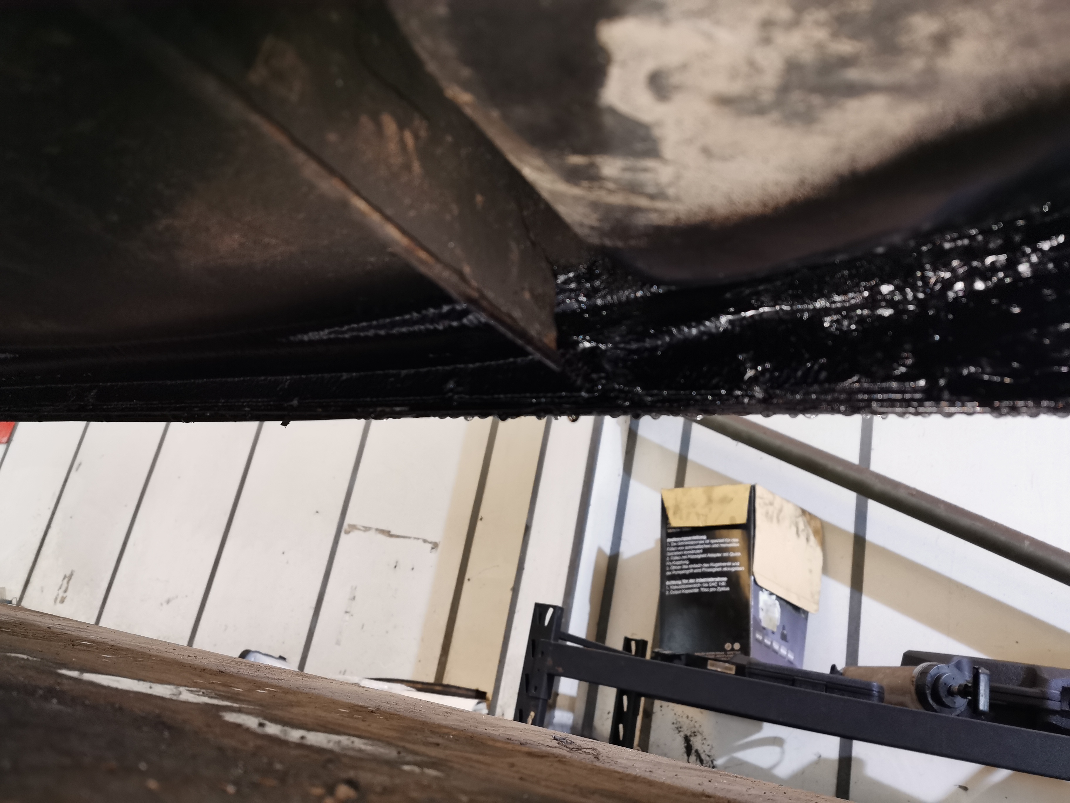

So we picked the car up from the garage on Saturday. I'm so glad it could be saved and put back on the road in a safe condition
Inner and outer sills welded on both sides, protected and now under sealed

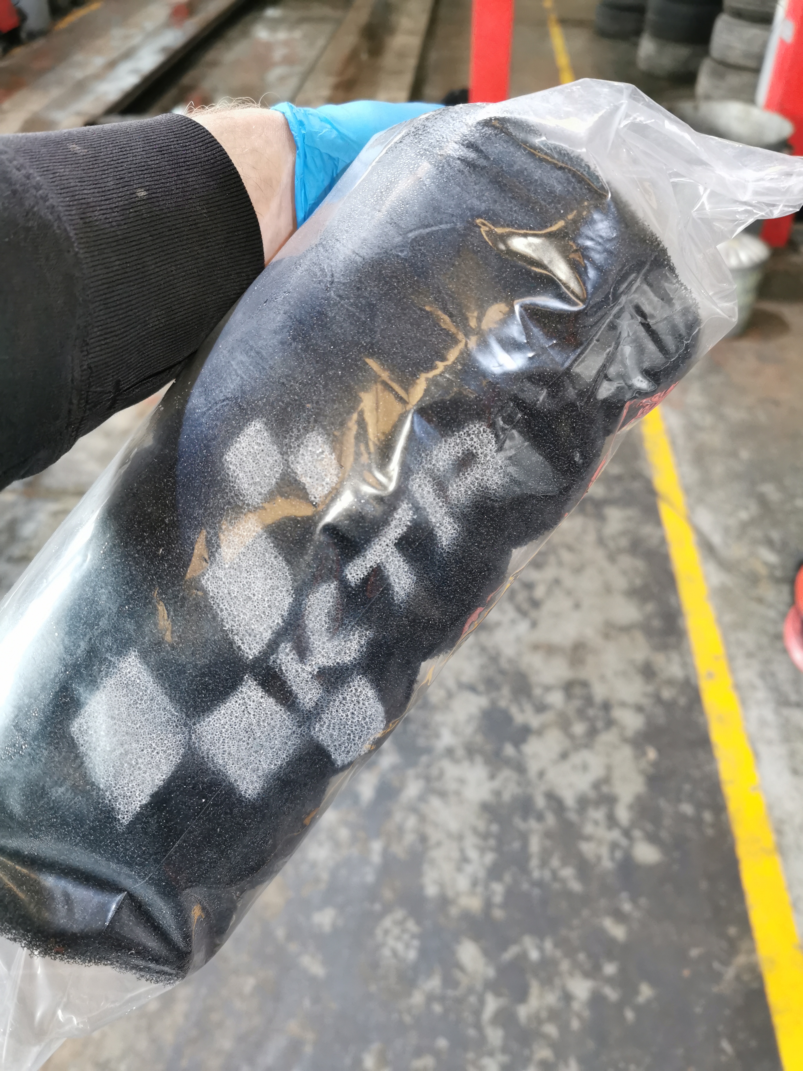

Also fitted a ktec panel filter as I didn't want to loose the Oem look under the bonnet with the ph1 airbox

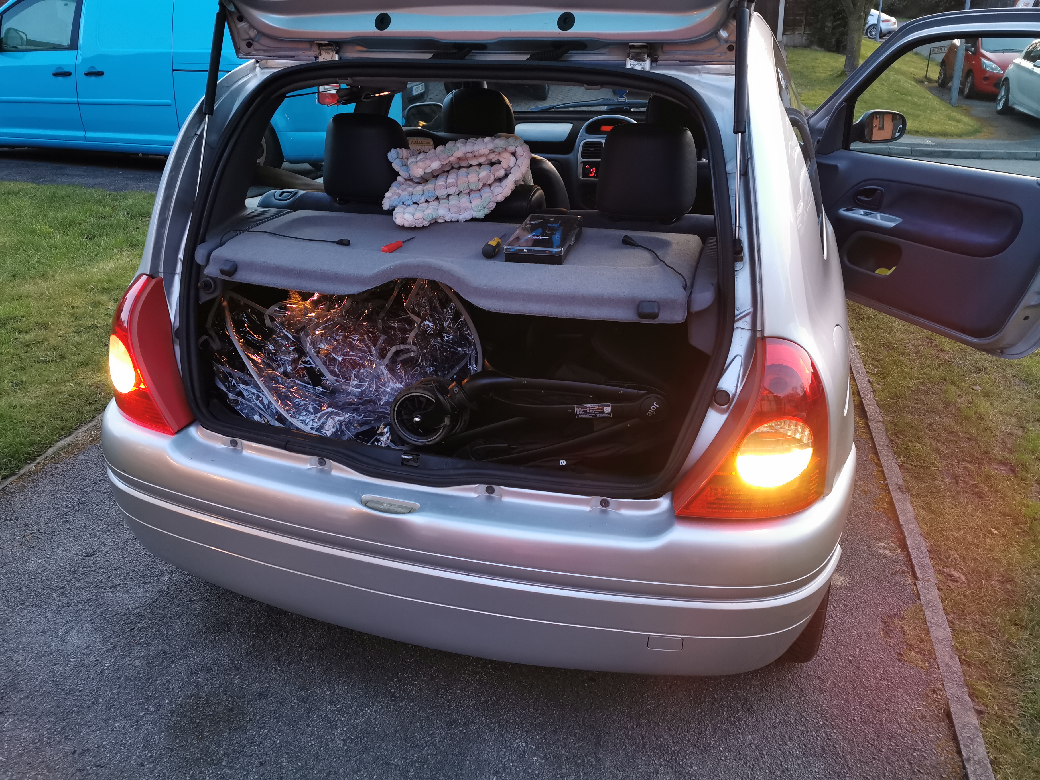

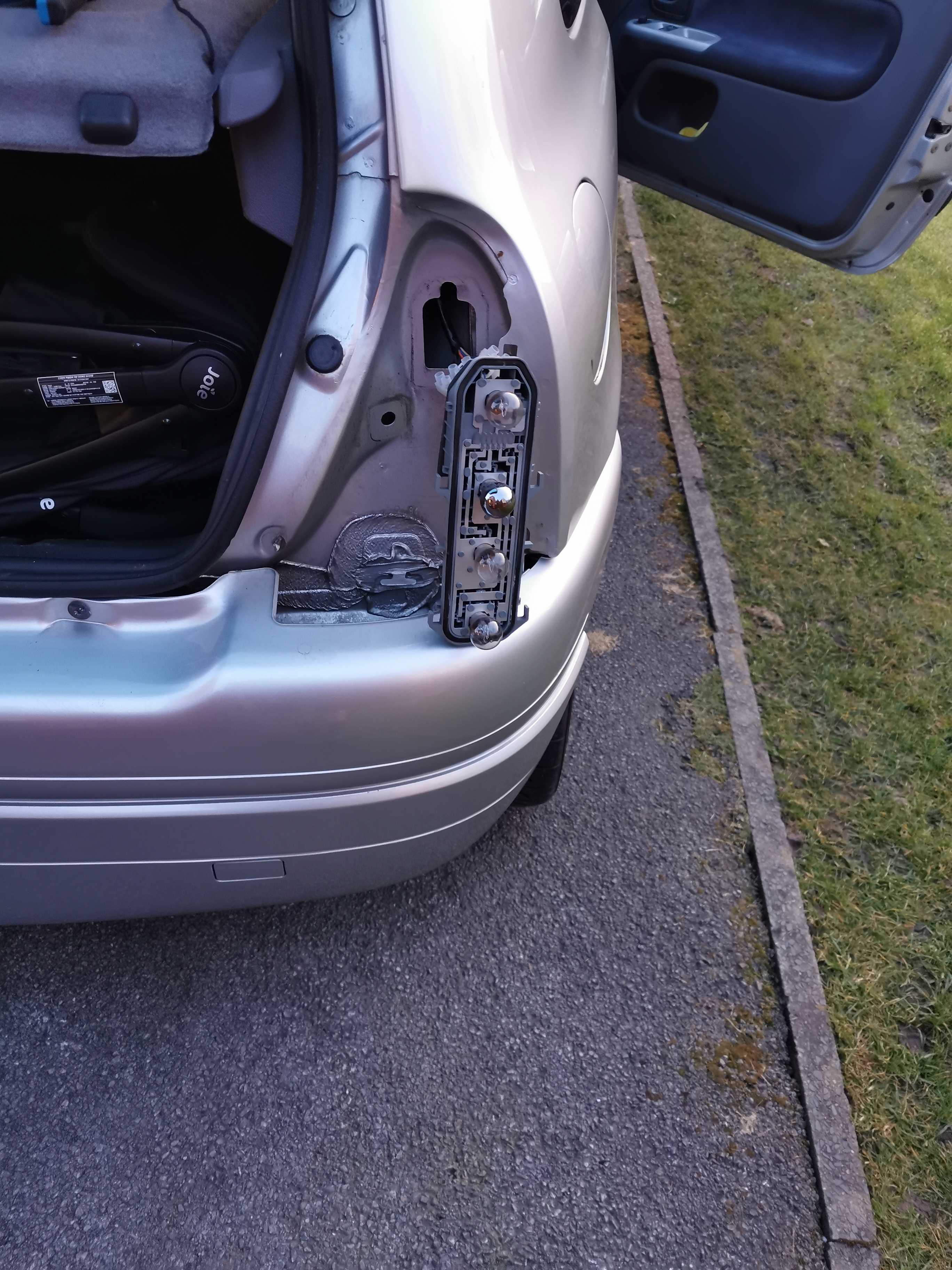

Noticed that the drivers reverse light wasn't working last night so removed the light to investigate
Some people's efforts are terrible🤦🏻‍♂️

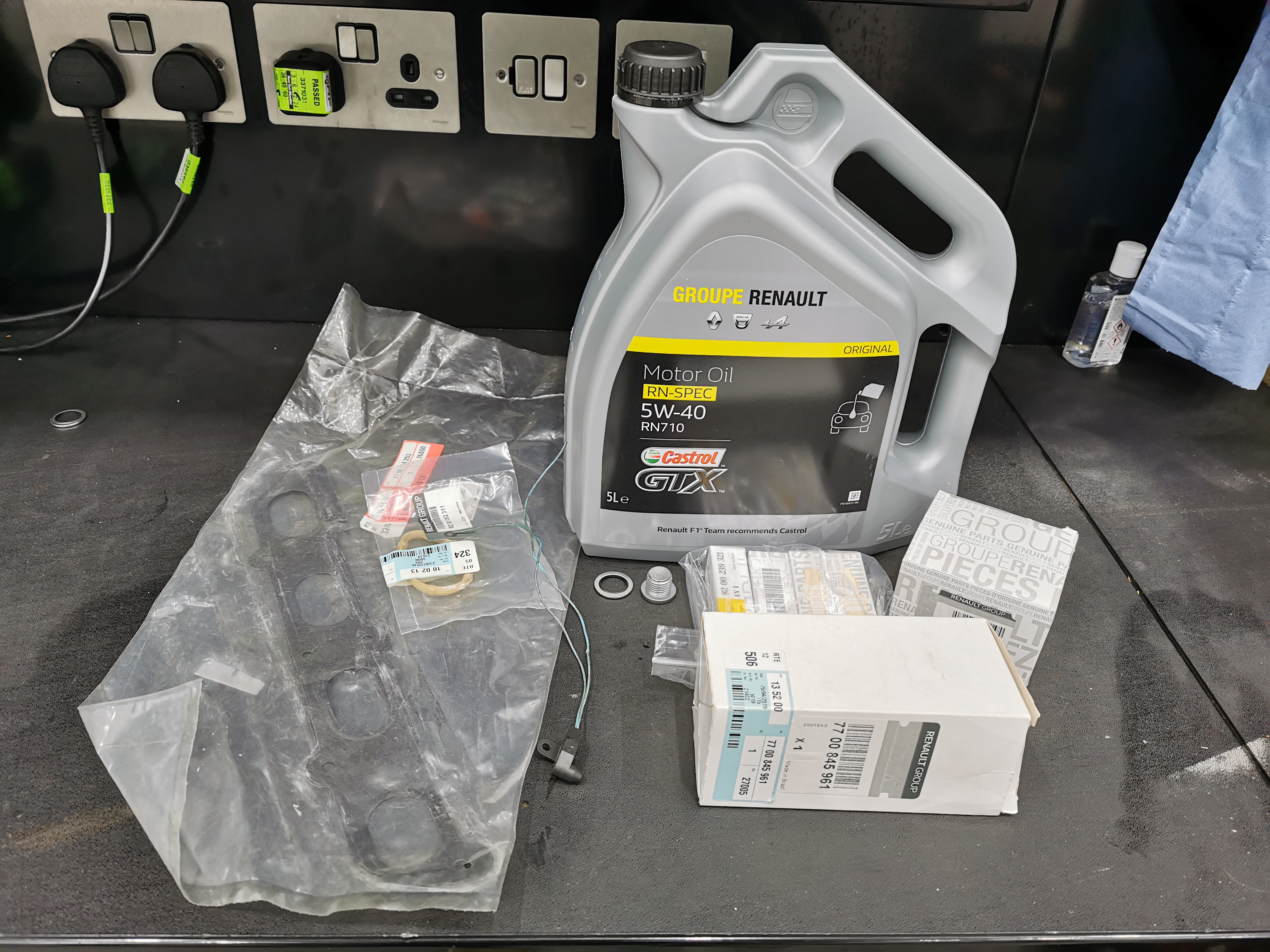

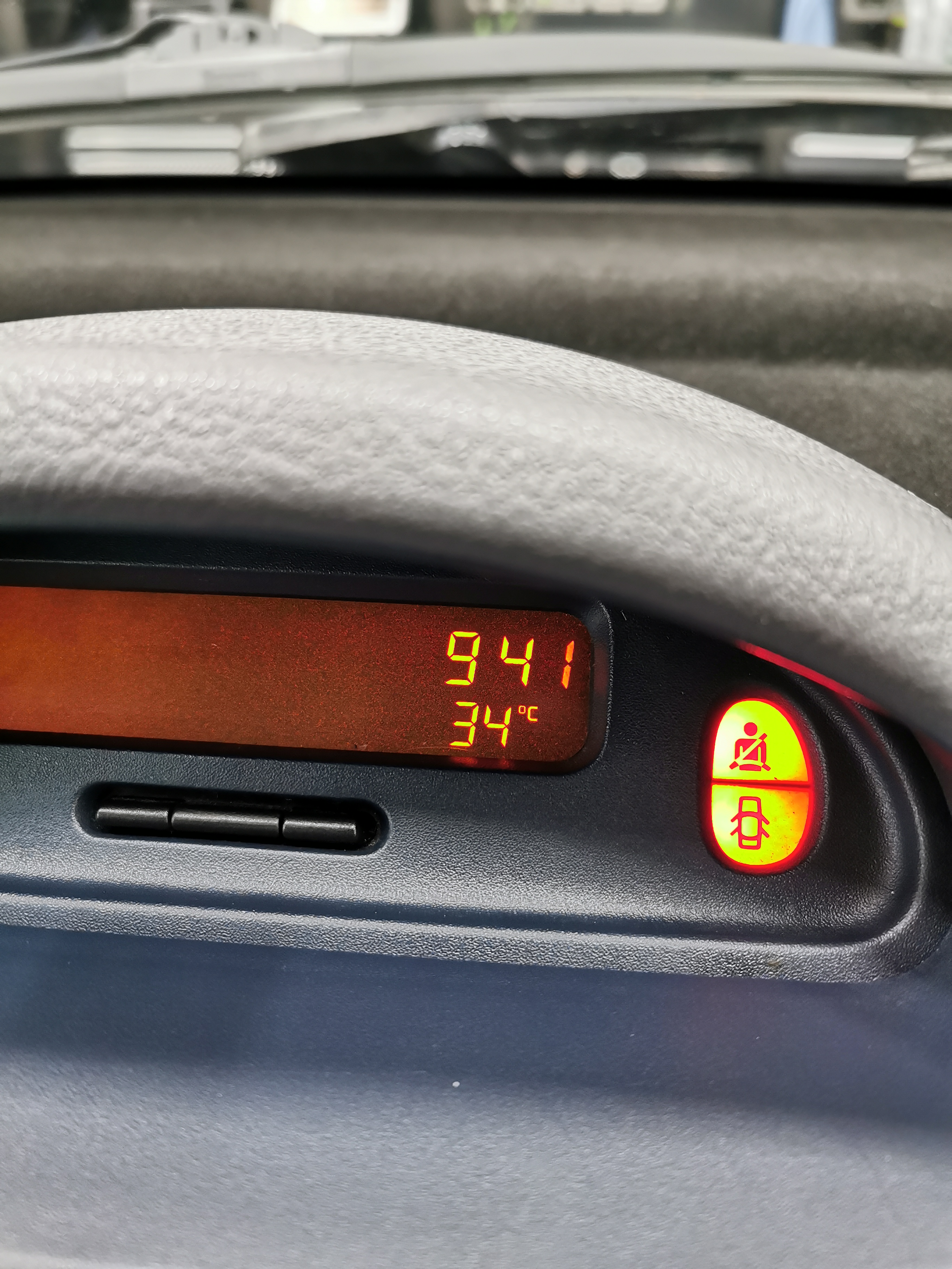

Gave the car a service in work today, and fitted the outer temp sensor as it was suffering from the standard sensor issue...... 34 degrees outside apparently 🤦🏻‍♂️🤦🏻‍♂️

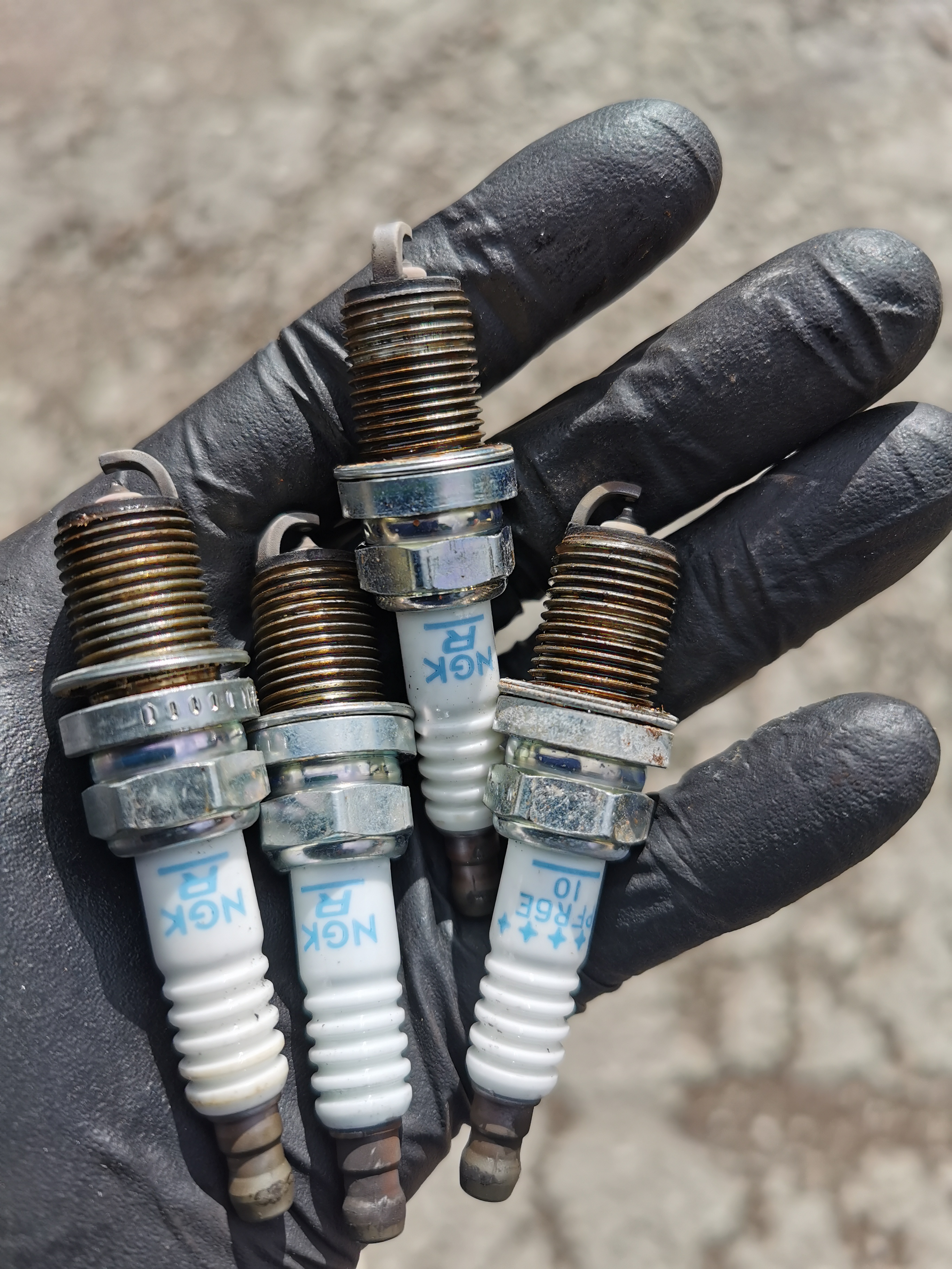

Full service with genuine parts
Oil
Oil filter
Fuel filter
Plugs
Sump plug and washer
Genuine inlet manifold gasket and o ring

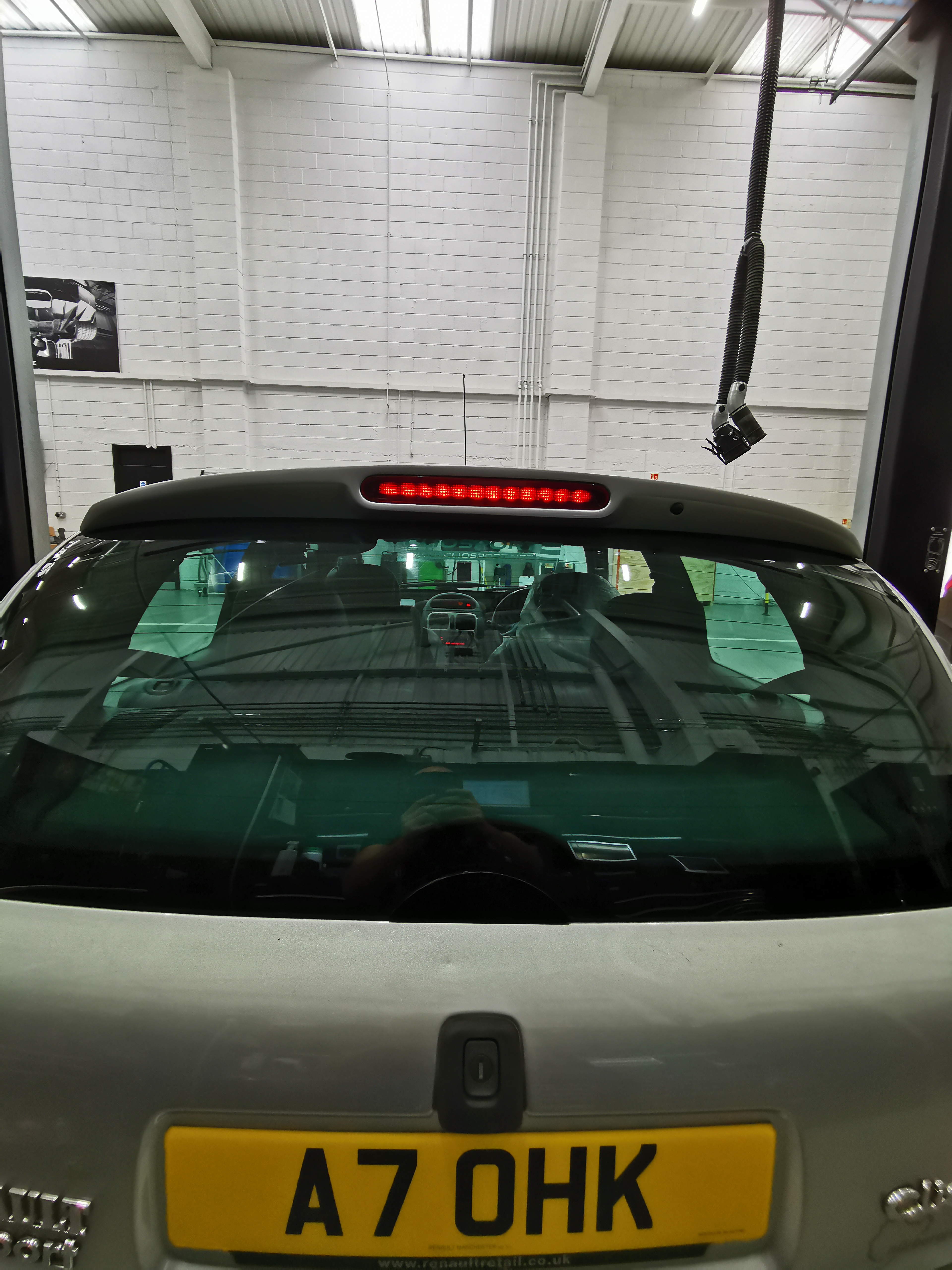

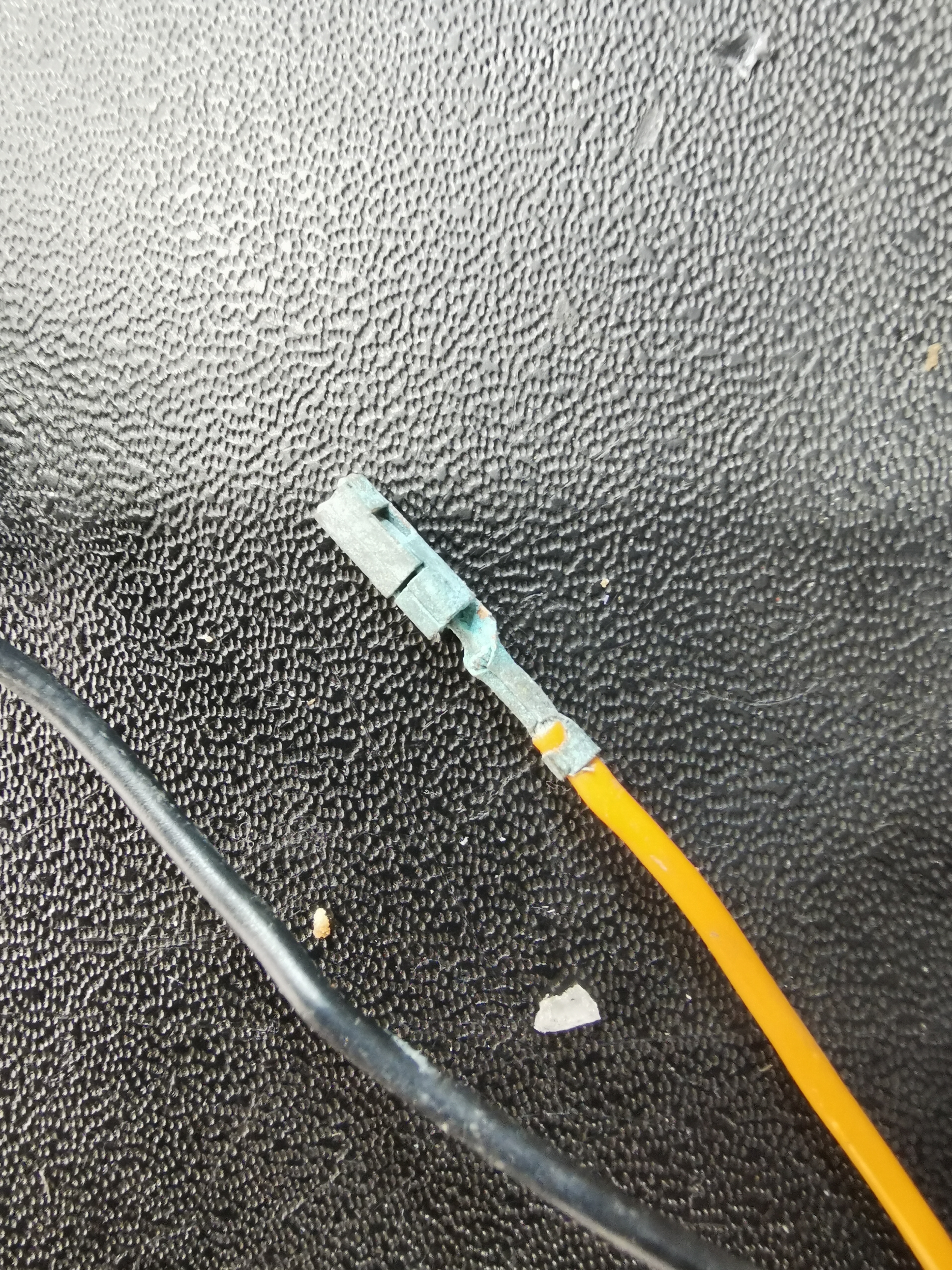

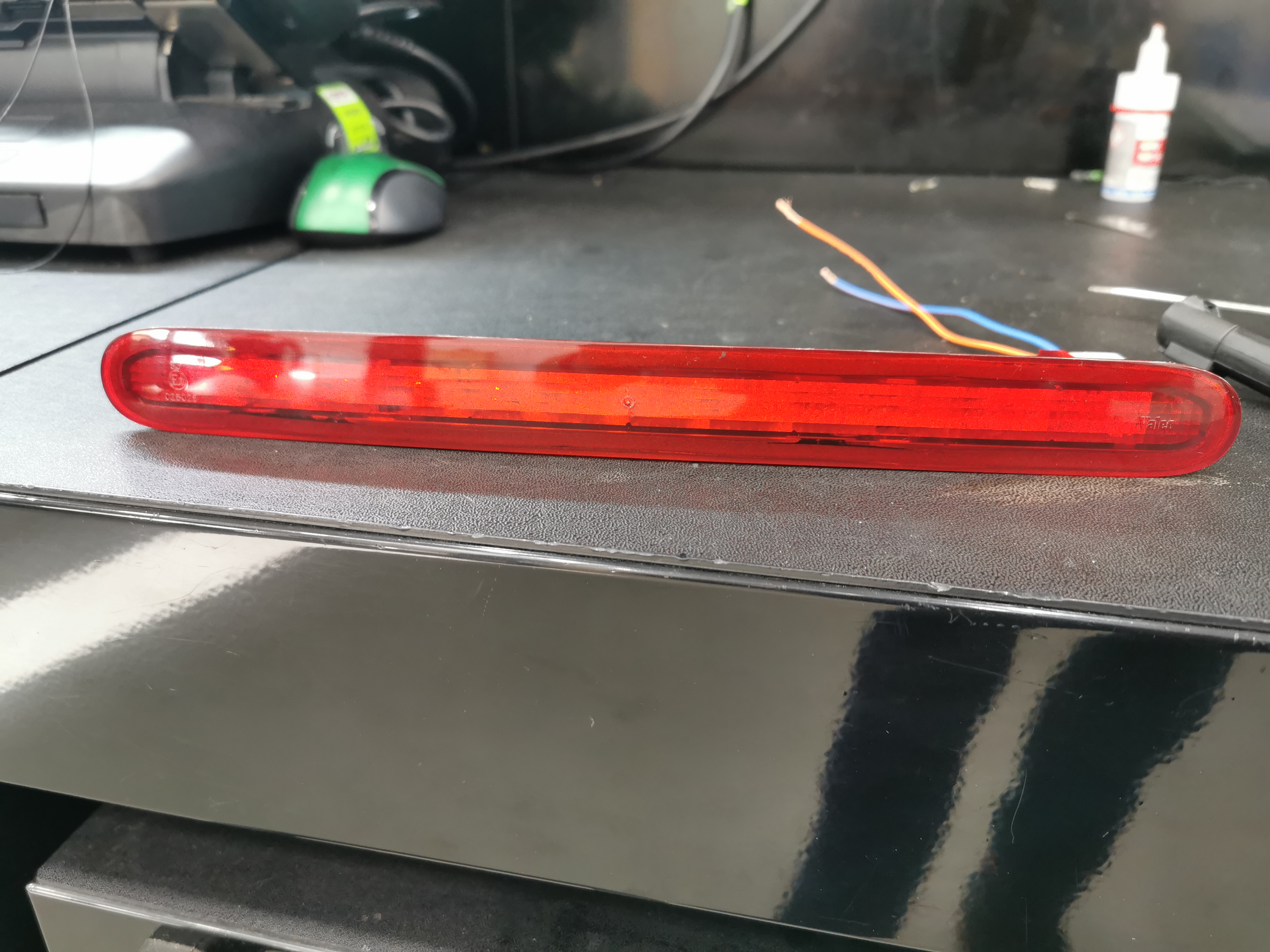

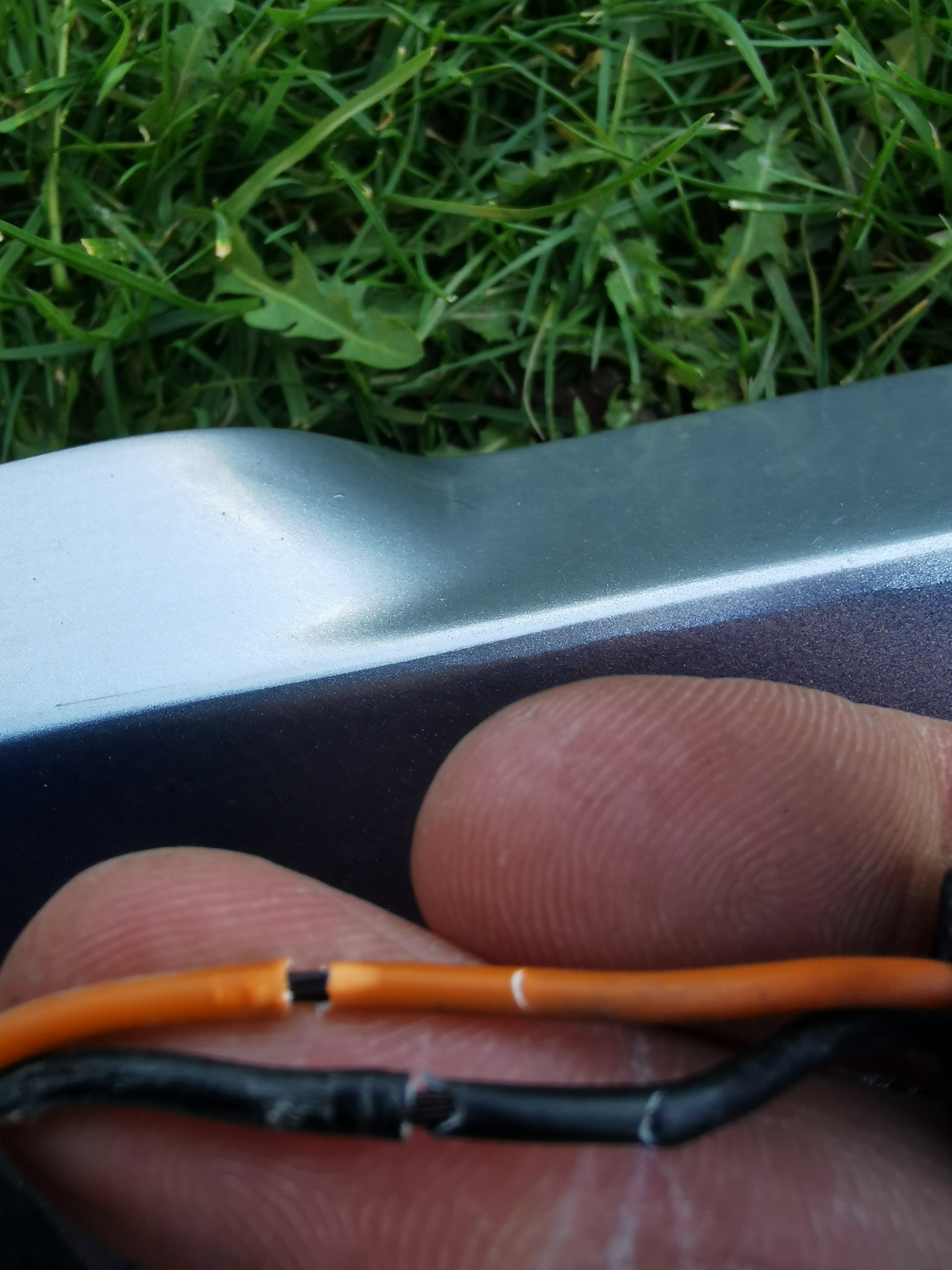

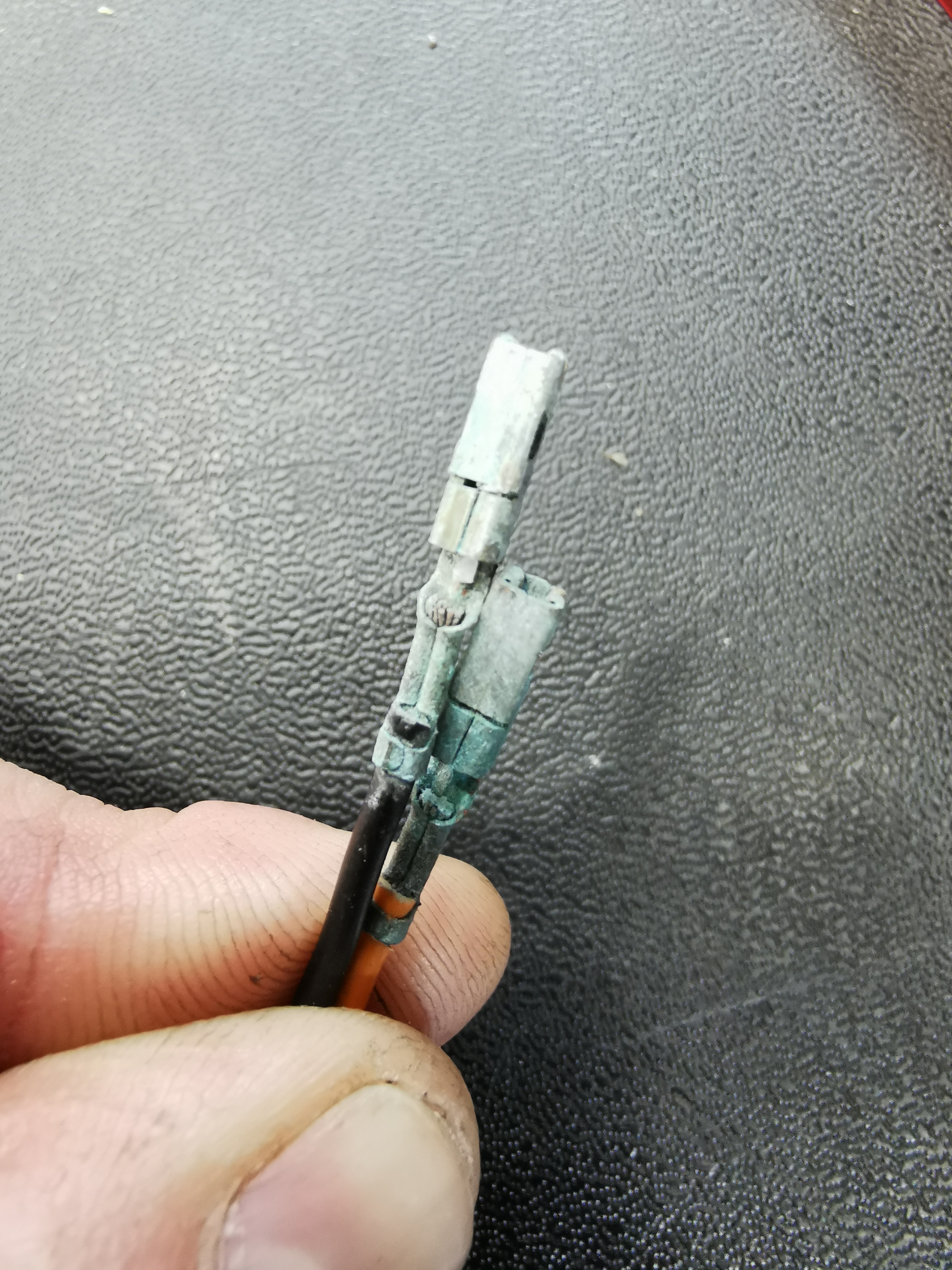

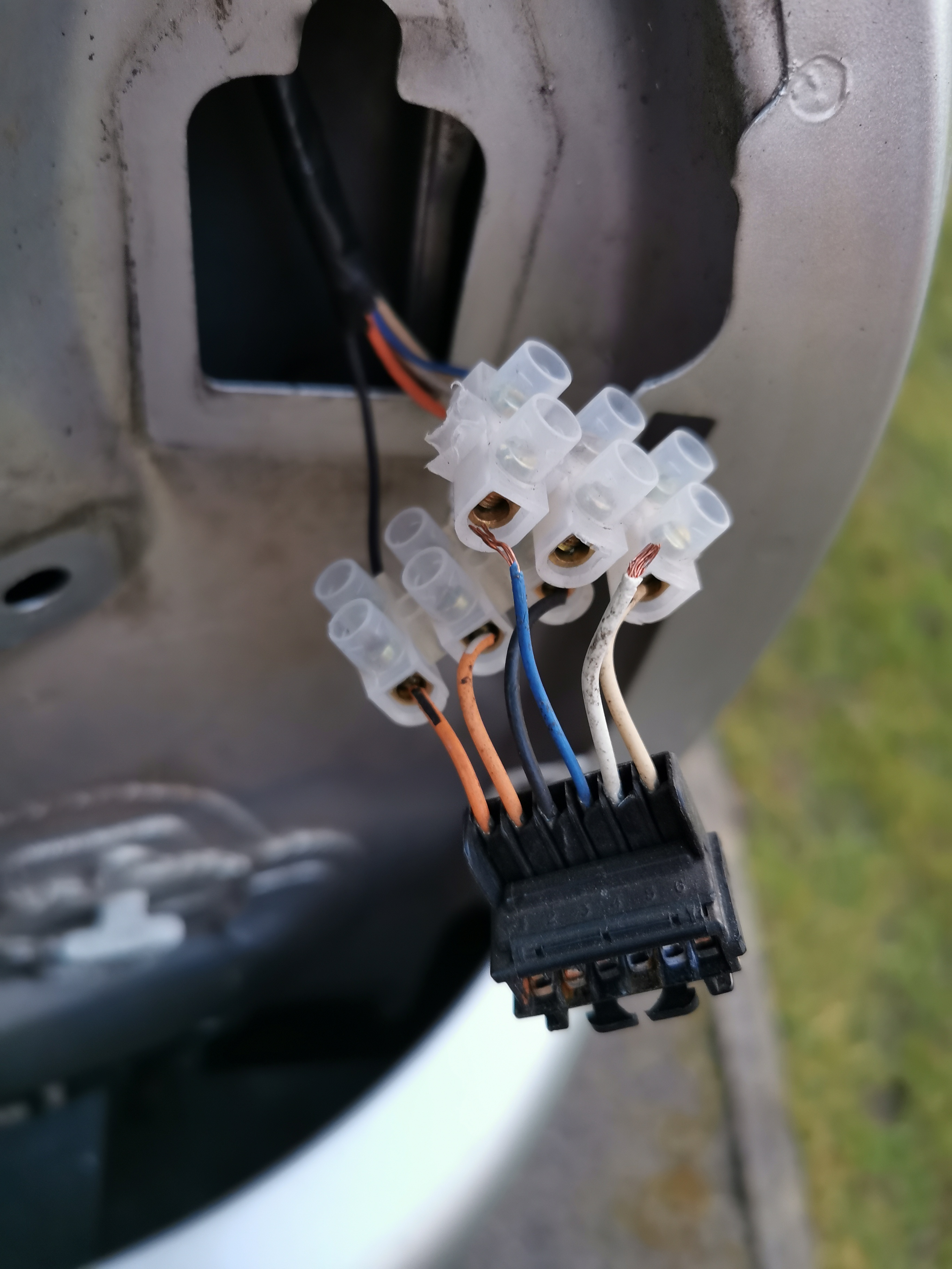

Decided to investigate why the high level brake light wasn't working
Removed the spoiler to find a corroded connector

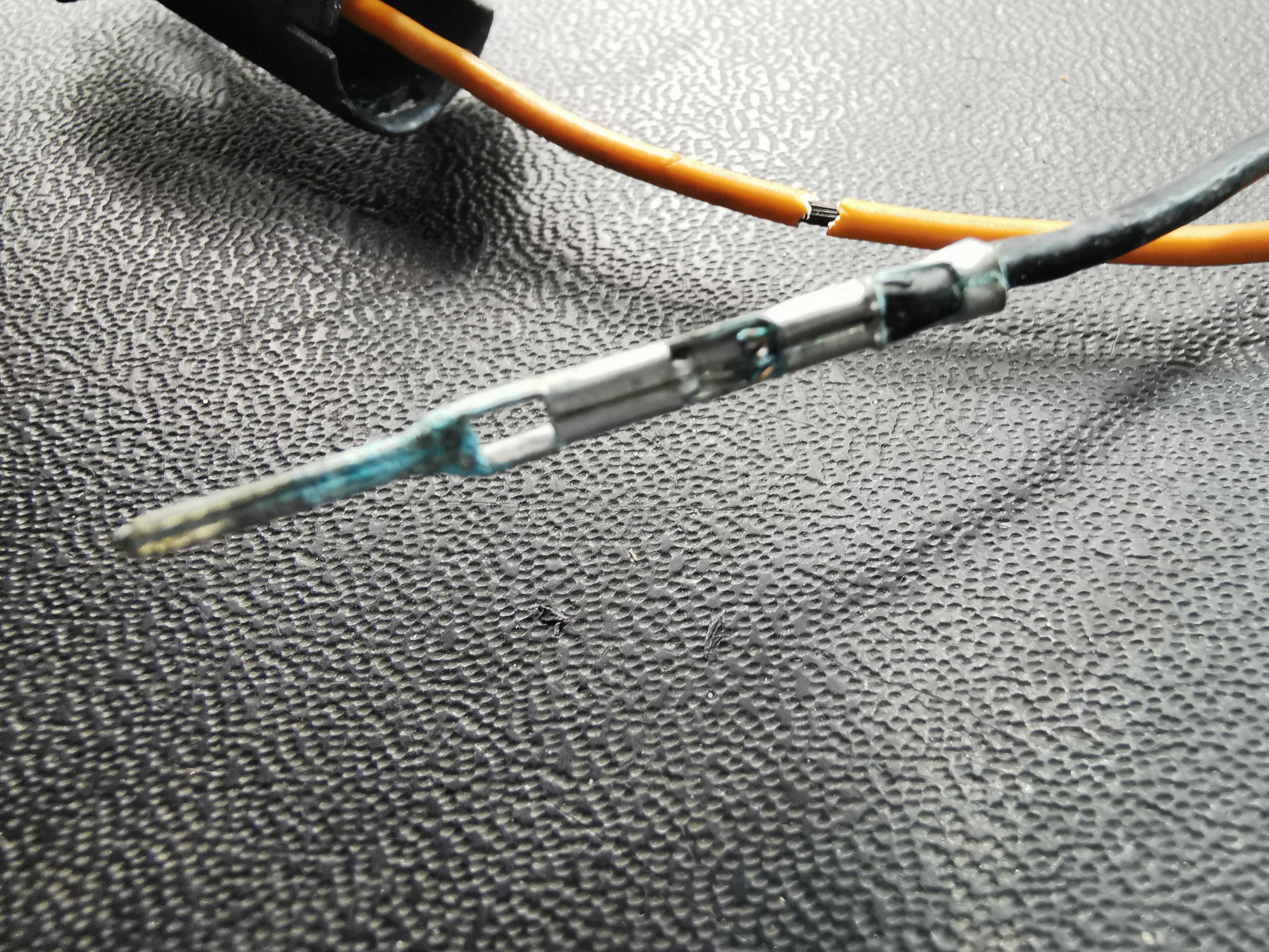

Stripped the wires to find them rotten

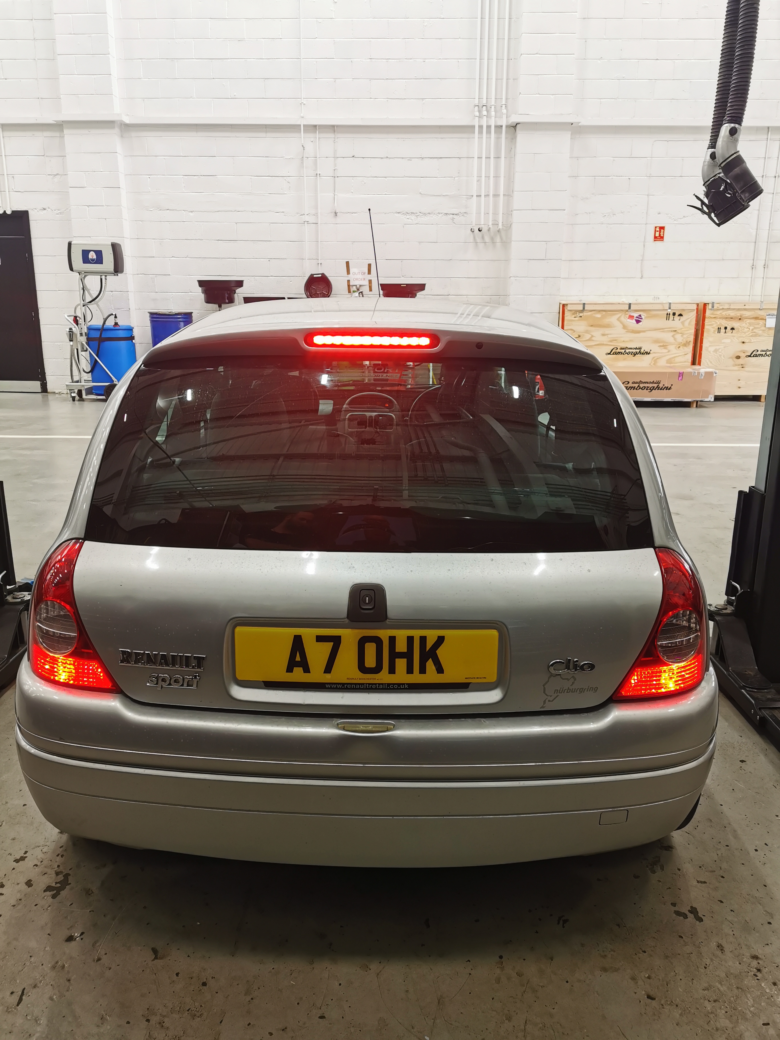

Removed the light unit last night and tested in work today the light unit itself is fine just need to make a new loom
Led unit plug stripped and new wires and pins sorted. Jobs a good en 👍🏼
Center led isn't as bright as it should be unfortunately.
Does anyone know if there are any replacement led stips available that would fit as a replacement?

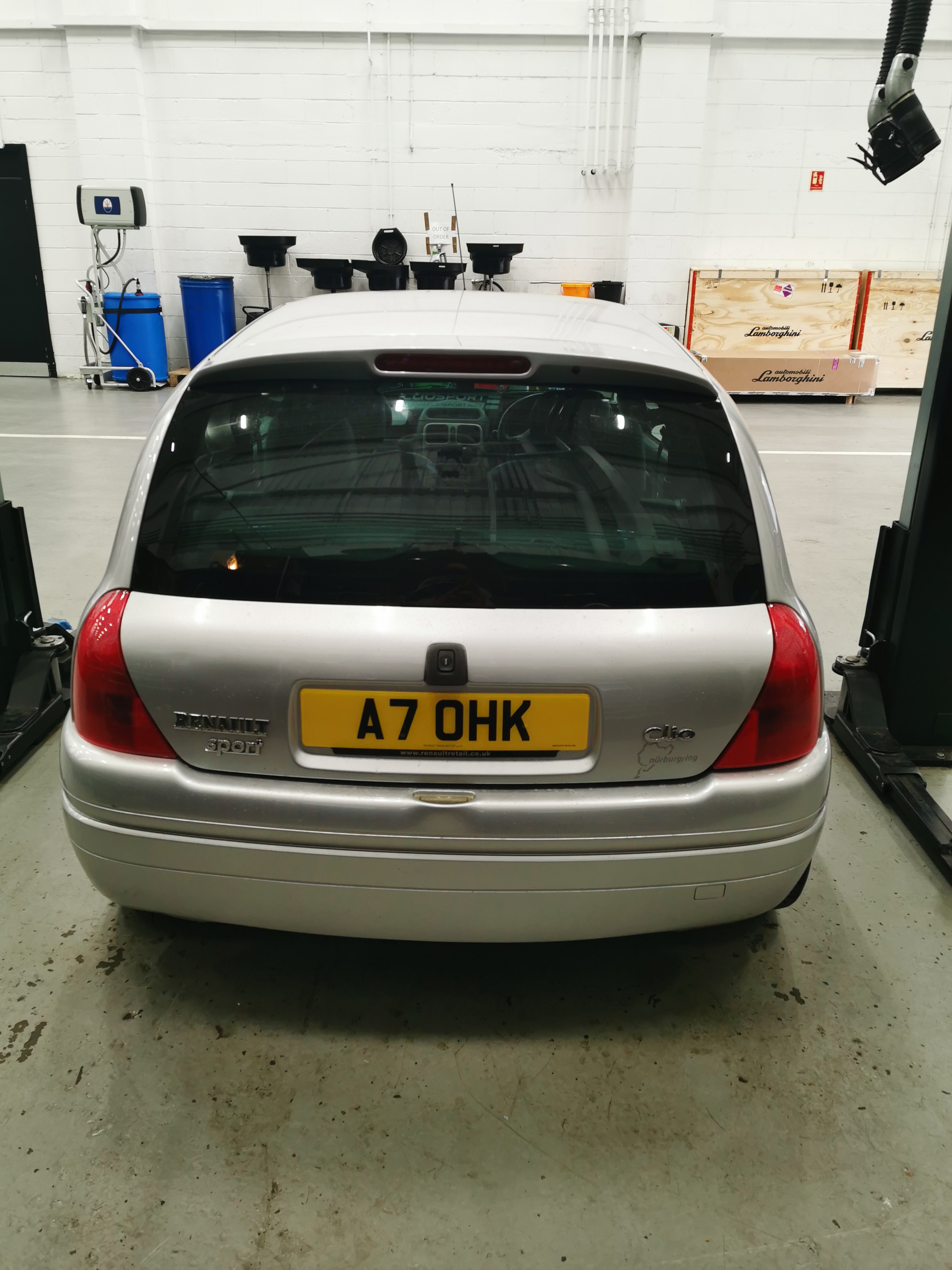

Replacement led strip sourced and fitted. Also fitted the ph1 rear lights
In my opinion it looks better

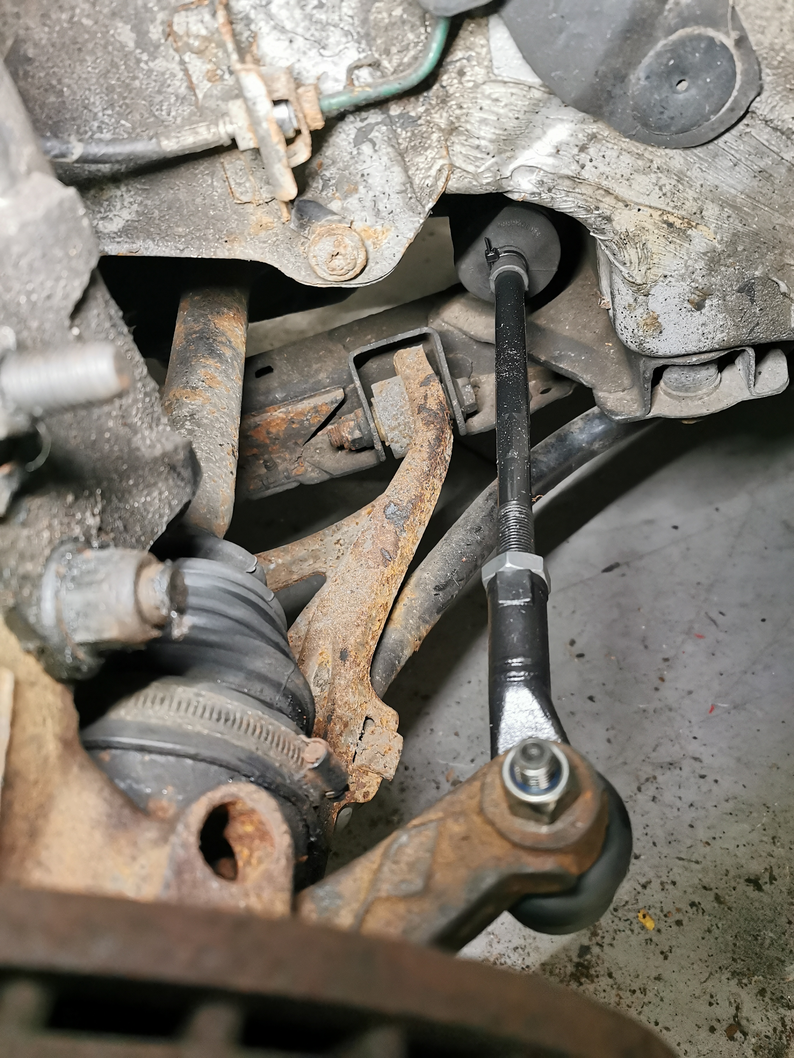

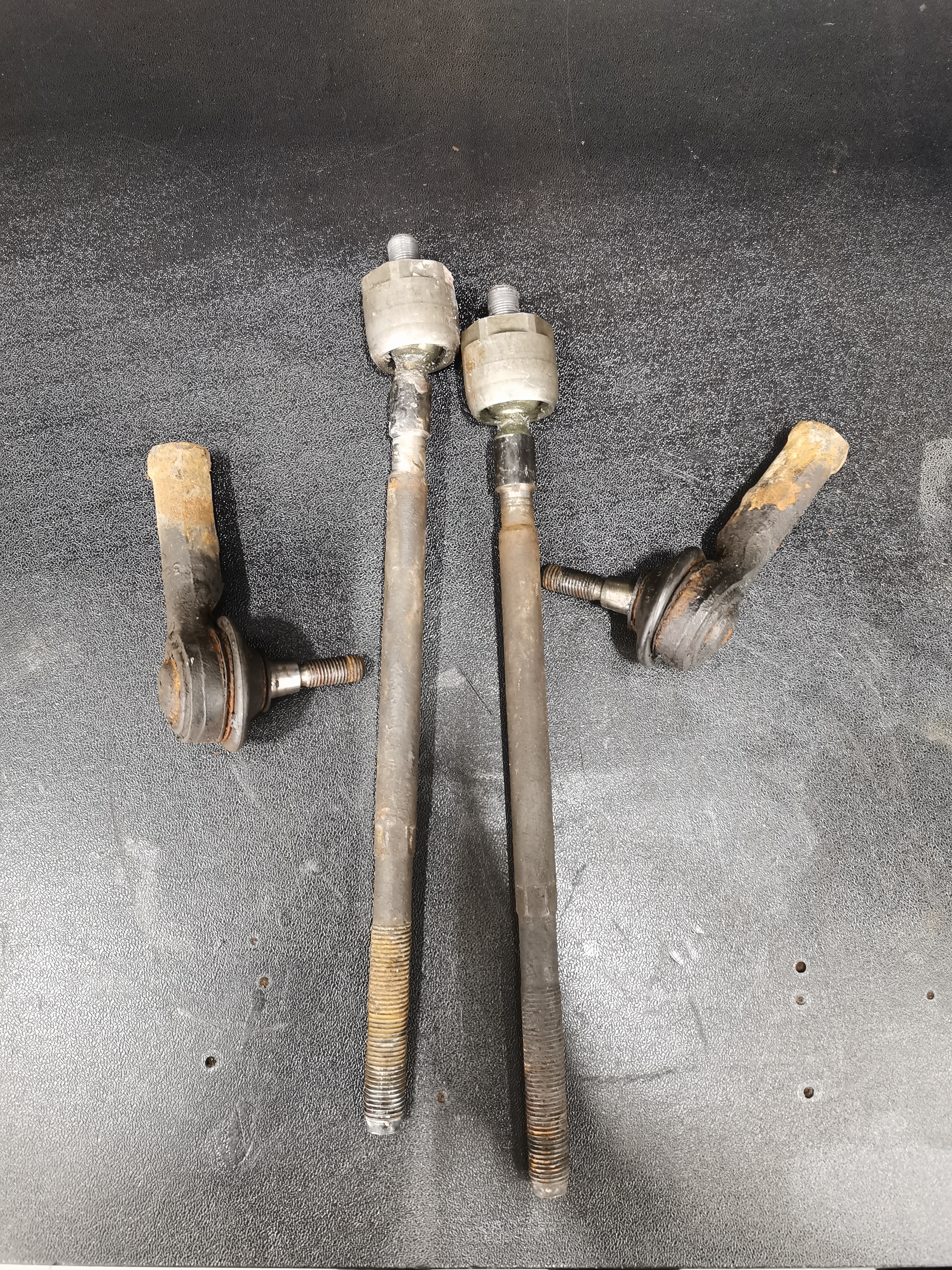

New inner steering arms and track rod ends fitted ready for the rs peak district drive next weekend

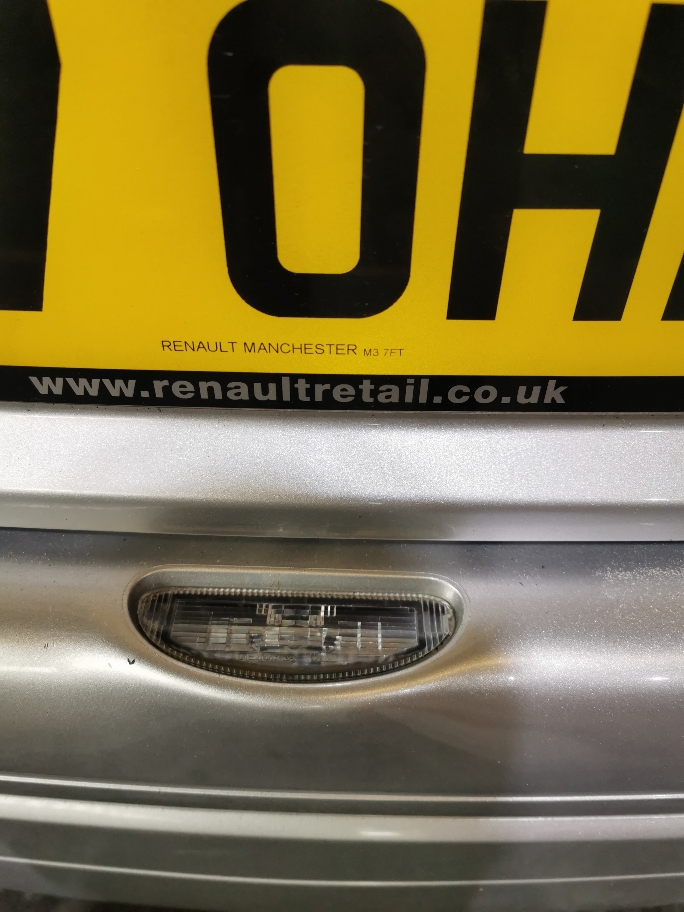

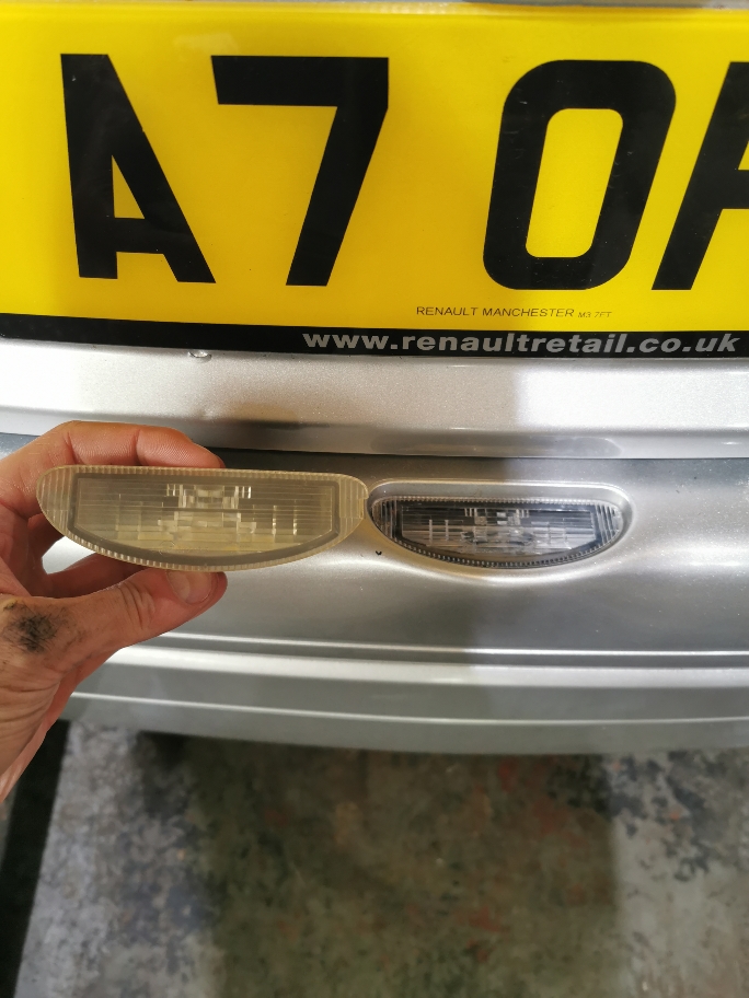

Fitted a new number plate light as the old one was tired
Makes such a difference to the rear

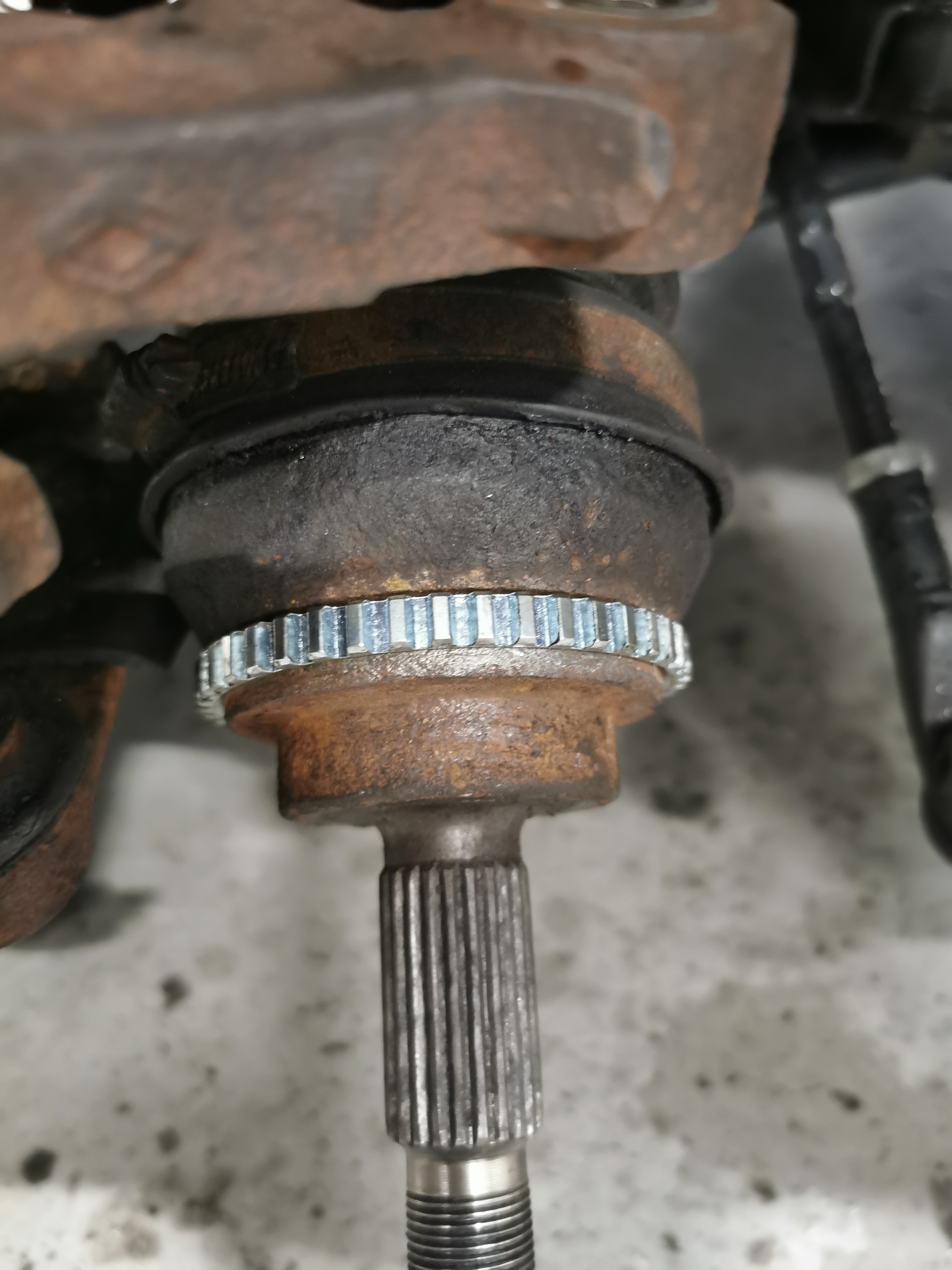

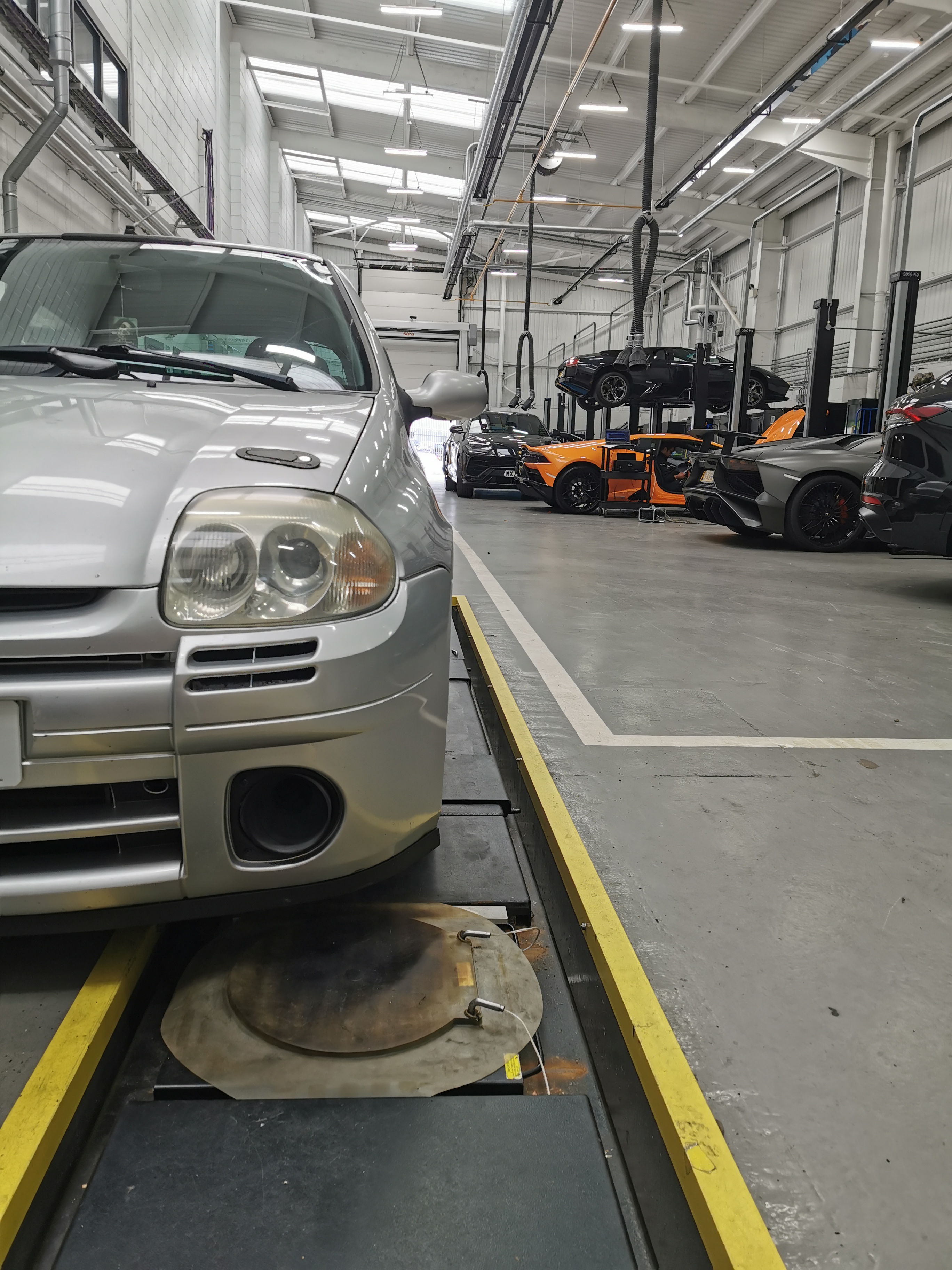

The clio hasn't really been used since the rs drive, its just been sat in the garage.

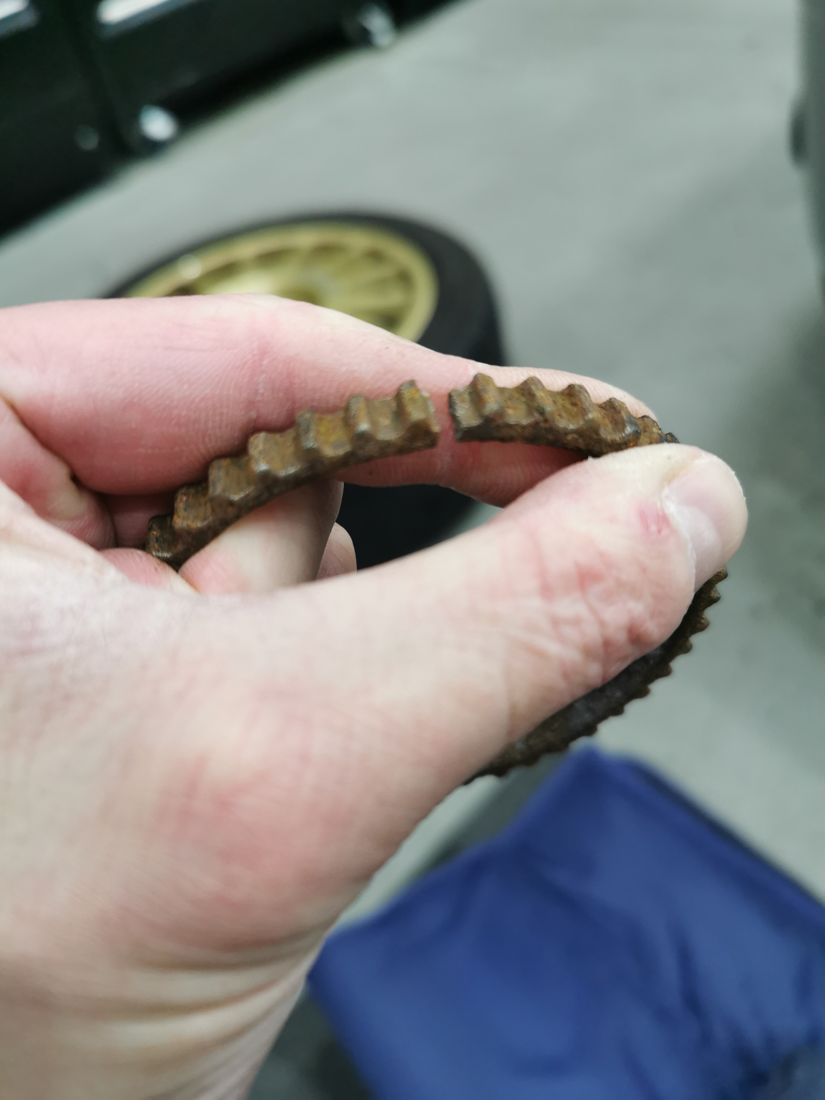

However mot this coming weekend and new front abs ring then to start using it for a bit
Replaced the old snapped abs ring at weekend due to the ring causing the standard abs feel under breaking

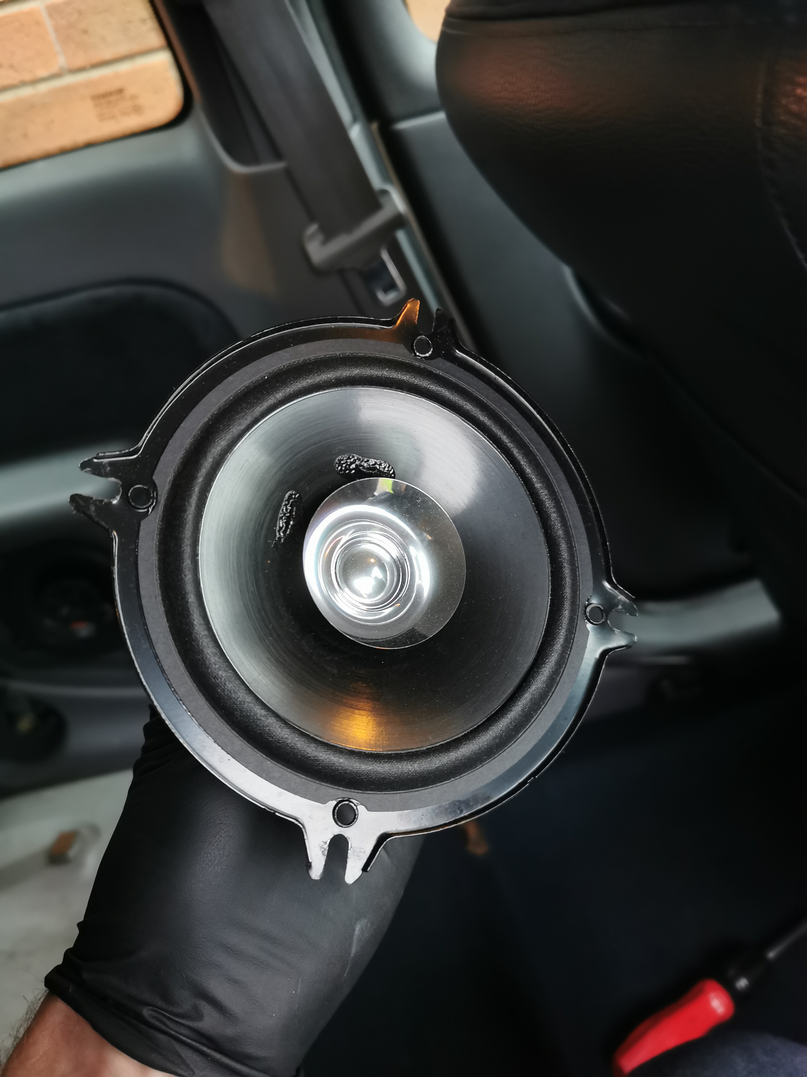

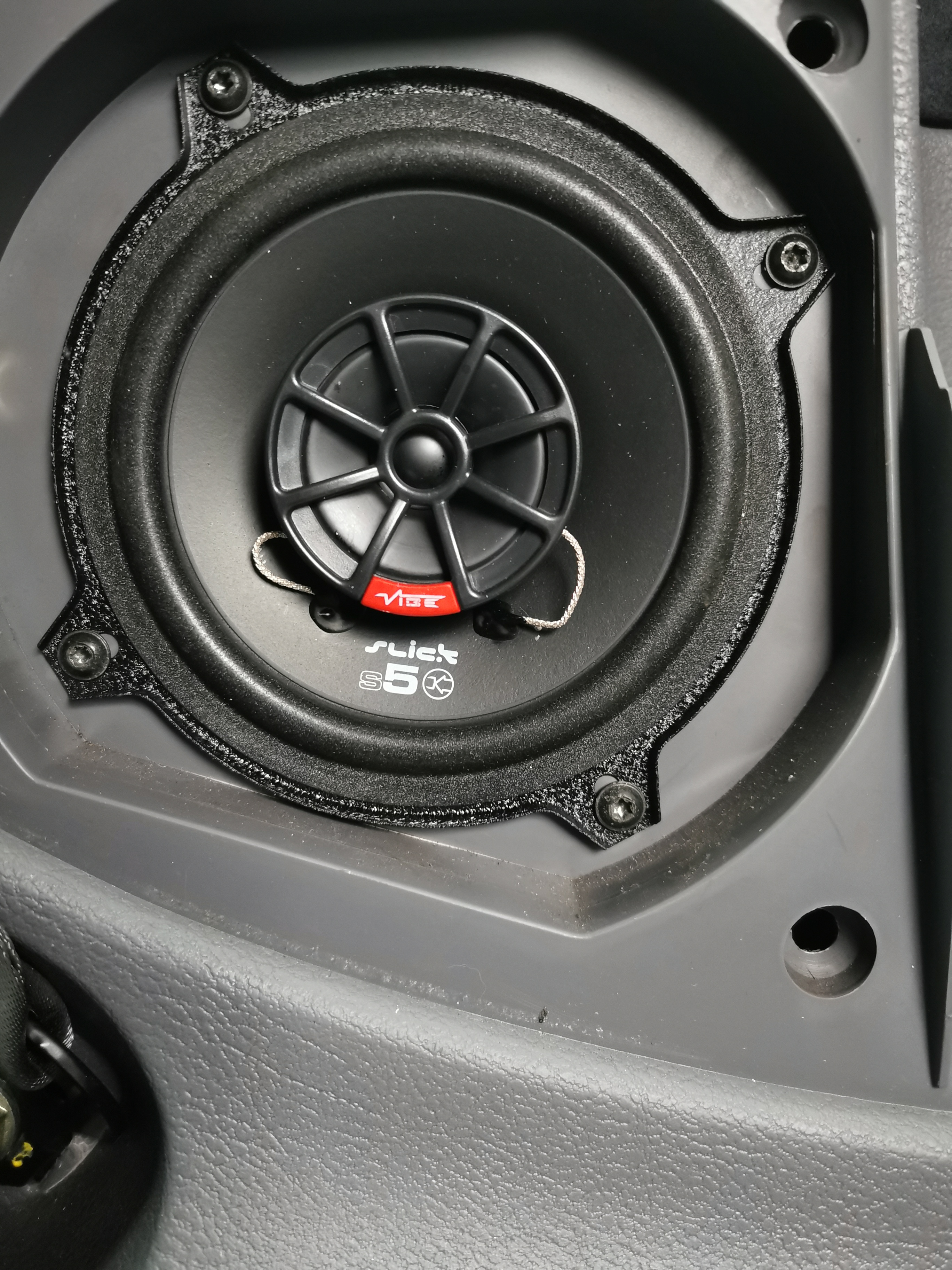

Replaced the shocking crappy 25w pioneer speakers all round with some upgraded vibe speakers
