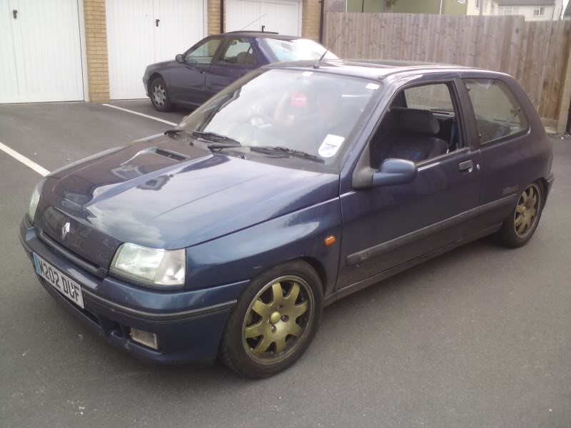

I have finally got round to getting my mate to sort out all the little scratches and marks out on the Clio, including the big marks/scrapes on my rear bumper from the recovery lorry driving into it at the beginning on the year. :mad:
No pics yet as the Clio needs a good wash but will be up soon. Im very happy with the outcome!

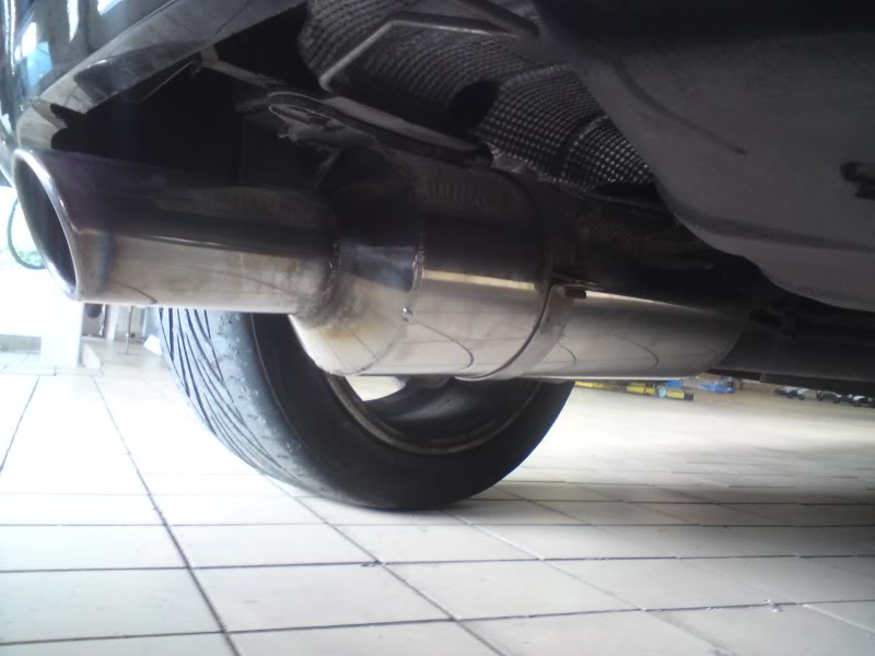

Well I knew the Clio needed a new exhaust. It has always been a problem for me, Iv been through 3 middle sections, the last one Blueflame kindly modified for me with pieces of ally to strengthen it, but alas that did make it last a bit longer but it still ended up cracking as per the previous ones.
Although I tried in vain to weld it, I knew ultimately I would need to buy a new one.
Dan came to the rescue and as his exhaust was now no good to him, I decided to purchase his.
But Thursday, I noticed on here that there was a chap not far from me who was selling his Yozzasport exhaust off his Ph1 172.
The price of Yozza's were way out of my range, so it was really something I though id keep an eye out for a 2nd hand one. Unfortunately, they usually sell for a decent price and very quickly.

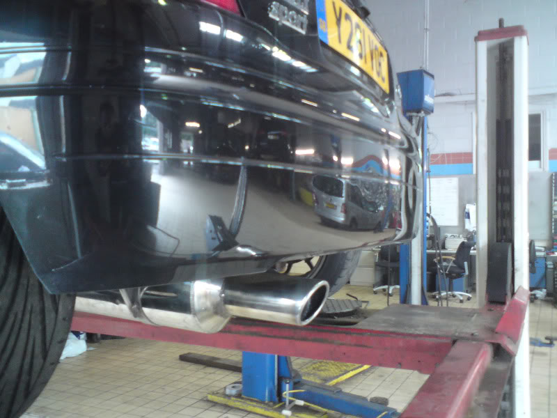

This one though, was a good price so off I popped to the Air Baloon Pub, met Paul (Cheers mate!) and collected my Yozza :D
Today, once I had finished work, I cracked on and due to the brilliant design of the Yozza, it fitted right on with no hassle!
At that point Dan turned up, as he is buying (Now bought) a car off me, and helped out with a broken exhaust mount I had, and we did the Ghetto rear exhaust hanger mod and the job was done!

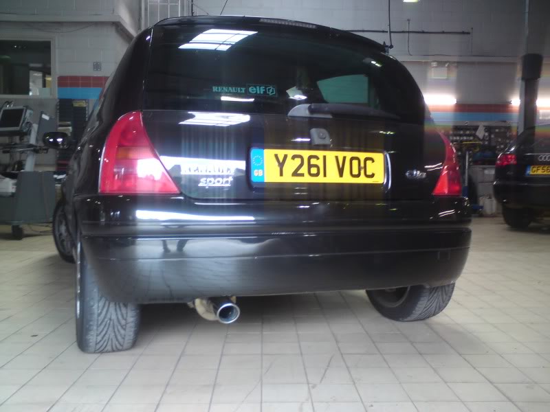

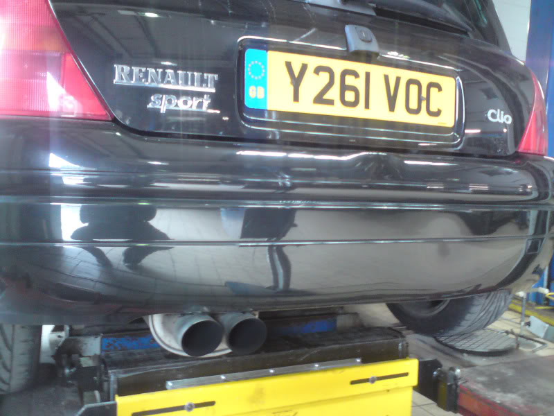

Before:
And after:
The pictures dont do it justice, the exhaust is a work of art, from the welds to the joints - perfect.
The difference really is night and day, no bangs or rattles, no exhaust blowing, a decent looking tailpipe and a FANTASTIC noise!
Yozza's are known for being loud. In fact I was expecting it to be so loud I still bought Dan's exhaust as I was expecting the Yozza to be a bit too loud, but first impressions are good, it is louder than the Blueflame but not a huge amount. Will be giving it a proper test over the next week.

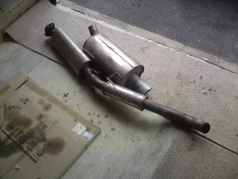

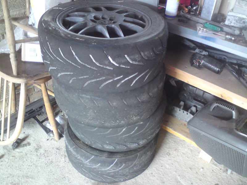

Of course I couldnt just have Dans exhaust, so I also bought his Ph1 wheels, complete with well worn R888's:
And Dans exhaust Iv got:

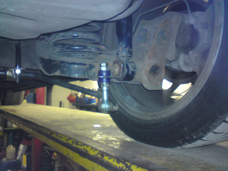

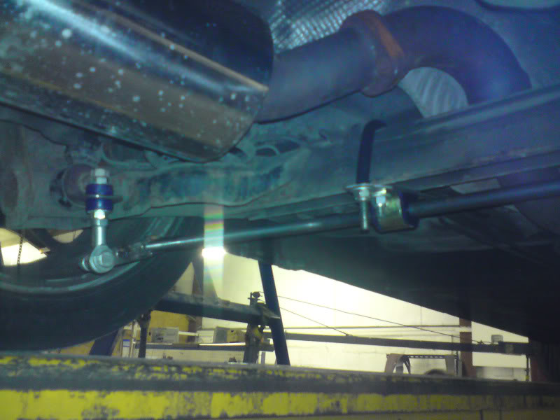

Custom rear anti roll bar fitted :) (That one is prototype)
So far very good results, better turn in, feels like front end grip is better and back feels more controllable so all in all very good :)
  53 Clio's & counting
No mate, was designed this way, gives a shorter link to make it stiffer, though the option of turning the bracket the other way and having a longer link is available also.
ok, just looks a bit sore hanging down like that. I'd have though attaching it to something better than that L bracket on the end of the damper mount would have made a lot more difference than shortening a rod that's in tension.
Thats how the Clio ones are all designed matey, even the Whiteline ones.
Agreed, it would look neater if it would attach to something else, but im assuming that must be the best place tension wise?
I think the whiteline ones look sore too, I thought you might like to make a nicer job of it ;)
If it was me I'd be looking at making bolt in sections to make the standard < shaped beam into a <| and not hang a bar on at all. I've done something similar on my 5, and will probably do the same to the Twingo as that really does have a floppy rear beam

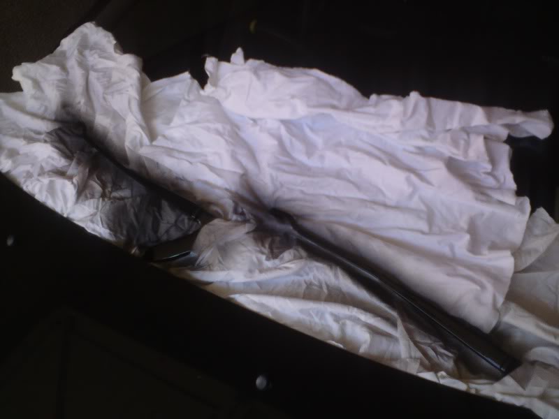

Wipers sprayed as they were looking tatty

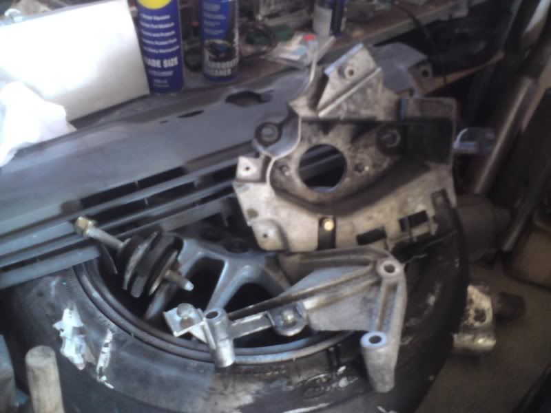

And im doing something with this
More to come tomorrow

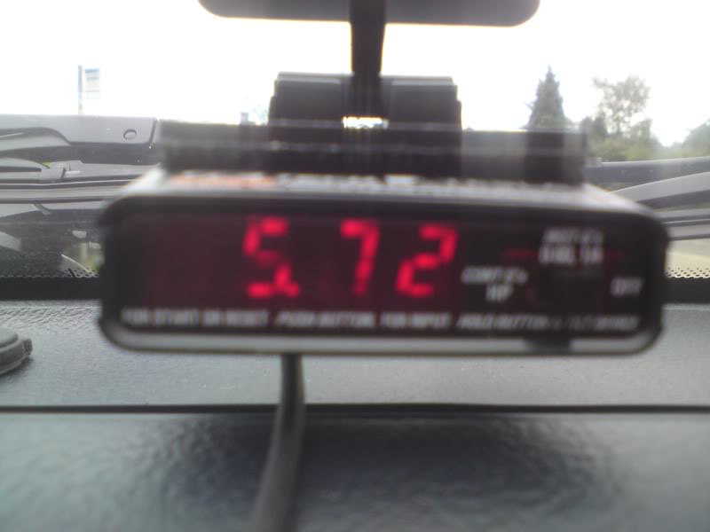

So with the improved map, I just gave my Gtec another whurl and:
:D
thats a second faster than what I averaged before the ITB's were fitted :D
