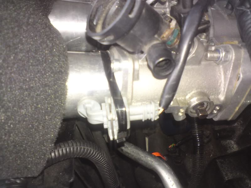

So I thought Id move the air temp sensor. Normally these are mounted into the air filter, but as Im not running a filter with a back plate and wont be for a while, I thought id try a different route so I drilled into a trumpet and mounted the air temp sensor direct, so it can read the exact temperature of the air as it enters the head:
Excuse the cable tie, this was a temperary measure to see if it would work:

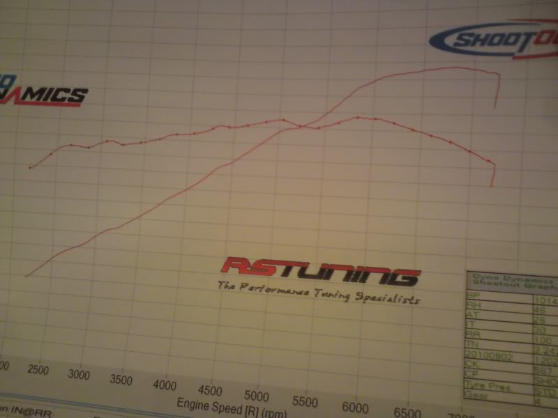

This, and the new lambda probes (thanks again Maynard!) had an interesting effect on the map, it made the car run rich at the bottom end and lean at the top, so Paul needed to do some changes, but I left with a much smoother looking map:
The power curve is getting to the point where you can near enough draw it with a ruler(apart from the usual dip where the car comes on cam), and the low end torque has improved, as well as the car pulling harder when going past 5000 rpm. It has also improved the fuel economy too, to the point of I was getting a genuine 43 mpg, which shows with the right setup a itb'd car can equal a standard inlet car :)

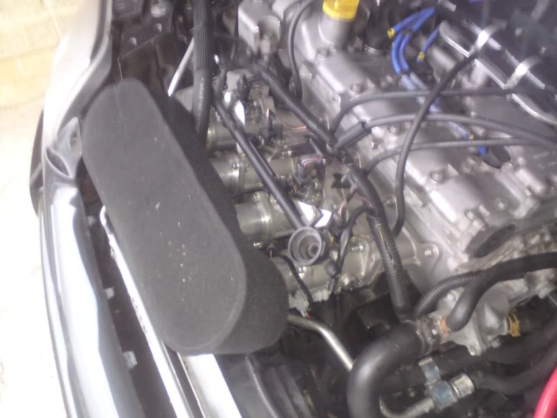

I need to work the filter a bit better, as it is still strangling power :
Paul is pretty happy with how the map is at the moment, next stage is to improve the throttle response, which is what the next stage will do, as well as hopfully netting a few more horses.

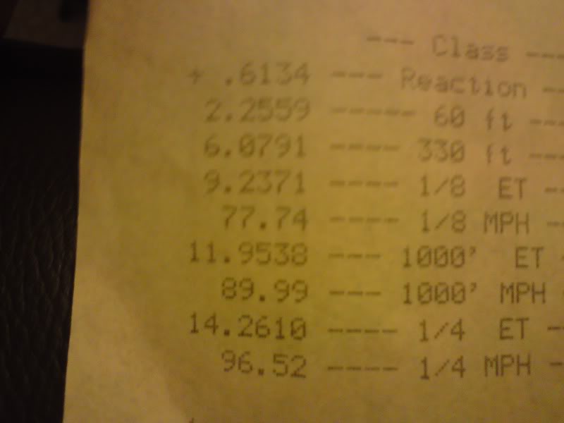

Best was 14.2 @ 96, as Dan has said full road trim, half a tank of fuel and spare wheel etc
Was happy with that, If I had more time im confident a 14.0 would have been acheaved, but it got too busy
