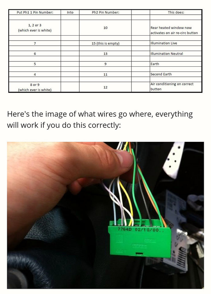

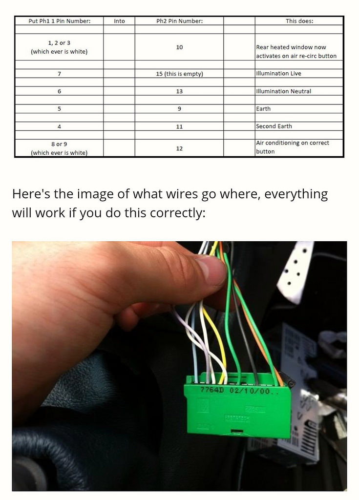

Heater controls don't light up when lights are on.
It's all wired as per guide in image here however I don't not do the wiring so I don't even know that white wires are the right ones-
View attachment 13756762018-07-17_12-01-21
Aircon button does nothing,doesnt light up, doesn't engage aircon pump. Relay and fuses are fine.
Recirculation button lights up and only then will aircon button light up if fan, speed is on speed 2 or above.. But aircon pump still won't engage ?
Is there a way to just ghetto wire a switch for the on /off of aircon? It's a black Ph1 and I'm sweating!!
Heather controls not lighting up can often be the bulbs in them. I had the same and was sure it was broken! Haha
Heater controls, 12v when the side lights is on goes to pin 12 on the green connector on the heater controls.
The A/C is control is a signal to the ECU which goes from pin 12. If it doesn't turn on then I suspect the A/C pressure switch isn't seeing the correct pressure to put the compressor on.
