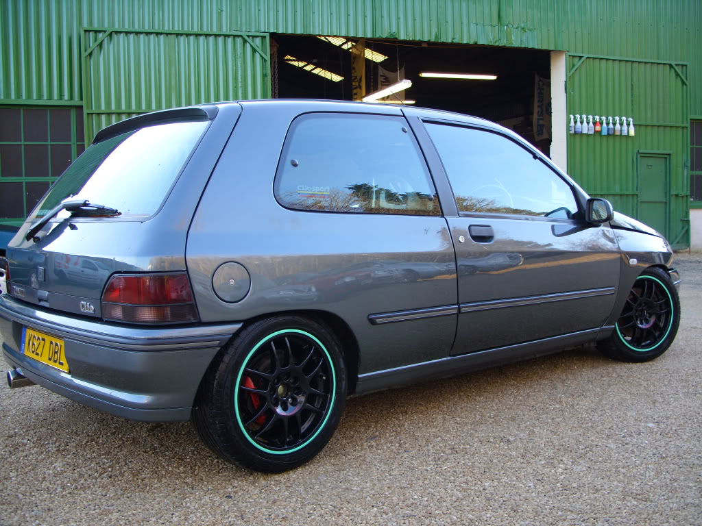

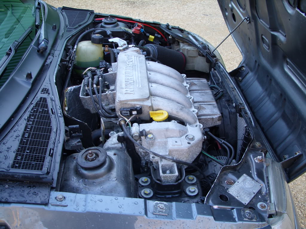

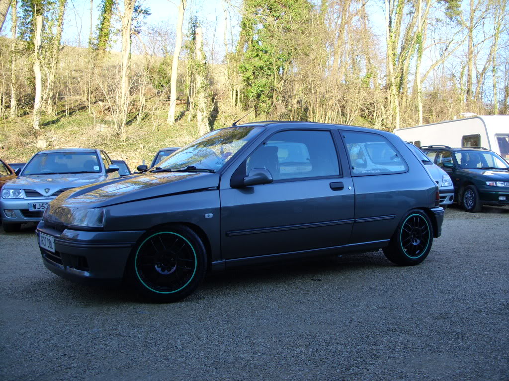

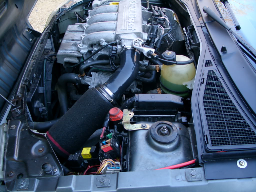

Here we are ladies and gents.
The product of lots of money/time/late nights/swearing/throwing various toys out of the pram.
1992 Clio 16v Shell.

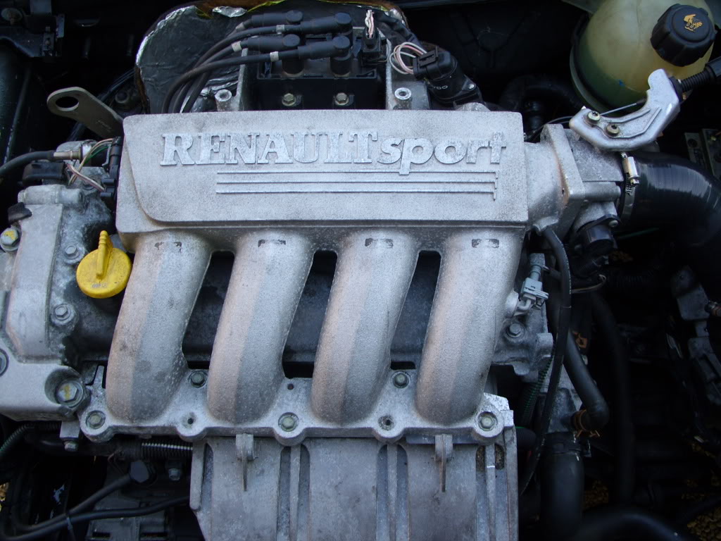

36,000 mile 172 doner car which donated the following...
Engine
Gearbox
Clutch
Driveshafts
Hubs
Bottom Arms
Brakes
Radiator
Manifold
15" Oz F1's
Williams Subframe and steering rack (Converted to manual)
Still a lot of work to do including:
Buy and fit new WilliamsCoilovers (so the driveshafts aren't bent in half!)

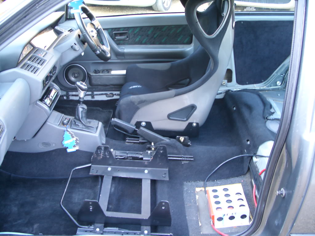

Buy and fit a passenger seat
Fit my Oil Cooler
Buy and fit some Harnesses
Fit my Cage (Possibly. Its a K-tec show cage and i'm undecided at the minute)

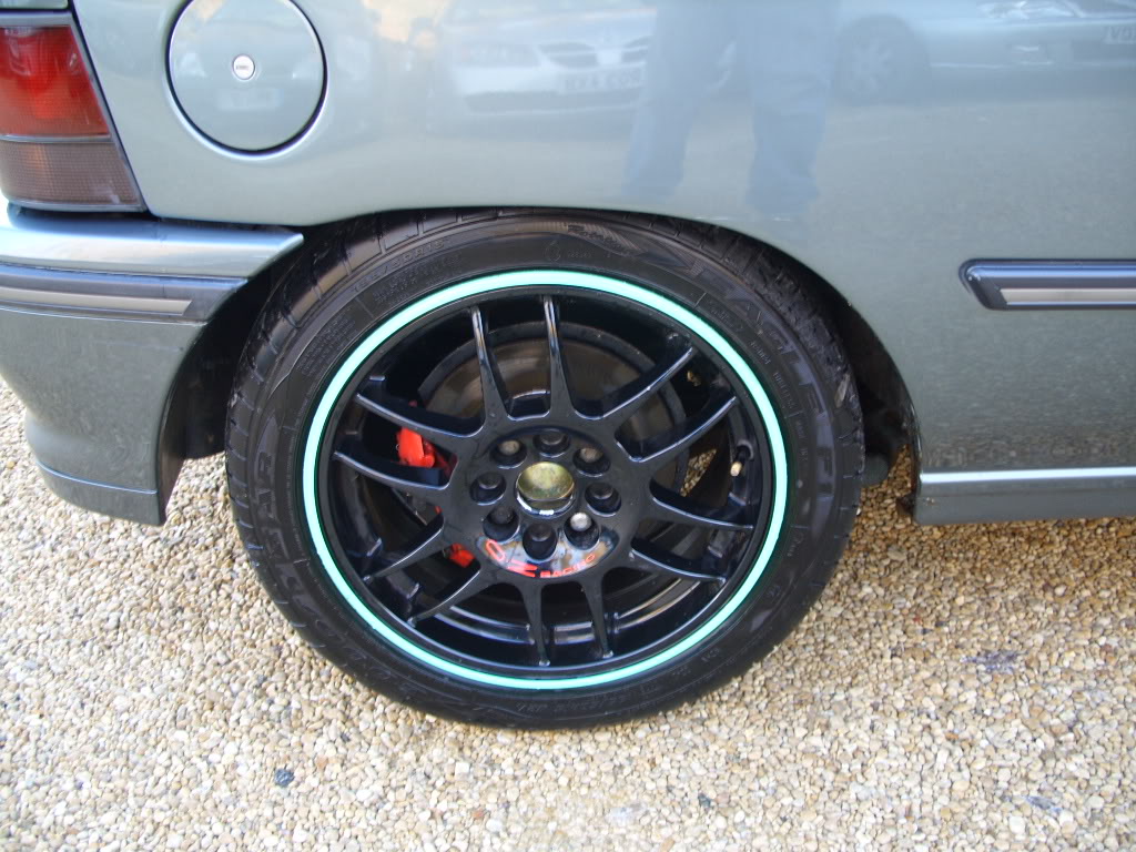

Fit my newly powder coated Silver Oz F1s and new T1r tyres (The wheels in the pics are going on my 172)
Anyway, pics....
(MASSIVE MASSIVE THANKS TO Whiteley AND f0xy, ABSOLUTE LEGENDS THE PAIR OF THEM! :D)

Got a lovely omp record 2 seat there if you're interested ;-)

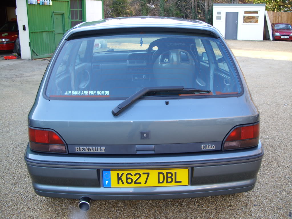

Also, i need that sticker in the back window for my rallye haha
no to the show cage, sell it to some muppet, save up and get a proper one....
phase 2 rear boot trim and lights
swap shell for my phase 1 or just sell to me
Get that carbon canistor pipe blocked off and sack the pipe you have connected to it off ;)
Looking good!
We did, but it idled at about 4000rpm?! :S
Shdany light on that dude?
I tapped a thread into the end of the metal fitment and screwed an M6 bolt in with sealant to fully seal it off...never had a prob after that! If there is a small leak it will usually do its high idle crap, make sure its fully sealed!
About time indeedy!
Have you got the rev counter working? What's it revving to? Beanie's old ECU Clinic'd ECU isn't it which we never determined what map it had on it!

nice filter, jords old one i take it lol

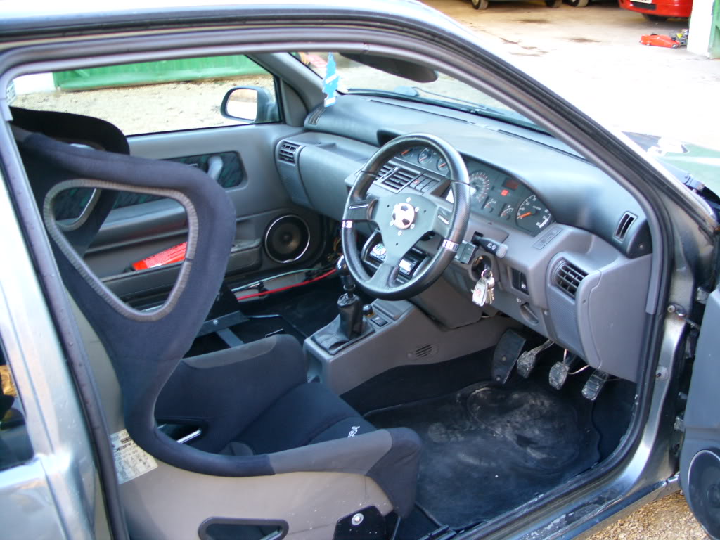

love that seat too, looks nice n' tight and deep ;)
Not got the Rev counter working yet. Its on the list of to-do's! Everywhere is covered in ice at the minute so not had a chance to give it beans and see whats what! lol.

Its got crappy knackered GAZ 16v shocks on at the minute. They are bottomed out and as such I have about -10 degrees of camber. This is making the nearside driveshaft clunk in the gearbox and so i've not driven it above 40mph.
No its the Air filter that came with the 16v car when I bought it. Its off a TVR! :D

It will eventually get completely stripped and painted in the original colour inside. Its a track car as tbh the combination of the deepest seat in the world, a very low car and a 13 stone fat bloke means its a bit of work getting in and out! Only been driving it 2 days and its getting on my tits lol.

Ah man that sucks, when's the new susp arriving???? Was gonna say I bet that seat is driving you crazy, looks very impractical!
Oh and whats with the green rims on the wheels? Wheel tape?
Haven't even ordered suspension yet. Need to sell some cars first. Bank balance has taken a beating this last month.
The wheels were painted gloss black, then the green lip, then laquered.
