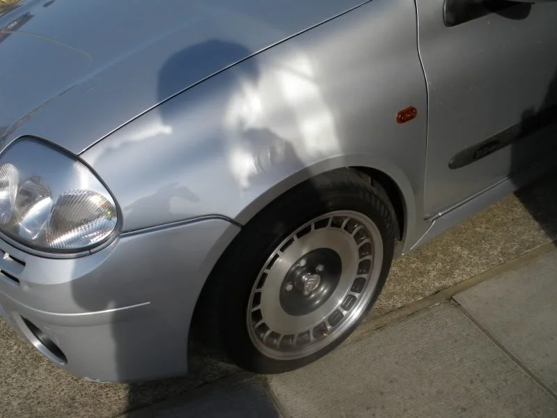

hi, bit of a noob in the world of cleaning cars :o but i've just bought a set of compomotive th mono's, their polished but not laquered so was thinking of polishing them up and then giveing them a layer of rim wax?
is this a bad idea on bare metal? their in really good condition atm but dont wanna ruin them.

are they not painted at all? bare metal? sounds strange. Polishing would be fine in this case obviously, but wouldn't do much. What metal are they?
they've got some paint in the centres and in the recesses around the spokes.
gonna get some autosol on them now their pretty dirty in the pic.
Just use a bit of metal polish to keep them clean every now and then. You could try some form of sealant on them (poorboys wheel sealant is good), but not sure how well it will work compared on top of paint. so long as you wash them regularily they'll be fine.
