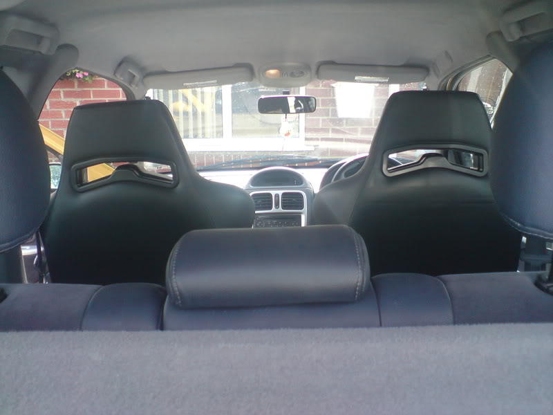

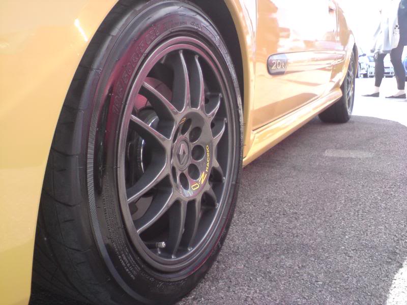

well not updated this in a while. main things to go in just before FCS were the seats and finally fitted my spacers which make a massive difference. was fairly happy with the way the car looked at FCS:
but as with everything i wasnt satisfied so decided to remove the rear seats, so from this:

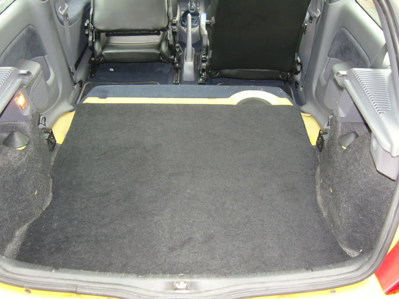

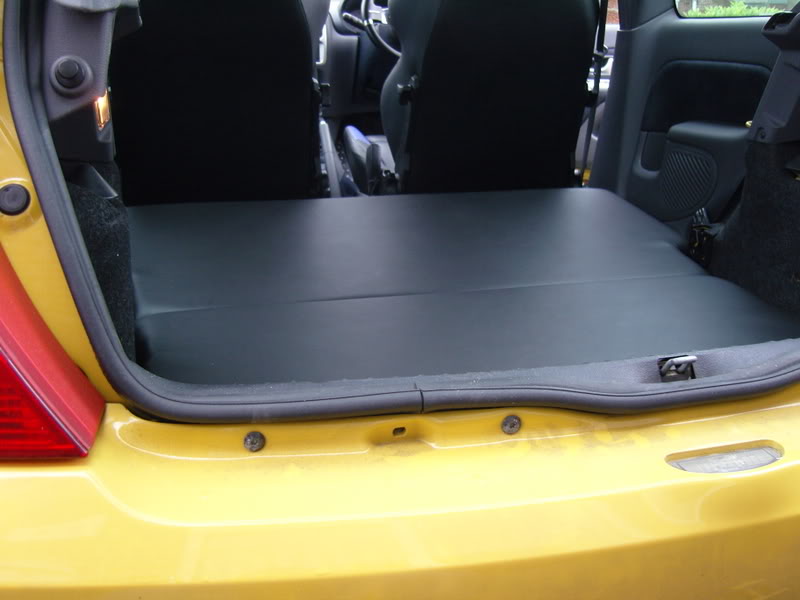

to this, with a convenient piece of carpet dropped in so the dog didn't hurt himself on any of the sharp edges. so decided to clad it to match the konig's

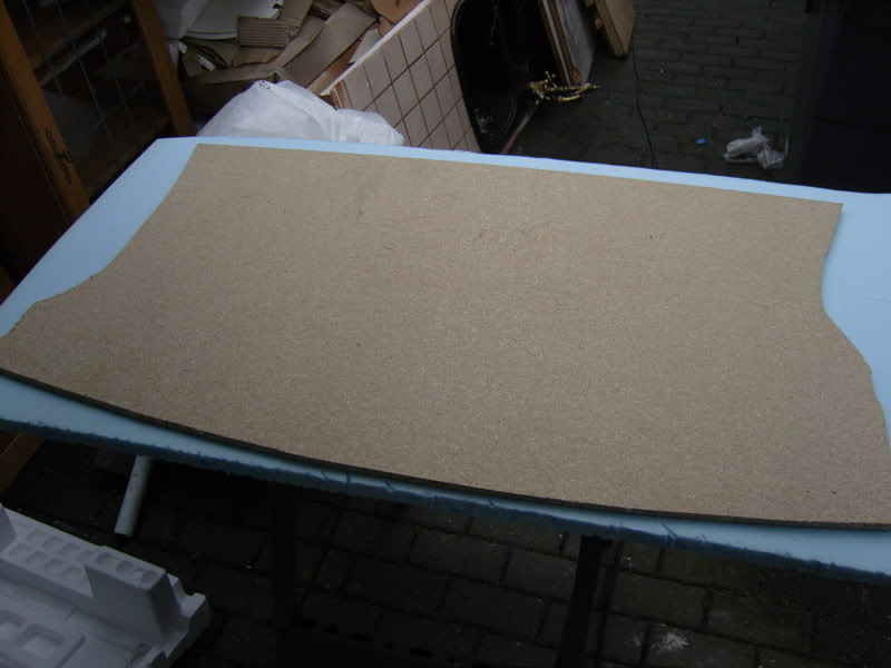

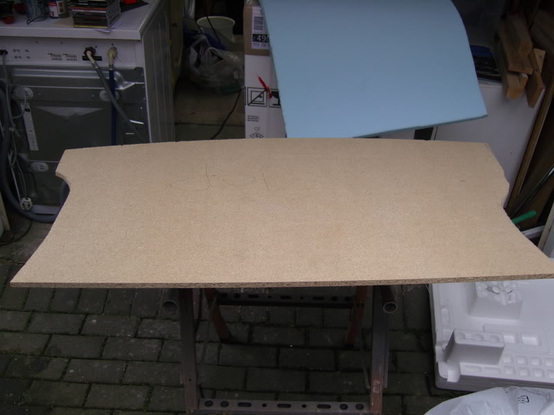

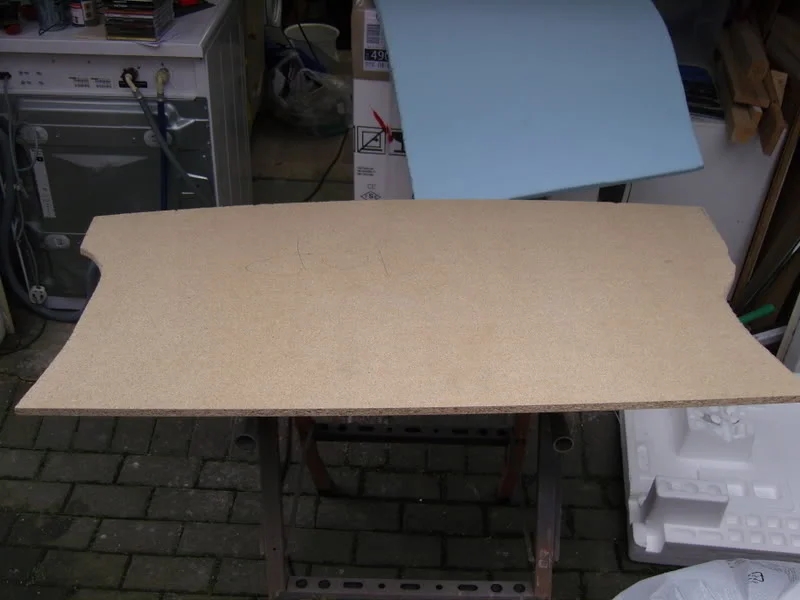

made a rough template of the boot and decided to get cracking. cut it out with the jigsaw leaving me this. then sanded and planed the edges to get them a bit smoother.

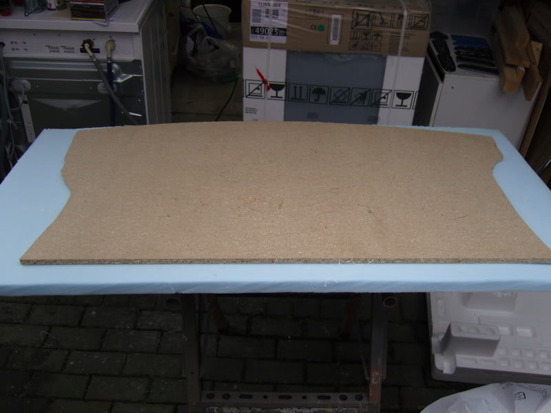

then used some rather funky smelling spray glue to attach some 1'' thick foam.
which left me with this little mess.

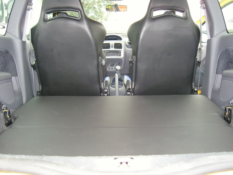

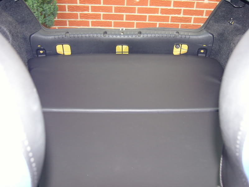

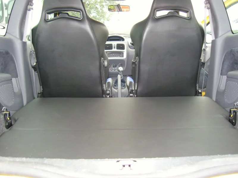

then cut the excess away with a carving knife and threw some synthetic leather over the top. i'm no upholsterer so you will have to forgive my rather poor attempt :dapprove:

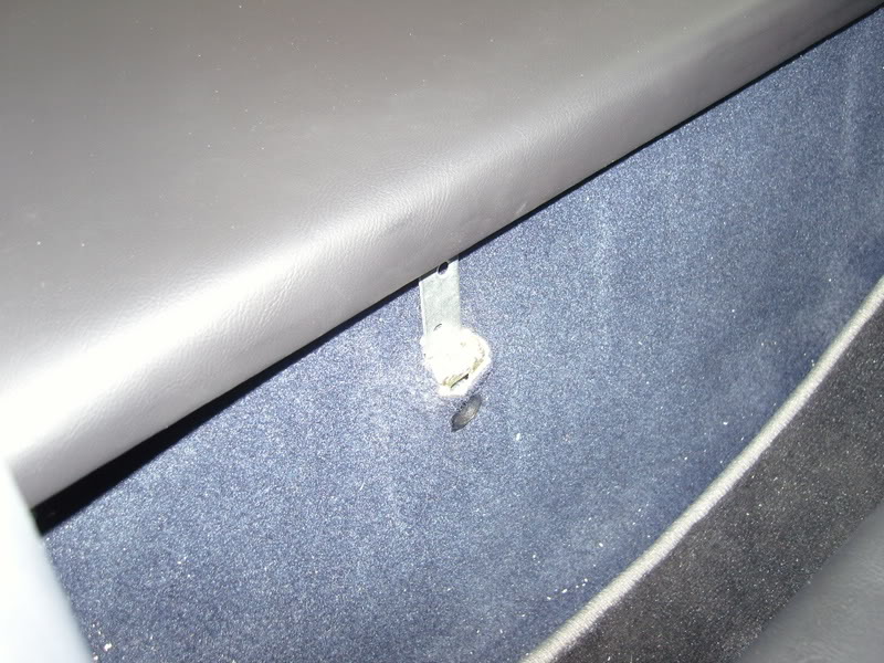

the boot section is unable to move due to its shape, whereas i thought the front piece under hard braking may slide forward. so used some L brackets tucked into the original holes, and screwed to the underside. not sure how long this solution will last, as i personally think its a bit pikey but nevermind lol
all in all i'm rather pleased tbh. next week when i get back from my holidays got to go to birchdown auto services to collect and fit the bargain k-tec show cage i got off the ebay which will hopefully tie it all together a bit more and make it look less like a van.

That looks ace Mark, Do you have any pics of how you fit it down to the floor?
how do you mean fit it to the floor? back (boot) section is just dropped in. front (seat) section has two L brackets screwed to the bottom of it, which locate into the original holes in the rear passenger footwells.

top marques on the rear flooring though, looks good :D has the foam helped keep the road/exhaust noise down as well? i know when i had my back seats out the exhaust made a right racket lol
  Chocolate Bar™
noise from the yozza was fairly mental when it was stripped. its not as good as when the seats were in, but better in a way as instead of being a drone you can actually hear it popping and banging.
