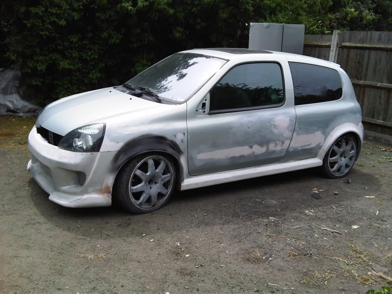

So The car arrived back at mine approx 1 week ago.
We got it back to mine and took the fence down on my garden and lobbed it in the garden and began the long and arduous task of repairing and finishing the car.
took all the parts out of the car and put them in their temporary home inside the house :)
Began fitting the interior again. Don't let anyone tell u this conversion is easy. If it's not the fact the seatbelts don't fit it's the courtesy light unit not working or the new Air con/Fan unit housing not having a whole in the bulkhead. Don't get me wrong 99% is plug and pray but the other 1% is make it fit or do without.

Parkside Garages, Walker. Work is done by a guy who works out of there but isn't part of Parkside don't get me wrong he has done a hell of a lot for the money I paid him £1250. But it's taken 18months. 17month's longer than he said it would take and has cost me a gearbox.
