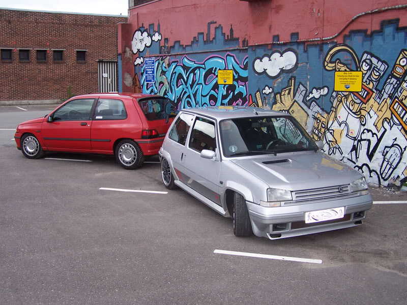

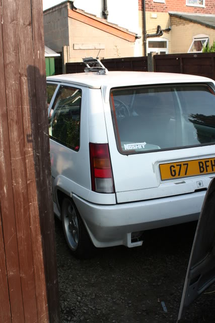

Guess whos back home :).... The 5 finally got some time today lol

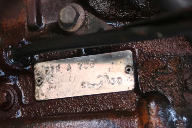

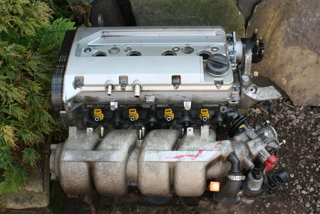

Cleaned and stripped the engine some more.. so its closer to being painted

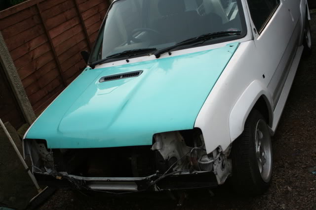

New fibreglass Bonnet trail fitted

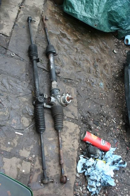

Today i have battled the weather to get the gearbox and subframe off and get the bits to one side i need for the widetrack and throw away the rest lol

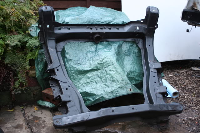

Subframe.. semi clean and rust free :D

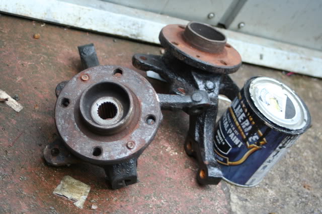

Front Williams hubs with good bearings... they need some more hammerite since they lived on the 5.

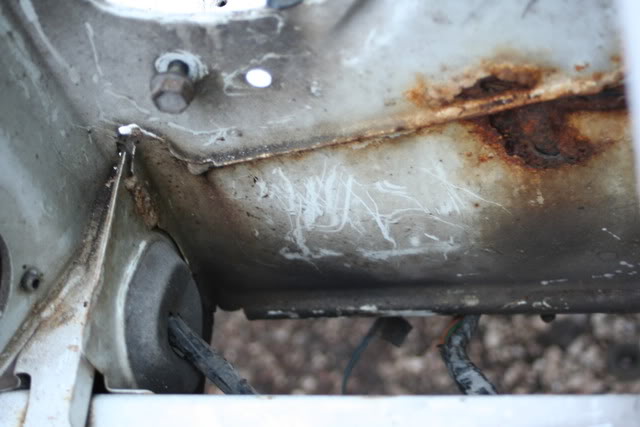

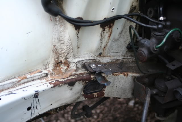

The bay has some rust that needs attending too

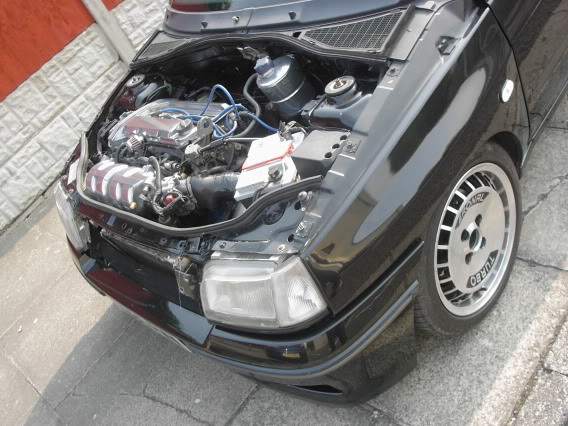

The new bonnets to try and offest some of the weight of the F7R and the vent is functional... i won't be badboying it...

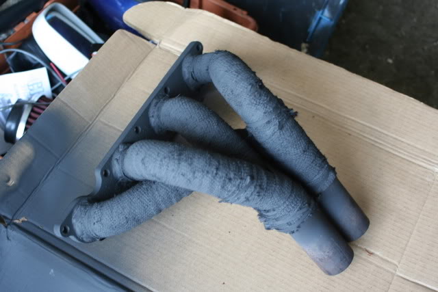

First coat of high temperature paint on the manifold

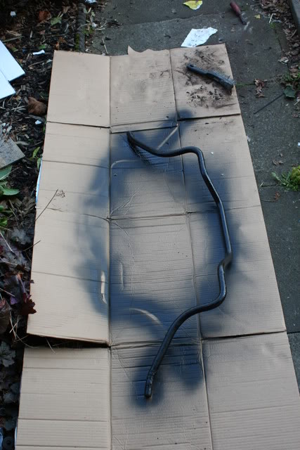

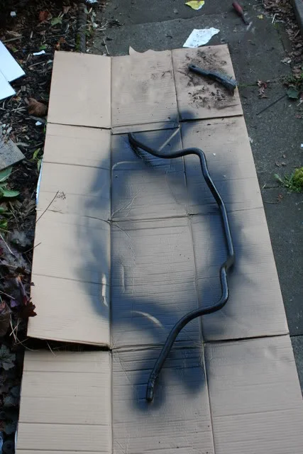

Anti roll bar semi de-rusted & painted

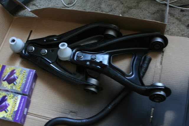

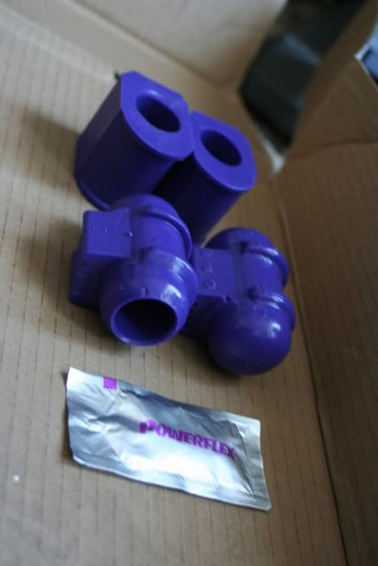

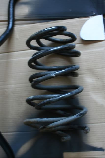

The anti roll bar bushes turned up from ktec, I picked up a pair of 19 16v wishbones from GSF and a pair of 16V/Williams springs from a mate. So I have all the parts to build the subframe back up and refit on sunday :)

One of my ex mates had a valver bonnet vent on his 5gtt years ago, tbh i've not seen many 5gtt's running them, I know you said it's functional, I guess you also need the vent as it clears the engine ?
cheers folks... yeah think the bonnet will help with clearance... It looks abit mad badboy'd... maybe its the picture angle

The Wishbones
The ARB bushes
Springs

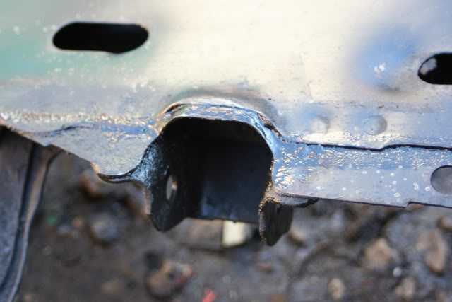

The first problem i ran into was the 19 16v wishbones fouled on the subframe so some trimming was in order with the angle grinder and a file... Im now going to give the subframe a lick of paint

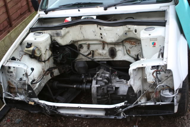

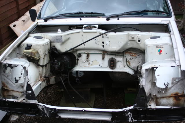

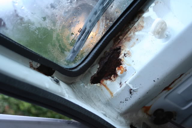

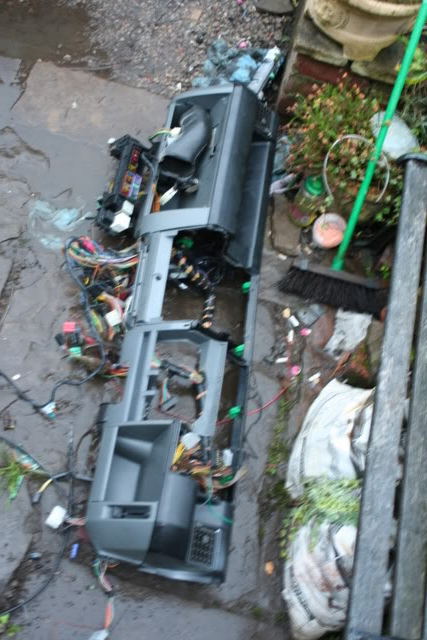

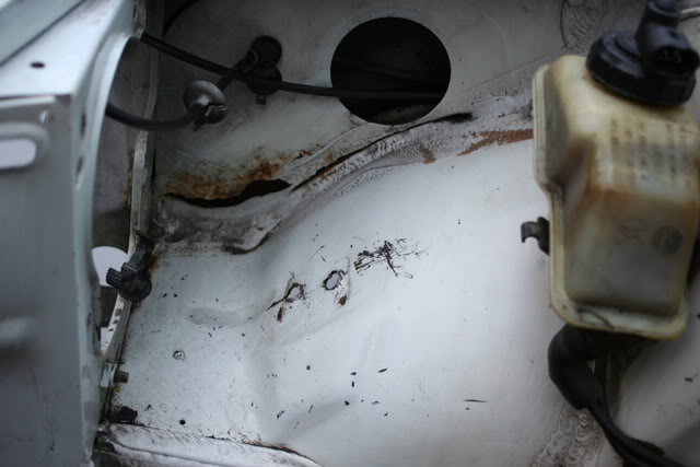

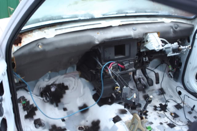

Before my evening meal this evening... I thought i would get the dash and loom out the 5, only part thats been a pain to remove so far (i should have busted out the haynes lol, but its out)

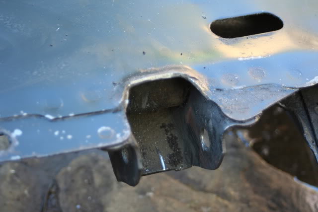

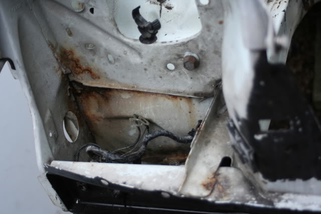

I found a hole :(
The badboy would not really suit the cars new image... so won't be missed

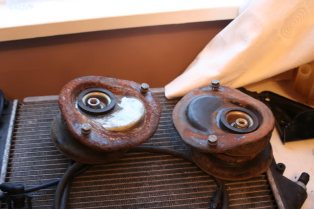

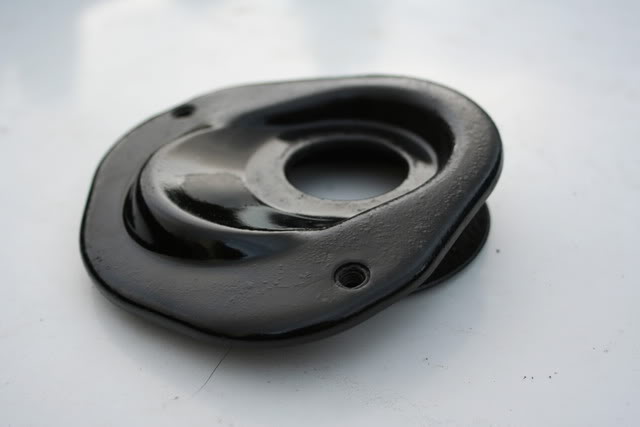

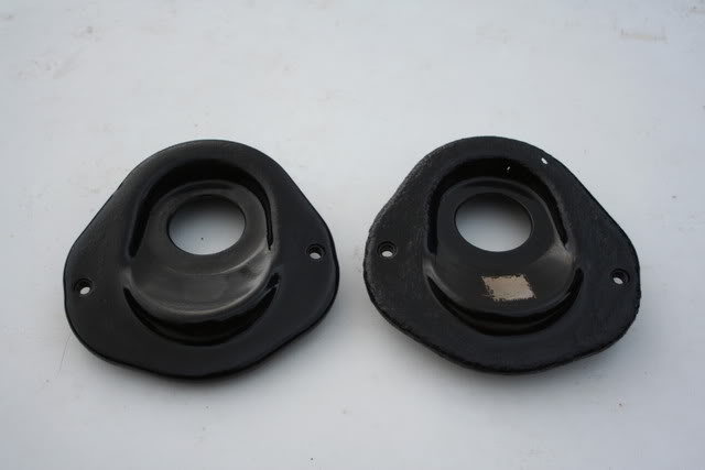

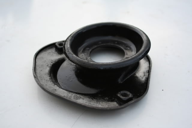

Ive not done much at all really since the last update... I have de-rusted, repaired and painted the Top monuts, as there no longer available from Renault, I needed to make sure they will last,,, Im just waiting on getting fresh bearings then the struts can be built up
I got carried away and got stuck in... so ive only got finished pics

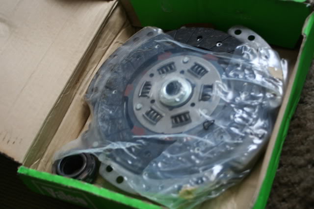

Also a few new part pics, not many parts left to get now :)
Uprated R5 GTT / Williams clutch

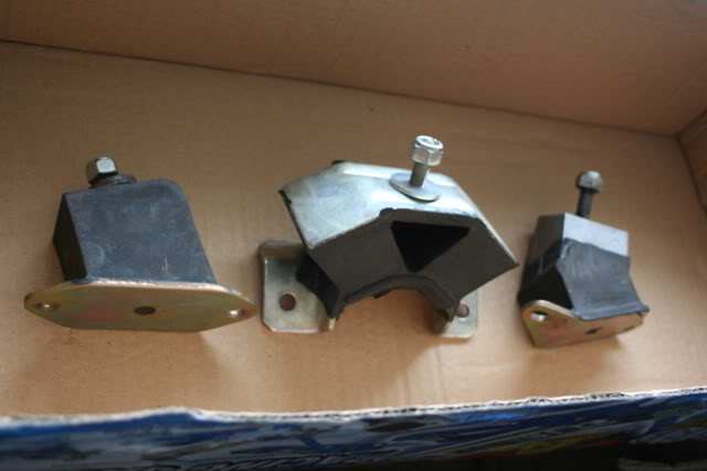

Uprated 5 GTT engine mounts
