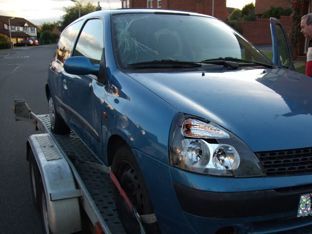

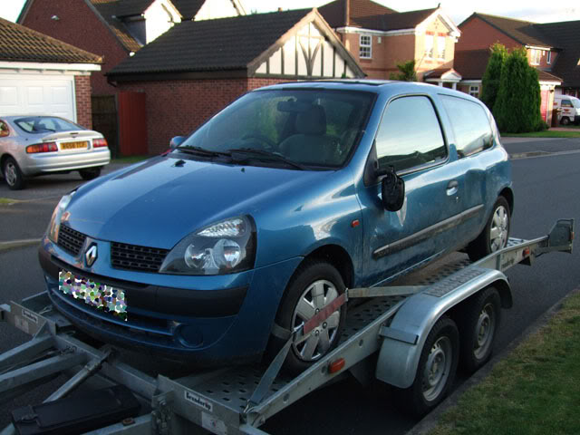

Got hold of this bargin; 1.2 16V 2001. Lightly rolled but more or less absolutely ok. Was going to use this as a base and put a new roof on it plus 172 suspension and gubbins.
Went to Manchester to buy a 172 rear beam off Winston to put on it but ended up going back a few days later to pick up the whole remains of the 172. Took 2 hours to move it 10 yards and onto a trailer but got there in the end :)

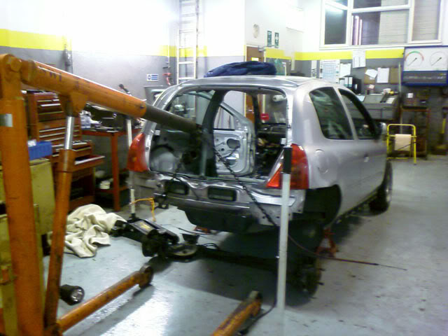

Got the shell off the trailer and put the rear beam back on with a couple of nuts, no dampers and some broken springs from the skip just as a stop gap to get it back on its wheels.
Back on its wheels and check out that wheel arch clearance ;)

how come you got the mk1 for 200 quid? is it a cat b?
Its unrecorded believe it or not!! Lady I got it off just wanted a quick sale, her son had rolled it after 3 days of driving. Its done 120k miles and is tatty inside too. Still the bargin of a lifetime though. Its almost a shame to take it to bits, could of had some profit out of it, but more fun doing this.

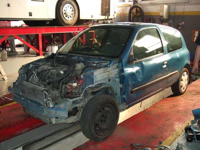

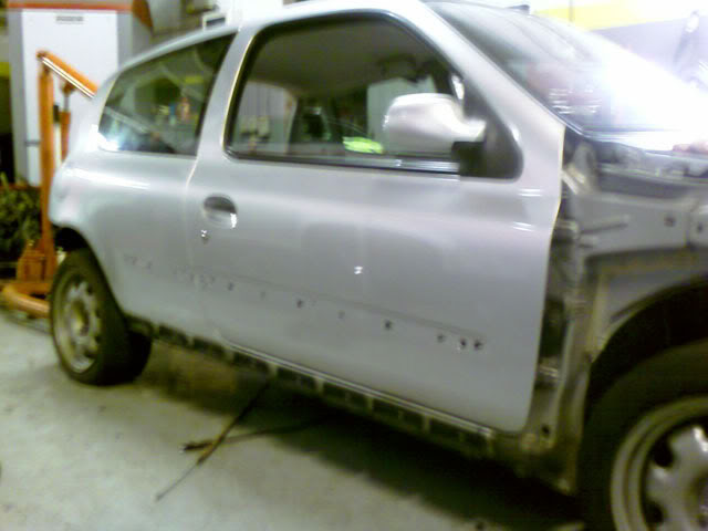

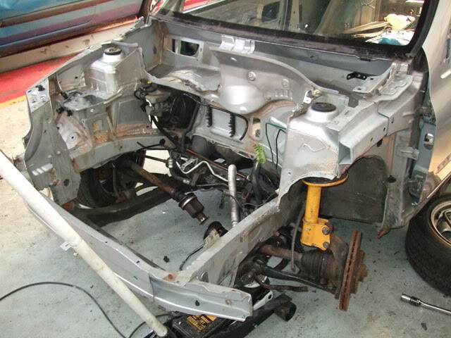

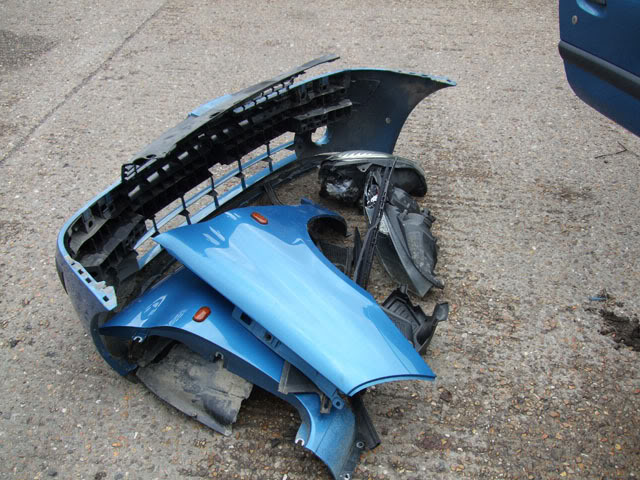

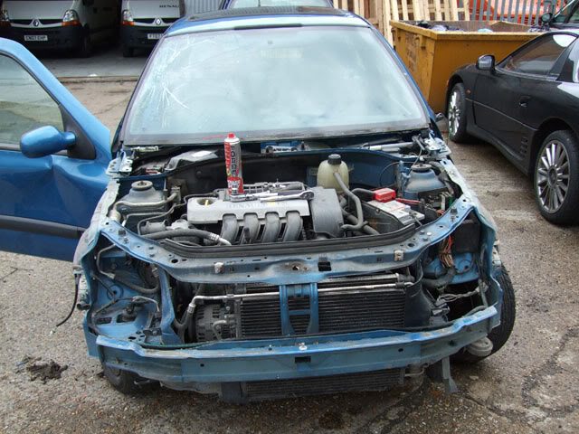

Bit more stripping out done....
Everything taken off to get at the front wings odd and expose inner wings etc
Leaving...

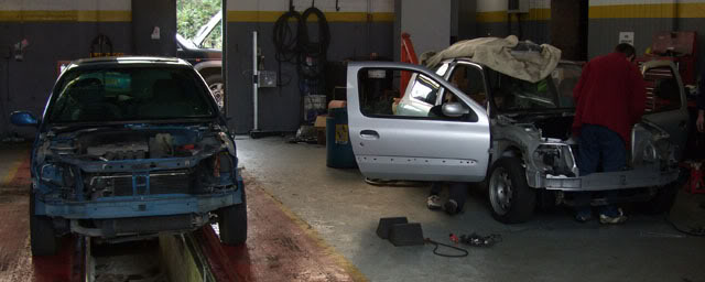

2 cars side by side, ready for their operations

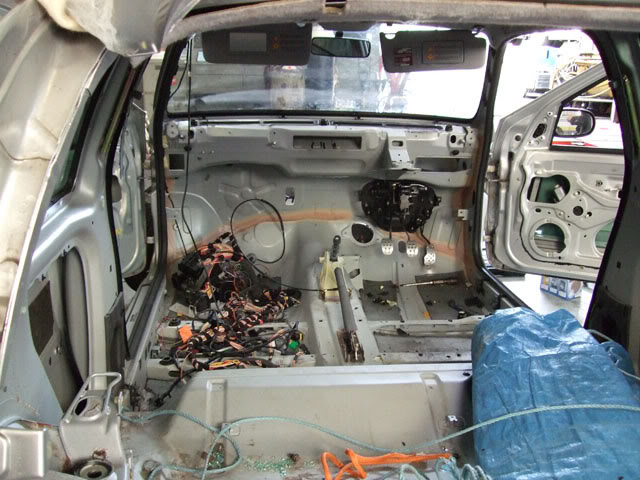

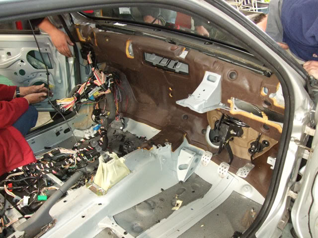

Stripping out the remains of the interior
Dash supports, heater box and bulkhead lining out

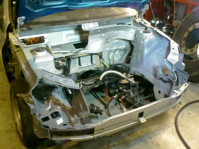

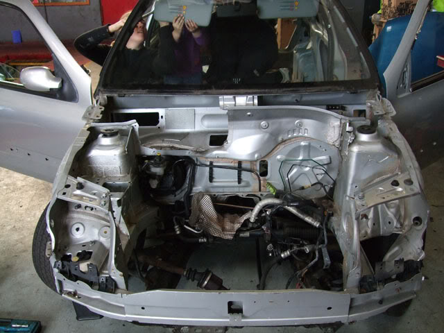

Just about bare engine bay, aircon stuff out of scuttle, ABS block out
Thats all the easy stuff done, the interesting bits will get going soon ;)

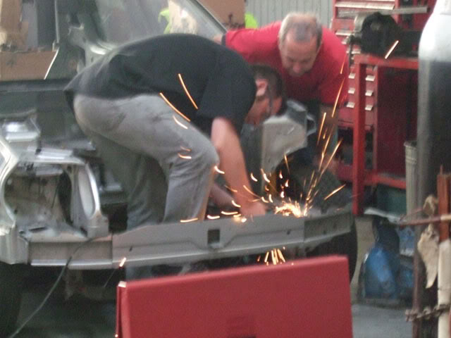

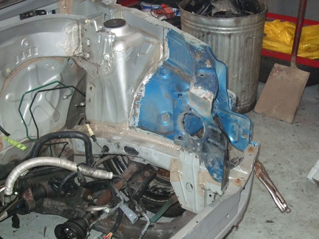

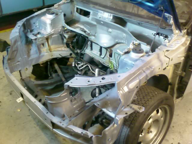

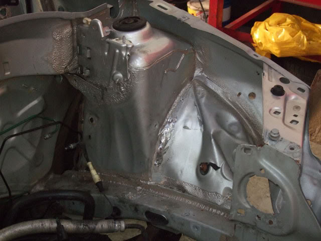

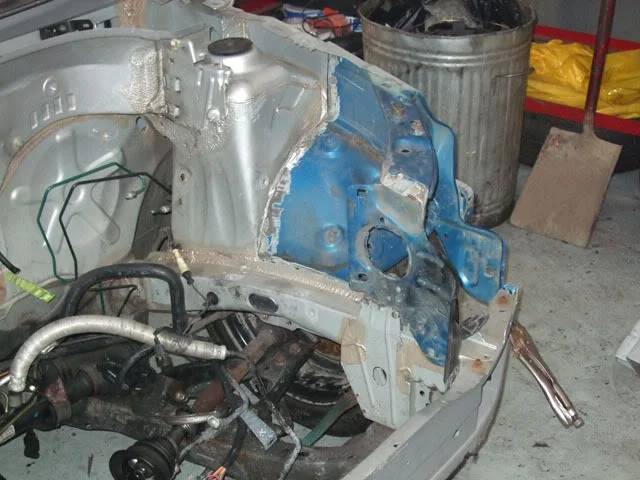

Nearside inner wing area, bit of damage here. Techincally there isnt alot here that couldn't just be pushed out and covered up... but where would be the fun in that? So seam along turret cleaned up and spot welds drilled.
So, spot welds drilled out, and a bit of work with lump hammer and chisel; then a fine application of hacksaw (and a nice grind to tidy up) got the following result

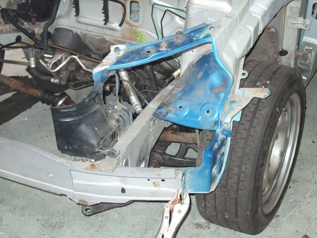

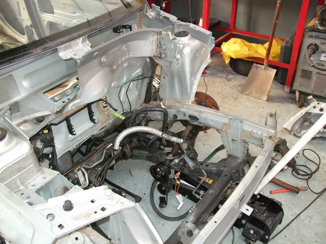

Now where could we get an undamaged inner wing from? No need to be quite so subtle this time...
Again with some spot welds drilled out the and seams chiselled apart, other less needed parts taken off with the grinder and we got...
A bit more tidying up to do, and its not bad fun either ;)
Ready to just tack in place, before making sure everything is lined up properly for the full seam weld.
So; next job is to do the same on the other side. Will cut it off a bit further forward though to avoid the hassle of messing around with the top engine mount.

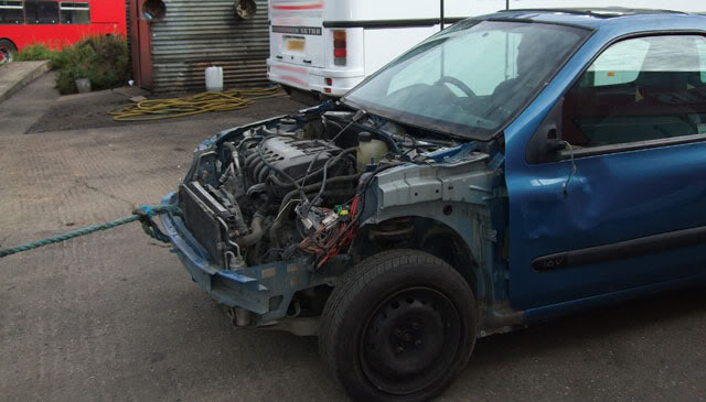

Only trouble we had today was putting the cars away at the end; must have wired something went wrong as got a bang when went to start it and must have blown a fuse. Towropes and pushing awaits!!

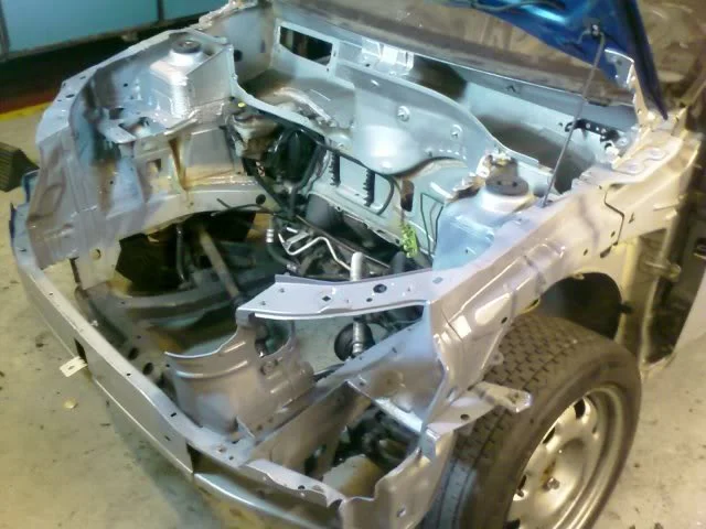

In the meantime, just welded new inner wings on, sealed the seams and given a coat of primer.
