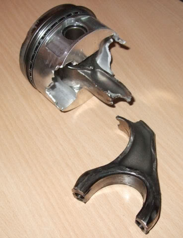

Probably oil surge caused bearing seizure; broke the rod, chewed the piston and liner up, put a hole low down in the block and bent a couple of valves.

Has the bearing failed/spun?
Kinda looks like it hasnt looking at the remainder of the rod!
Im guessing failed rod bolt also..
Though these engines arent anywhere near as prone to oil surge issues as the Mi16 with std sumps, incorrect running clearances will soon spin shells.

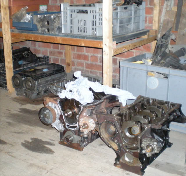

Got a couple of spare blocks off ebay, plus a crank and sump.
Pic of some of our spares

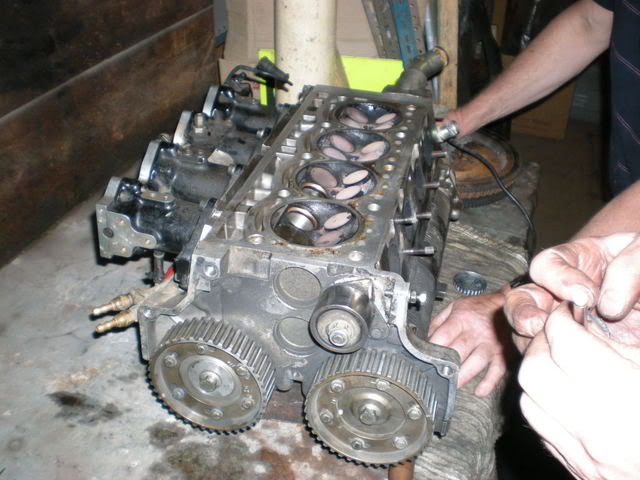

Lapped 2 new valves in, got to put it all back together now and see if they seal ok.
We have any entry for the Abingdon CAR-nival stages on the 13th-14th June, so really need to get the car sorted before then!

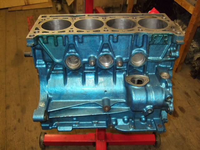

We have the remains of a few Sodemo engines kicking around, originally from a Continental Megane touring car so are going to rebuild the engine using some of those bits for the bottom end with the original head.

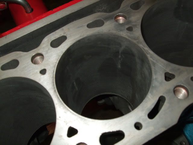

The best block had a bit of damage right at the top of one of the bores, it looks like the engine had dropped a valve and chewed up a piston scoring the cylinder wall in the process. The block was sent away to a local engine builder who bored out the damage and put in a sleeve. He also honed everything up nicely. Nice neat fix as seen below.

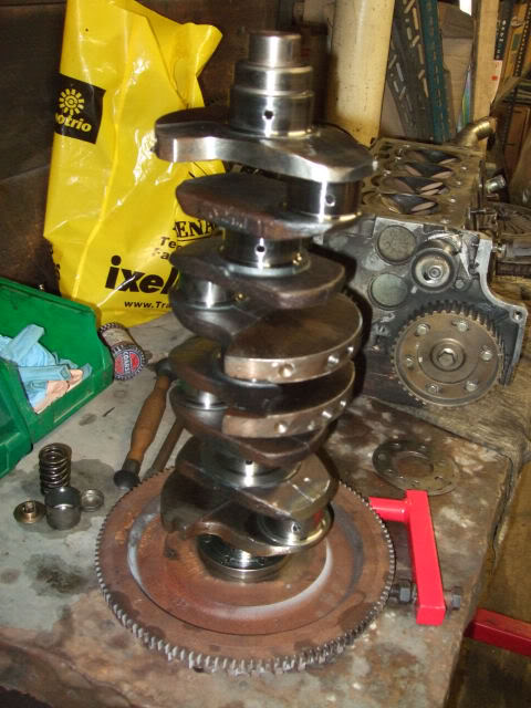

At the same time we sent the crank and flywheel to the same place to be balanced.
Ready for assembly now!

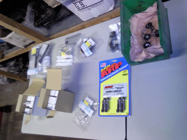

Some of the new bits needed for the re-build; new shells, bolts etc.

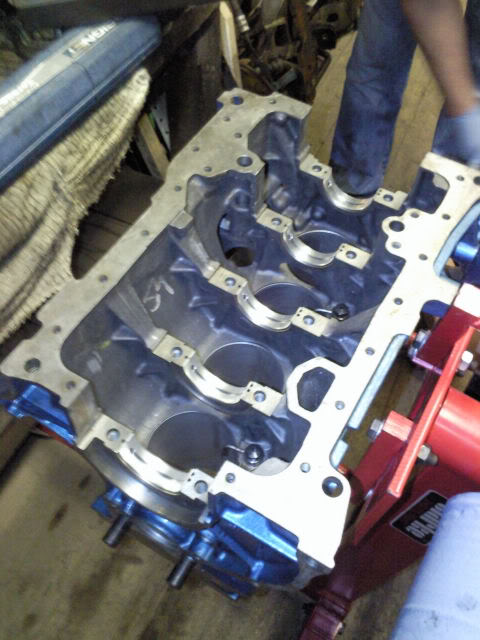

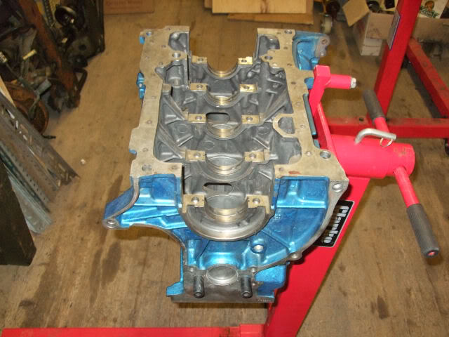

Main bearing shells going in.

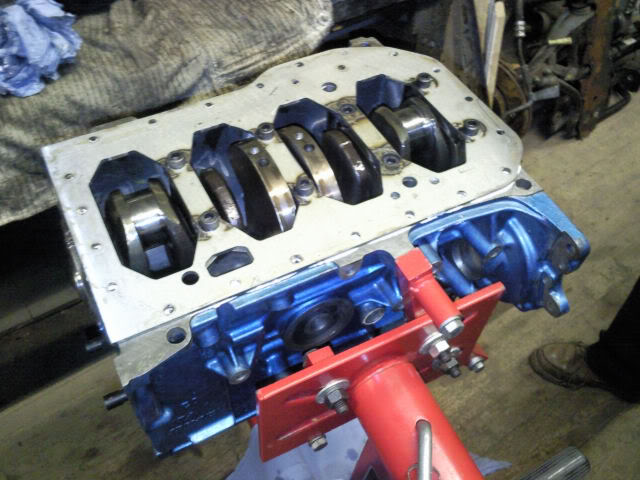

The balanced crank in, with main caps torqued up and reinforcement plate attached.

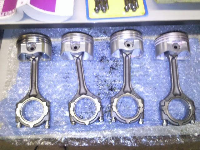

These are the Cosworth pistons and rods that will be being put in. Just need new rings in and that will be it.
