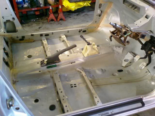

It's a bit hard to know where to start now the car is back, but really the first thing to do is get the shell prepped as much as possible, get everything that needs to be welded welded and primed.
Here are the pics from today, took the rear beam off to get it cleaned and painted, and the subframe off so it can be welded, strengthened and painted.

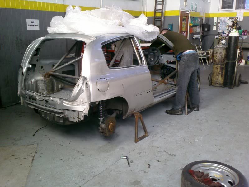

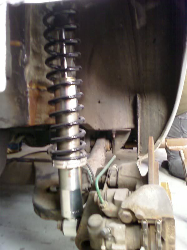

With the wheels off and on sill stands

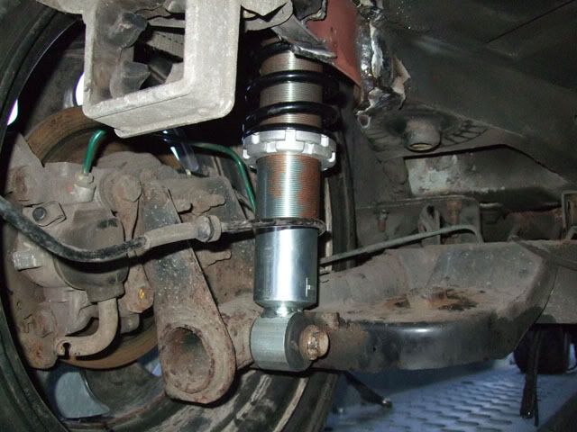

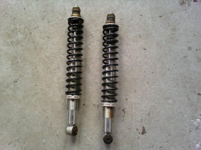

Photo of the rear coilover on the car before the rear beam came off

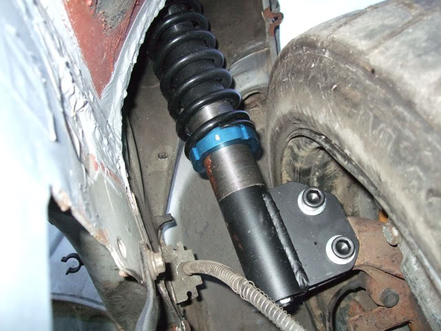

And off the car

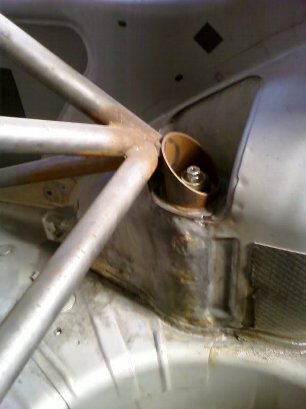

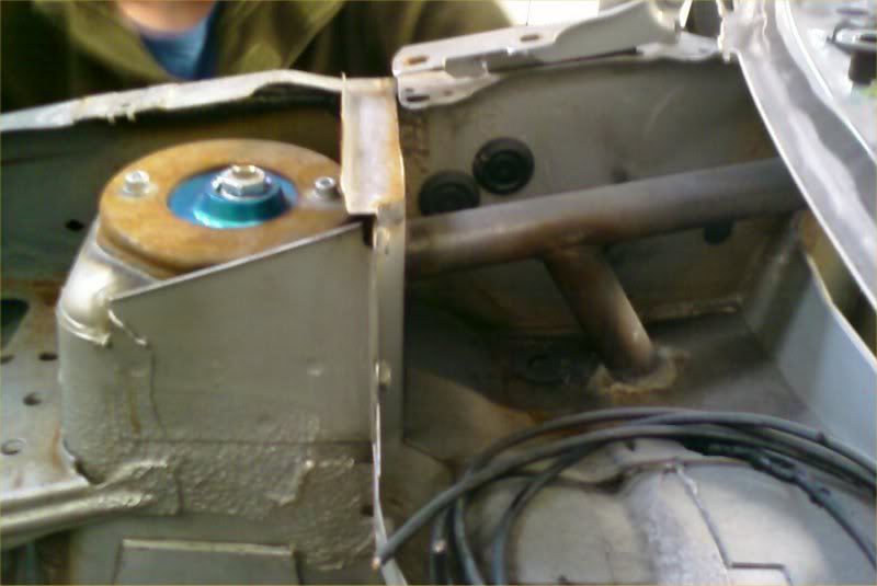

Here is the top of the turret at the back on the inside, showing where the turret has been modified to fit the width of the coilover, and where the rollcage ties into the turret

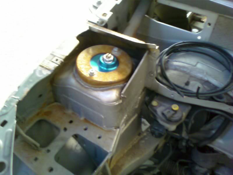

This is the top of the front strut, which has been modified to fit a flat plate for the top of the coilover and triangulated into the rollcage

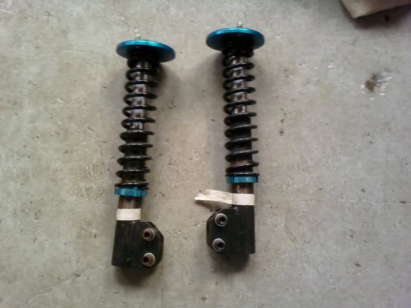

The front coilovers off the car

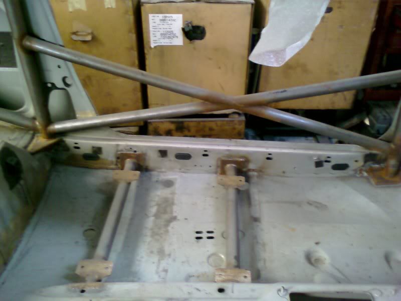

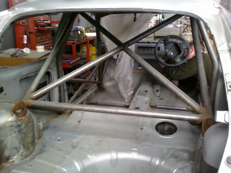

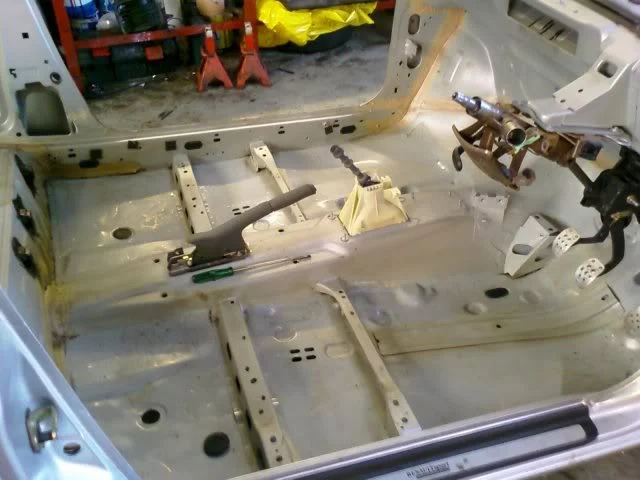

Last couple of pics showing a bit of the rollcage, and the seat mounts
