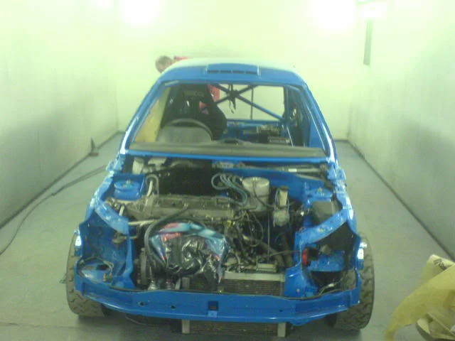

These pics arrived on my phone yesterday; many thanks to Peter

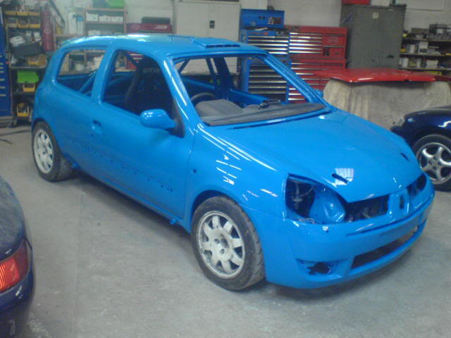

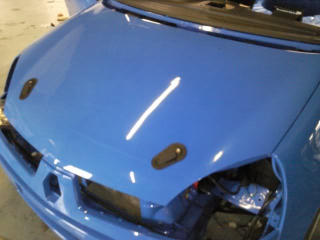

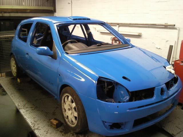

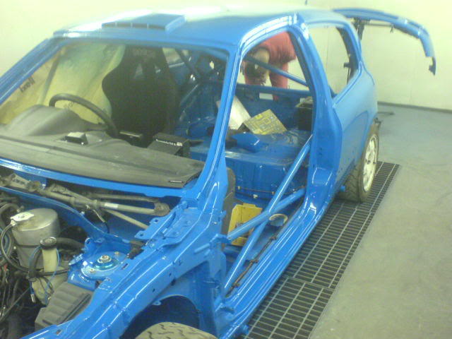

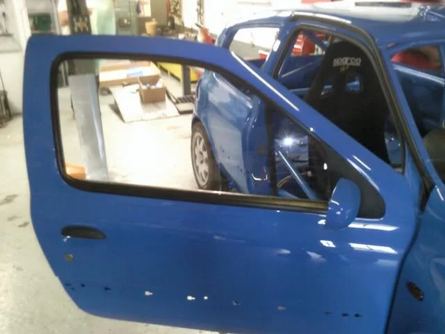

Now the car is back from the paintshop we had to put back on everything we had taken off before sending it.

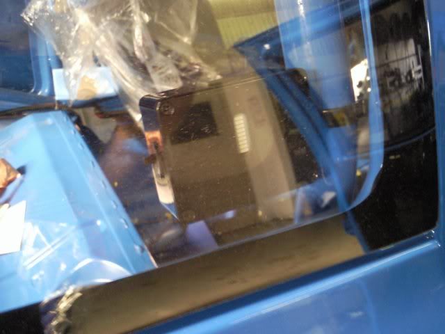

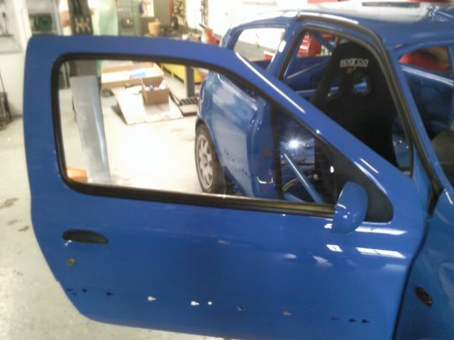

Door catches, locks, door seals and trims all went on with no problems. Put in the plastic door windows we've had for a while now into the original rubbers and held them in place at the bottom. The plastic windows look really nice, and the doors are really light too.

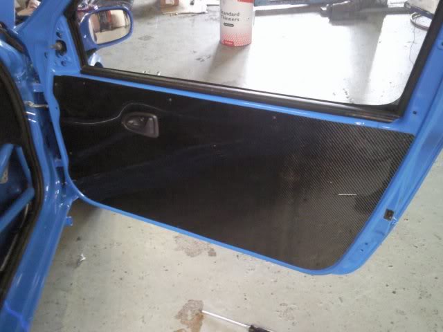

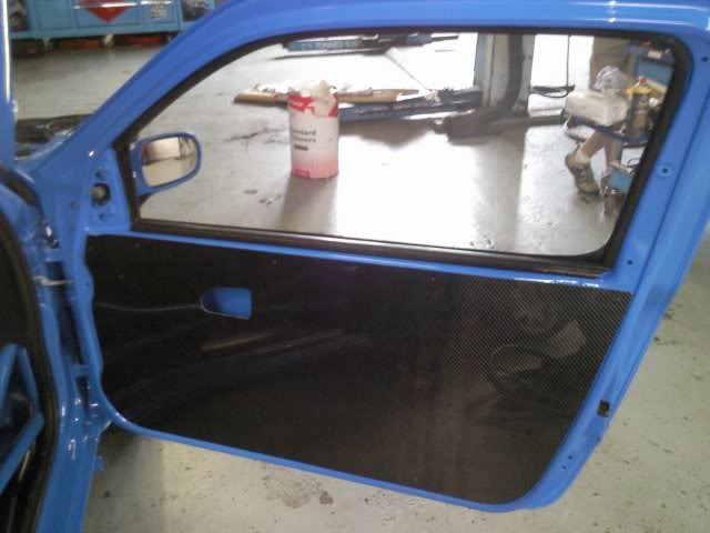

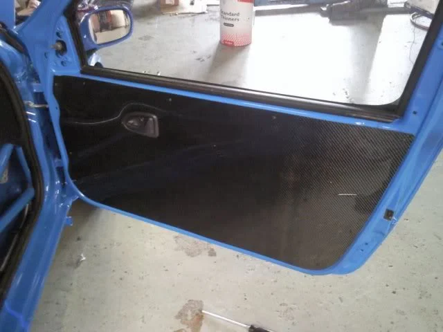

The door cards we got from performancetrim went on with self tappers easily enough.

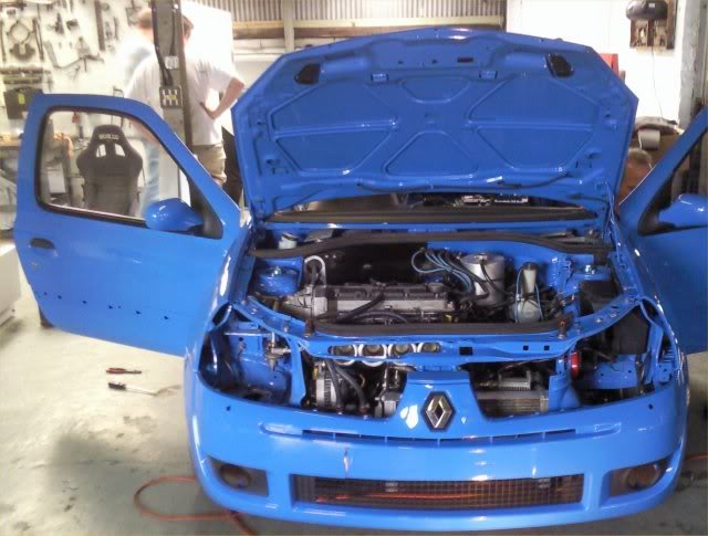

Slotted the bumper foglight trims and lower grill on too; just waiting for an upper grill and new headlights to complete the front end.

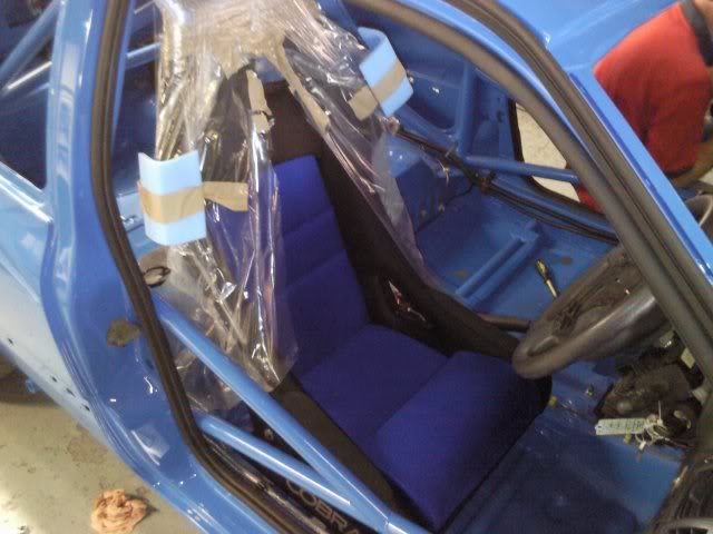

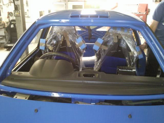

Test fitted the 2 new Cobra seats. They are going to need some plates making to get them into the right place on the seat bars.

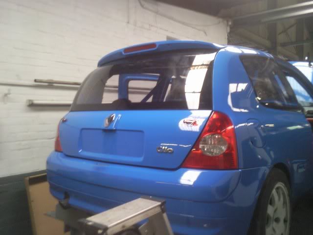

Cobra seats and Willians harnesses have been fitted; and the rear quarter, tailgate plastics and windscreen have been bonded in now. Also got the new cup spoiler all finally fitted.

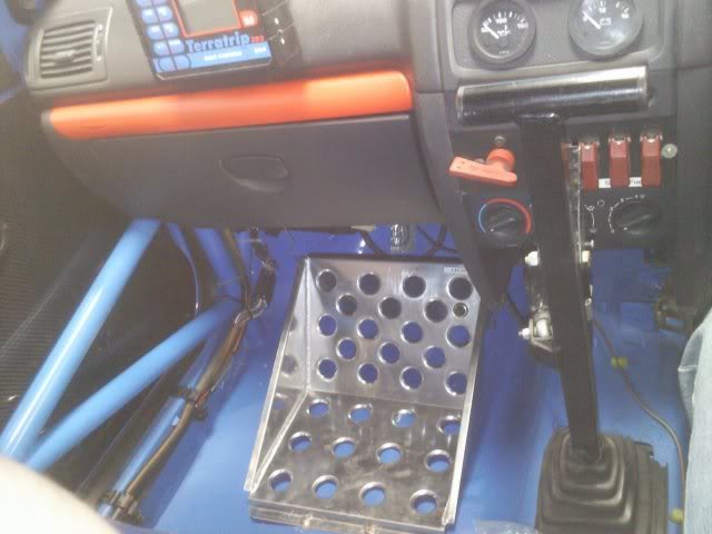

Bolted the navigators footrest to the floor, and wired in a foot mounted button for the horn.

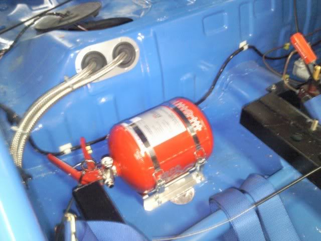

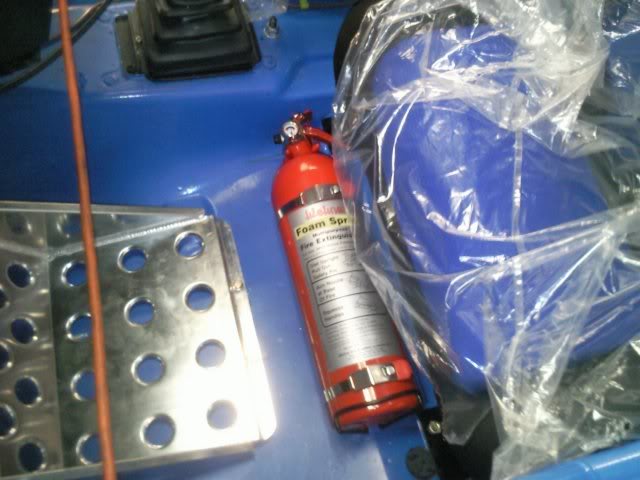

Also just infront of the passenger seat the handheld extinguisher was fitted.

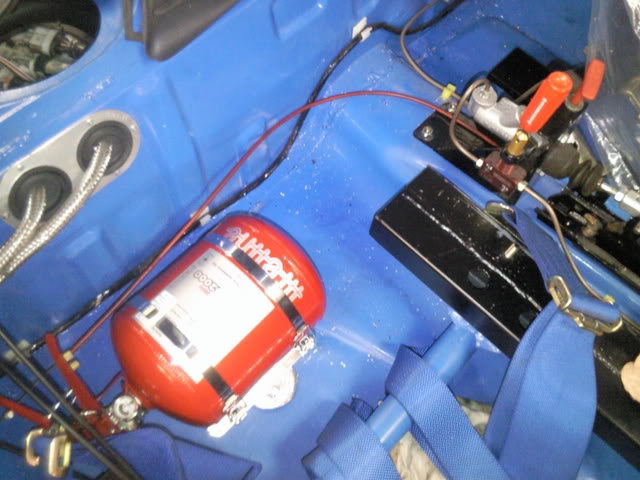

Begind the drivers seat is where the plumbed in extinguisher has gone. This just needs plumbing through to the engine bay and the nozzles fitting.

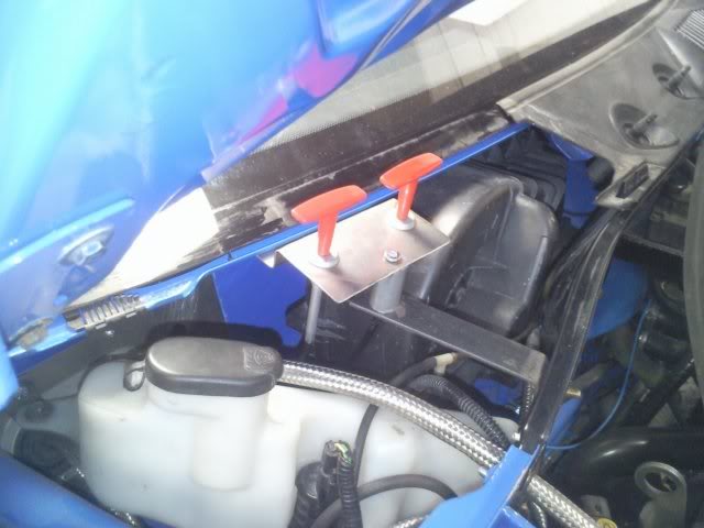

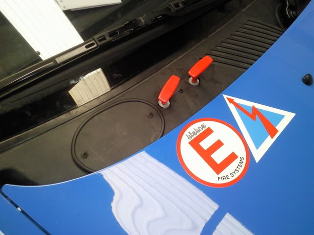

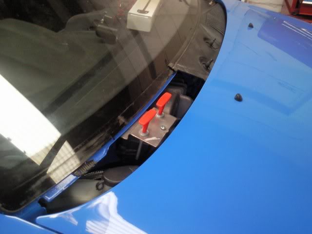

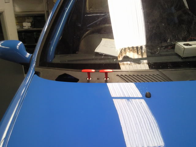

To go with the extinguisher and and battery cutoff there are controls outside to activate them. Just made a bracket to hold the handles in the scuttle.

Is the co-drivers foot rest custom made or can u get them off the shelf?
Good price that too. looks very well made.

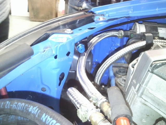

Finished plumbing in the extingusher, two nozzles in put in the engine bay with the pipes running down the O/S inside the car to the extinguisher behind the drivers seat.

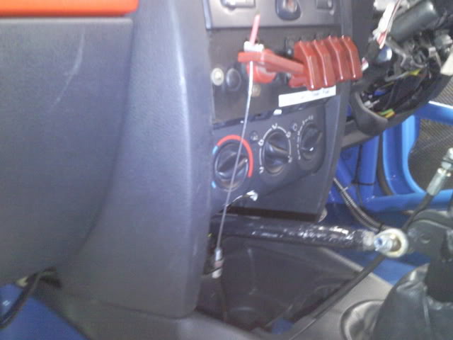

The extinguisher can be activated from the outside or by a pull cord on the inside behind the handbrake.

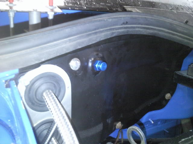

Also ran the cable through for the external battery cut off switch, going to the master switch on the center console.

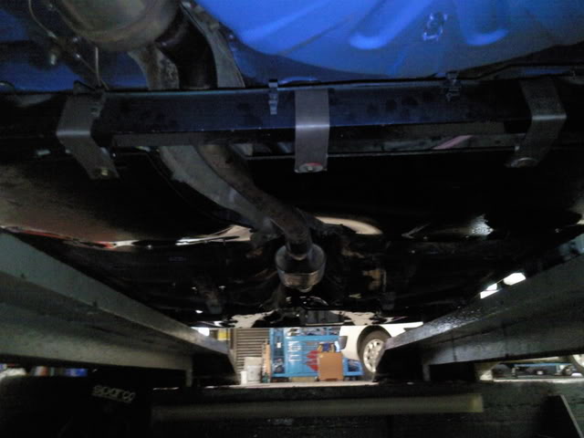

Fixed some underbody protection for the fuel tank, cut to shape and bolted and strapped on.
whats your front box on the exhaust shaped like we had to weld a skid on ours as went you clip a stone it rips box apart, just a thought :D
It's oval I think...

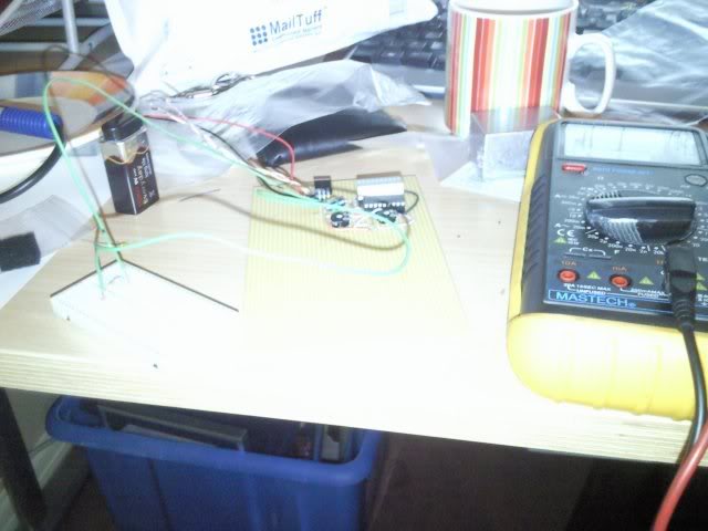

Also got a package with loads of little bits in...
A little bit of soldering and stuff...

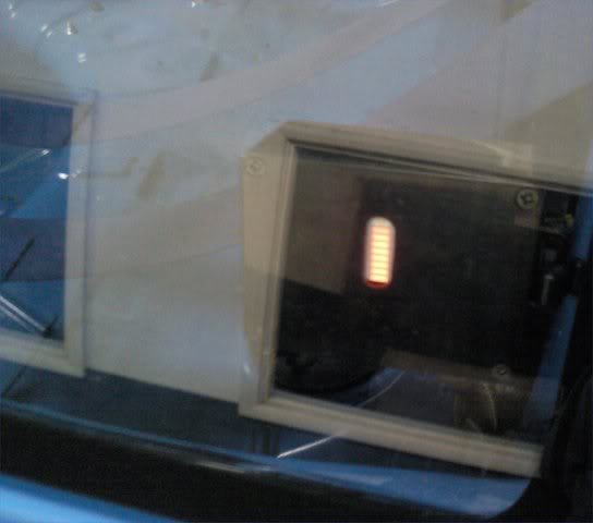

And what do we end up with? A new fuel gauge.
Because putting a 58mm holesaw through the dash did little for the OEM display we had to think of something else.
Couldn't get any thing aftermarket which worked with the original sender and fitting a new sender would have been alot of hassle. This ones works with the original sender unit and can be trimmed for max and min.
Its clipped to the rollcage where it can be seen through the 3/4 windows whilst you are filling it up.

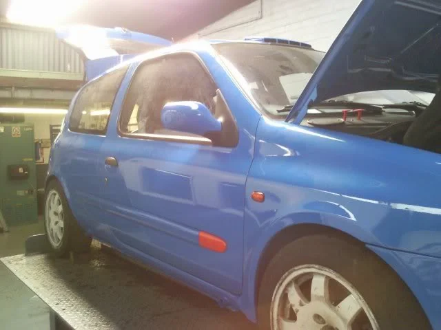

After an initial try with some 1.2 side trims we decided to ditch them and get some new proper ones painted. Looking good now and not really much let to to!

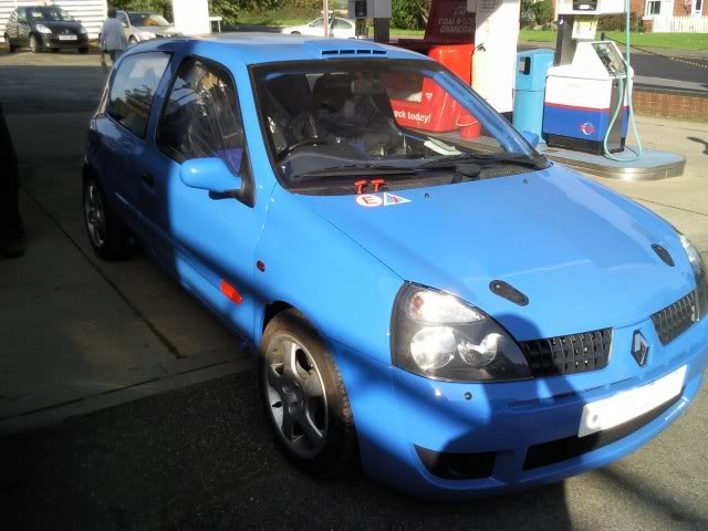

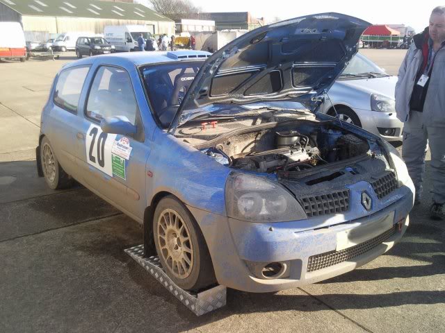

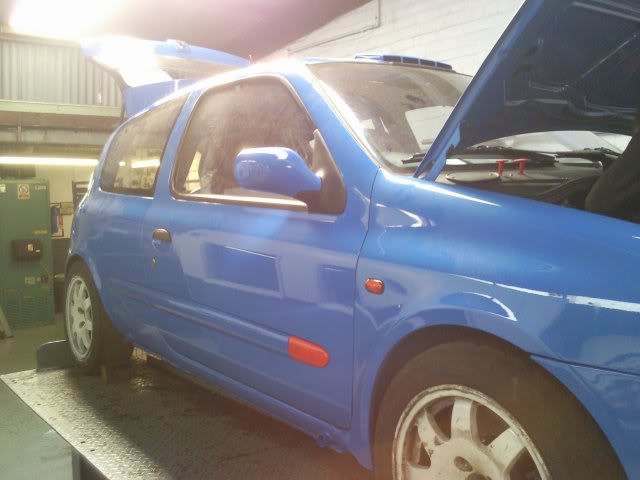

First event at the weekend, purely as a shakedown as it has done hardly any miles.
Finished, and with a list of things to look at.
Different brake pads/fluid
Fuel guage needs some work
Few things came loose
Flat shift needs checking
Apart from that it seemed really good and everything will hopefully be sorted for next time we go out.
It got dirty :(
