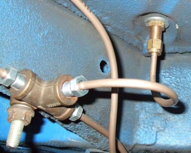

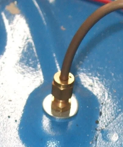

do you have any close ups of where the brake lines pass into the car then ?
it looks just how i want mine to go into the car :)
I'm not sure what they are technically called, but we got them from a local place that makes up hydraulic hoses etc.
They are an olive fitting by the way if thats any help

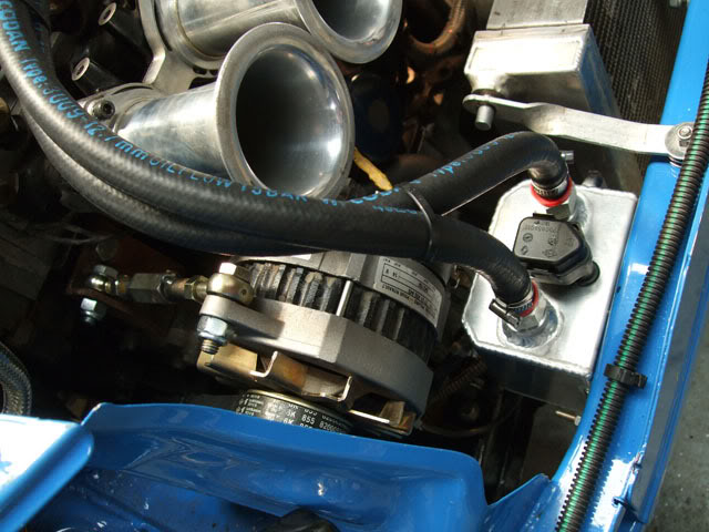

Saturday we transfered the uprated fuel pump from the old car to the new car, plus fitted the old competition driveshafts into the new car.
The oil breather catch tank also went in. You can also see the adjuster bar for the alternator aswell.

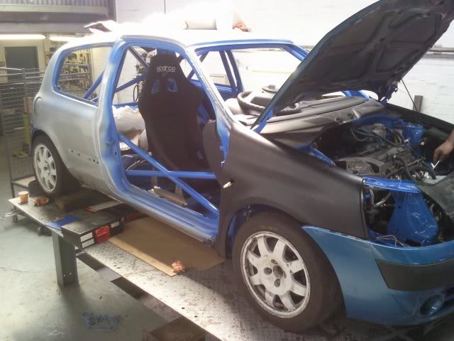

Test fitted the bonnet and wings, and also made some new mounts for the rear bumper. It's starting to look like a car again now :)

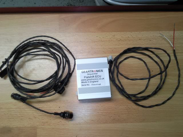

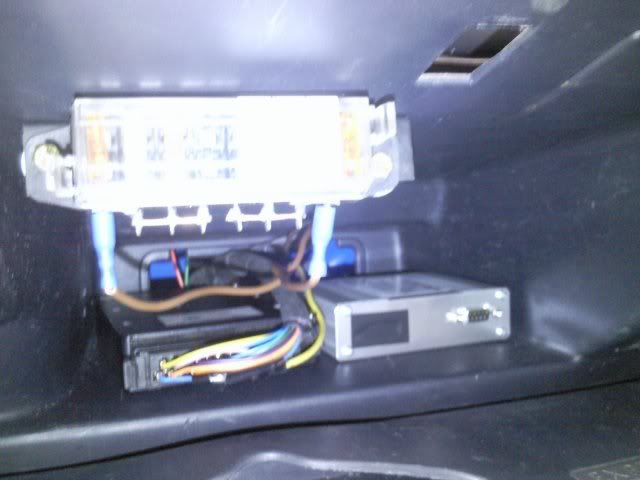

Got a Geartronics flatshift ecu to replace the Sadev one we already had.
And fitted in the glovebox next to the Pectel T2 engine ecu.

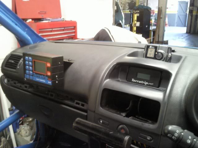

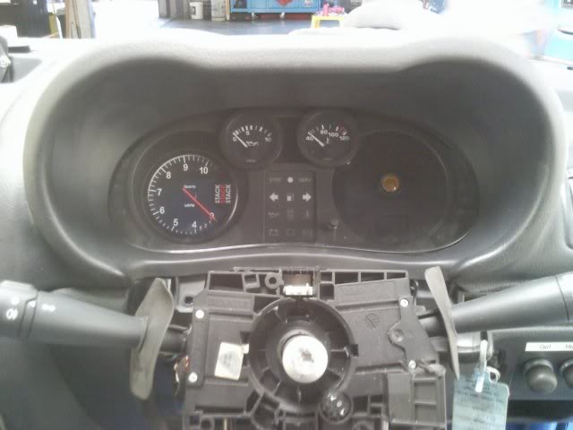

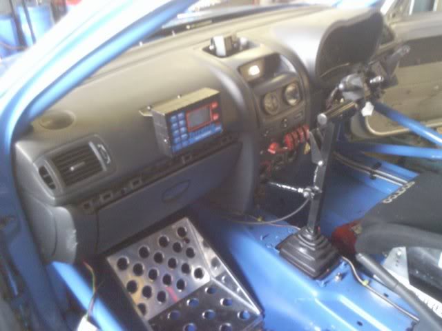

Terratrip rally computer and display fitted to the dash, with the Sadev gear indicator mounted to the dash top.
The dash top is on, but will need to come off again to fit a couple of guages into the middle air vents.

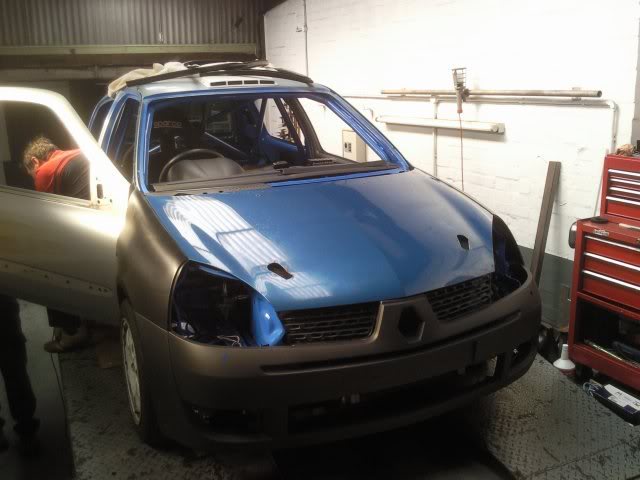

A bit slow going, but been quite busy the last few weekends. The car is ready to go off to get painted now.

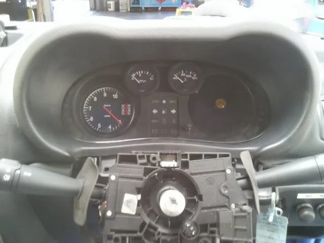

The dash is now all complete apart from screwing it back up and putting the newly painted dash inserts back on

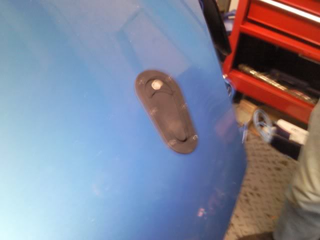

Have fitted Aerocatches to the bonnet, such a pain to fit as i'm sure anyone who has some on their clio can testify. If you have a flat single skin bonnet then i'm sure they are a dream :) The clio is anything but a flat single skinned bonnet.

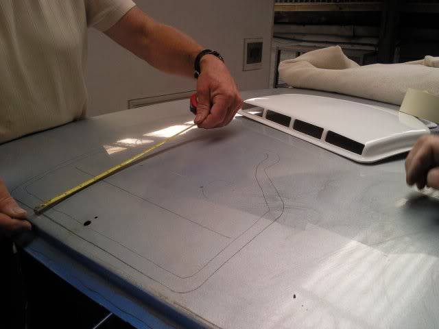

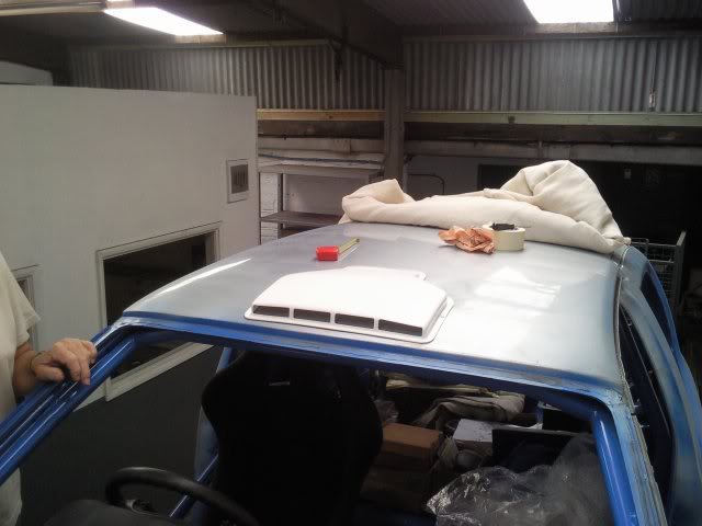

Drawing on the roof, and using a tape measure!

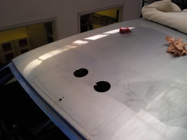

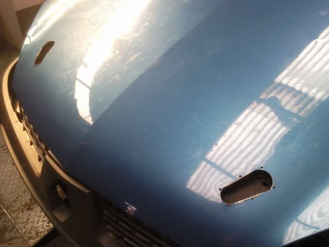

Hole saws out yet again to put a couple of holes through
Roof vent loosely fitted; when it goes off to get painted it will be bonded down to the roof.

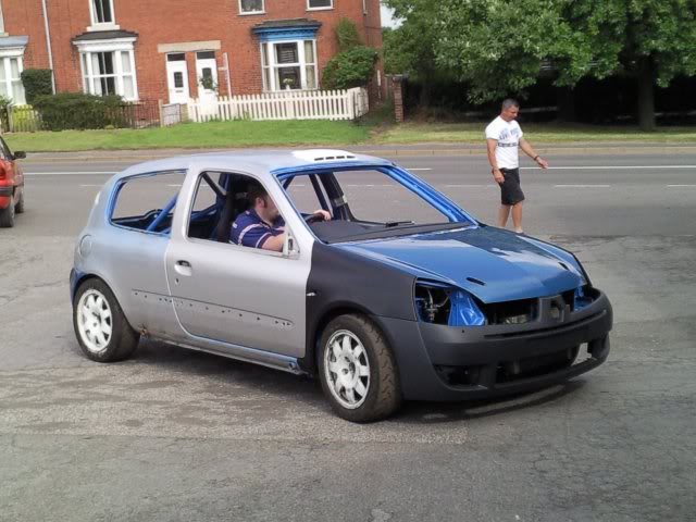

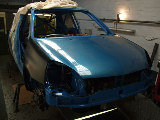

All the panels fitted, ready to go. Not mentioned before but fitted the tailgate and removed the glass from it, and put on a new RS bumper.

I have the same roof rent and I have just replaced after the bonnet had flown up. I have made a mod to it as if its raining you do get wet even with the internal vents are shut. the holes that are in the roof put a rubber trim round to try and stop water running in.
