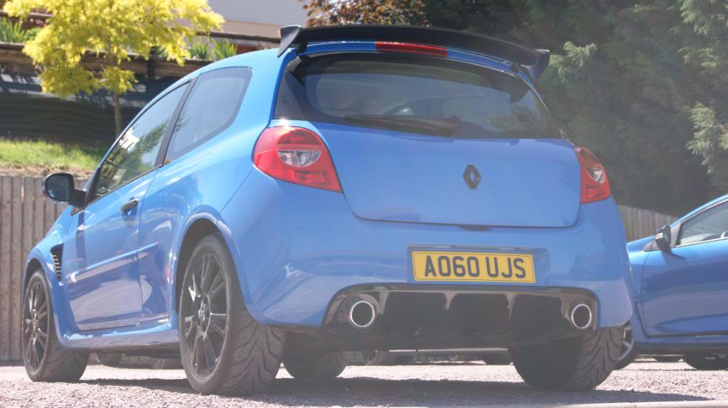

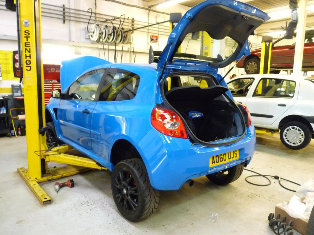

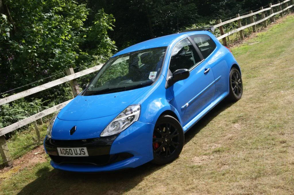

Right.........time for some pics!
So here is the new dakar clio - taken during the coilover fiasco!

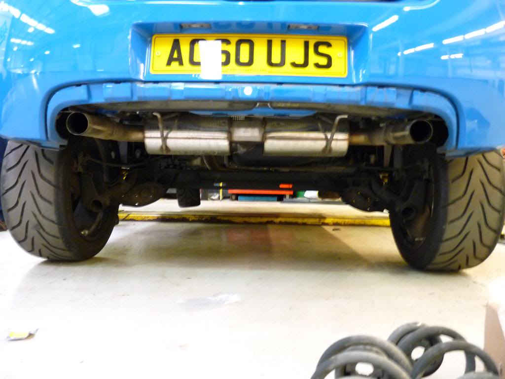

Picture of the KTEC pro exhaust and 888's

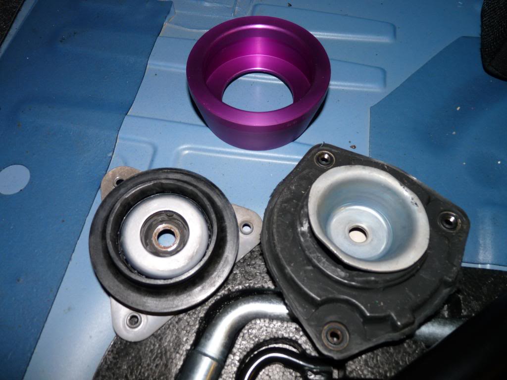

And this is why the coilovers won't fit a 200. See the difference in diameter of the top mounts, the one on the left is the 200 mount which is noticably smaller than the 197 mount, which fits snug in the purple coilover cup. Also notice the difference in the triangle bolt spacing which is why I couldn't use the 197 top mounts.

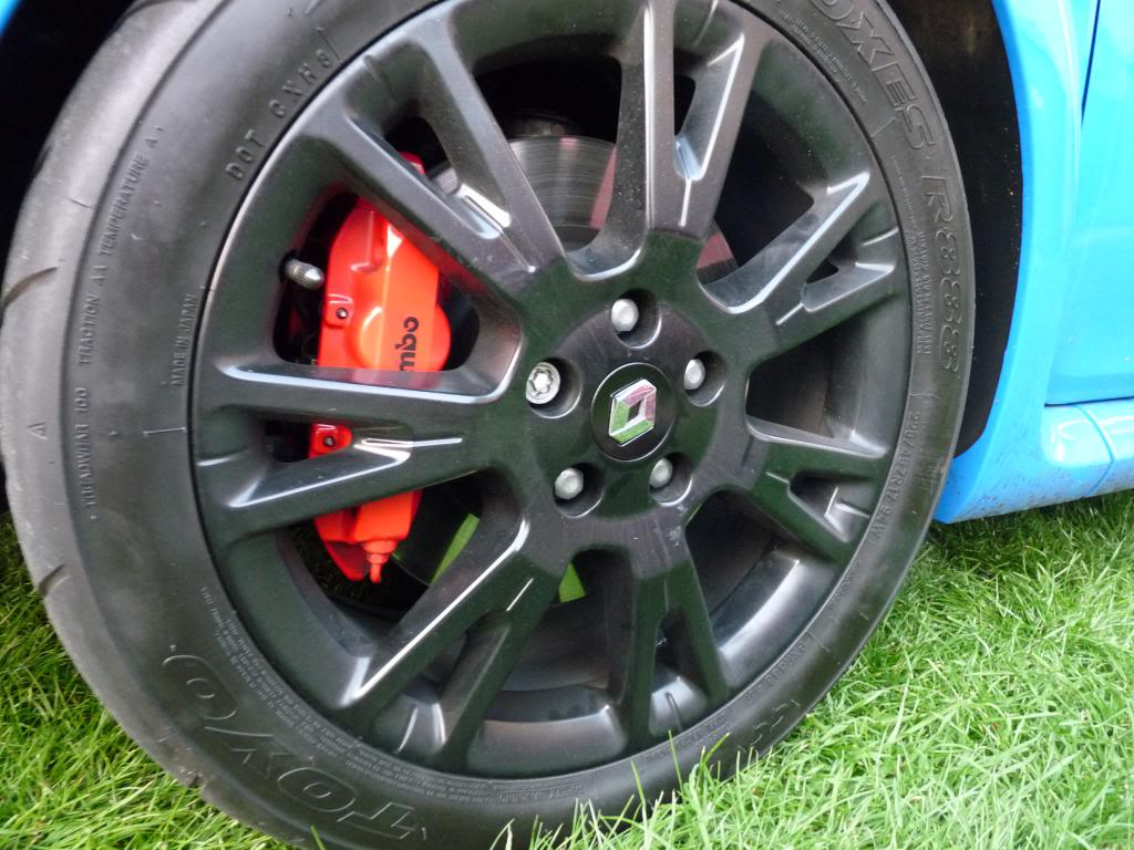

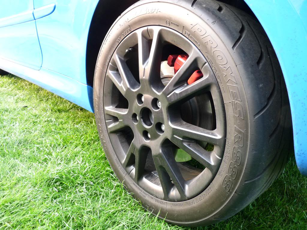

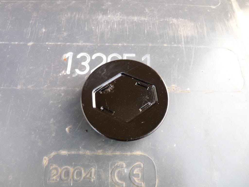

Wheel centre cap with a couple of coats of satin black
Before and after fitting to the wheel

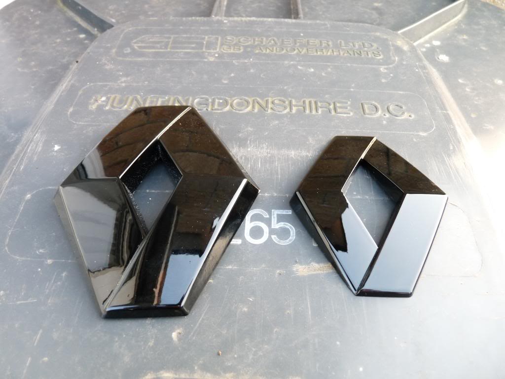

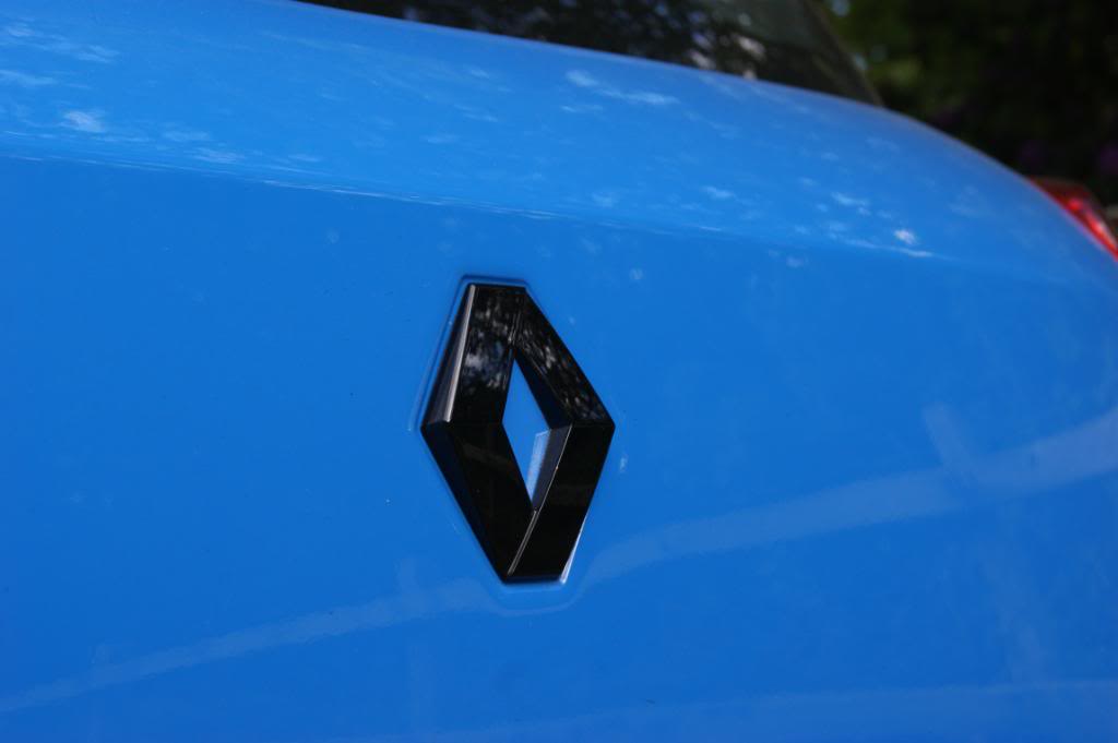

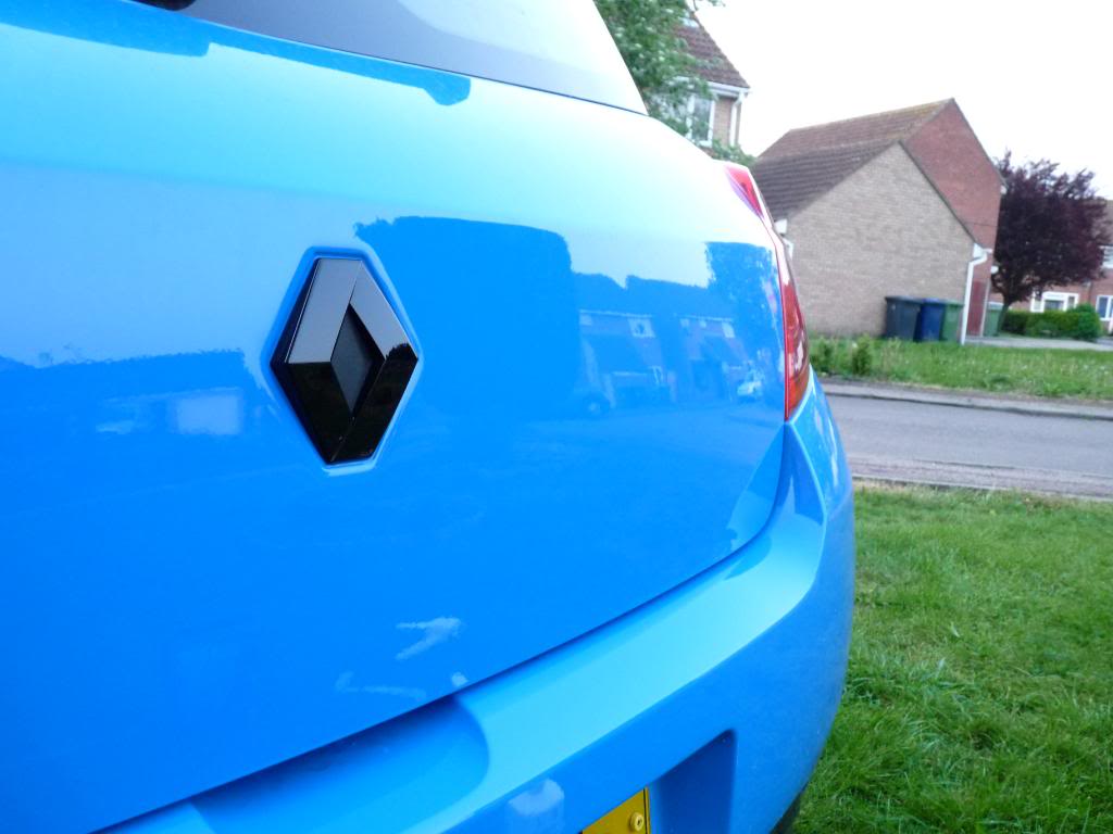

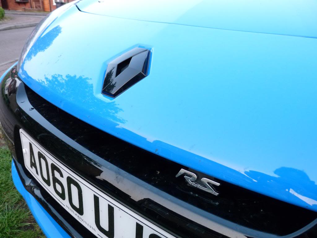

Diamonds after a couple of coats of gloss black

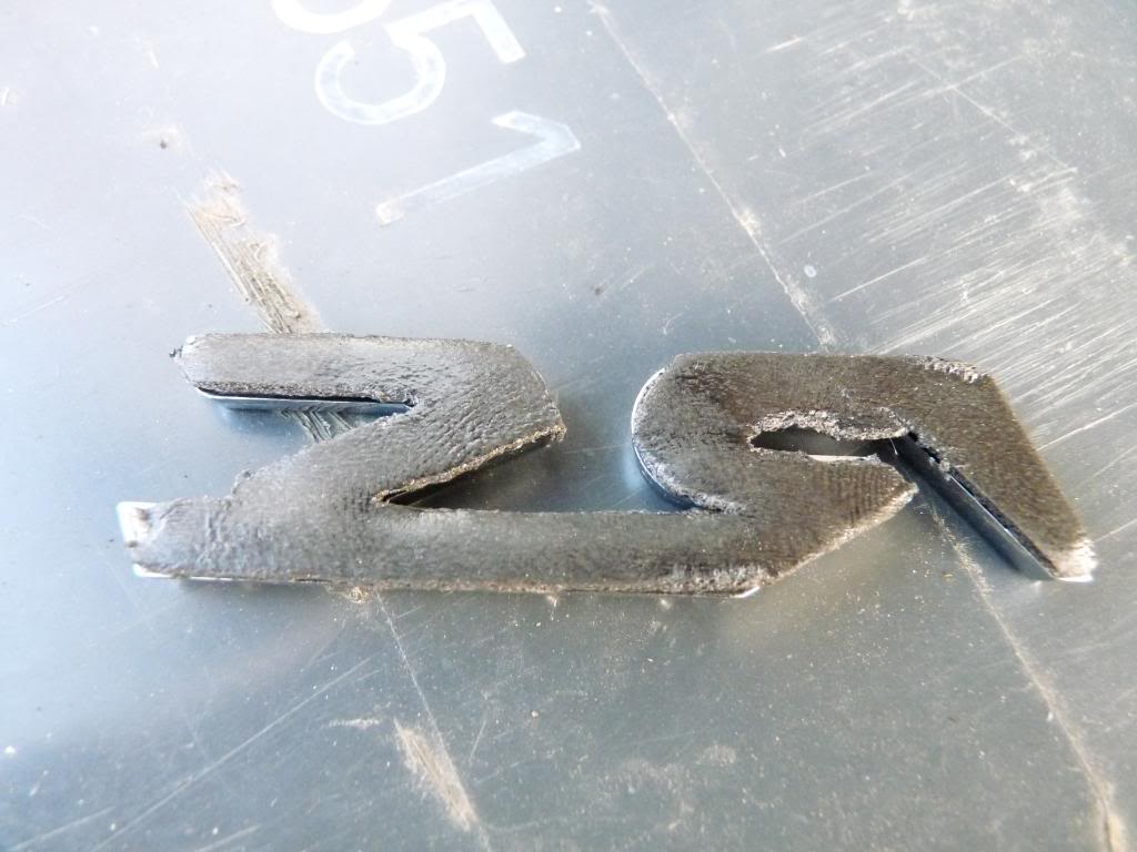

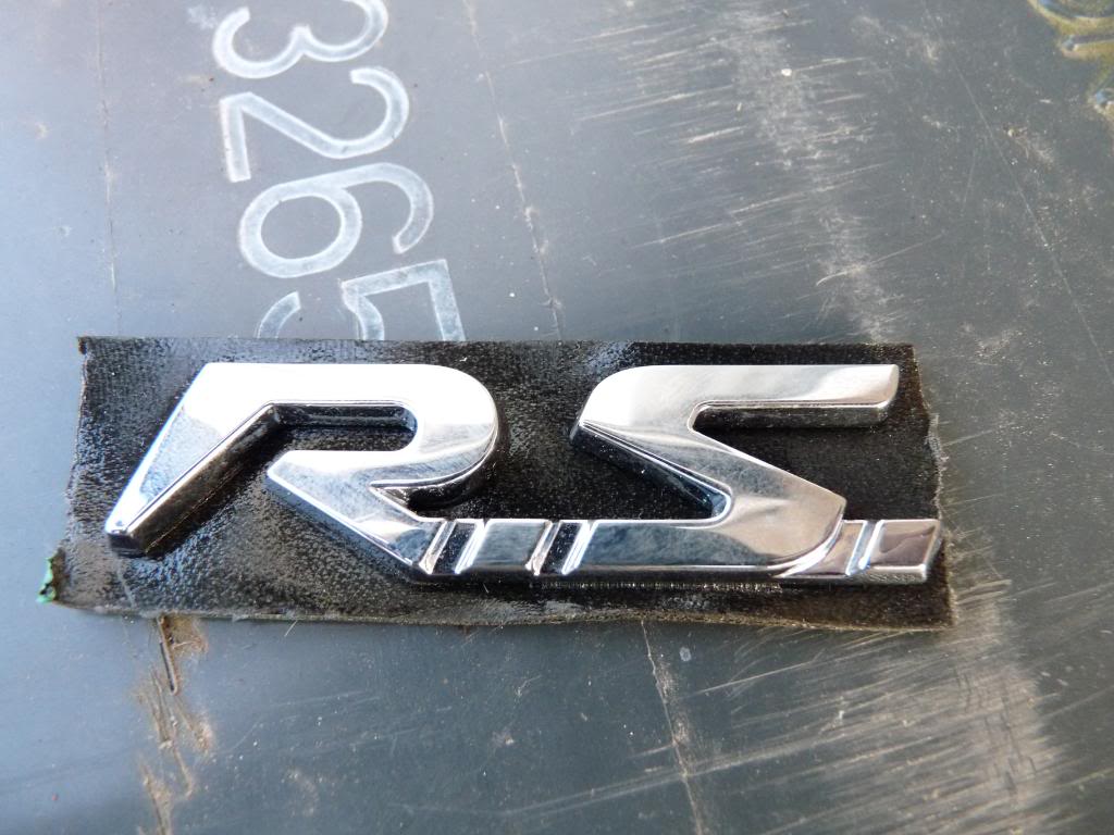

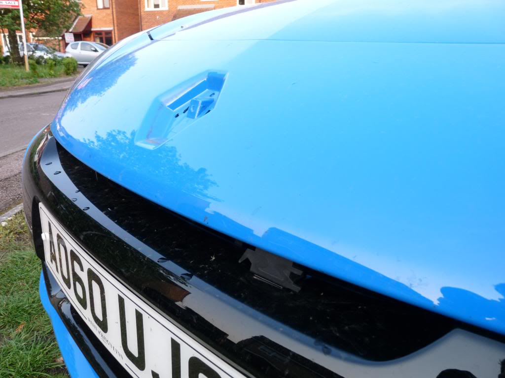

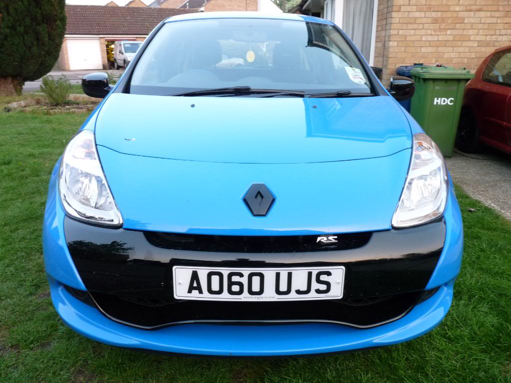

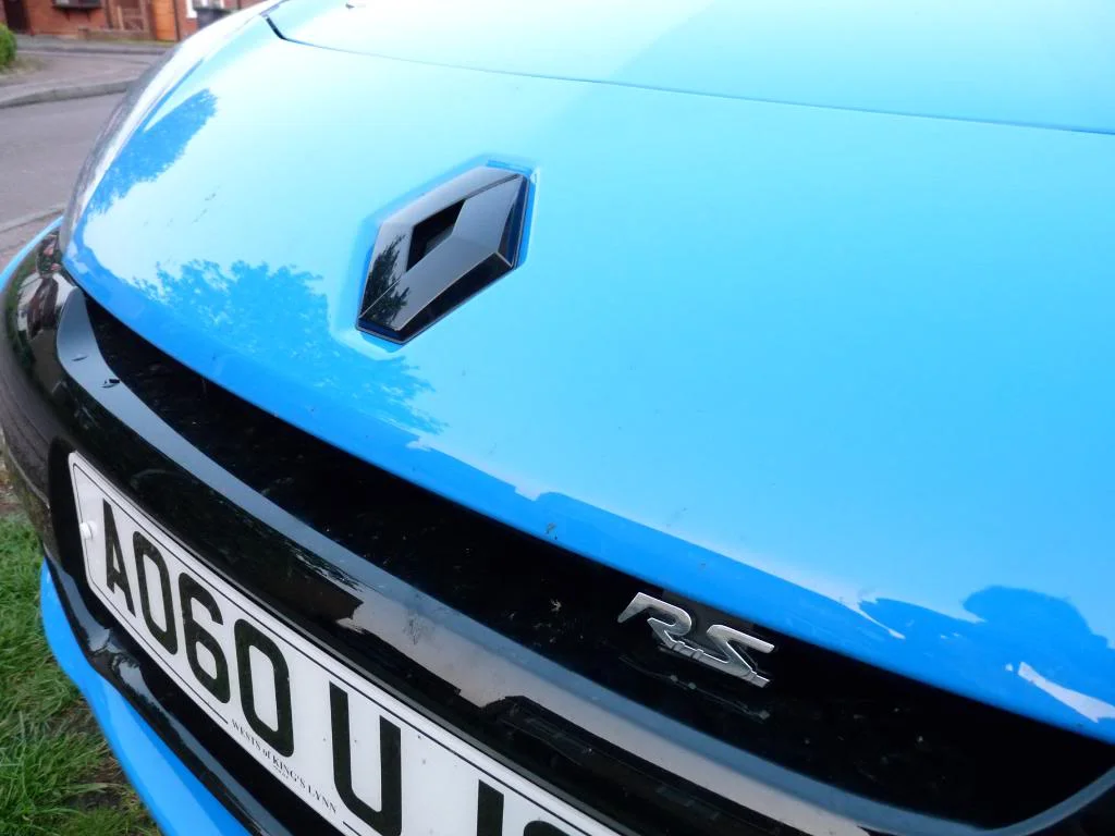

Front RS badge - after it fell of within 2 weeks I decided to stick it back on again, although still not sure I'm going to keep it on!
Front before and after

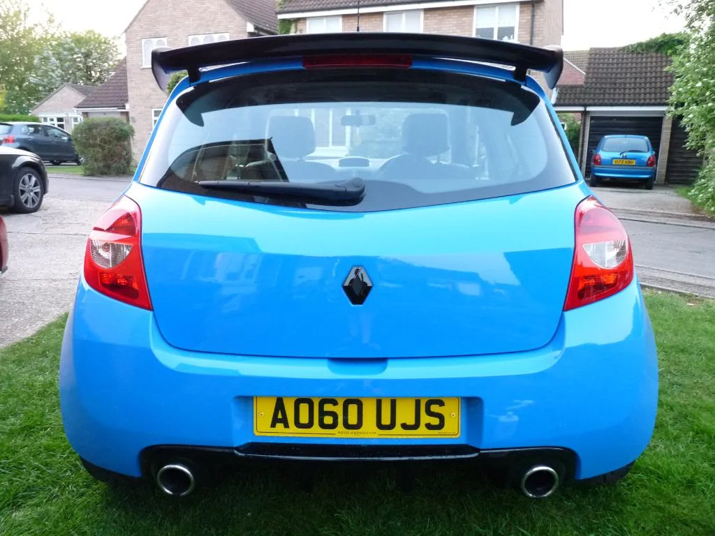

Rear before and after

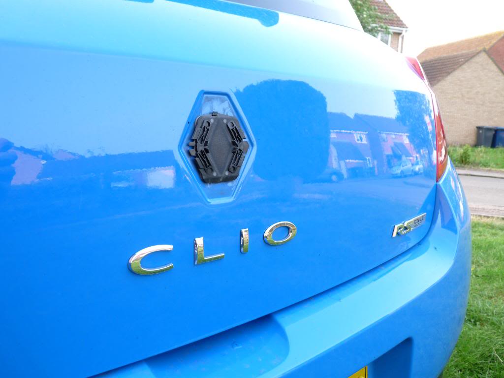

The badges....you manage to get the front off without removing the bumper? Im wanting to do mine along with the bullets to go all black and yellow black and yellow
  Discounted 1*2 parts
Ill have to pop along to a meet and hear it in person. Only round the corner!
Want to do my bullets RB with black lettering but want a spare set of bullets to practice on first!
You need to release the top of the bumper (2 10mm screws in the middle by the bonnet catch and 2 plastic plugs at the end) and then pull it up to get access to the 2 torx screws behind the badge.
The badge is only clipped on the base but I found it too tight to prize of without breaking something!

And not wanting to argue with the 2 people I know who've had KW's fitted to their 200's ......... but I can't see how the small 200 top mount could possibly be save rattling around inside the KW coilover cup. You'd have to guess where the centre was and then hope it doesn't move once fitted!
As said above you can see the internall diameter of the purple cup is a perfect size for the larger 197 top mount, not the smaller 200 mount.

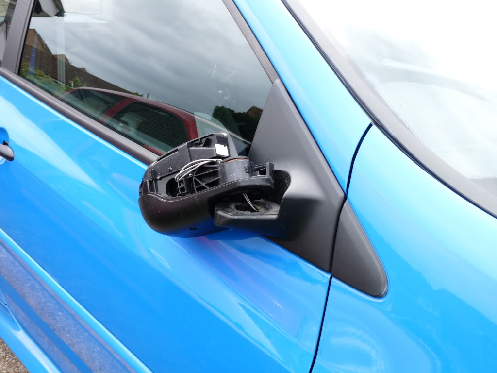

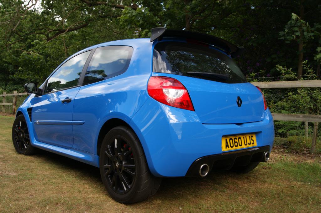

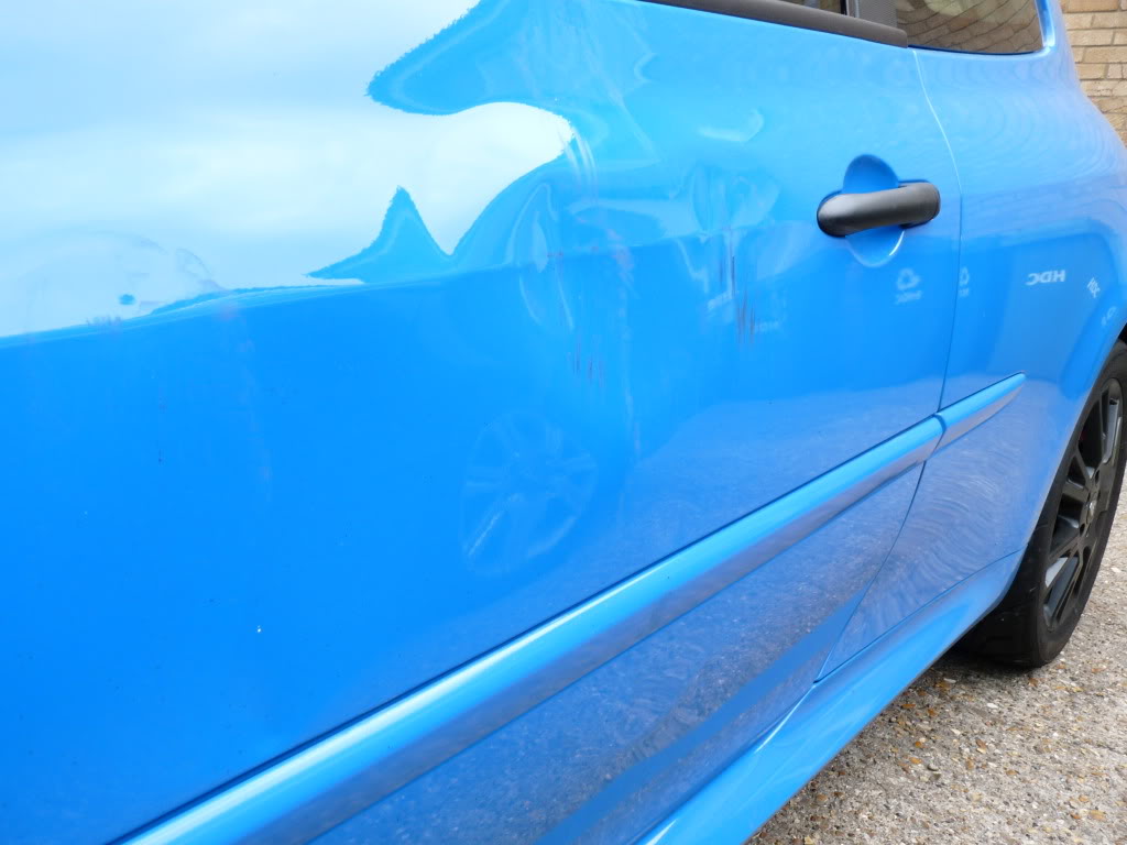

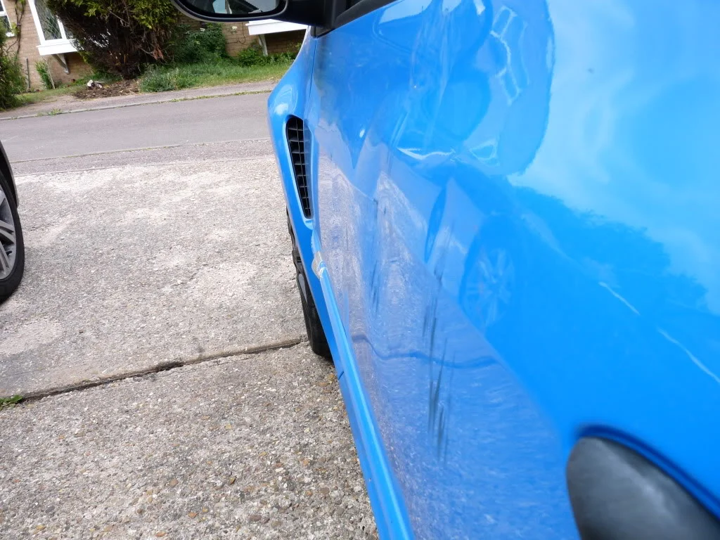

Car now back to its former glory after having to have a new door and mirror :(
Some quick pics

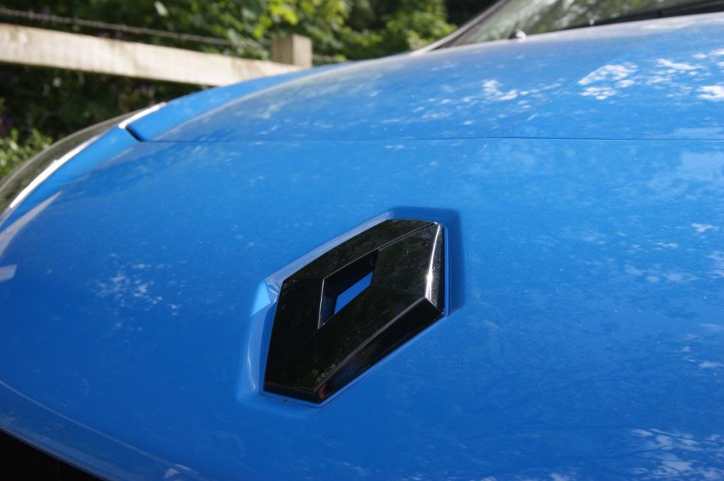

Also had the centres of the badges painted blue

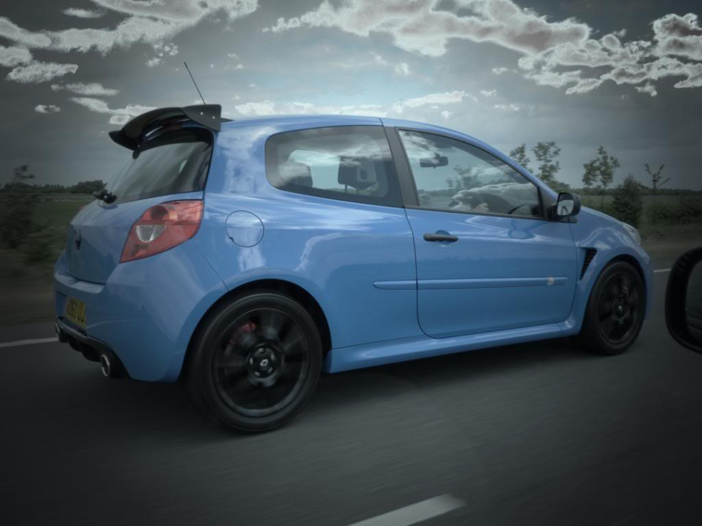

Rolling shot from the last Hunstanton meet
