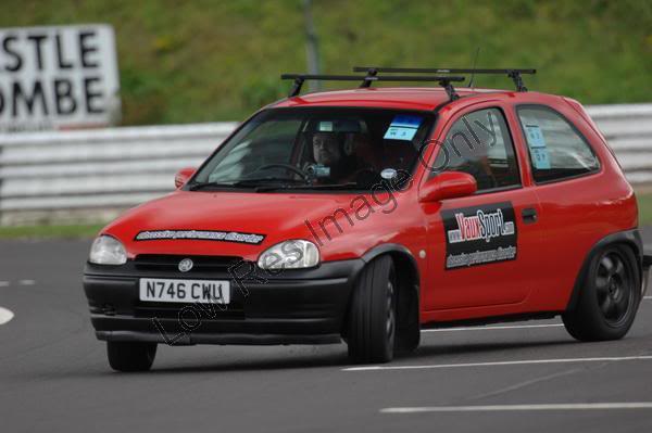

We've not just pulled the pump out and crimped the pipes up though.... that would be the stupid way of doing it, because we'd still have to either push fluid or air against itself. We took the gear out of the rack and cut out the seal that sits in the middle, then greased up the gear and stuck it back in. It's a much neater solution and doesn't have the resistance that a failed pump would have.
Even still, Id sooner haver a quicker rack and PAS.
I added PAS to my trackday corsa along with a quicker rack and it was much better to drive on track afterwards, quickly allowed you to get all of the lock on.
You never know when you are suddenly going to need all the steering input all in one go.
