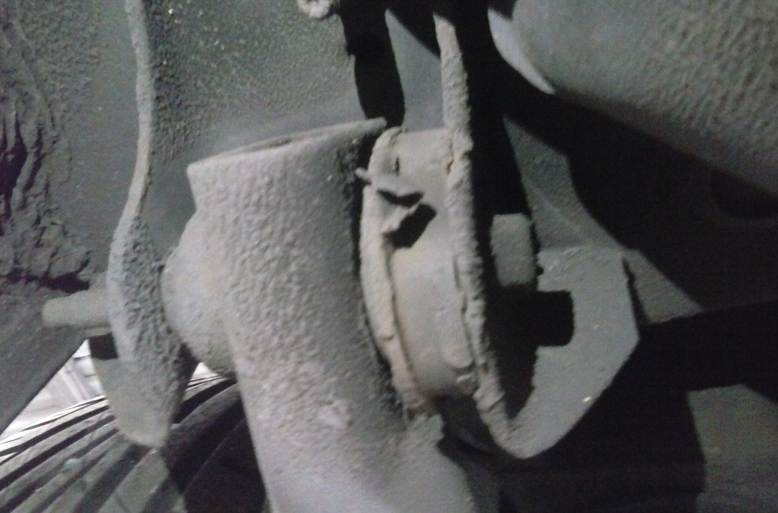

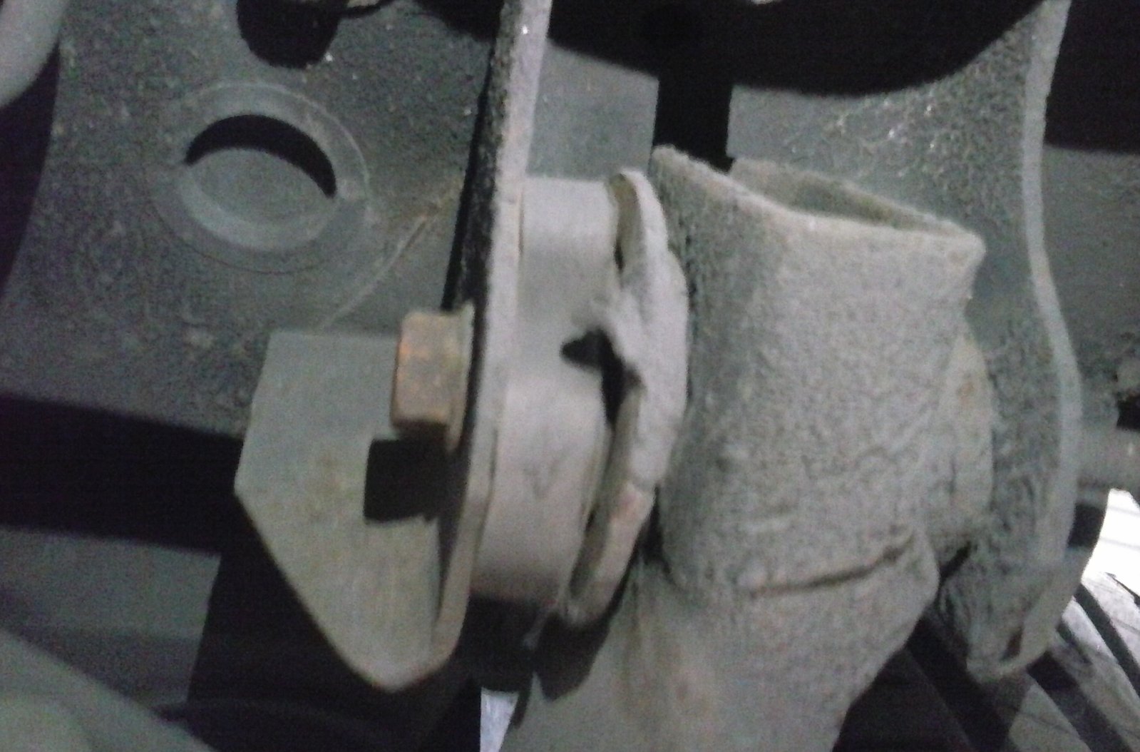

Well seeing as the rear tyres are suddenly rubbing on the arches on tight turns, the rear wheels sit at different widths in the arches depending on which way you last turned, I can feel the rear moving about when the car changes direction, plus the fact that the rear beam bushes are utterly mashed up when we looked at them on the lift, i'm going to go with the theory that the rear beam bushes are f*cked.
Well seeing as the rear tyres are suddenly rubbing on the arches on tight turns, the rear wheels sit at different widths in the arches depending on which way you last turned, plus the fact that the rear beam bushes are utterly mashed up when we looked at them on the lift, plus I can feel the rear moving about when the car changes direction, i'm going to go with the theory that the rear beam bushes are f*cked.

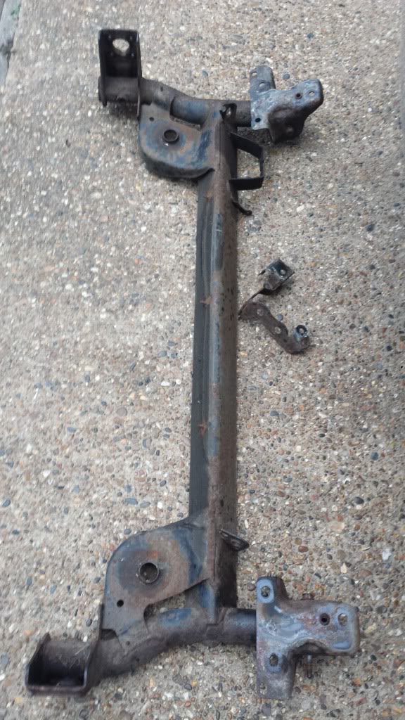

This is what he told me last year maybe 2016 will be the year when more of these start to fail a bit like the water pumps on the 1*2 engine leaking at 10 years old.

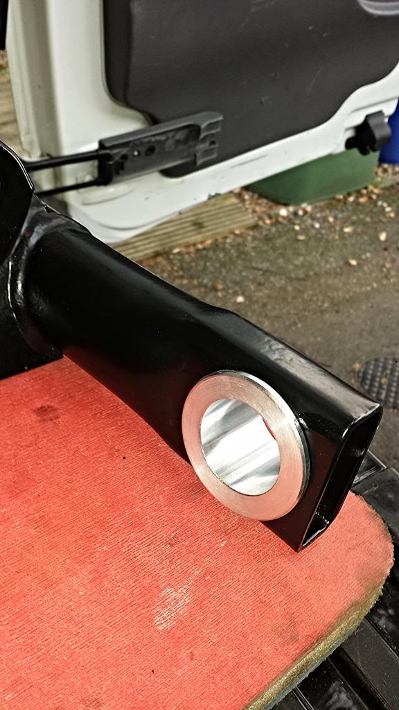

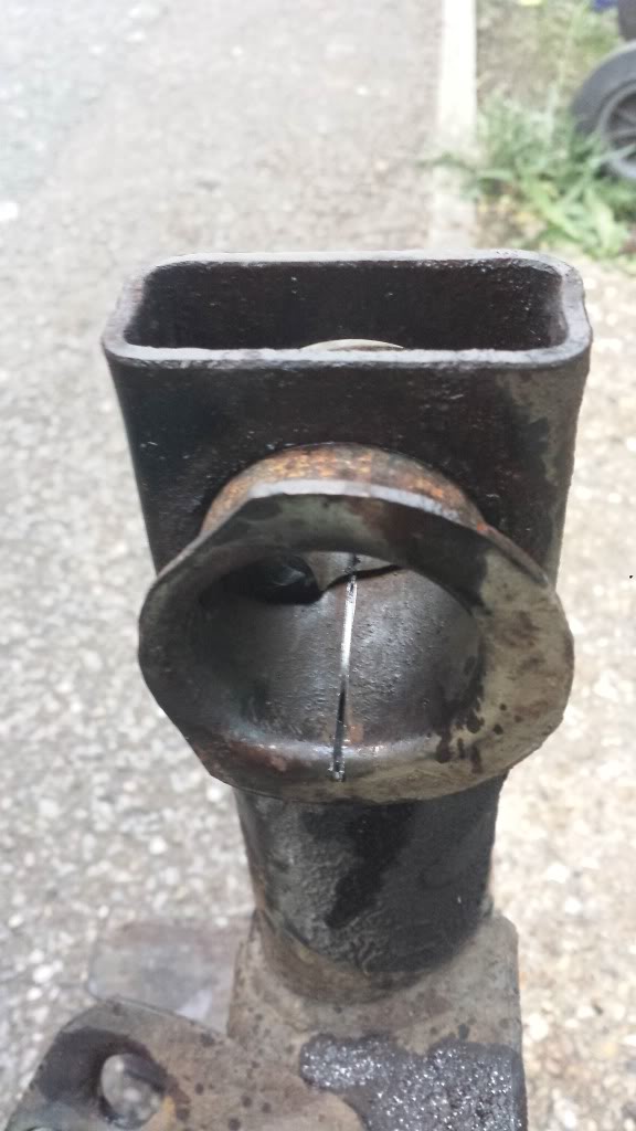

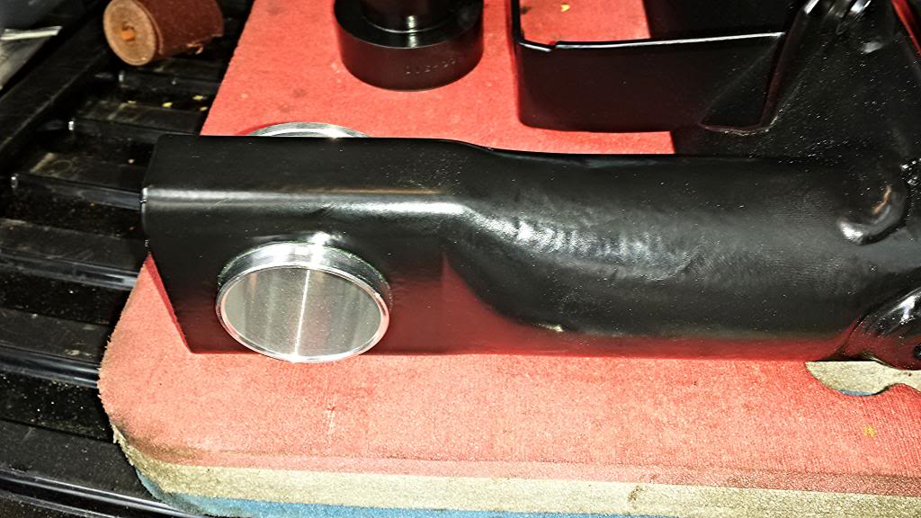

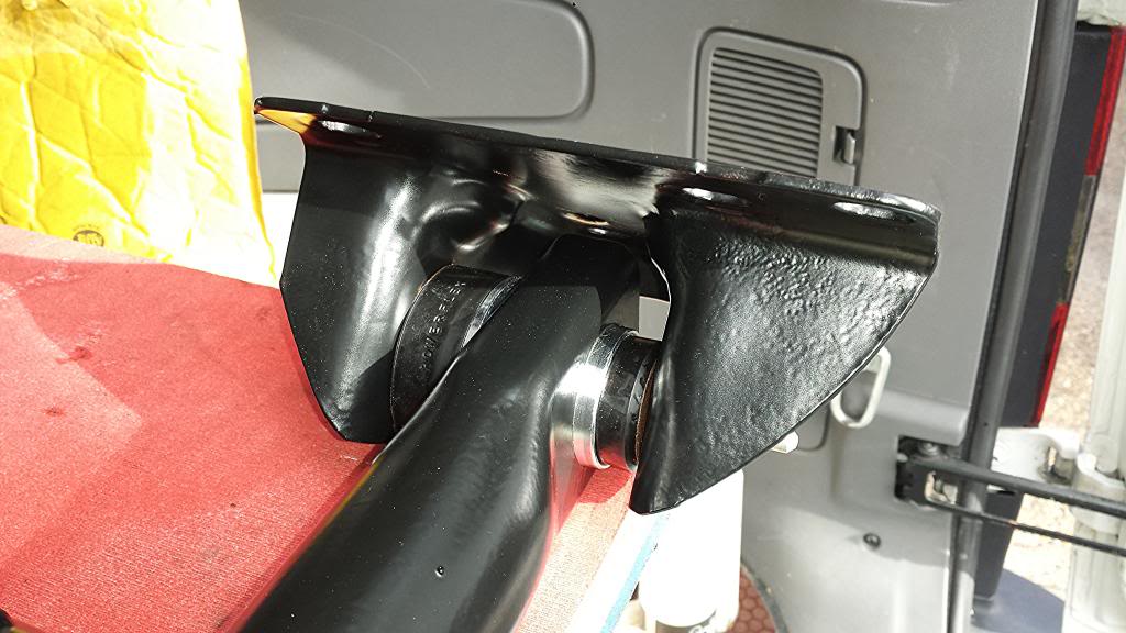

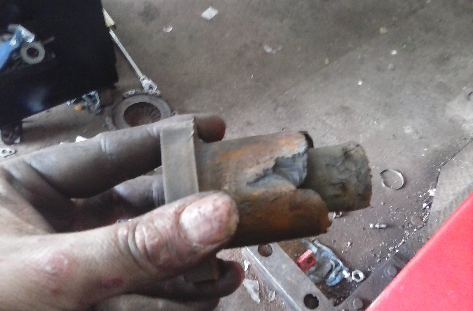

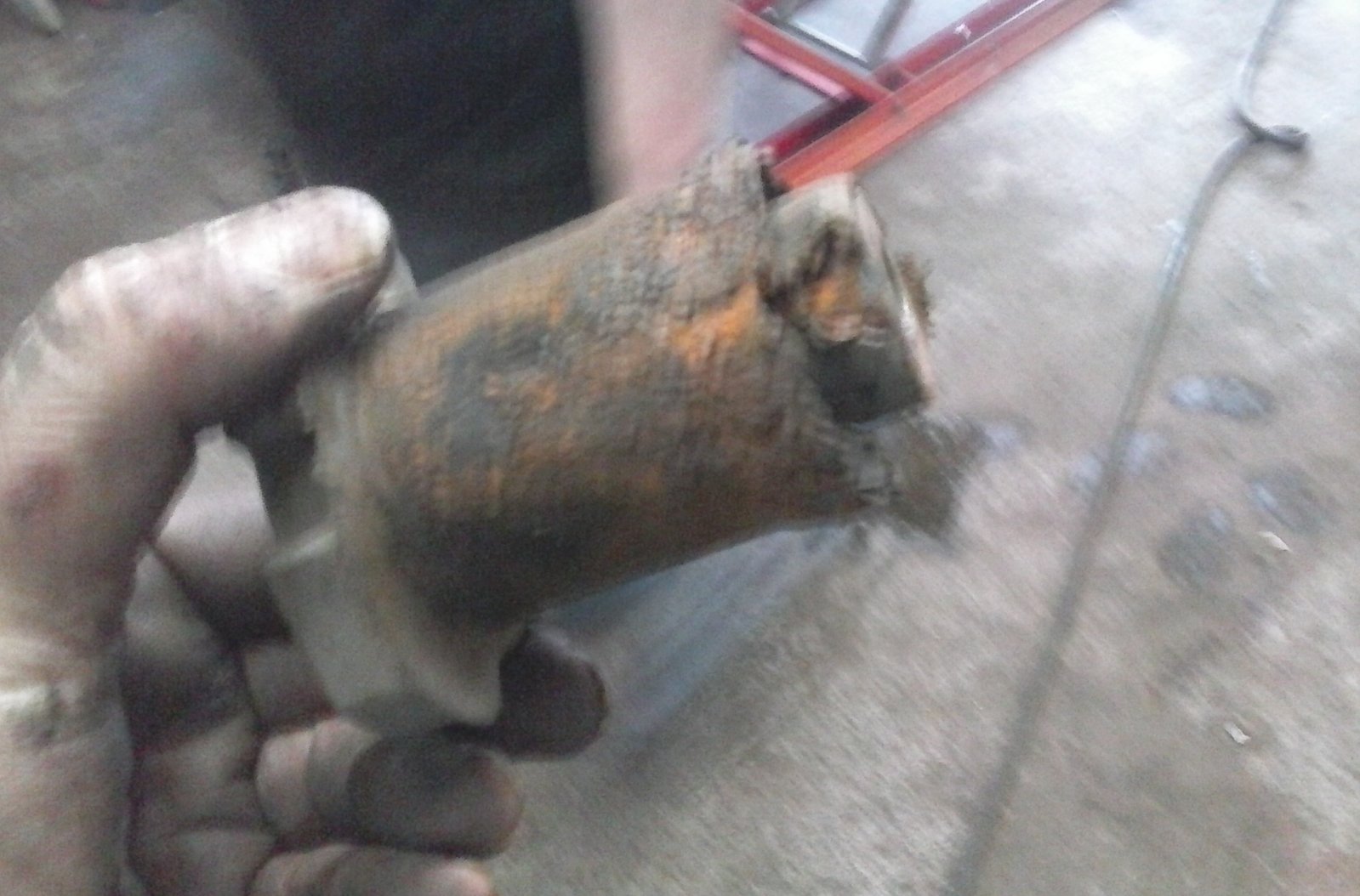

There really not that hard to remove/fit.
I did mine in the back of my van...
Once the rubber is removed (i did mine with a sharp chisel
0nce then just cut a groove with a hacksaw, like so.
Then just hit the metal inner and it will come out.
then you can fit the alloy sleeve, i used loctite to hold it in place.
The new bushes just push in by hand.
Done.
Done.
Done.

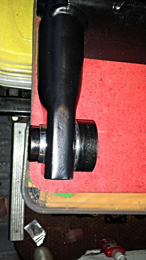

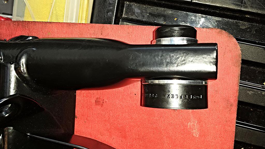

So it turns out my old bushes had indeed seen better days.
Sadly I forgot to get photos of the new bushes while it was on the lift, so this was the best I could do with it on the ground.
What a monumental pain in the arse that job was, even with an entire fully equipped garage it still took us 4 hours.

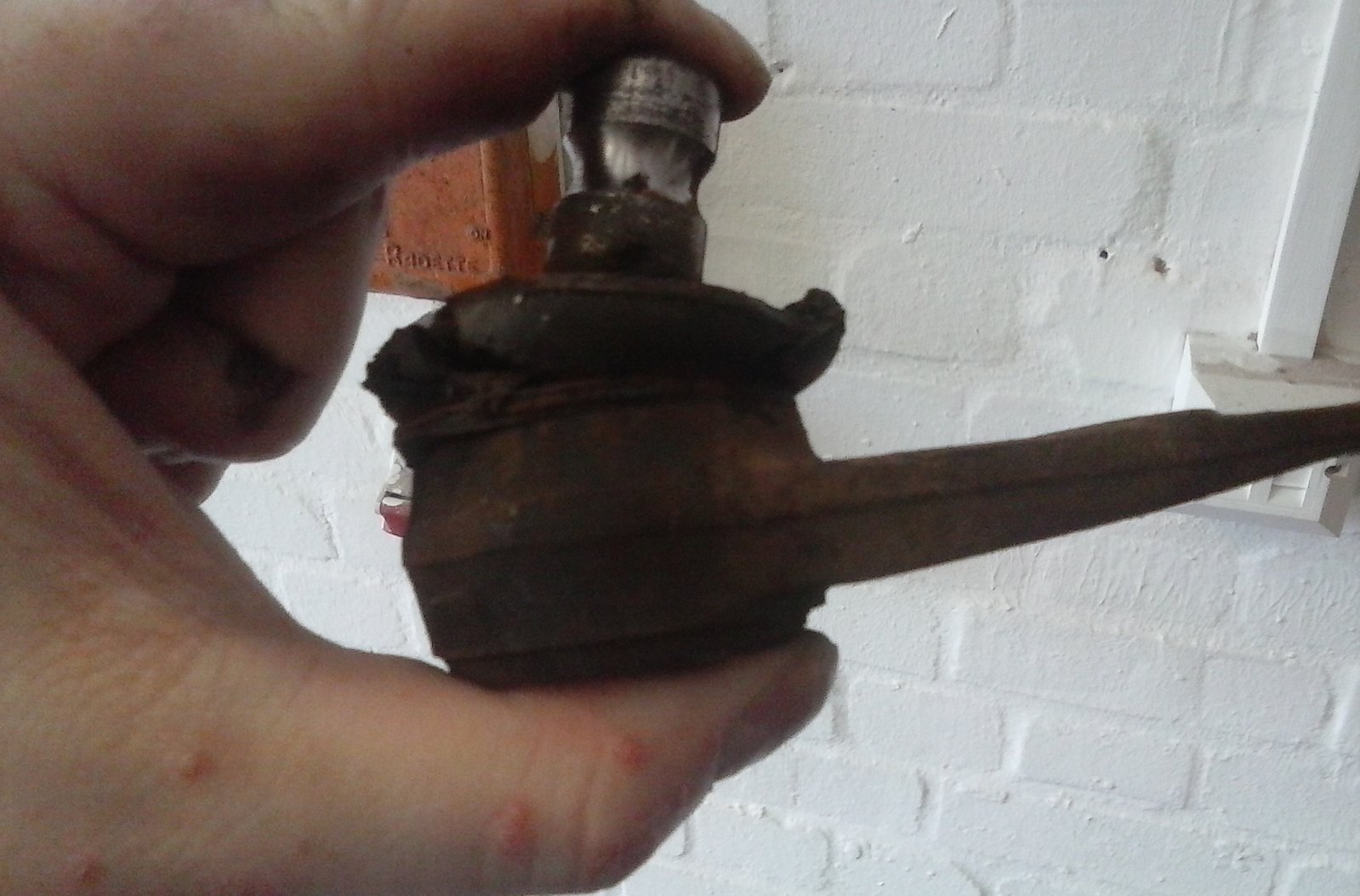

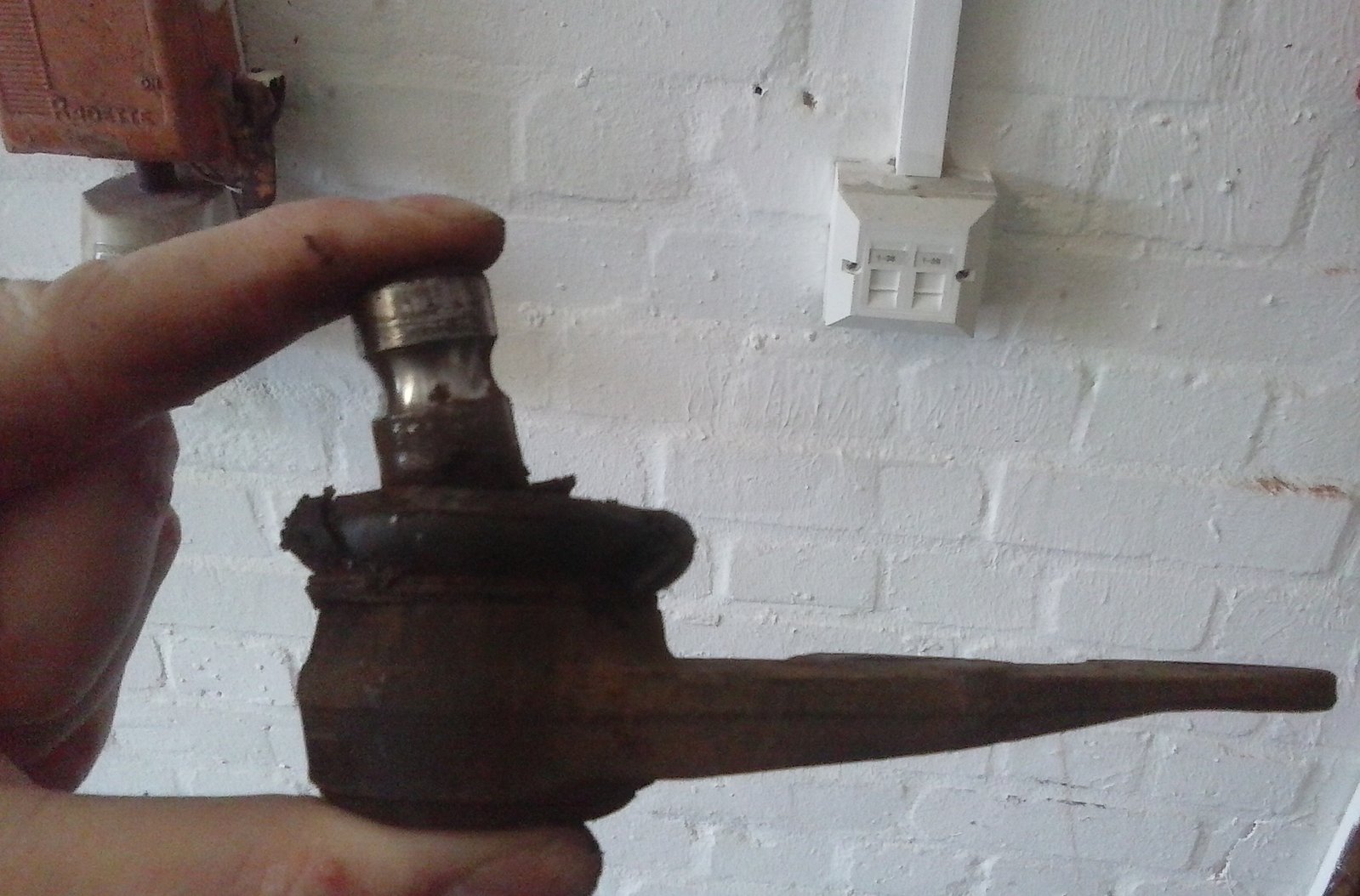

It also took us 2 hours to change the ball joints due to rusty nuts and gunk and stuff, they'd also seen better days.
Oh and when I say 'we' I mostly mean @HMSDervDestroyer with me helping a little, that man absolutely refuses to be beaten by any car, you're a f*cking legend Ryan.
