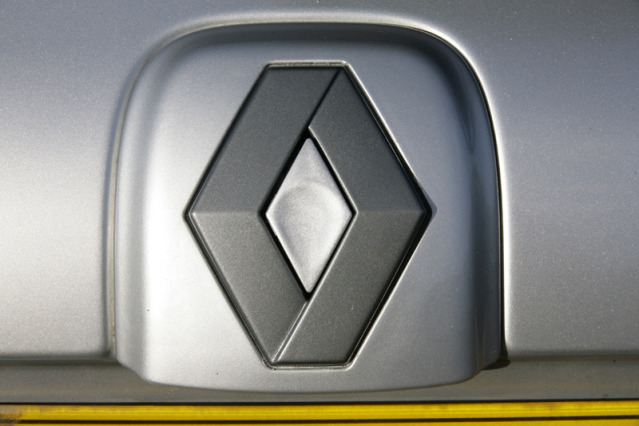

I want to spray my rear renault diamond and have read a few threads on here. Some say it can just pop off, others say take rear plastic off and undo bolts. I took the rear plastic off but theres so much stuff around I'm not sure whether to just undo the bolts and some how push it through or if to attempt pulling the diamond off separately like on the front. I haven't found any tutorials on this so if anyone can post step by step or pictures/guide would be much appreciated! Thankyou for reading

Presume you're talking about the big plastic cover that's held on with one torx screw and then clipped in. You then need to remove the 3 10mm nuts and push through. Then you can either mask around the diamond or cut out the plastic welding on the four lugs holding the diamond in place.
  BG 182 FF
I think the picture has uploaded with this if not i will upload it via photobucket, but take the plastic trim from in your boot off, held on by clips and 1 torx screw on the right side iirc, then you will see these the are the three nuts take them off then you should be about to take it off then get the diamond out. I haven't removed the diamond just took the lot off when my boot would not lock. hope that helps

Mate it is honestly so easy.
Just undo the screw on the inside of the boot by the interior handle recess,
pull hard on the plastic cover on the inside and it will just pop off,
then undo the 3 nuts holding on the rear diamond section,
then pull it off from the outside.....done!
I've recently sprayed my rear diamond and I had no clue how to take it off,
once I exposed the boot mechanism, it became obvious how it cam apart.
Don't be scared, just follow the steps above and you'll be done within 5 minutes. :D

unplug it yeah cos then the wires dont get in your way but the actual boot handle after you have unscrewed these you will able pop off, it aint difficult to get off, becomes clear as you do it.
