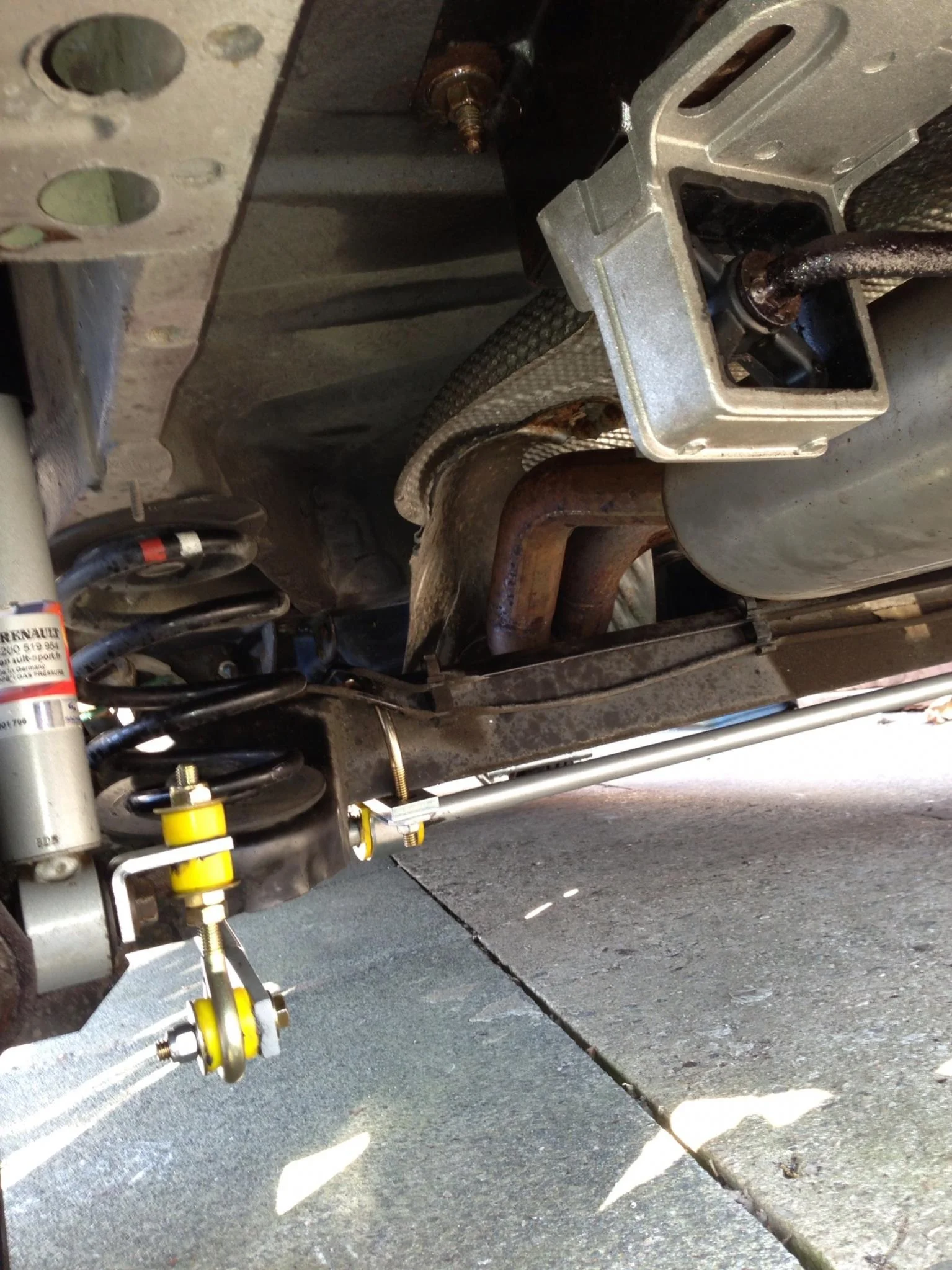

It's tight but lie on your back shimmy in from the rear and there right above u I used a 13mm with a extension on it and ratchet. There's 4 of them to remove the bracket if u look at the pic u can see there's copper slip on it. Maybe you've got a different exhaust?
