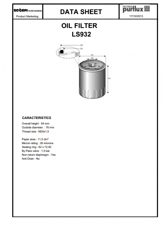

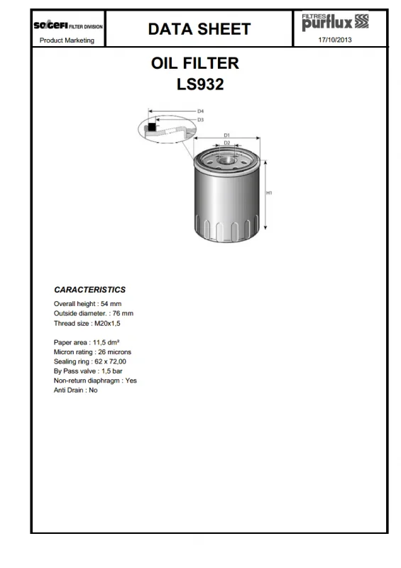

if anyone cares
i spoke to Sogefi who make the OE filters for the following
http://www.sogefigroup.com/en/sogefi-group/our-clients.html
they very kindly sent me the tech spec of the genuine OE filter as fitted by Renault
feel free to comment Chris, i can pass on the details of the tech people i spoke to no bother
AdDaMan
is anyone else bemused by chris lewis and his very odd argument with fred about a different engines oil filter?! :S
No. Im very interested. If im putting filters on my engine that could be potentially causing oil pressure issues and there are better variants available then i want to know about it.
